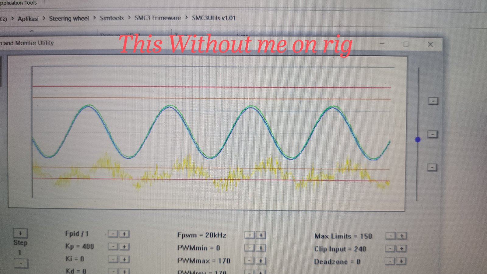

Question Weird Problem in my 2dof with SMC3 Arduino

  2. Gadget999
    1,952
    11,941Coins
    +483 / 10 / -0
    Set p, i and d to zero and slowly increase p
    One it starts moving set the output to sine wave

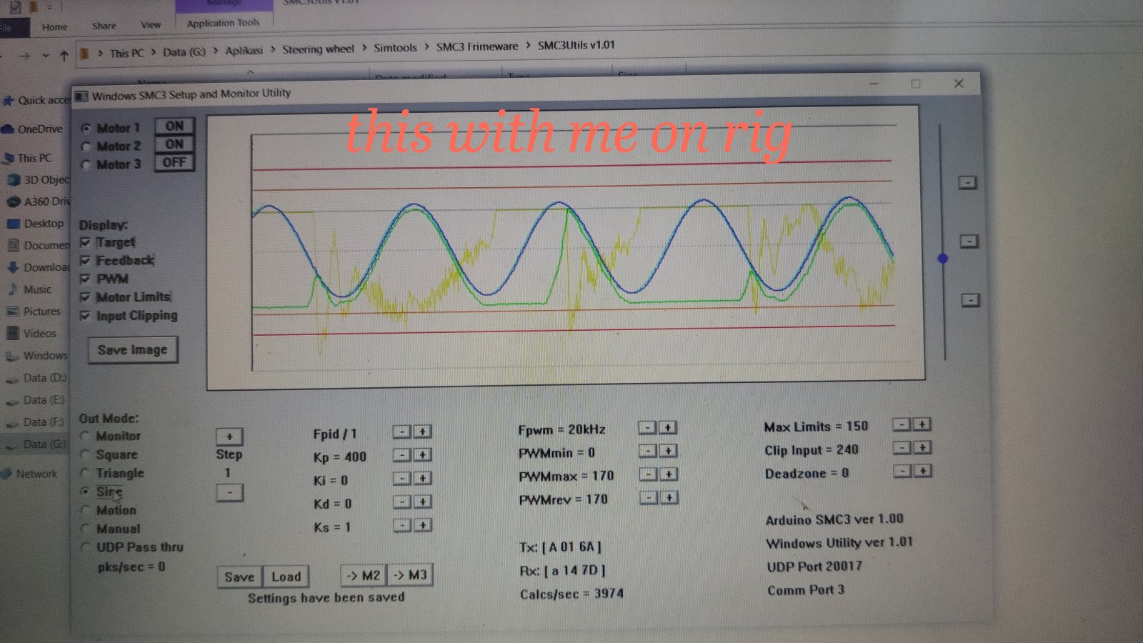

  3. Arta Yasa
    Arta Yasa Member
    Jan 27, 2021
    165
    824Coins
    +14 / 0 / -0
    Ihave try sir, but still get same problem. I have try p 300 until 500 sir. I have check the pot are oke 10k. And change to new pot still get same problem like on video sir.
  4. Arta Yasa
    Arta Yasa Member
    Jan 27, 2021
    165
    824Coins
    +14 / 0 / -0
    Now i set p until 950 sir, still get same problem sir
  5. Gadget999
    1,952
    11,941Coins
    +483 / 10 / -0
    So the sim is ok when you are not sitting in it ?
    This means the motors are not powerful enough, or your power supply is too weak

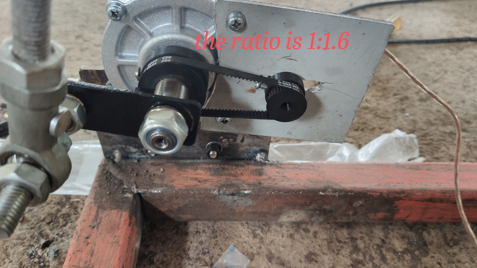

  6. Arta Yasa
    Arta Yasa Member
    Jan 27, 2021
    165
    824Coins
    +14 / 0 / -0
    Yess sir, i used 2 motor 250watt with 300rpm. And used 1 psu 24v 13A. But i tets supplay 22v to motor direcly it veryy strong sit, until my ring jumping, yess i will try with 2 psu 24v 13A sir.

  8. ilciumbia
    ilciumbia Member
    Jun 1, 2024
    31
    Engineer
    181Coins
    Same problem as me, I am using two wiper motors, I can assure you that it is a matter of power, no p, d or i are the issue here, only power. Since 250W should be enough to move the rig, I would concentrate on PSU. Unless... Did you balance the rig well, when you are sitting on it?
  9. Attyla.pl
    Attyla.pl Active Member
    Oct 1, 2023
    270
    Polska
    1,185Coins
    +81 / 2 / -0
    In my opinion, something is wrong with the connections of the potentiometers to the arduino or the uploaded software to the arduino.
    There is a limitation in SMC3Utils software, you can control only one motor . In your video you can see that Motor 1 is selected and both motors are moving such operation is incorrect. First of all, check that when you have Motor 1 selected, if by turning the potentiometer from Motor 1 you change the position of the green line, then do the same for the potentiometer from Motor 2, if with Motor 1 selected you can change the position of the green line by turning both potentiometers, it indicates a problem with the correct wiring.
