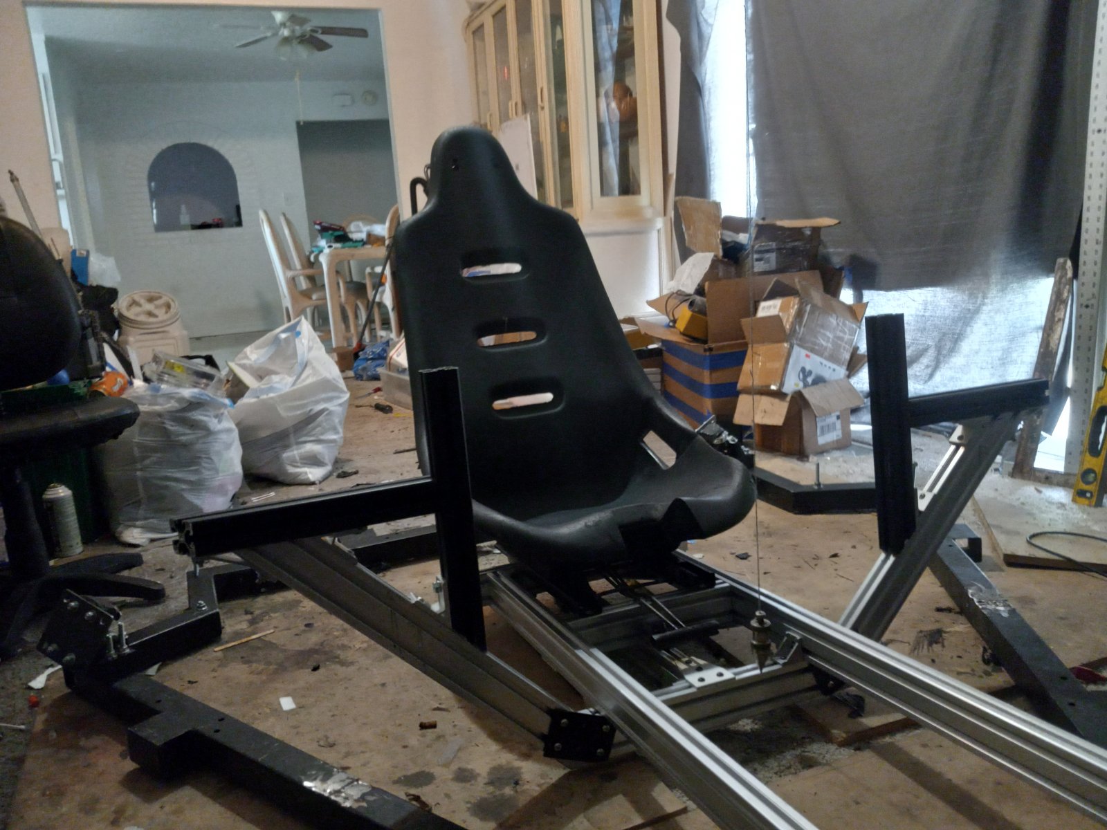

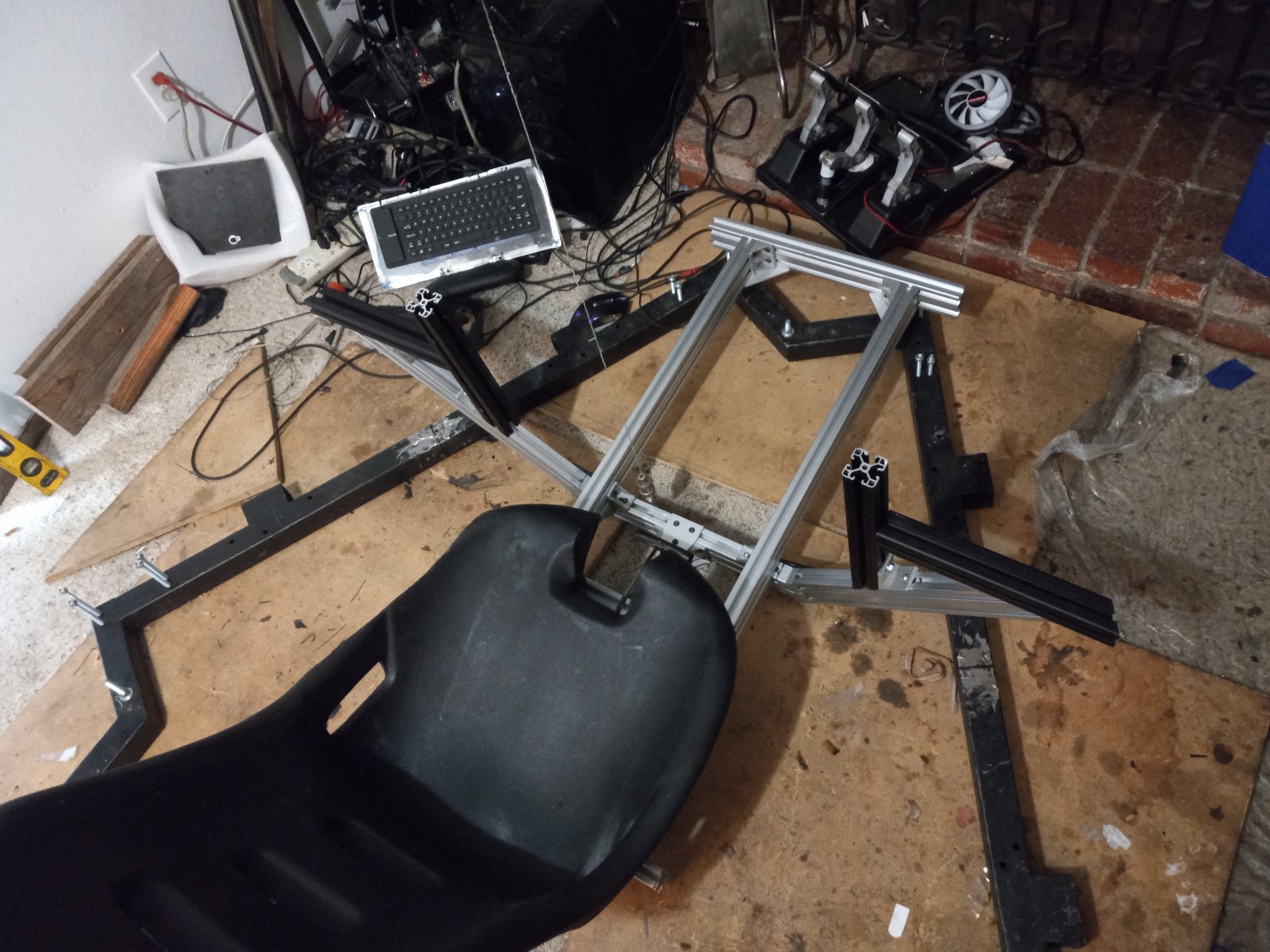

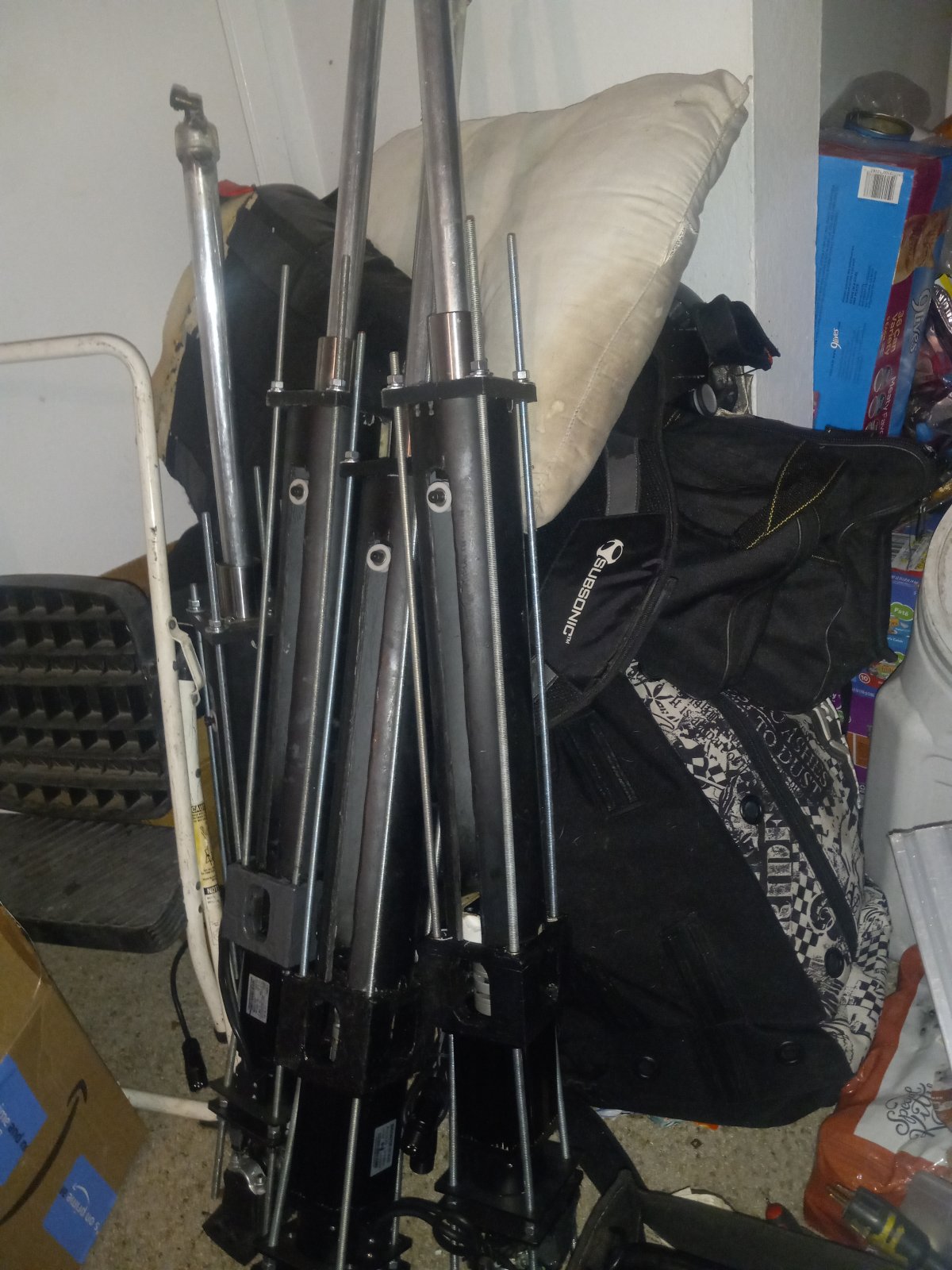

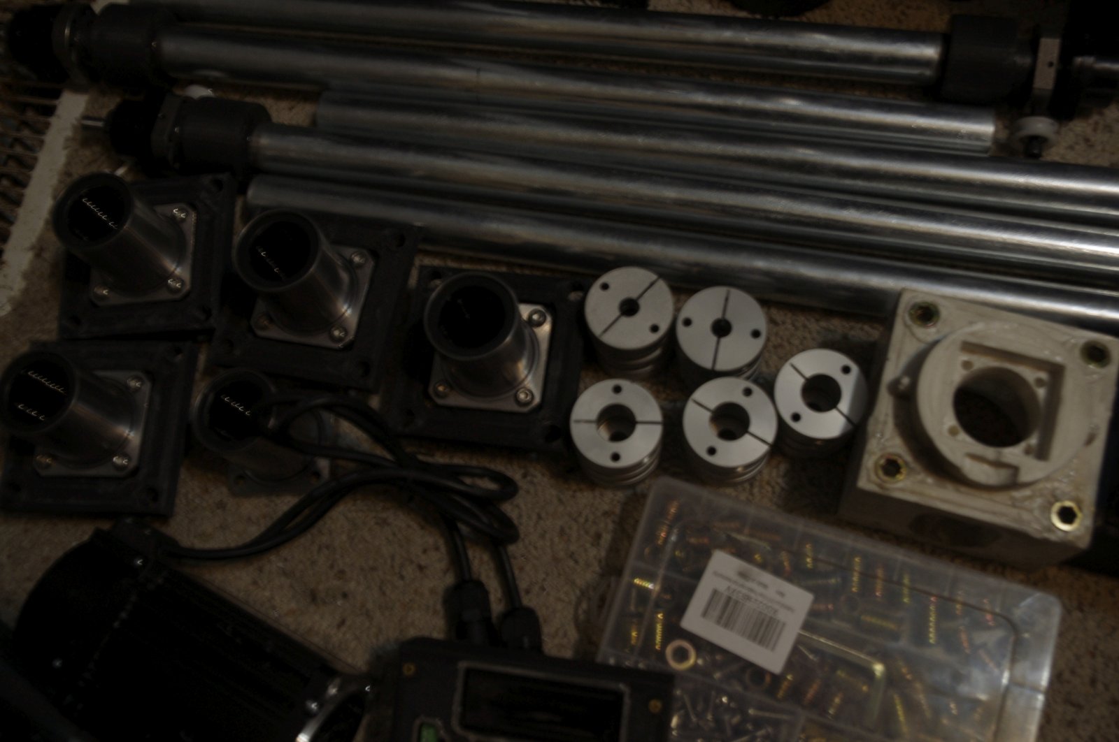

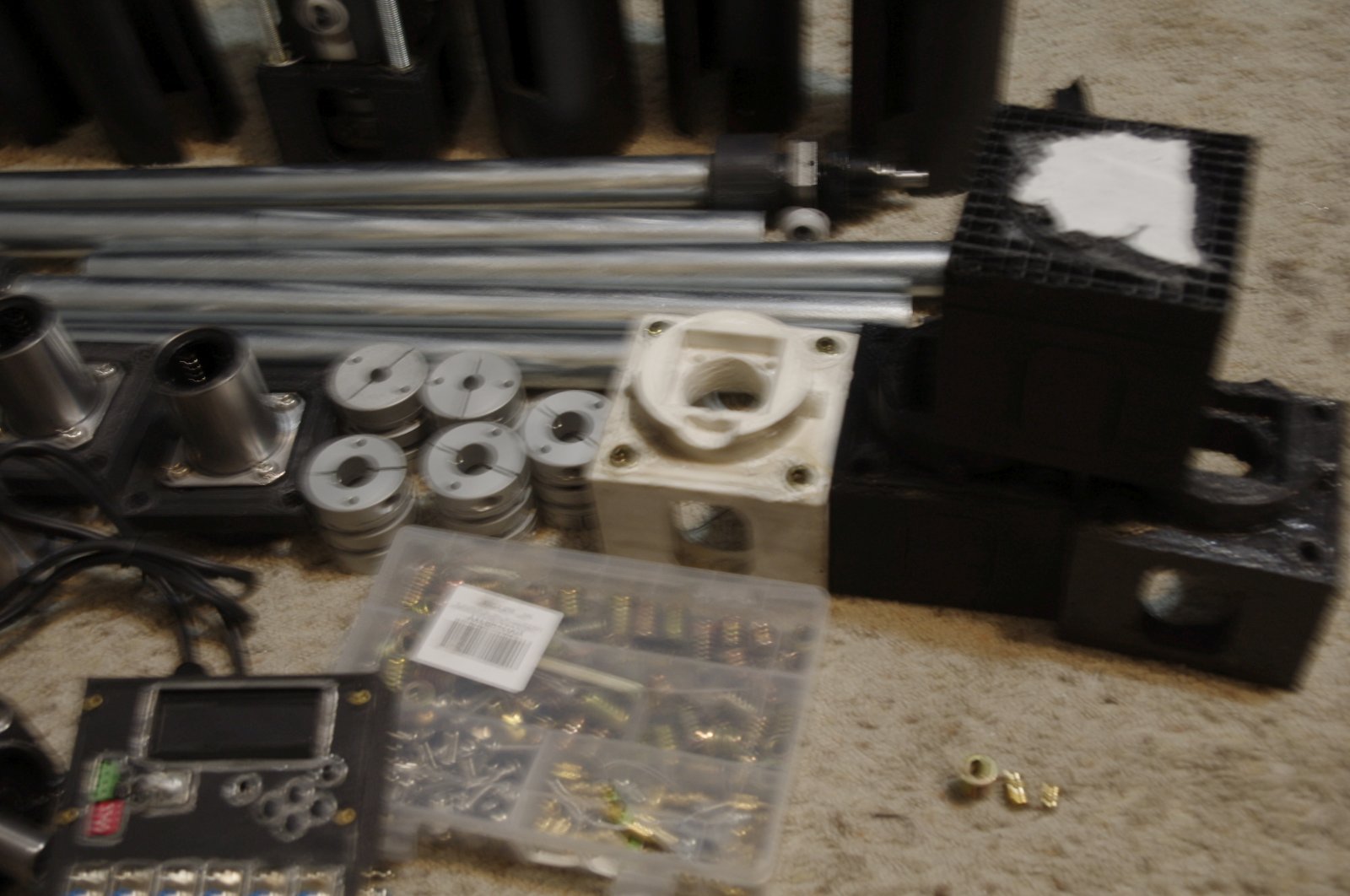

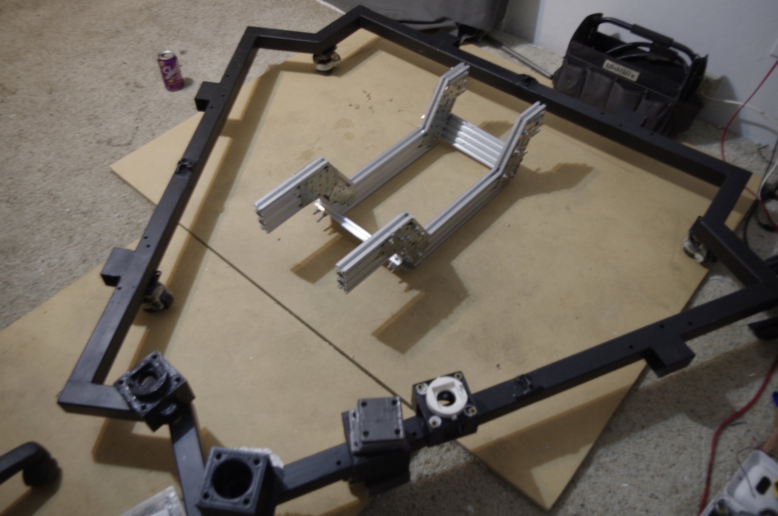

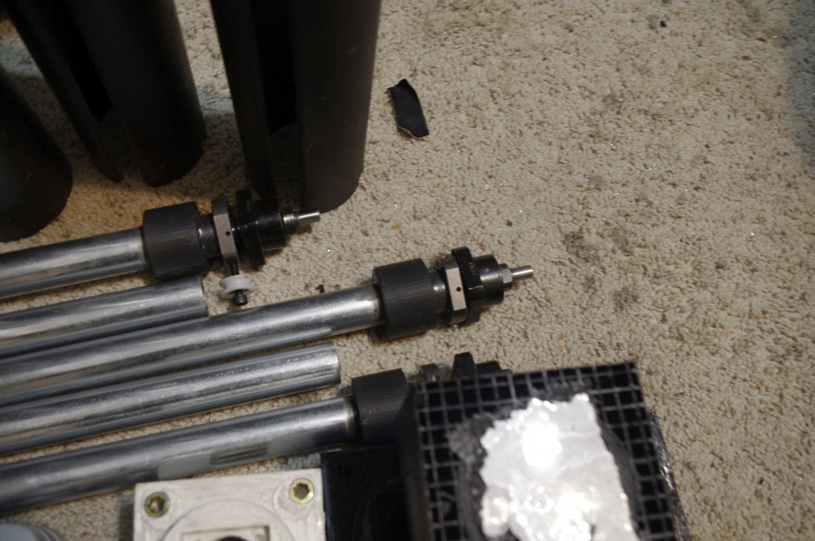

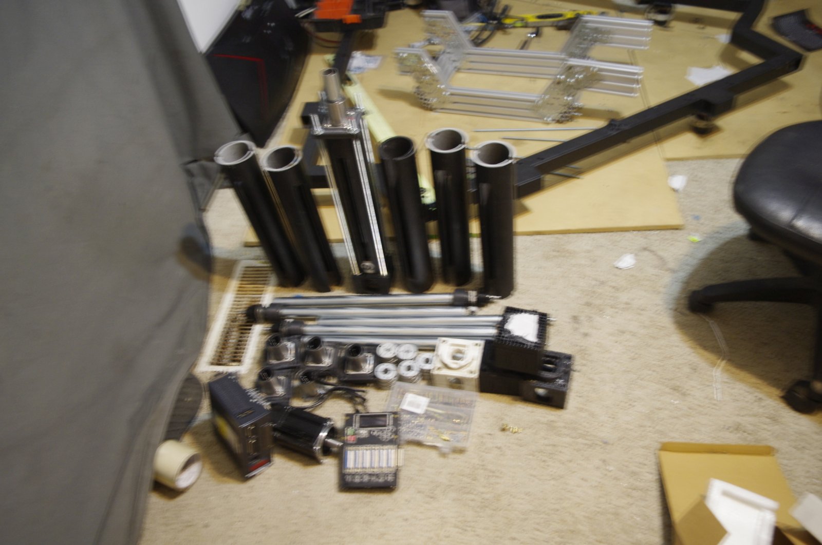

    Hey all. Its been a while since my last post. Ive been amassing parts for a new build.
    Base: 3 pcs 54" 2" square steel tubing cut at 60 degree angles
    6 pcs 10" 2" square steel tubing cut at 60 degree angles
    To make 120 degree sided triangle
    Platform: still a work in progress, dimensions tbd
    Actuators: 6 pcs 1605 500mm ballscrews: https://www.aliexpress.com/item/2255800936777386.html? spm=a2g0o.order_list.order_list_main.107.a5681802Sz7IDk
    6pcs shaft coupling: https://www.aliexpress.com/item/225....order_list.order_list_main.61.a5681802Sz7IDk
    1 lot closet rollers
    https://www.aliexpress.com/item/225....order_list.order_list_main.82.a5681802Sz7IDk
    6 pcs static ballscrew bearing: https://www.aliexpress.com/item/2255800723280532.html?
    spm=a2g0o.order_list.order_list_main.92.a5681802Sz7IDk
    6pcs linear bearing: Lmek30UU
    https://www.aliexpress.com/item/225...order_list.order_list_main.102.a5681802Sz7IDk

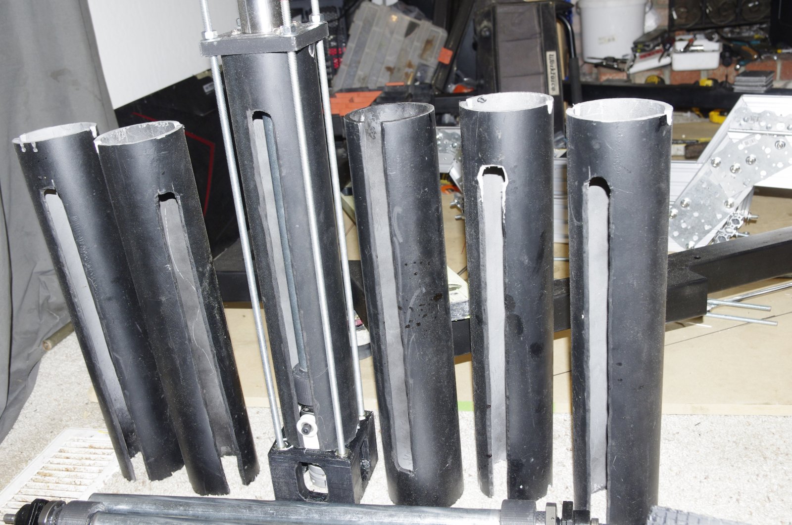

    6pcs. 6" plumbing pipe
    6pcs. 1" electrical conduit
    6pcs. 80ST-M02430 750W servo motors
    6pcs. AASD15 servo motor driver

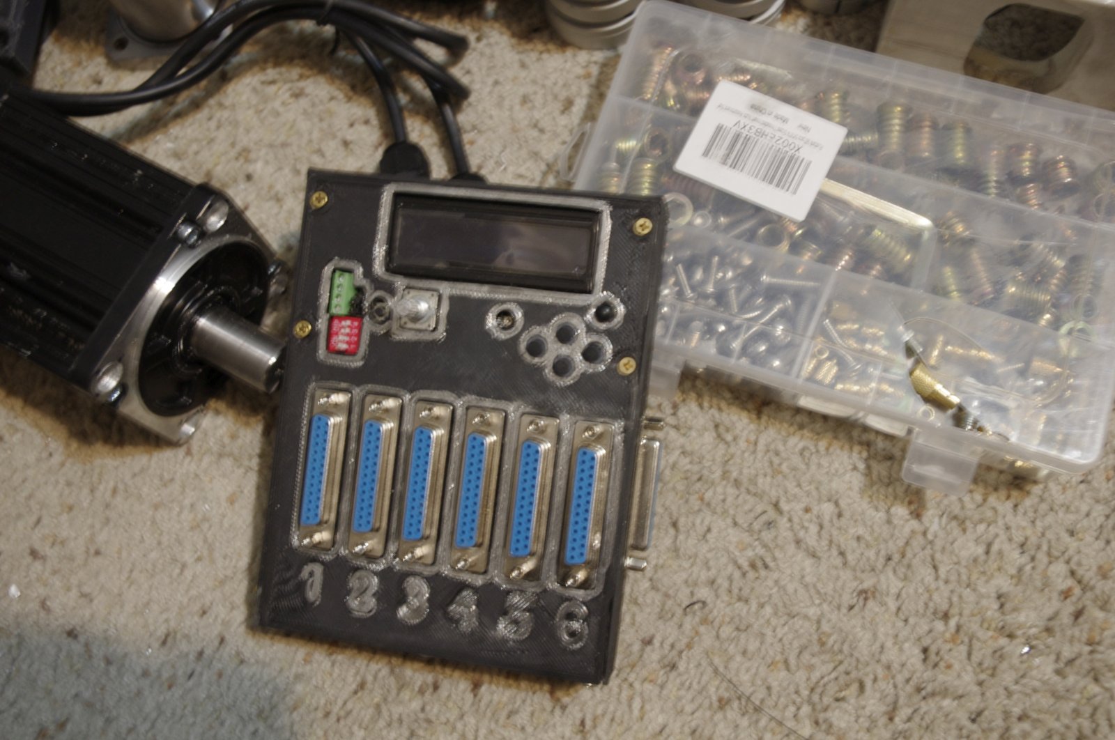

    1pcs. Thanos servo controller
    Actuator videos at the end of post. More videos to come
    _IGP6033.JPG _IGP6029.JPG _IGP6054.JPG _IGP6058.JPG _IGP6060.JPG _IGP6033.JPG _IGP6029.JPG _IGP6054.JPG _IGP6058.JPG _IGP6060.JPG _IGP6059.JPG _IGP6033.JPG _IGP6029.JPG _IGP6054.JPG _IGP6058.JPG _IGP6060.JPG _IGP6059.JPG _IGP6085.JPG _IGP6082.JPG _IGP6062.JPG _IGP6080.JPG _IGP6081.JPG _IGP6087.JPG

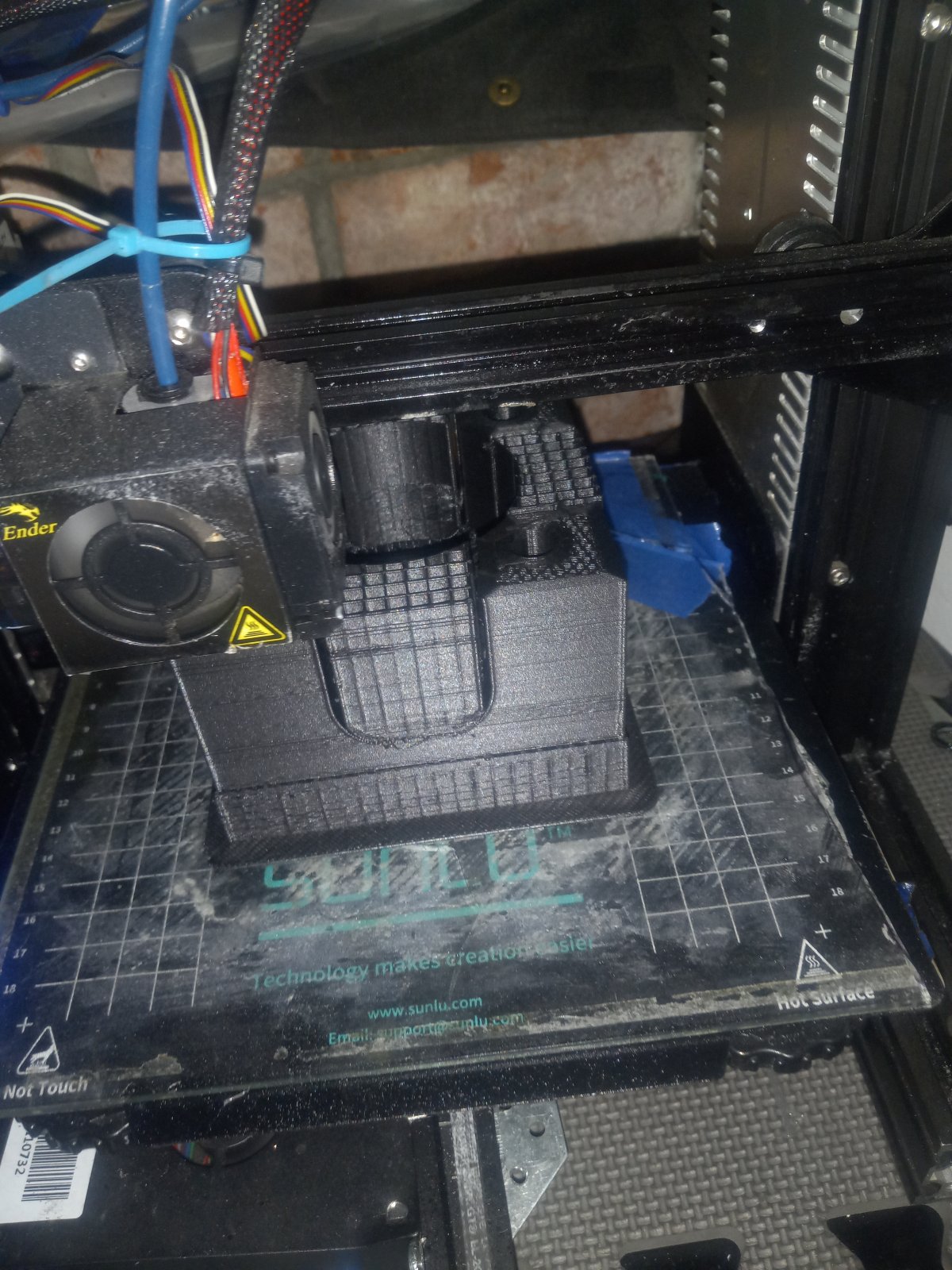

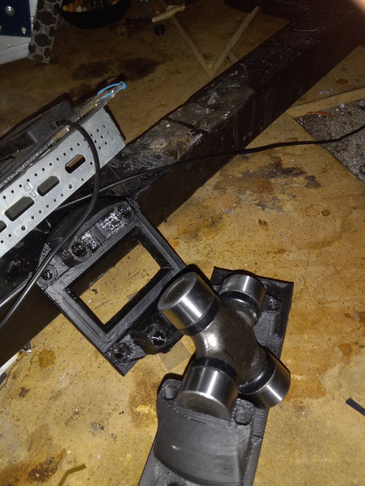

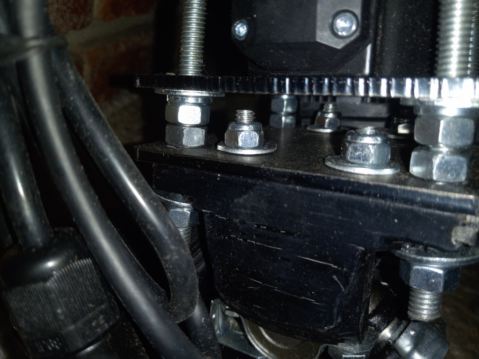

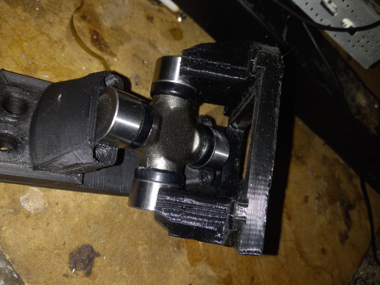

    I designed the U joints in ticker CAD and 3D printed them in carbon fiber PLA and the top pieces are in petg cuz I ran out of carbon fiber but the bottoms are carbon fiber pla the bolts go around the cross bearing through the mount and into the steel plate that mounts to another steel plate that connects to the actuator and the bottoms go around this prospering through the mount and into the middle of the base so triple redundancy bolted basically

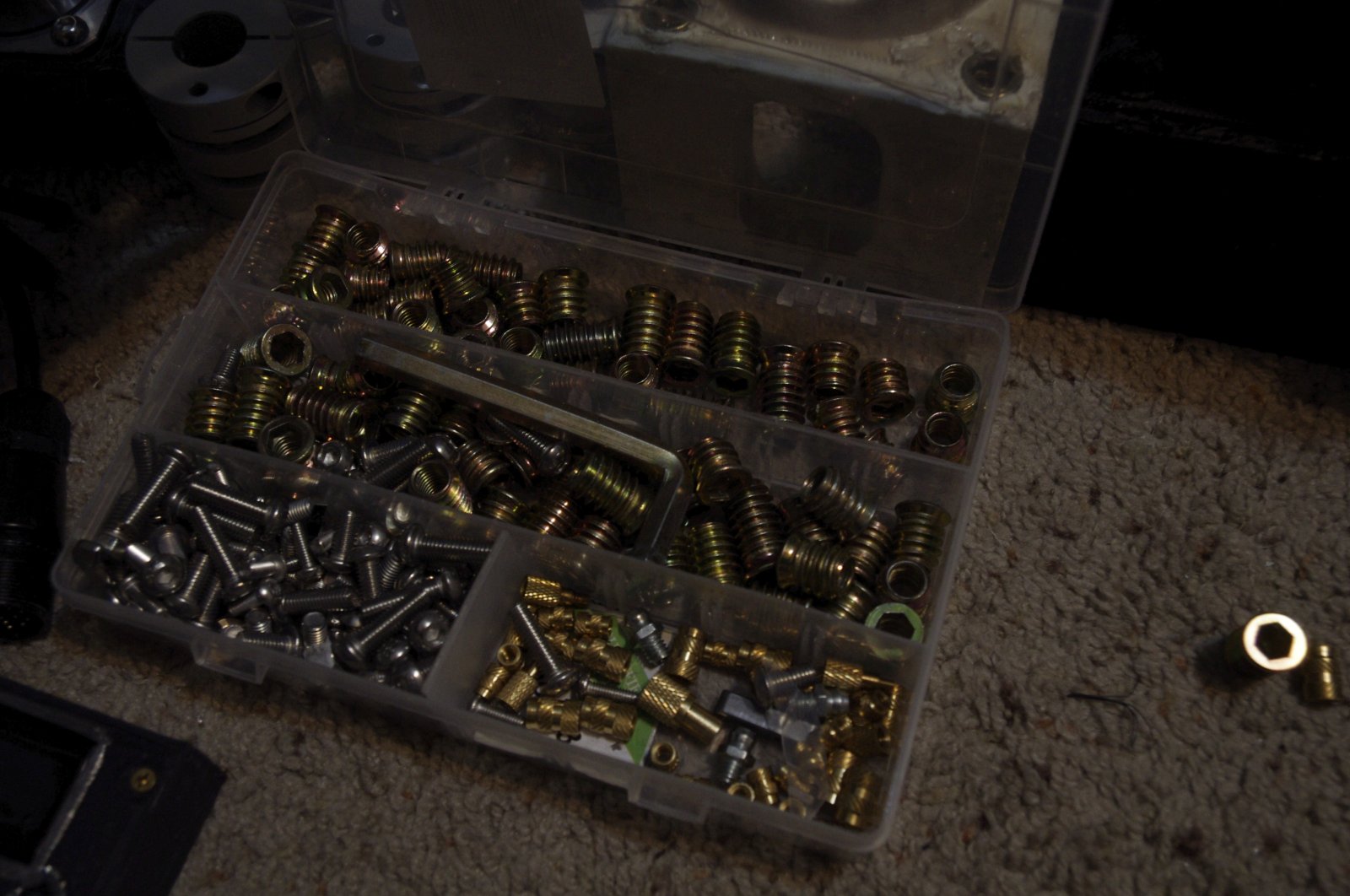

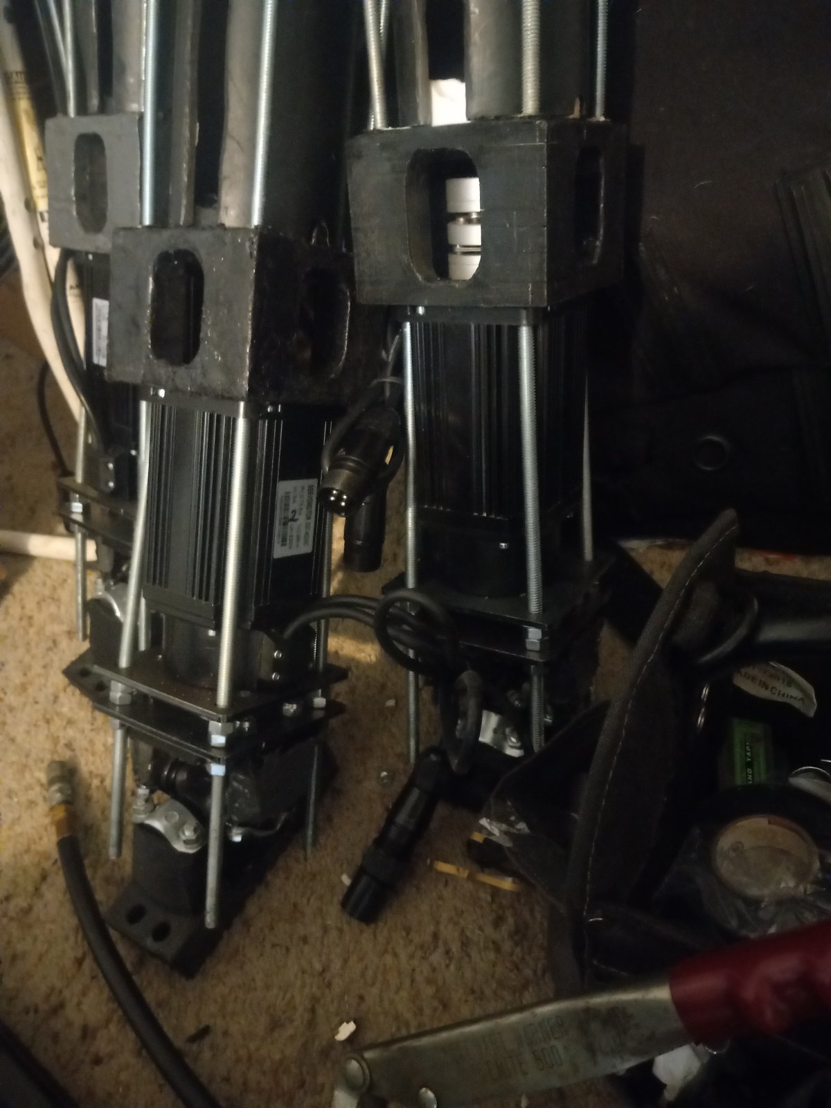

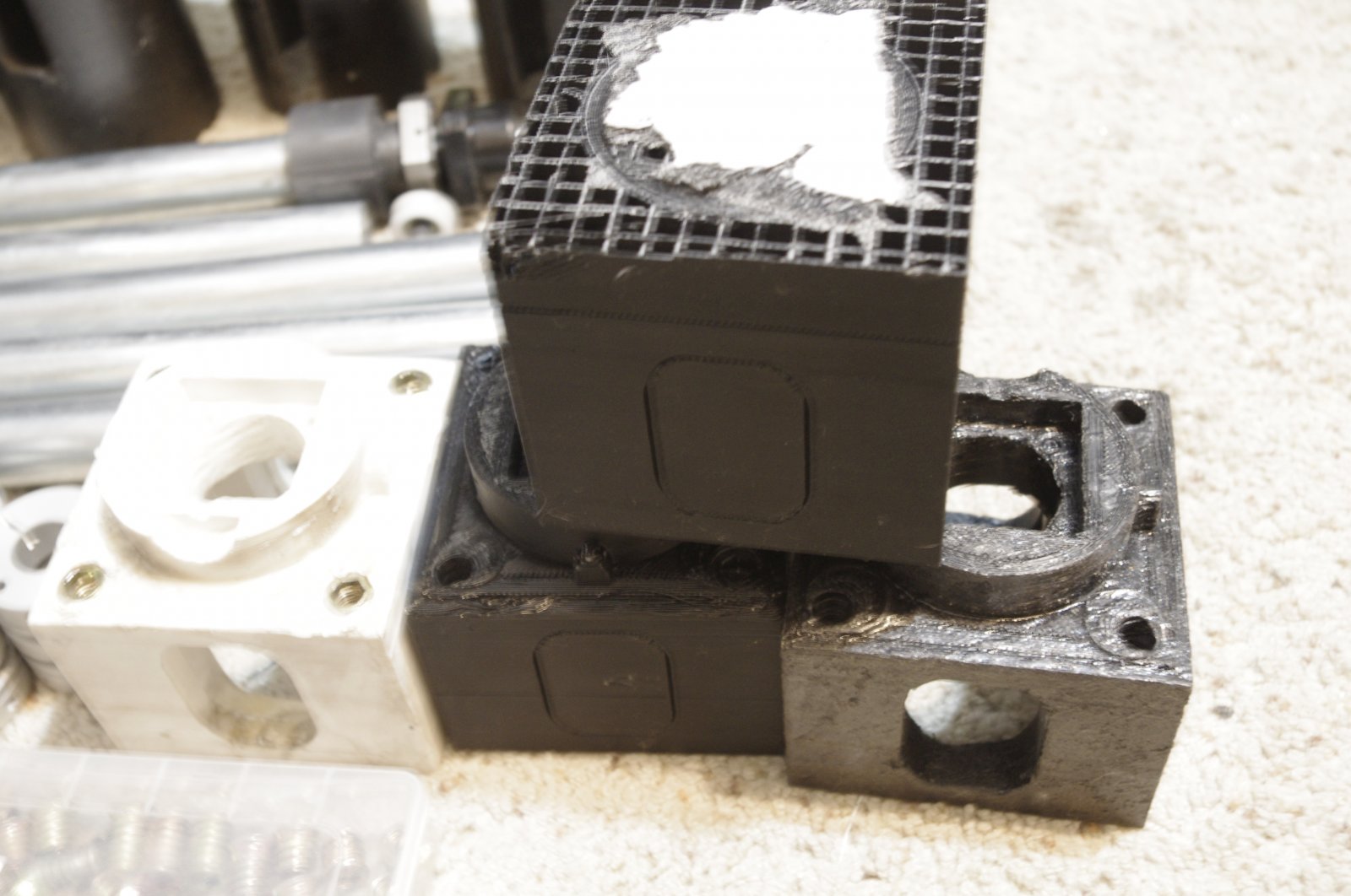

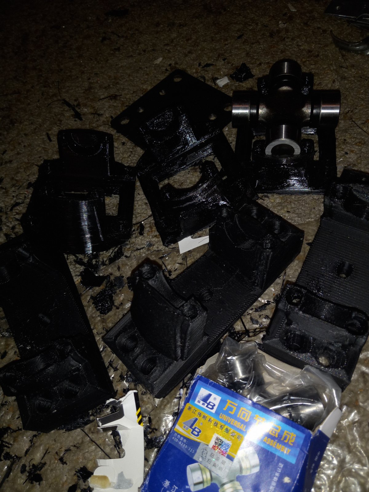

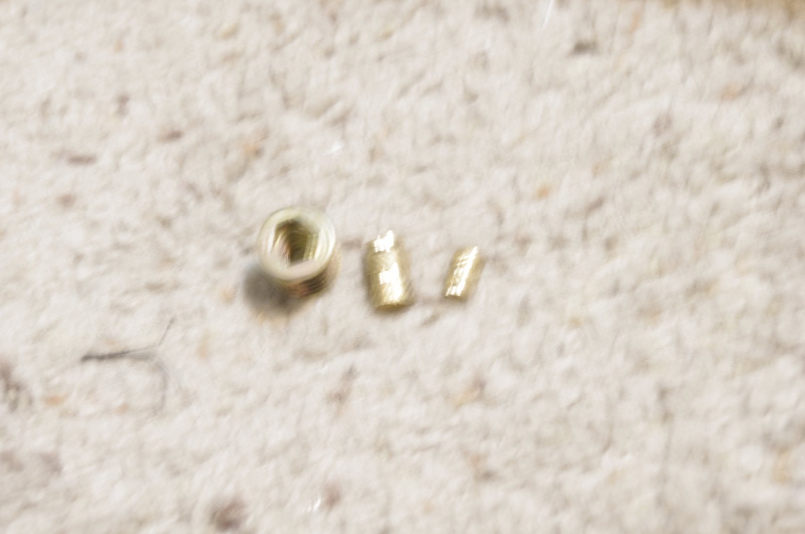

    Okay well as I've suspected. The ABS is completely the wrong material to use for the motor mounts. I couldn't even get my allthread into the thread inserts before splitting the motor mounts printed with abs, even at 80% infill. So like I recommended to start with I switched over to CARBON FIBER PETG ( CF PETG ). So I'm at a standstill until I print six new motor mounts which they're 24 hours a piece print time so that's another week I have to wait before I can Assemble.

    Yeah I'm pretty sure they will the carbon fiber pla is really really strong. I tried the carbon fiber PEtG, I don't know why people think that petg is so strong. It's brittle as hell is my experience I think the carbon fiber pla is way stronger. so I'm just going to go with that. Only problem is it's $30 a roll and I only get two motor mounts per roll so I need three roll so it's another $100. Lol

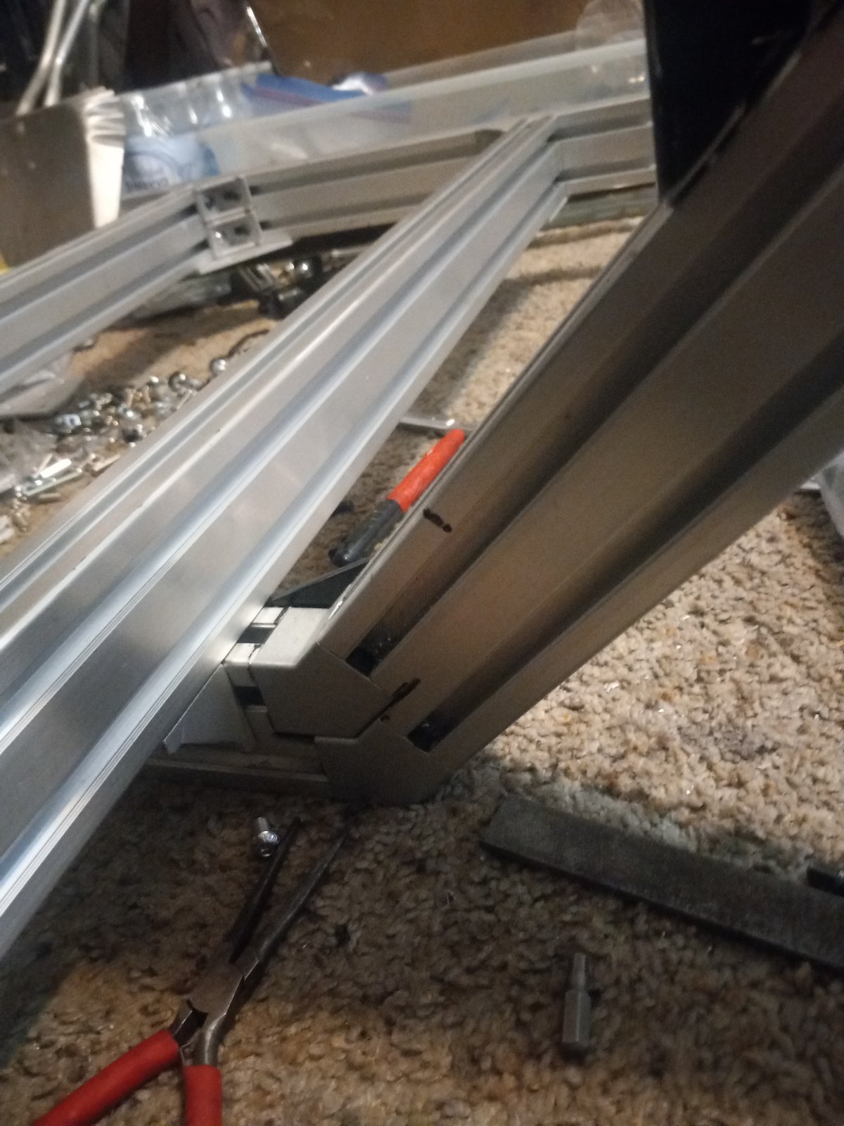

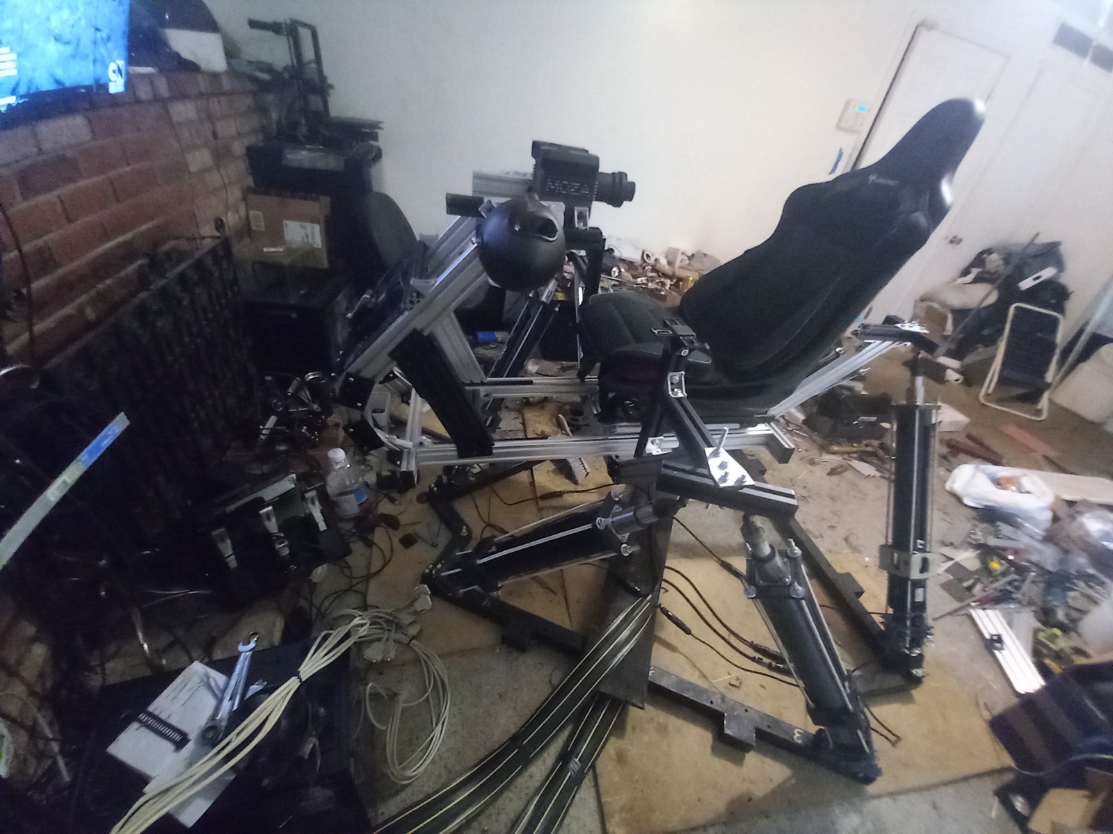

    Arduino, 6DOF

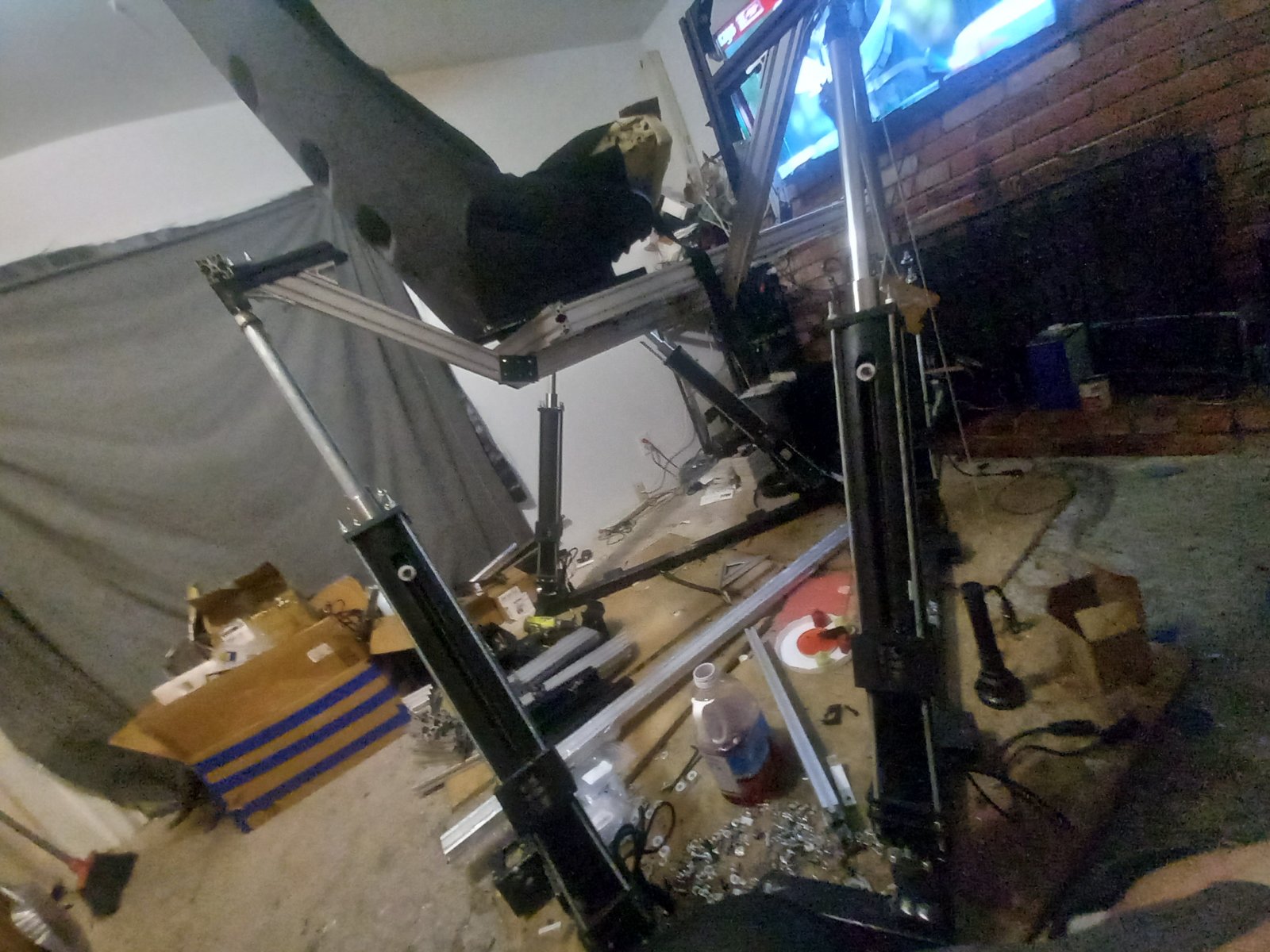

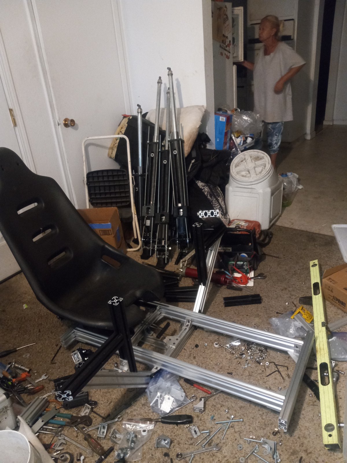

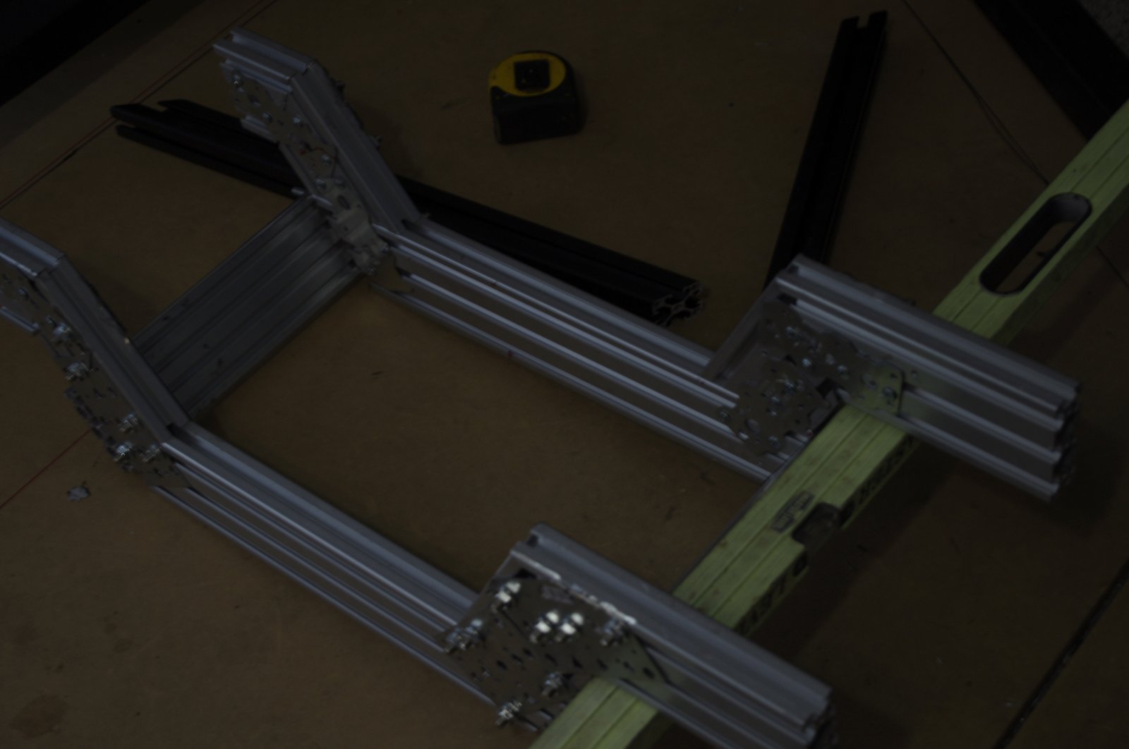

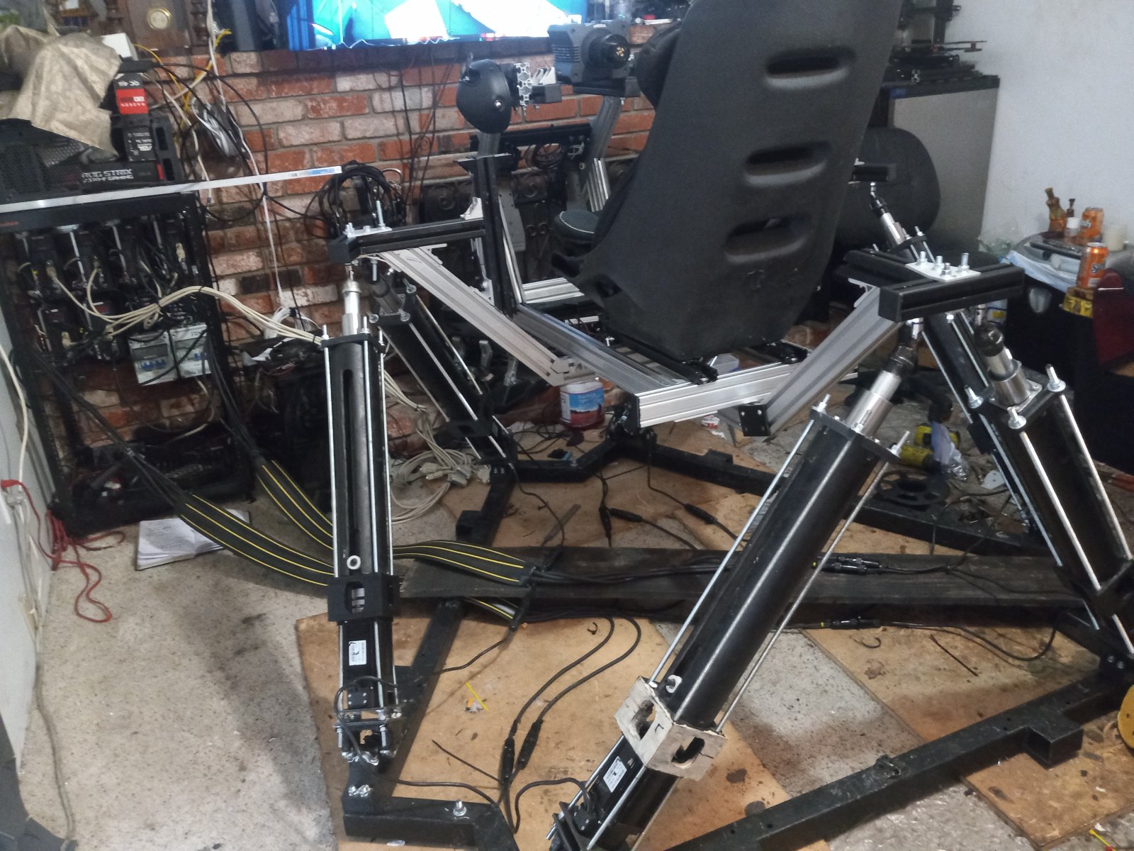

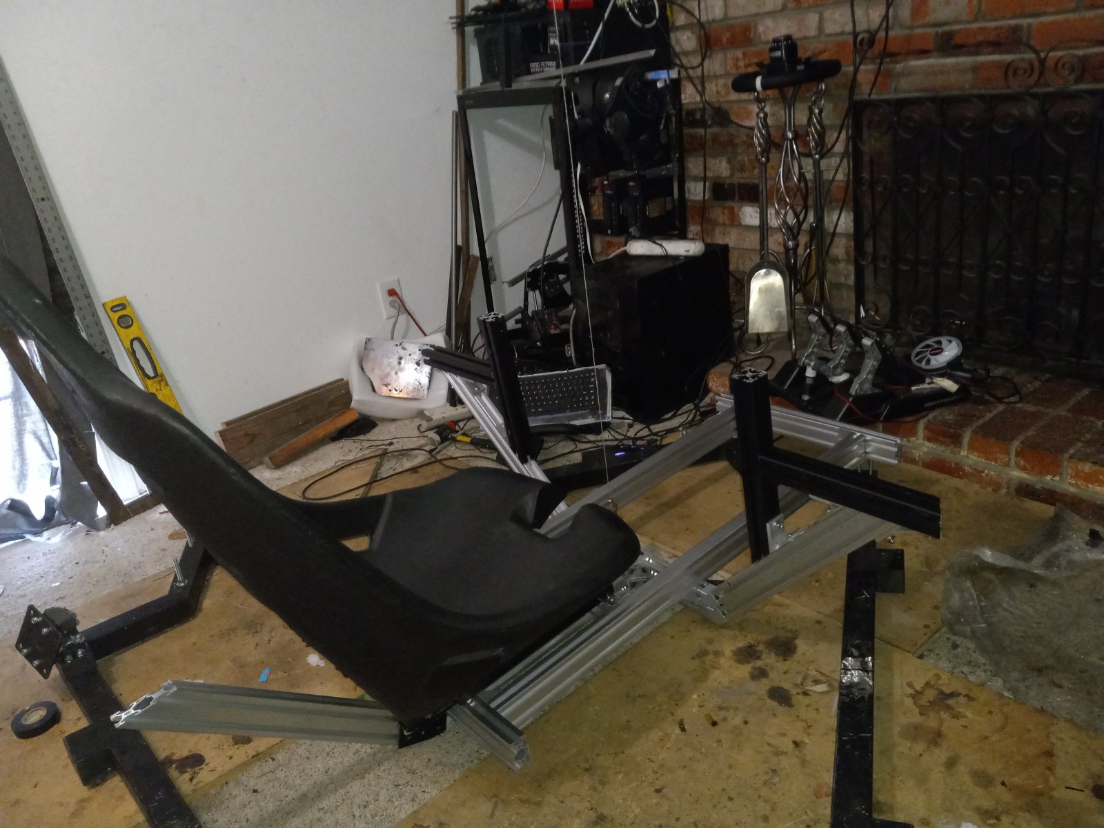

    Hey @noorbeast, do the proportions look close to workable? You have seen moore working rigs than me so your opinion on dimensions is valued. 20230813_165653.jpg 20230813_165603.jpg 20230813_165700.jpg 20230813_165653.jpg 20230813_165603.jpg 20230813_165700.jpg 20230813_165713.jpg

    Thats full extension
    21,511
    150,686Coins
    +11,018 / 55 / -2

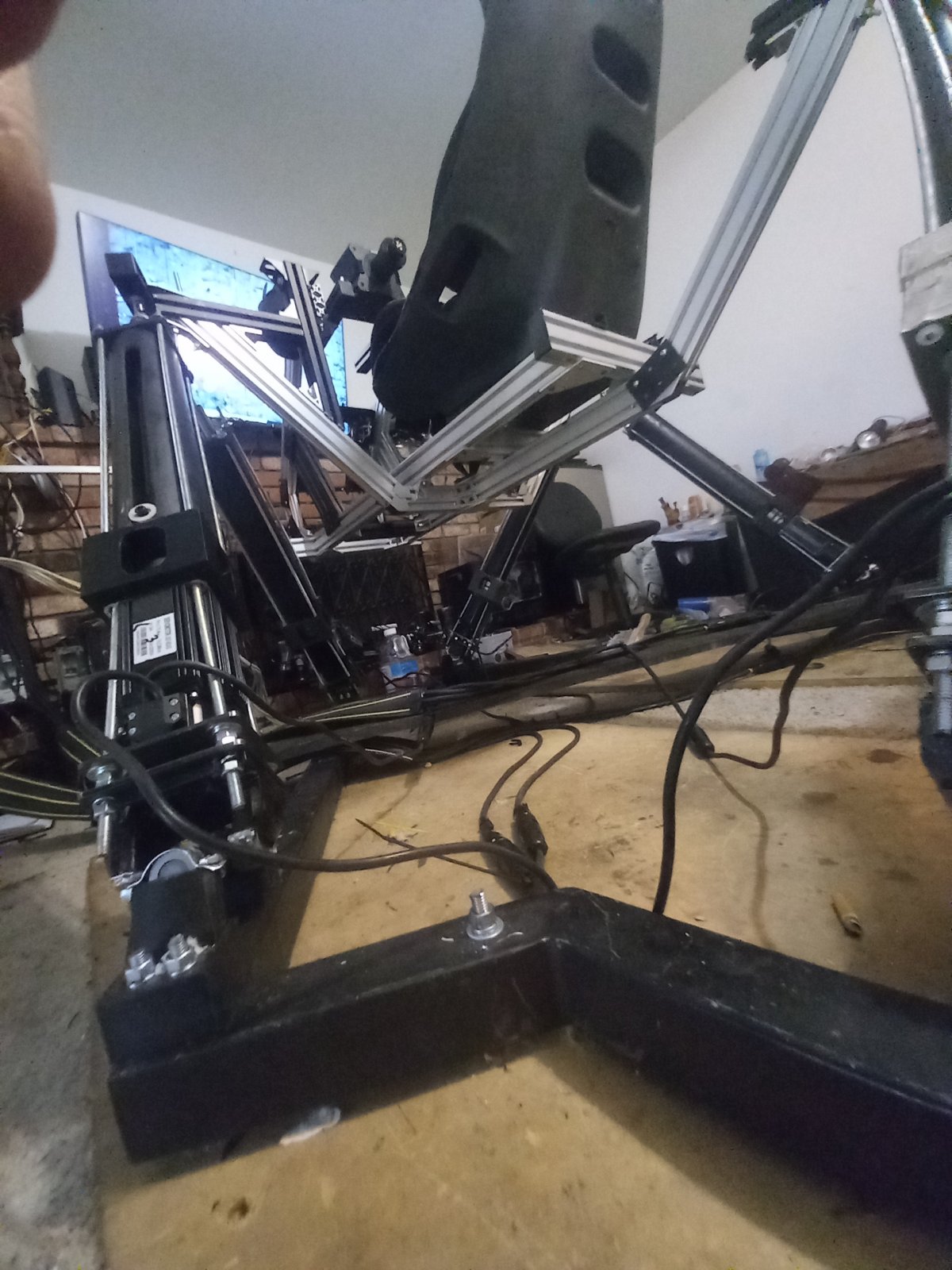

    I am genuinely curious as to what you expected?
    I can't tell the actual dimensions of the rig from some photos, which is far more significant for a 6DOF than say a 2DOF. Even in the case of the latter I often direct people building a basic 2DOF to tools like SimCalc, as even in those simple circumstances you can't really take more than a guess regarding the tradeoffs between design Vs physics.

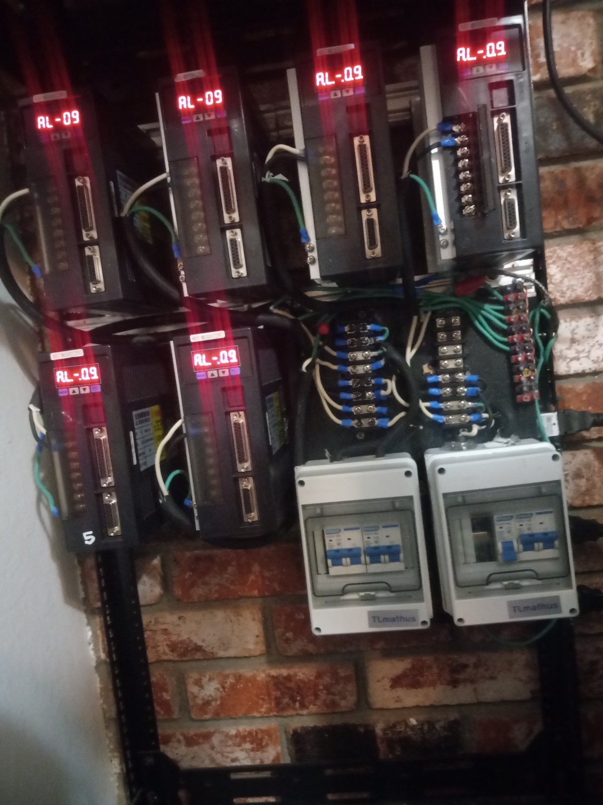

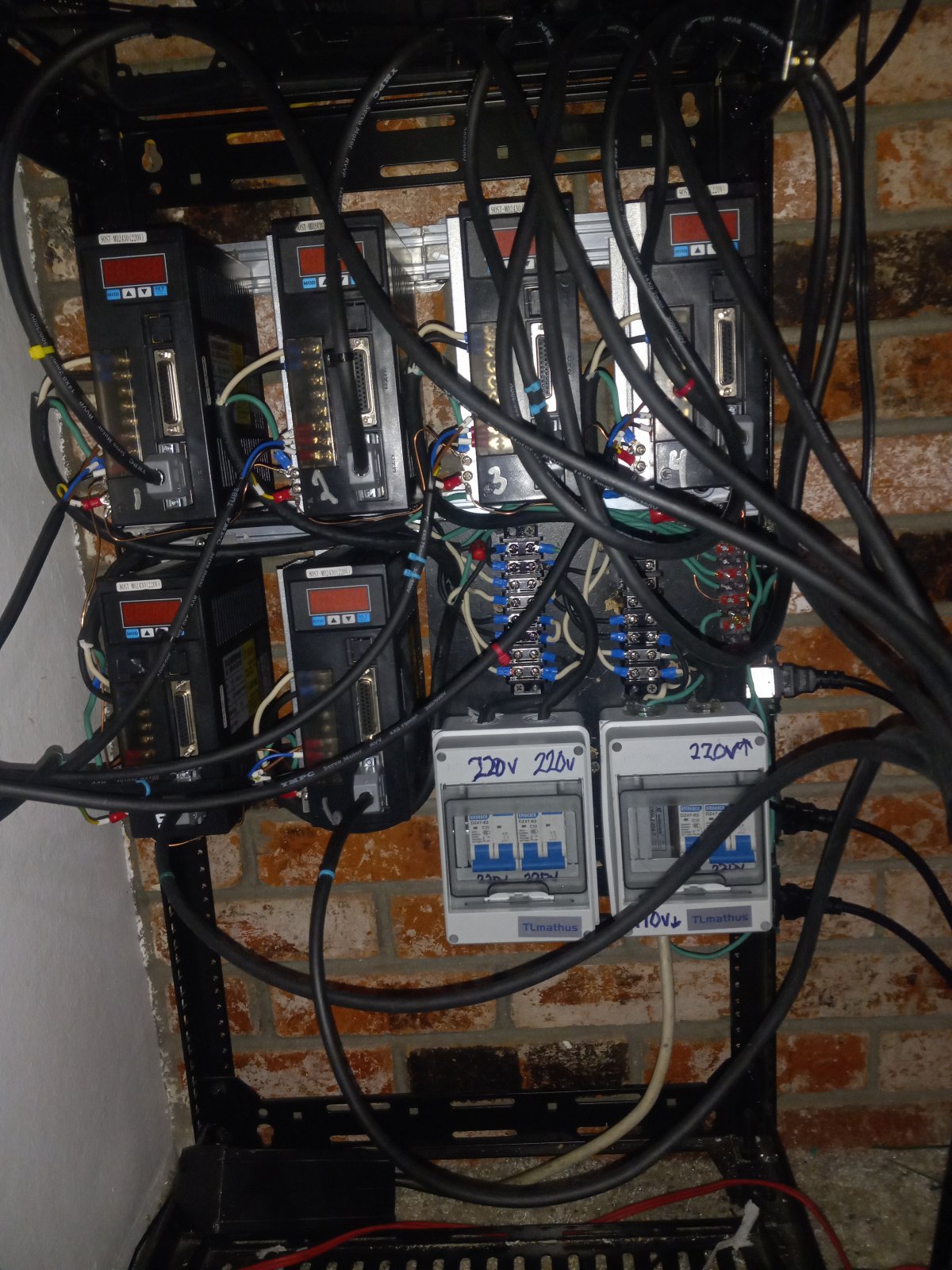

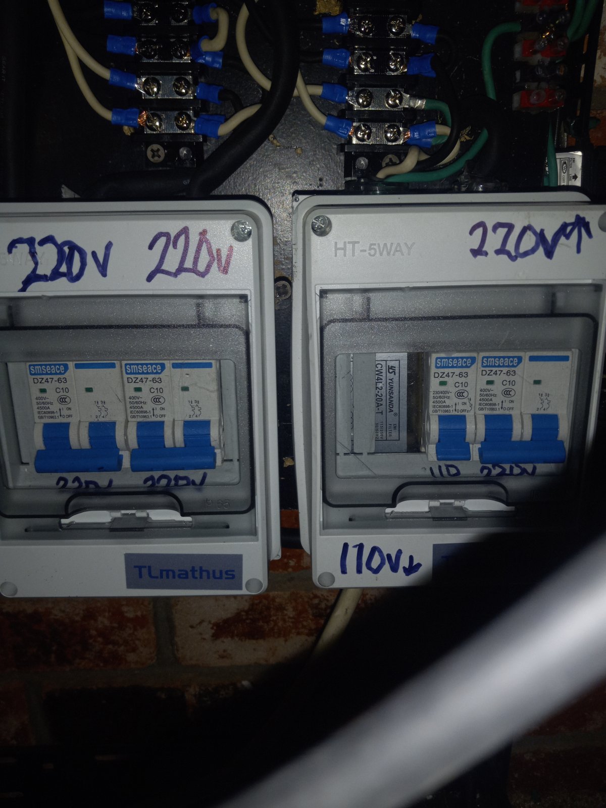

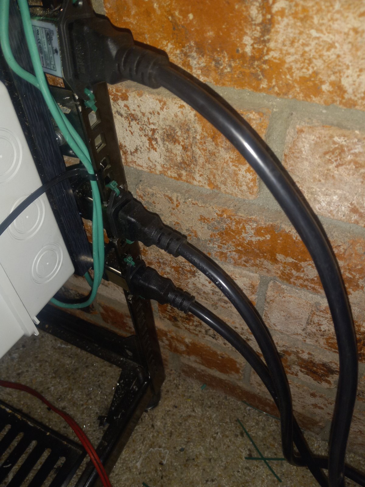

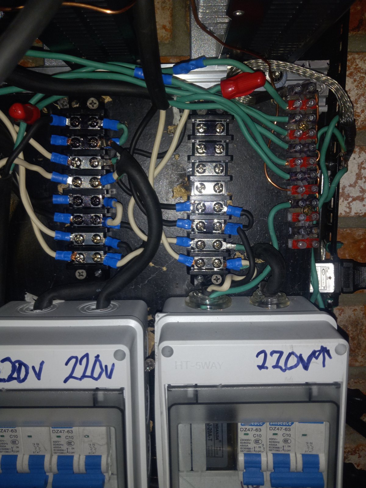

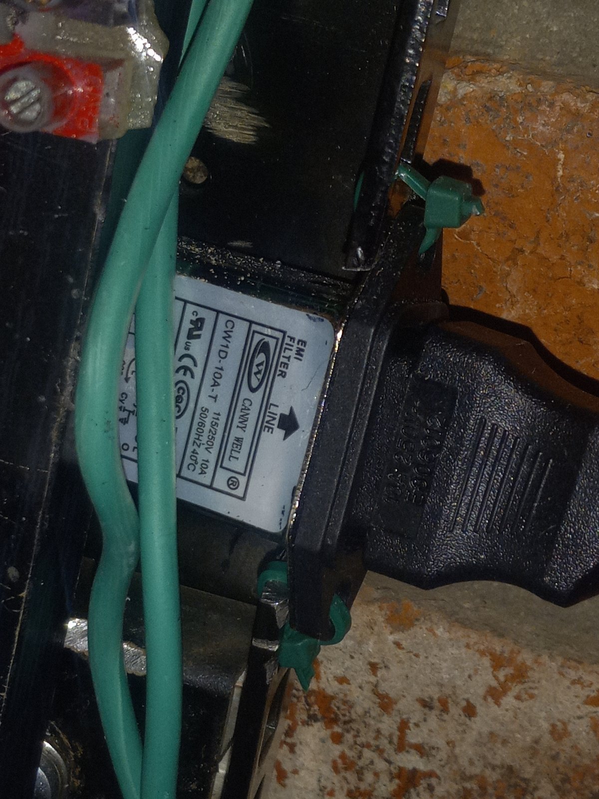

    The input 220v plugs on the side are each an EMI filter

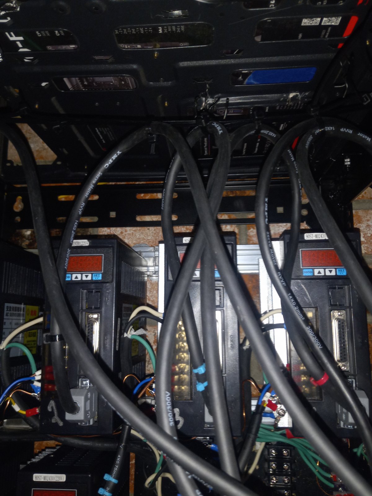

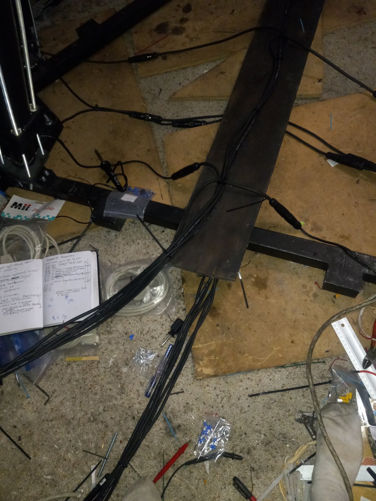

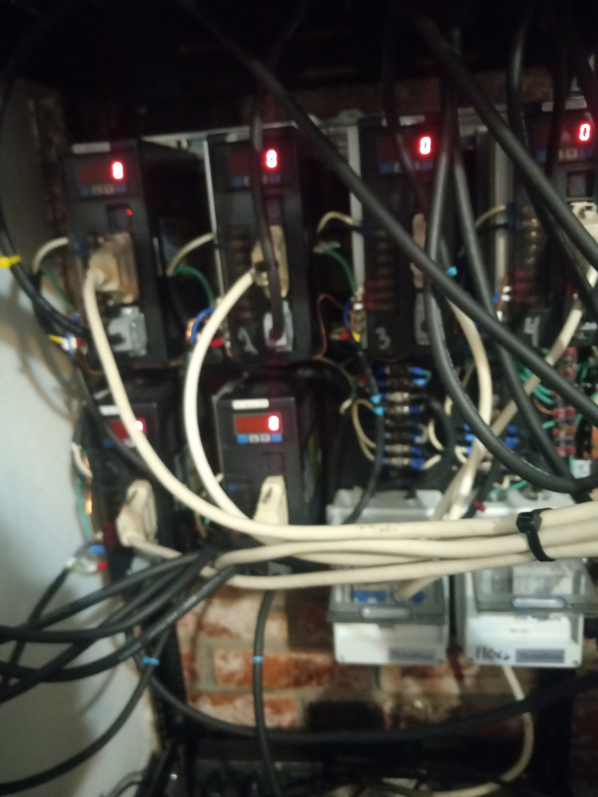

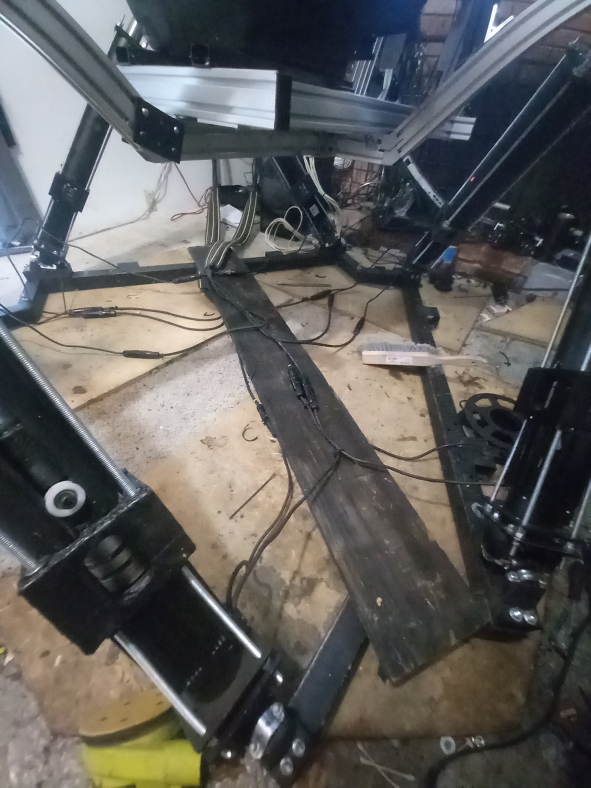

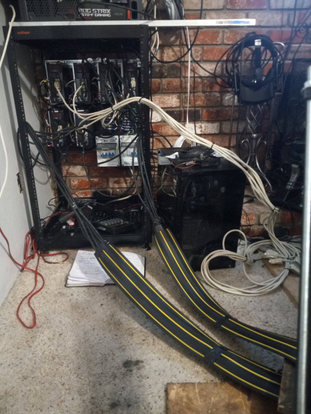

    Some more driver cabinet. The wires are hung that way in an effort to keep them separated to keep the power wires away from the encoder cables is why they're hung that way and not strapped down nice and neat and tidy

    I'm going to put power to it right now and I will upload a video to YouTube and post a link on here to update my progress thank you wish me luck.

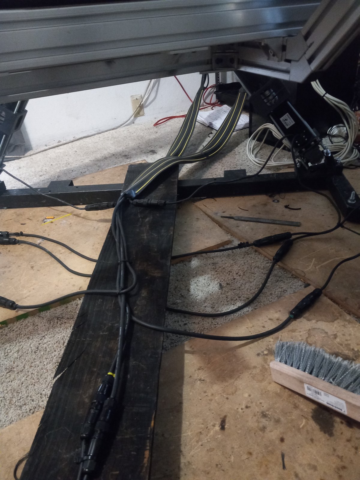

    Oh and PS the plank of wood in the middle of the Rig that the wires lay on. that's the only way I can think to separate the power wire from the encoder wires at the moment. until I come up with a better system that's what I had laying around the house. some of your thoughts on separating those two you bunches of wires in the middle of my my rig would be great if anyone has any thoughts u
