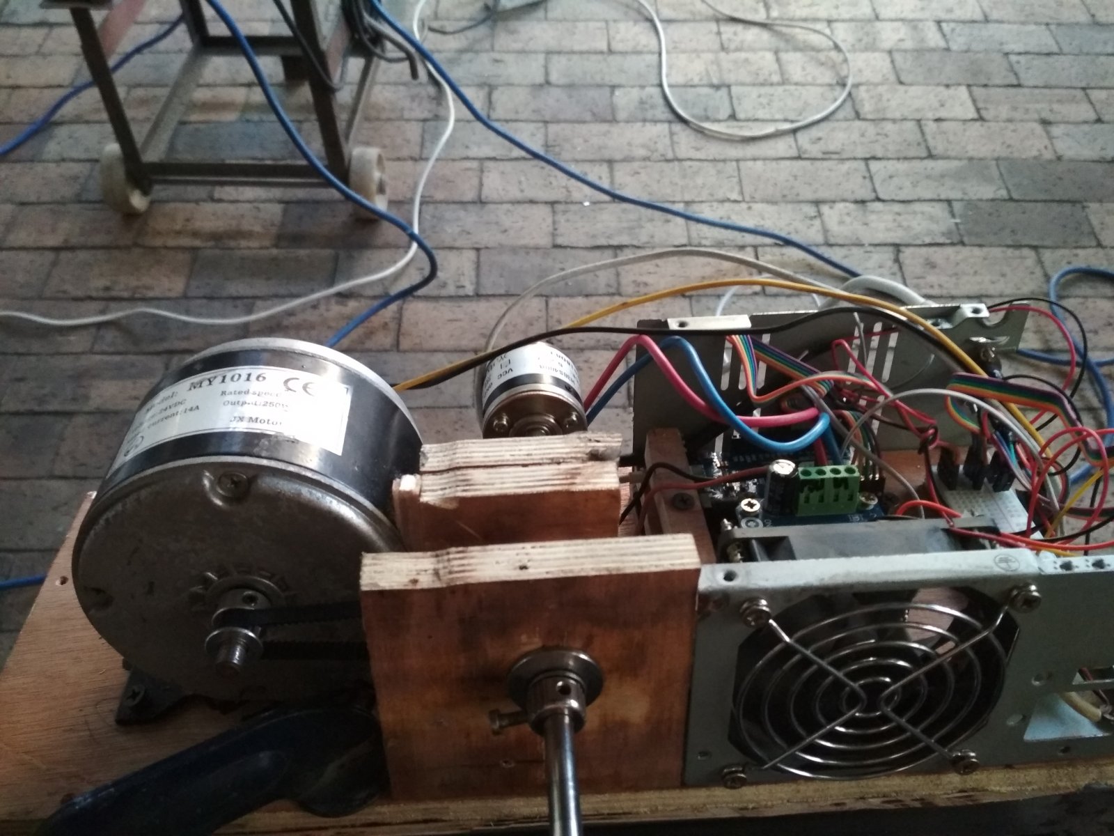

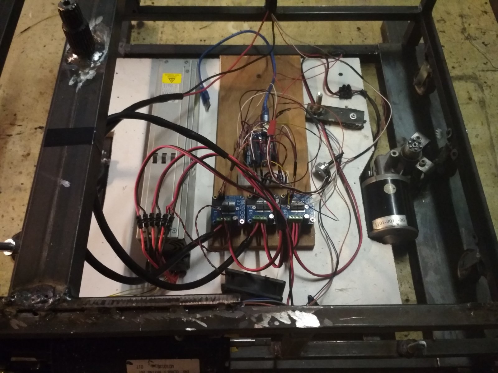

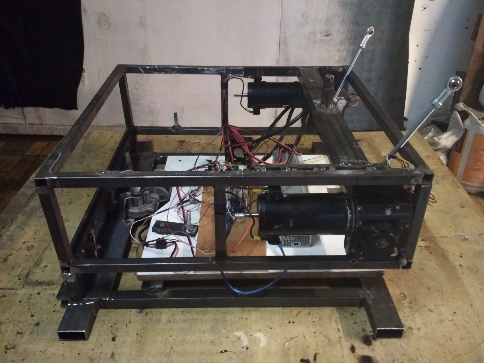

    Hi
    I'm using 2 wheelchair motors for the primary motion and a single garage door opener motor for the rear traction loss.
    BTS motor controller and Arduino UNO. 500w 47A server PSU. My FFB steering wheel is a DIY set-up comprising of a Arduino and BTS and a MY1016 250w motor. My wheel rim is a 350mm Chinese copy of the MOMO steering wheel. The pedal set is also DIY made fro aluminum square tubes and some m12 threaded bar.
