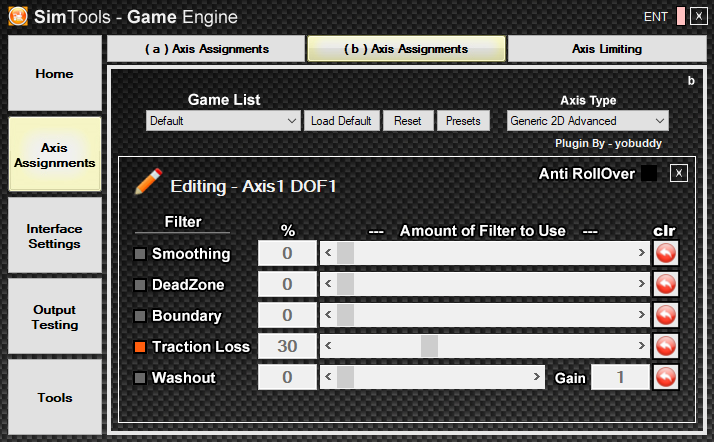

    I have recently added a Sway/Surge to my system.
    I needed to make the actuator go back slowly to the middle after an acceleration.
    So I use the Gain/Washout.
    Technically it worked but with 1 major issue and I wanted to know if it is a possible bug or me not understanding something.
    I found out when Playing project cars for example it won't recenter the actuator slowly as expected unless the telemetry value stop changing.
    Example: Let say I turned a corner, my actuator is fully extended. Now I'm racing straight ahead.
    Normally I would expect the actuator to retract slowly but it is not.
    BUT
    If I pause the game (ESC) the telemetry value coming from the game stop updating and stay *frozen* on the same number. THEN my actuator is now finally starting to move back to center.
    Any clues? Smell like some bug for me as this kinda make the washout unusable.

    My guess is that while you are straight ahead the parameters of Gain/Washout continue to apply to any sway/surge telemetry that is above the washout return rate. Likely what may help is a boundary parameter, though @yobuddy would be better placed to advise.
  3. yobuddy
    5,381
    50,359Coins
    +5,152 / 18 / -0
    Sounds like you want the Traction Loss filter.
    Give it a shot and see what you think.

    Hum, not sure what simtools settings you are talking about. Are you talking about the telemetry from the game?
    Thanks , will give it a shot.
    Also, I may not have been precise enough, the "gain" does work, it's the "return" value not working as expected.

    "Hum, not sure what simtools settings you are talking about. Are you talking about the telemetry from the game?"
    See below buddy...

    Strange, I don't have this option. I'm on V 2.4 (latest I think)
    Edit: Fresh install on another computer and I can see them, Maybe something went wrong when I'm restoring configuration backup, I'll investigate.
    Edit2: my backup had the plugin for the axis assignment, so When I reinstall simtool I overwrite with some old plugin :eek:
    Will test with "current" plugin and report back.
    Thanks again may never have seen this out on my own without that screenshot of yours !
    EDIT3 : Things seems quite different now.
    Before I was able to prevent my linear actuator going back into the middle position, when the telemetry data was returning to 0, when I used the Gain/return setting.
    But now, either with traction loss or the Washout/gain this is not happening.
    Any idea how I can get this "feature" back?
    Also, traction loss does nothing for me if gain = 1. But gain is forced to 1 when traction loss is active and had to edit the XMLs to make it 0 and having the effect working.
