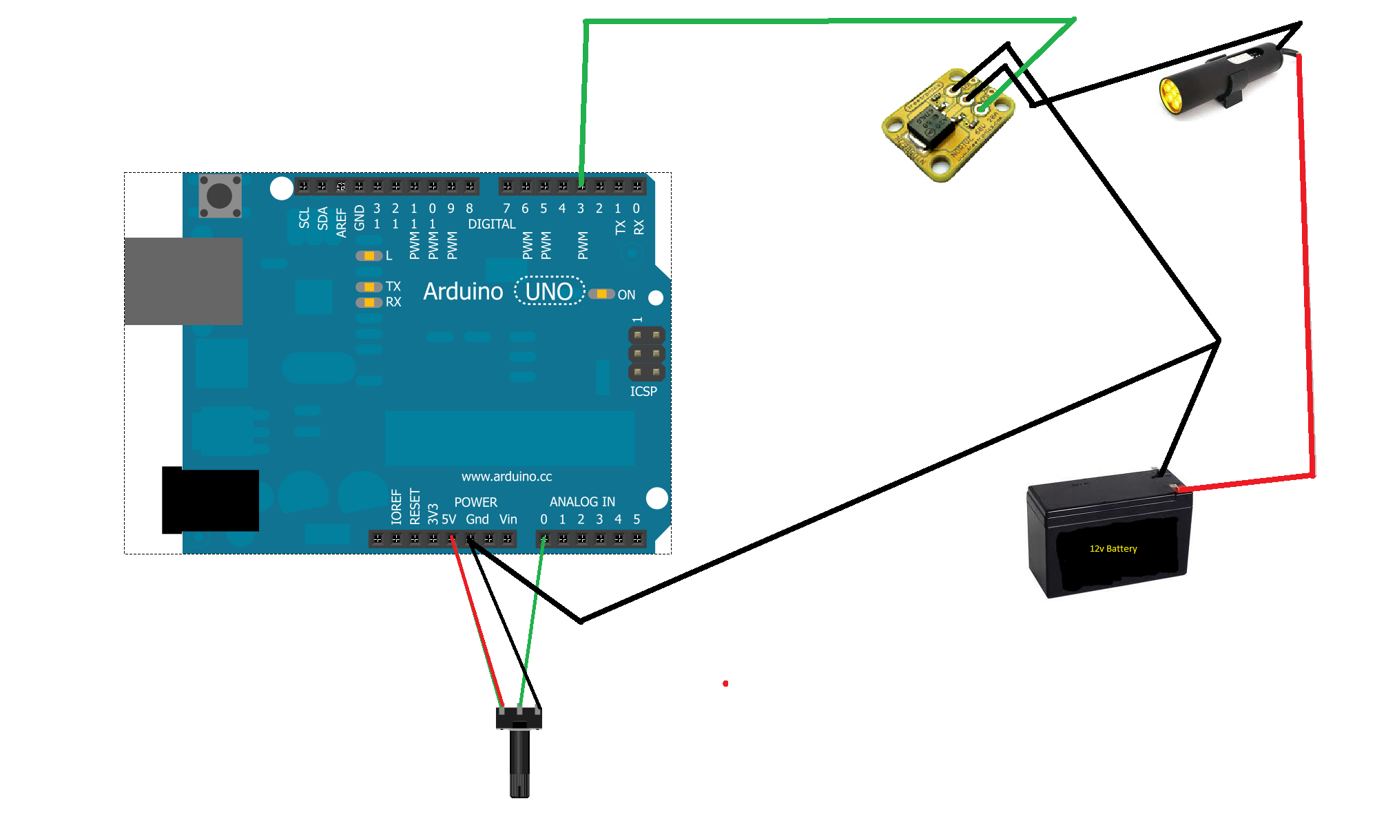

    Ok what is needed to build what you want,
    Me I would use:
    1x Freetronics Eleven or an Arduino Uno R3 - Jaycar - http://www.jaycar.com.au/productView.asp?ID=XC4210
    1x 10k single turn pot.
    1x Freetronics N-MOSFET Driver & Output Module - Jaycar - http://www.jaycar.com.au/productView.asp?ID=XC4244
    1x patching wire to connect everything.
    1x Cars Taco shift light , or a light to be driven, 20amps at 12v max.
    Basically the circuit that is needed to be created will have the pot connecting to a 5v,gnd,analog input , this will control at what rpm the shift light will engage on. Secondly the N - Mosfet will driven high from the Arduino and be connected to a 12v source up to 20amps and have its output connect to a std shift light stick from a taco. If wiring diagram is needed just ask, will post and as soon as this becomes an option in the new software, I can generate some basic code.
    No worries.

  13. eaorobbie
    20,506Coins
    +1,687 / 23 / -2
    Heres a basic diagram just need to actual wire and test myself but awaiting for the new update to complete, and test my theory.
    Note Draft untested, at your own risk. Until I can test or someone confirms. Thanks.
    In turn I feel a better option would be to use 15nb pvc pipe as a shift light tub and place 3 leds in the nose to the desired colour and a simple end cap on the other end, with resistors wired in series with the leds this should not require the n drive to run it.
    And thinking out of the square, RGB Leds could be used and driven with a pwm pin we can then have 3 separate stage lights like green for start of shift, blue for the exact rpm to shift on and red ya gone to far shift or blow the motor.
    Mmmmm , yes need to add this to my dashboard.

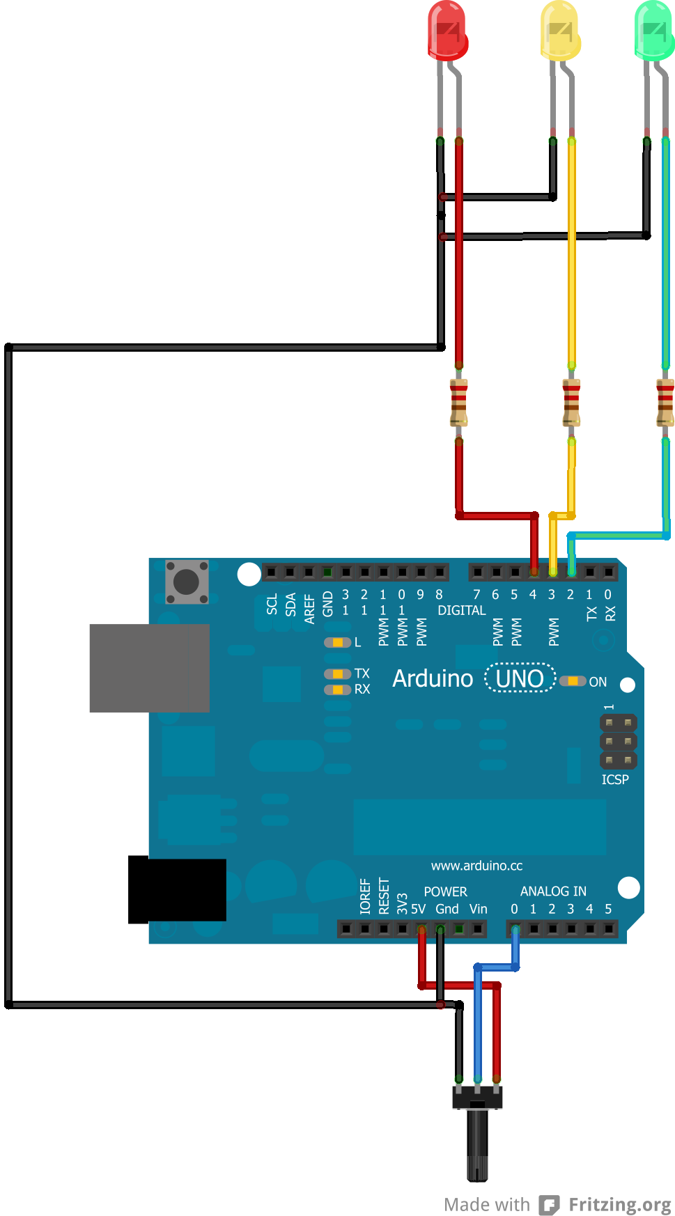

  14. bsft
    ok i got the bits for normal led use, so what do i wire up please?
    3 leds, green, yellow and red.

  17. eaorobbie
    20,506Coins
    +1,687 / 23 / -2
    Ok so from what you see above , I propose using 3 leds to control the point you wish to shift at, feel free to change colours.
    A pot is used on an Analog pin to control the rev amount that you want to trigger the leds.
    Aim is to use the green as a get ready and have yellow change with another 100 rpm then red when its 250 rpm past.
    And have the pot be able to change the magic number for an adjustable shift change.
    If you or anyone require something else, just post away.

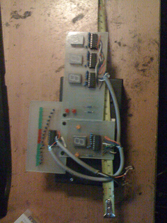

    Just bringing this up, would it be possible to put say 12 LED's in there say 8 green and 4 red, and have them light up in a line, like an F1 steering wheel Rev counter ?
  20. eaorobbie
    20,506Coins
    +1,687 / 23 / -2
    Yep can be done, you can string them together with a couple of shift registors and then from a 3 wire connection control the leds, with Revs from GameDash.
    So yea possible.
    For example a DIY Dash that I built ages ago and now have running under GameDash.
