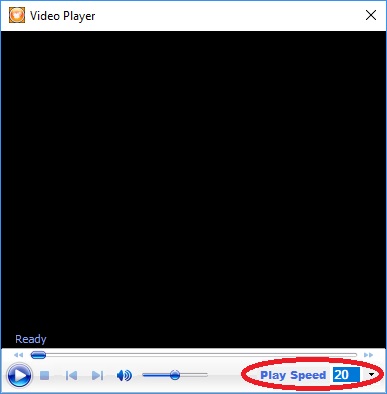

    First, open your video file and adjust the play speed of the file. (all files I have tried work except for .mpg’s)
    Set the play speed to something you can actually keep up with. (I suggest 20% to start with.)

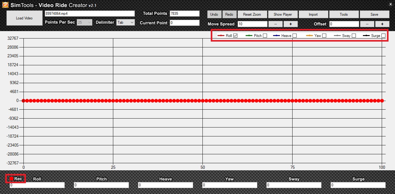

    Now select which input you will record first and deselect all the other telemetry points so you can clearly see what is happening.
    Once you have de-selected all but one telemetry line, press the REC button in the bottom left of the screen.

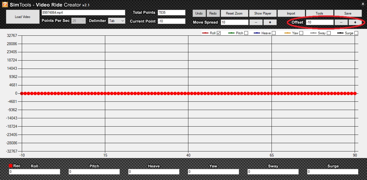

    If you wish to actually see a bit of the line you are drawing while the video is being played you can adjust the offset during the recording like so.
    (But be sure to set the offset back before saving the file!)
