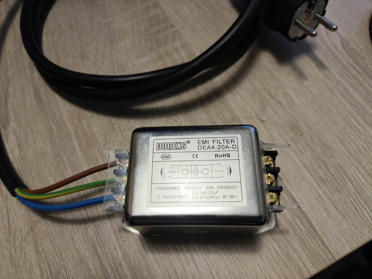

    Grounded everything, installed expensive EMI filter, installed ferrite rings everywhere, installed expensive Brennenstuhl brand power strips with RFI/EMI filters, NOTHING HELPED!!

    EMI filter:

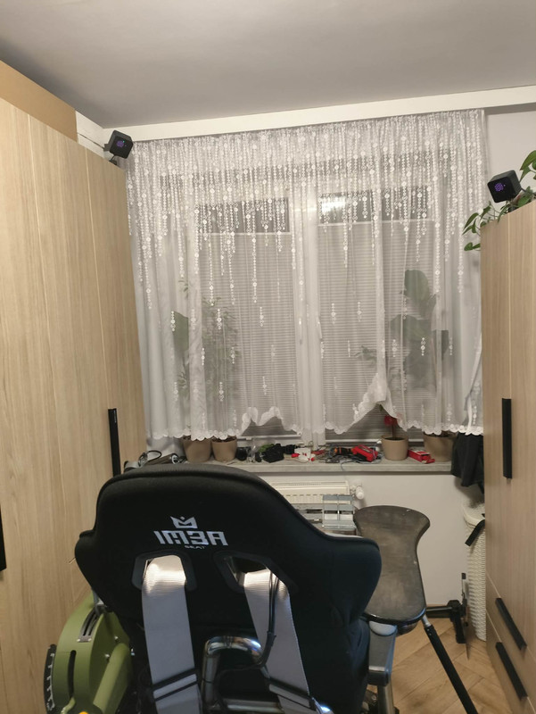

    Have you tried a solid window curtain?
    I say that because while EMF can be an issue, so too can any sort of reflective surface.
    It is an easy test, just temporarily hang some solid material like a towel.
  3. TheTakerPL
    TheTakerPL Member
    Dec 7, 2023
    33
    208Coins
    +32 / 0 / -0
    Covered, and nothing changed
    22,019
    153,710Coins
    +11,148 / 57 / -2
    The pretty much confirmed EMF or occlusion.
    Loss of tracking when using your hand to adjust the HMD is likely sensitive occlusion.
    Have you tried the base stations on the shelf just in front of the rig.

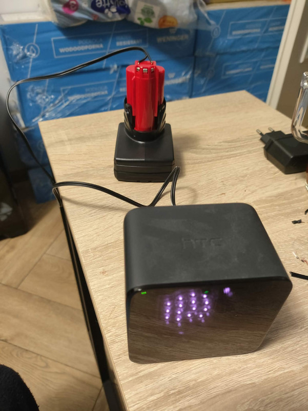

    In a stroke of genius I came out with a simple method to verify which part of the system gets interference.
    Is it HMD lighthouse faceplate that fails to look for base stations,
    or
    is it base stations getting EMI from power supply through the outlet?
    just run them from a 12V battery...
    And it... works,
    and there's no interference...
    stable tracking...
    no disconnection...
    no greying out screens...
    I can touch HMD now, nothing changes.
    I guess I'll just buy larger 12V batteries for them or look for better 12V power supplies for them.

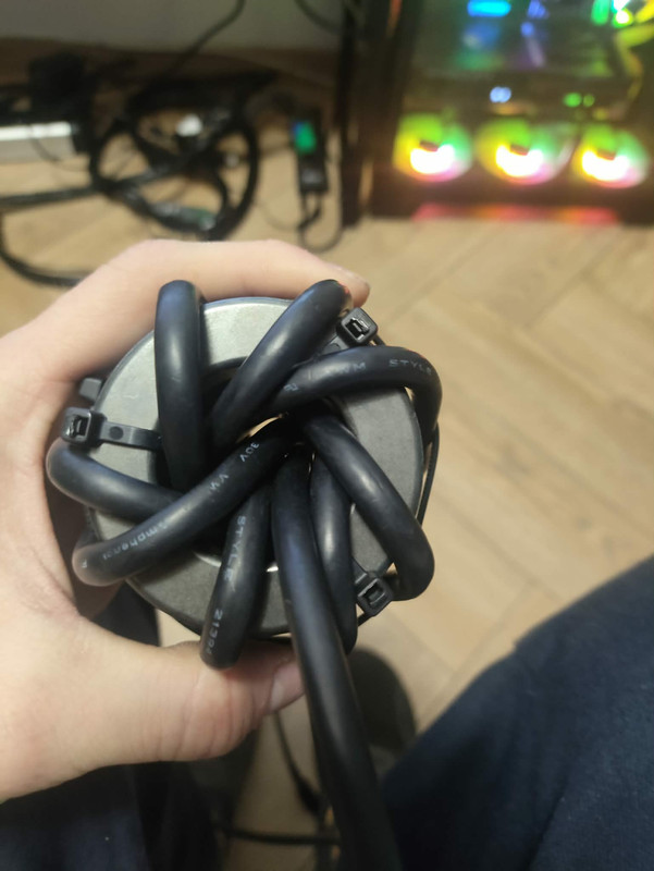

    [UPDATE]
    I was celebrating too early, and didn't check with rig's 3 USB cables plugged in PC. There was still interference with all 3 plugged, but today I got large proper material (type 31) ferrite cores.
    I made this with VR cable near the end and so far EMI is gone
    My friend said that he will nominate me for a Nobel Prize when I solve this :D

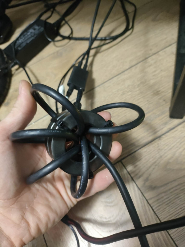

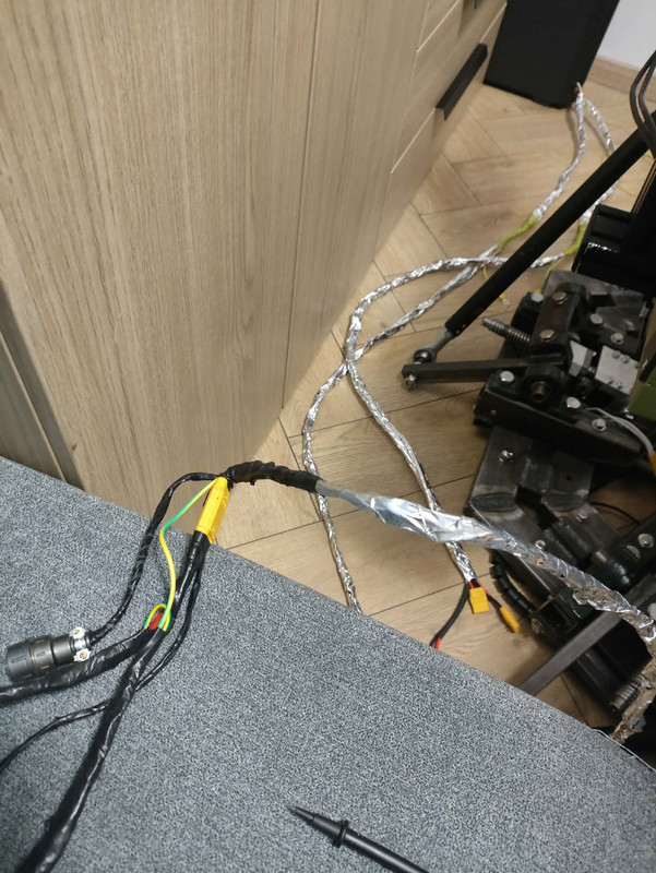

    [UPDATE]
    VR cable looped 8 times around 4 large ferrite cores.
    But the best results were when I shielded all power cables and rig's 3 USB cables with aluminium tape, and grounded them to single point. No interference at all, no noise in throttle/trim knob signals. I can touch VR headset, nothing happens.
