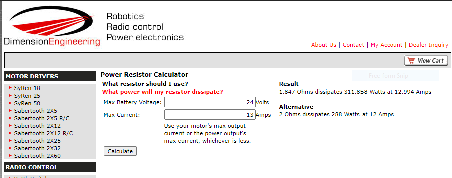

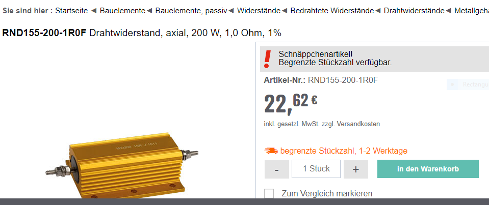

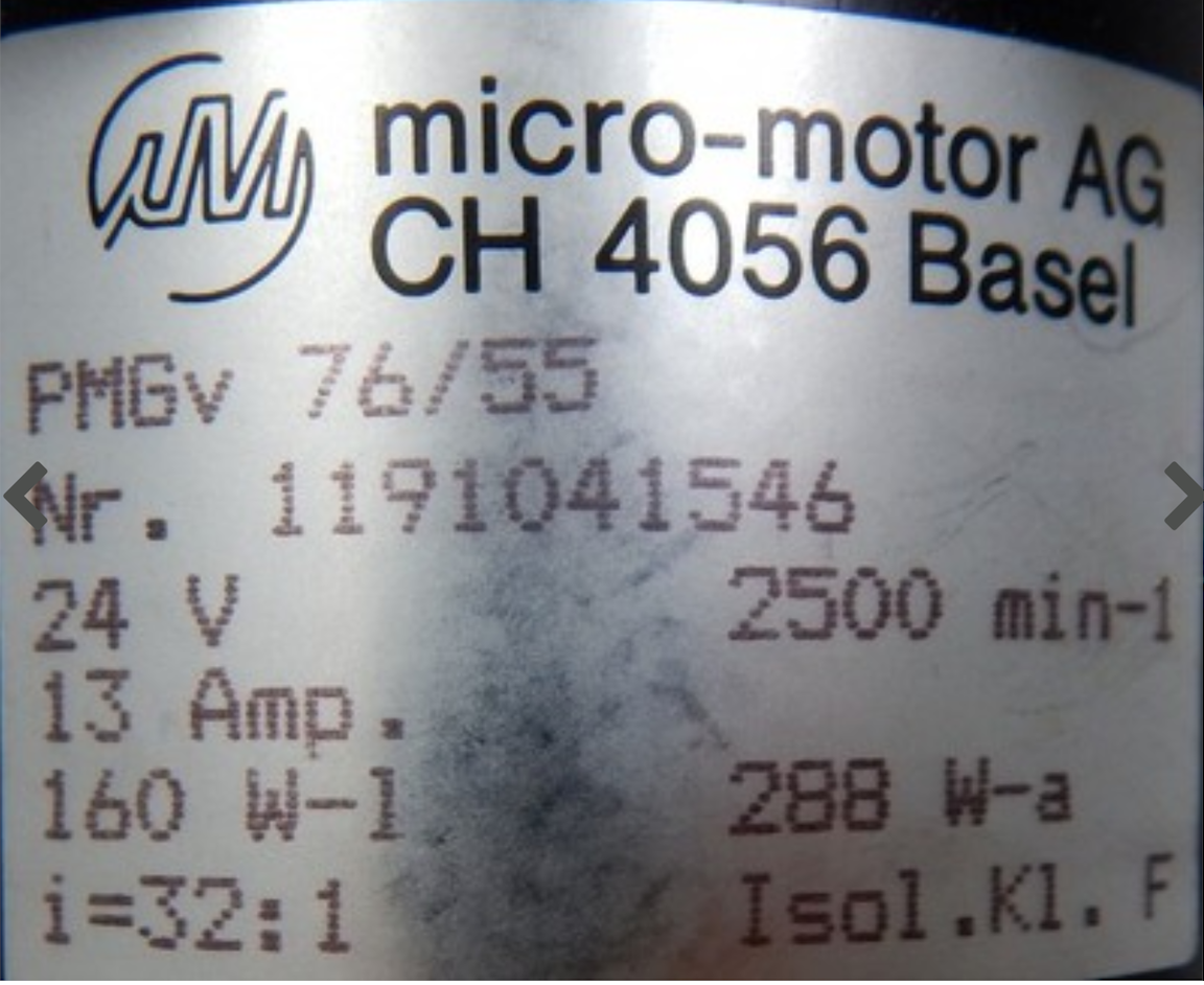

    Hi mates, please have a look at the following Pictures. They show my motor specs, the hopefully correct calculation and a product I found.
    Is that the right way and the right stuff?

    One 1 ohm resistor may work but accoring to the calculator result you would need two of them wired in series to get 2 ohms.

    Do you say if i buy a 2ohms resistor with more than 160watts i'd be in the save side?
