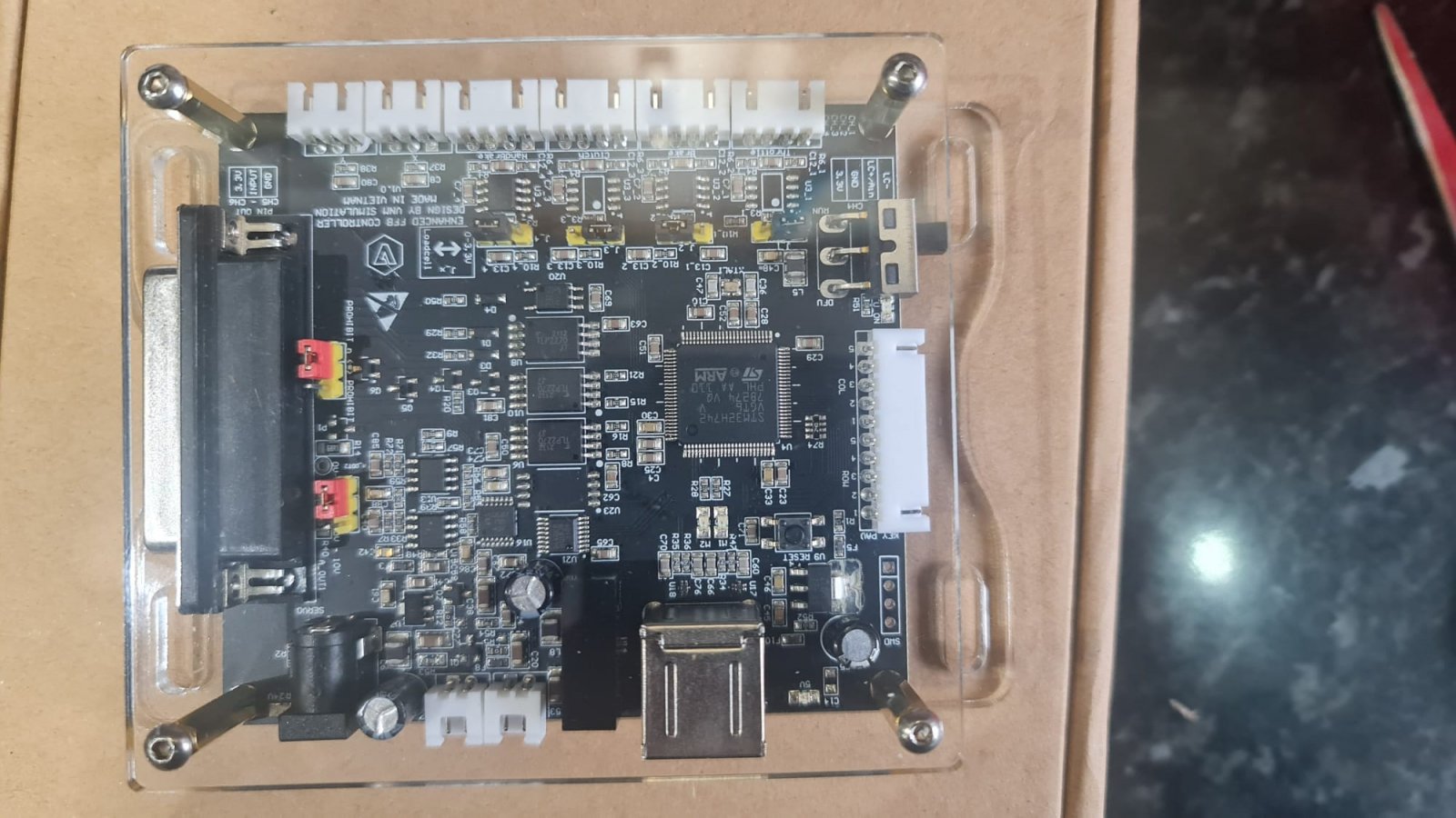

    I recently had issues with my OSW wheel running a mige motor, aasd driver and Tdd board
    after a lot of effort and getting nowhere I contacted @Hoantv
    his UK dealer made contact and I purchased a VNM wheelbase controller
    the dealer has been very helpful and is very knowledgeable with Sims and technology etc

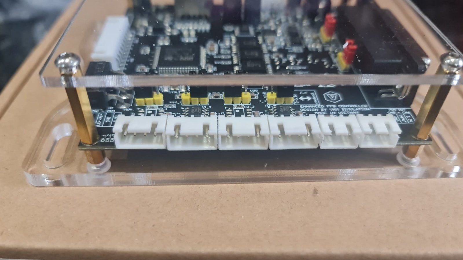

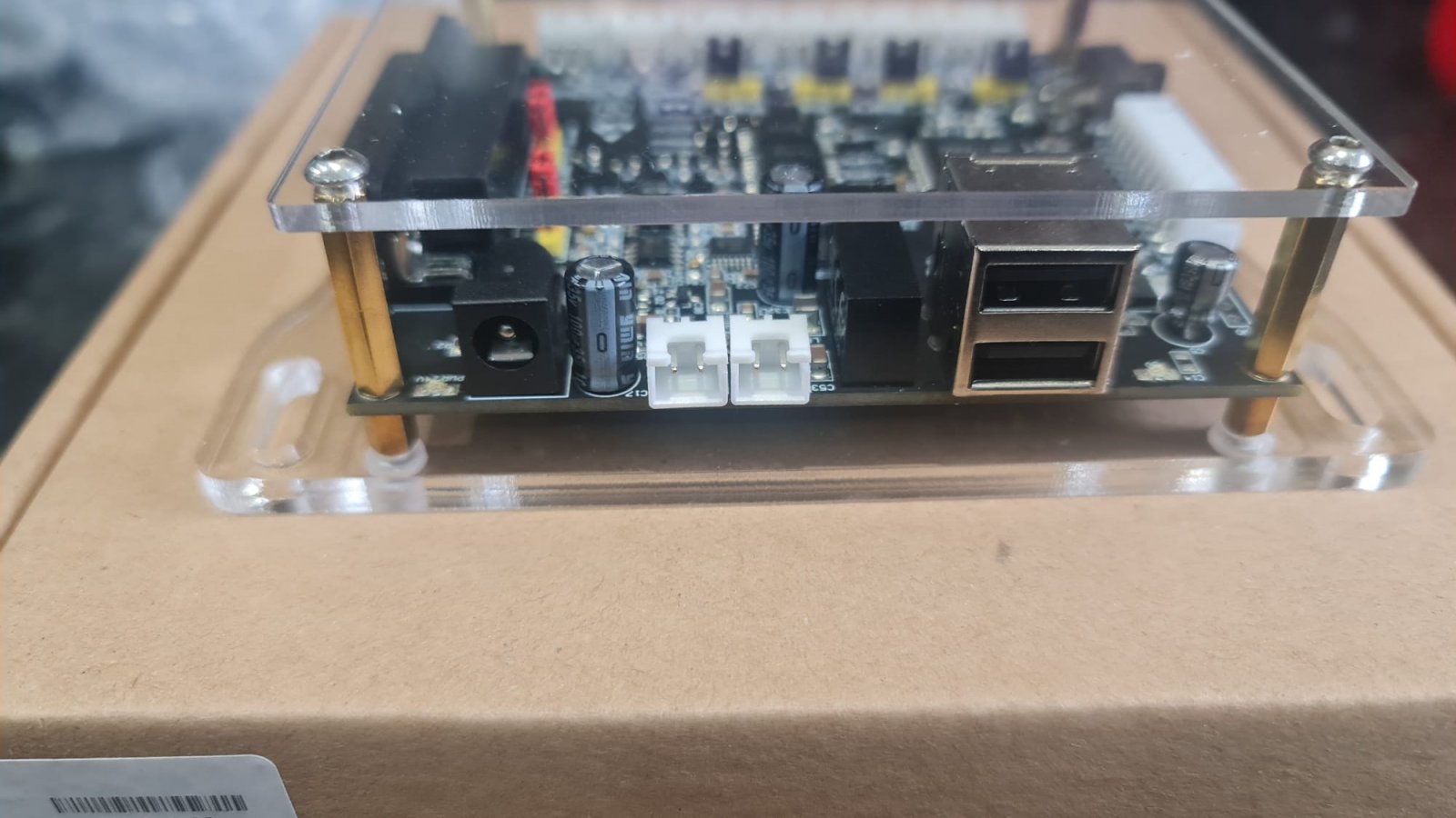

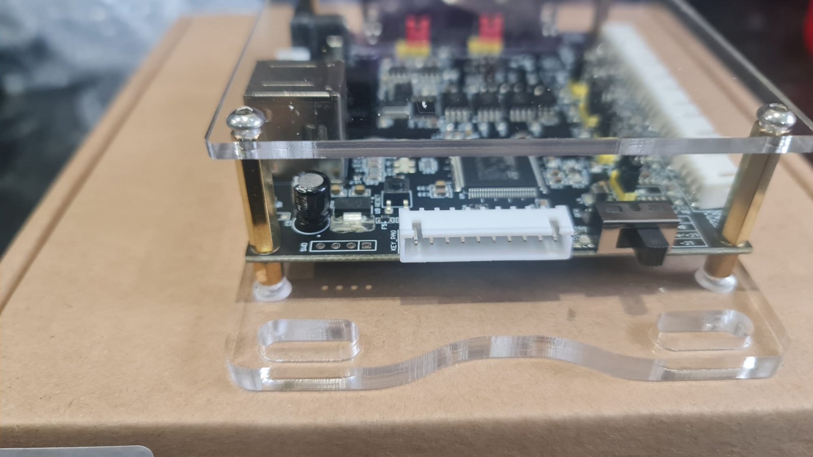

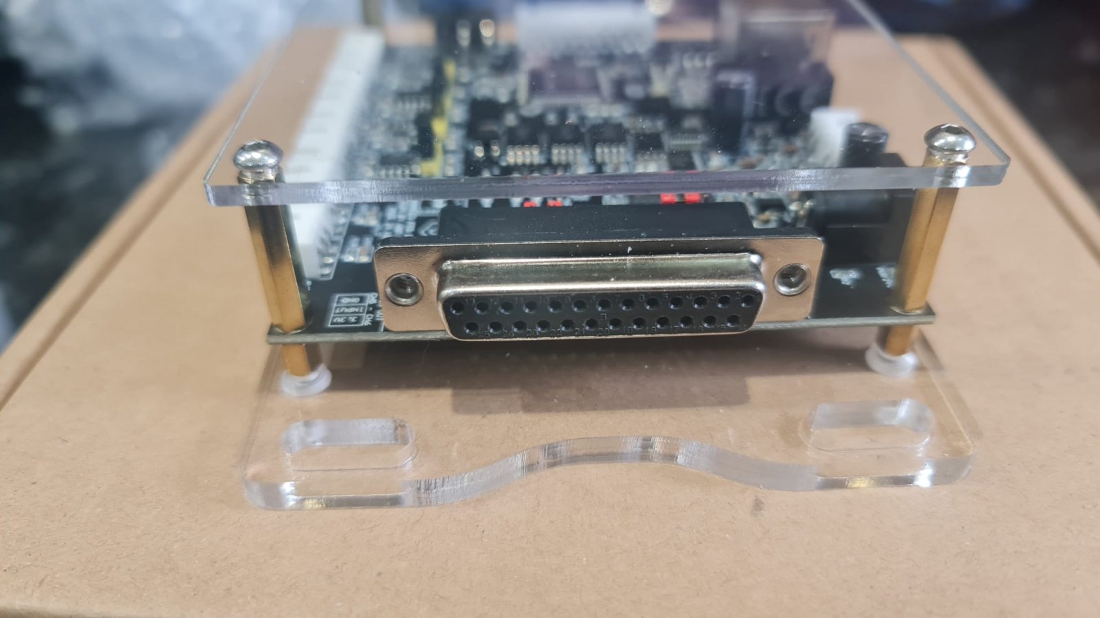

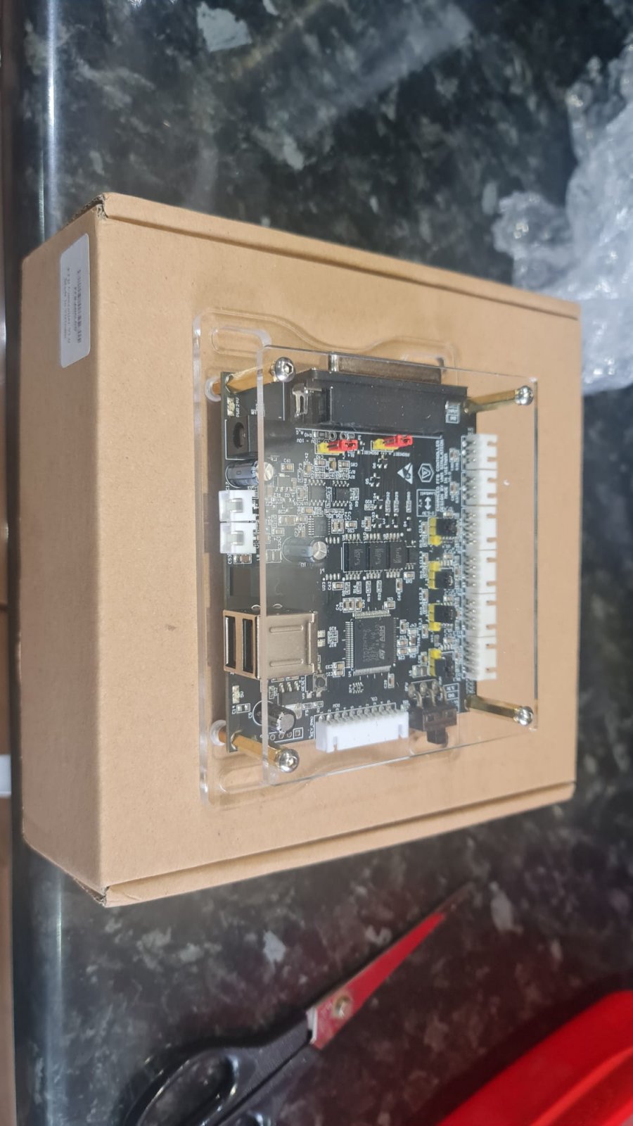

    the VNM wheelbase board is a neat board that comes mounted between acrylic clear plastic to protect the board and allow you to see the board underneath. its well designed and runs off its own 24v power supply that is optoisolated from the wheel
    a couple of points
    it can work with aasd pwm and direction
    it can also work with the mige -10v to +10 driver and other formats
    it can read shifter position x/y and convert to gear shift buttons
    it can be integrated into a button box matrix
    it can work with potentiometers for accelerator brake and clutch
    it can also work with load cell brake and clutch
    the software is easy to use and has a few quirks - I have got it working very well with my sim set up
    The FFB quality seems another step up from MMOS and has an extra level of detail I had not felt before. It is possible to setup the FFB to be 4k updates a second !
    I am very pleased with the product !
