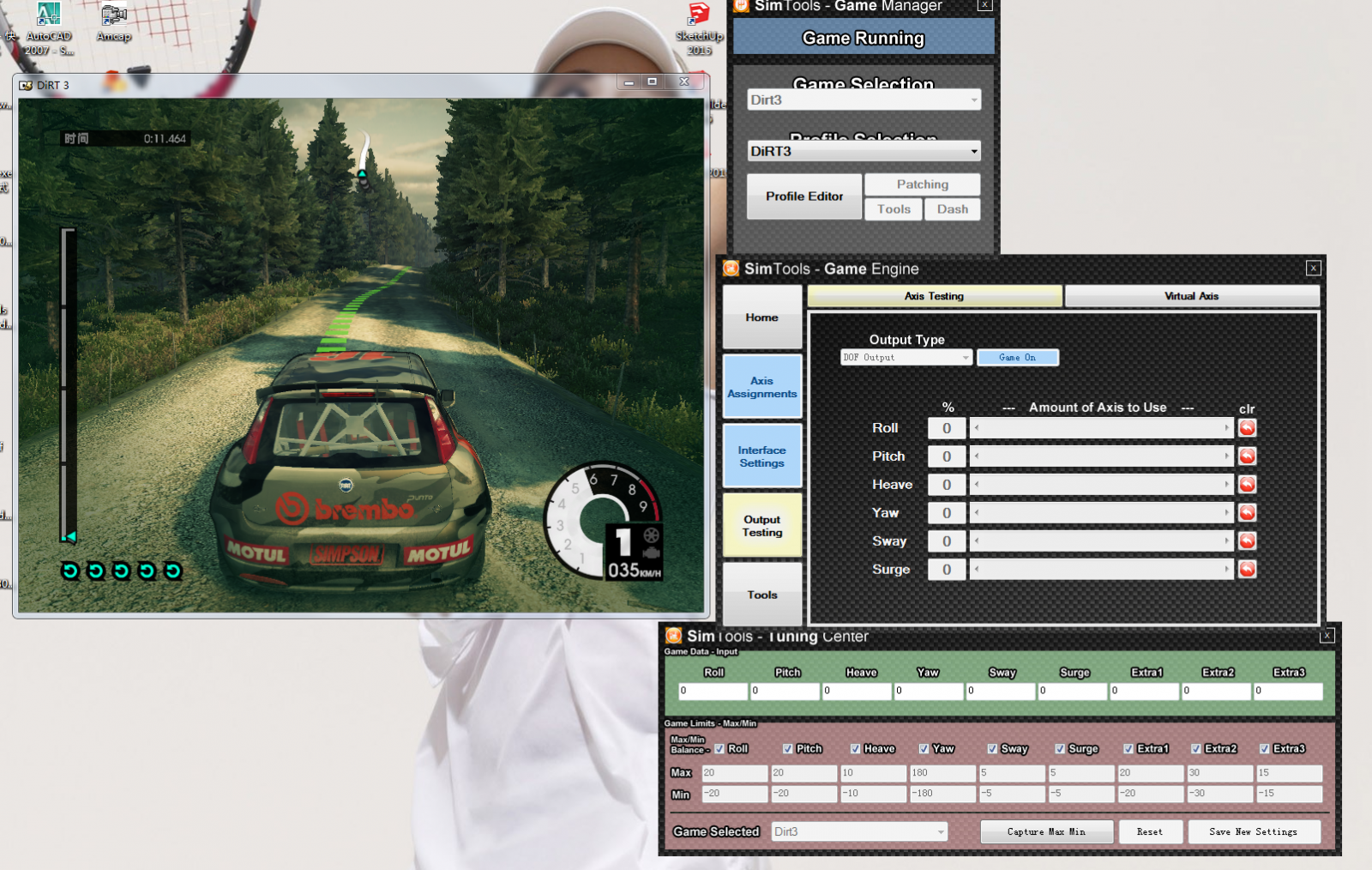

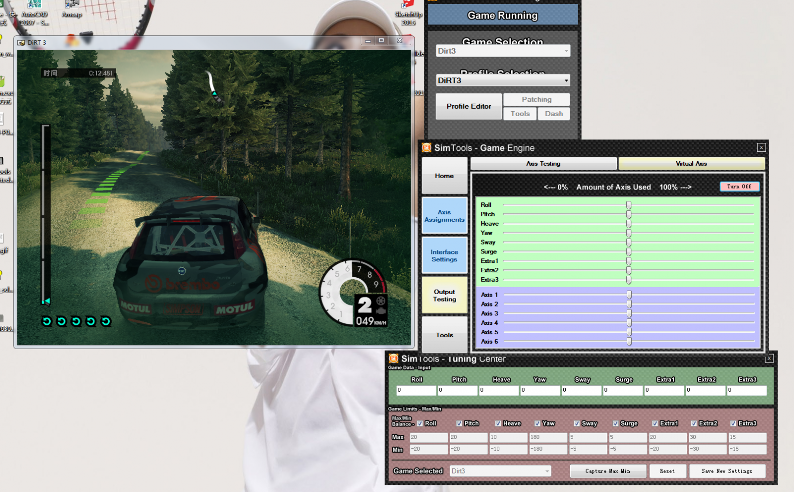

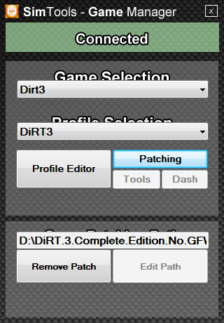

    I want visualizing DiRT3's data extraction use SimTools GameEngine ,
    My ststem :win7 x64 + G27
    Installed SimTools-GameEngine + SimTools GameManger +
    Dirt3_Plugin 3.0.2.0
    SimTools-Game Manager See "Game running" when i launch
    Dirt3 .
    Now i can't see Dirt3 data extraction on Output
    Testing.
    No response when i drive a car on Virtual Axis.
    where is error set it?
    please help me!!

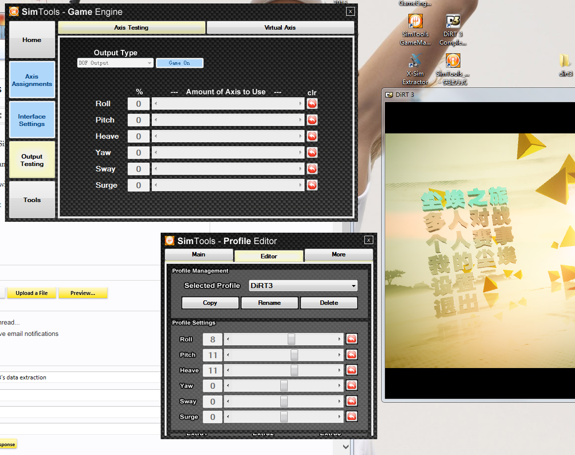

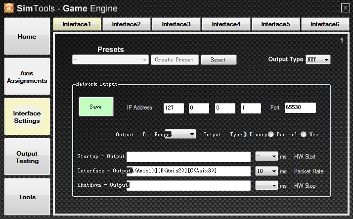

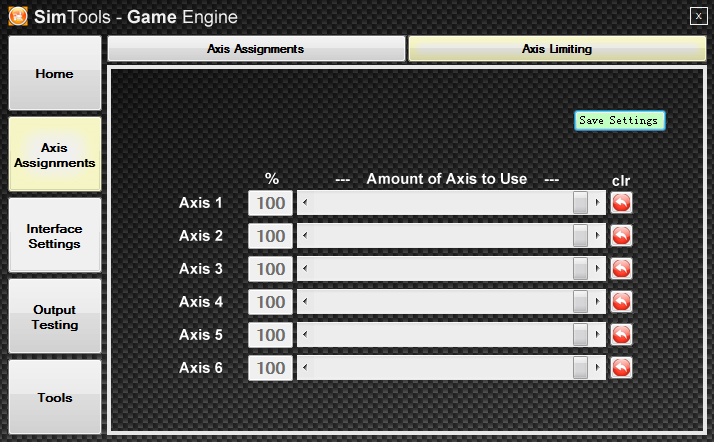

    Hi @leihonglun
    Can you please post a screenshot of your Interface Settings and your Axis Assignments?
    It could also be an issue with the language settings.
    You might try Windows Control PanelRegion and LanguageEnglish (United States).

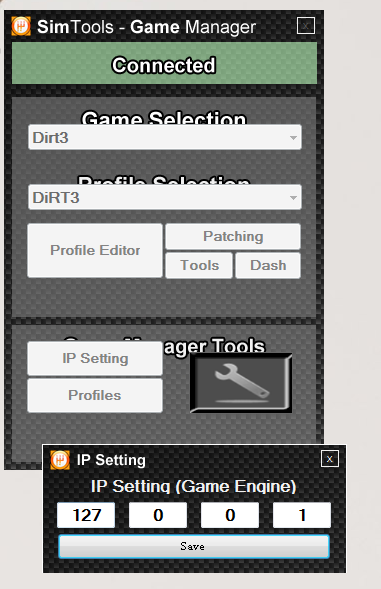

    Hi @value1,
    1.I change system's language setting a english.and SimTools installs again.
    Interface Settings and Axis Assignments is normal is default, i don't set it.
    2.Just want use "visualizing DiRT3's data extraction" see Dirt3's data.i need set Interface Settings and Axis Assignments?
    3.SimTools -GameManager IP setting 127.0.0.1. my computer IP 192.168.1.116.what 's have problem?

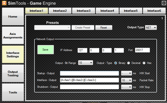

  5. value1
    Jan 9, 2011
    2,184
    Zug, Switzerland
    14,948Coins
    +3,328 / 11 / -1
    You need to set some values in axis assignment and define an interface. Just use any COM port on your computer.
    Check the quick installation guide for Simtools.
    Otherwise you will not see any data in Tuning Center.
  6. insanegr
    insanegr !N$@n€
    Jan 14, 2014
    504
    Athens
    16,721Coins
    +499 / 1 / -0

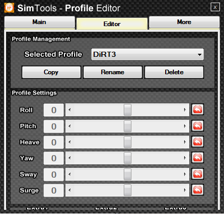

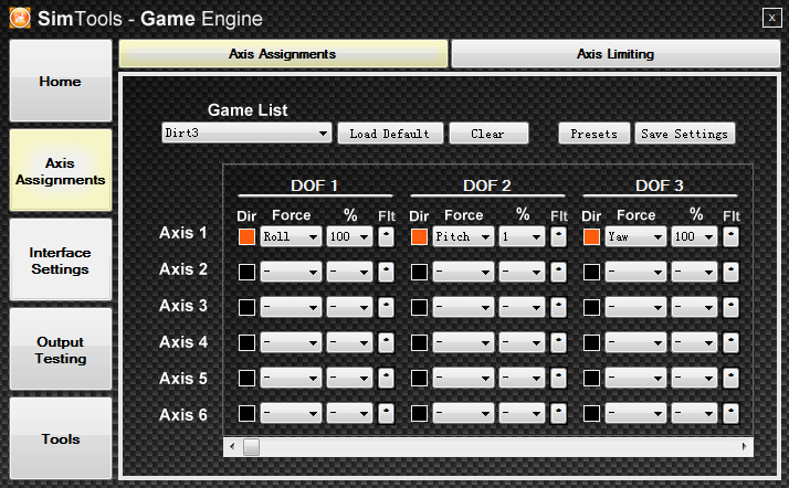

    you have to create a profile for Dirt 3 in game engine - axis assignments and save it.
    you have to configure game engine- interface settings and save it to see values in tuning center and Virtual Axis
    something like this

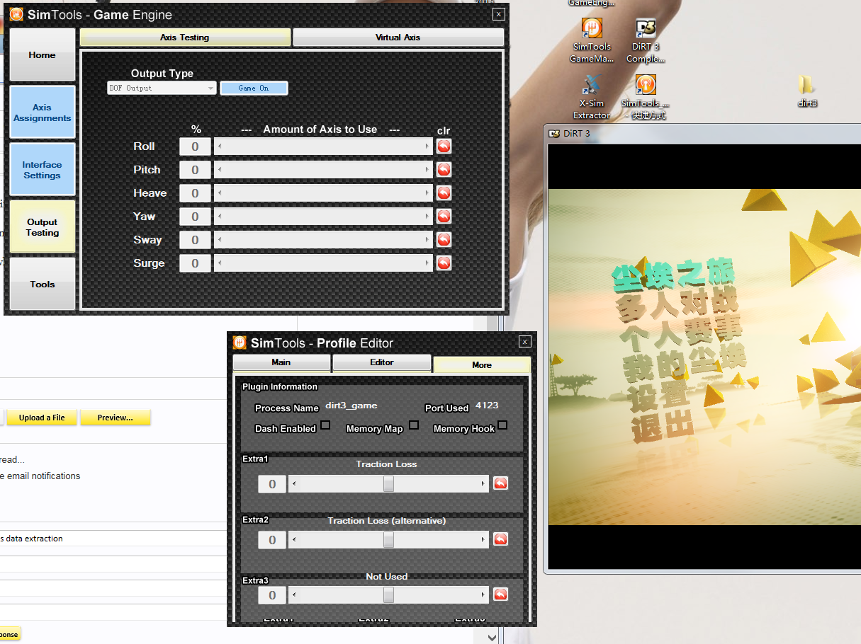

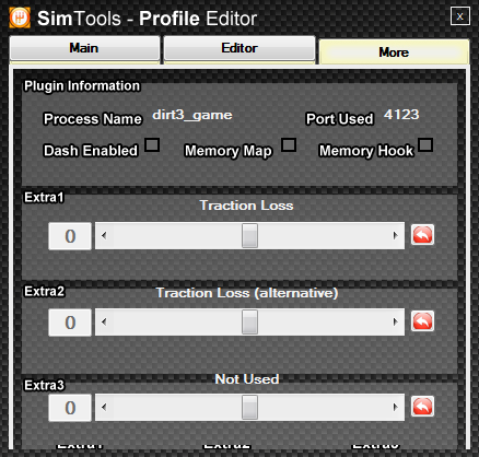

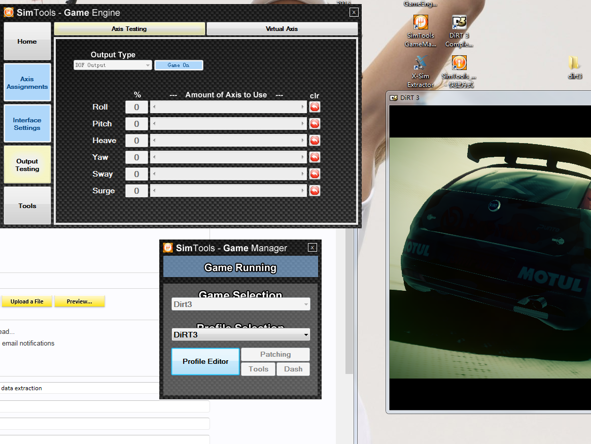

    1.IP address 127 0 0 1,Port 4123,Because i see on Sim Tools- Profile Editor -More 'Port Used 4123'. Otherwise according to you ,this is right?

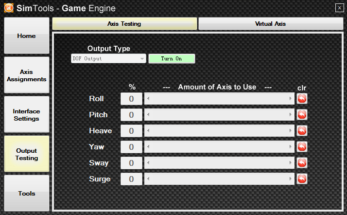

    2.OutputTesting "Axis Tseting" Output Type is 'Dof Output' - game on, "Virual Axis" is show 'Turn On' ,When i running Dirt3.

    4123 is the games port that communicates with simtools not the interface port.
    to see virtual axis moving you have to press '' Turn On '' button when you launch the game
    drag and drop the pic in the writing field to upload a pic but don't know if there is a restriction because you have few posts i think this restriction wouldnt be a problem for supporters
  12. leihonglun
    leihonglun New Member
    Dec 16, 2015
    13
    china
    262Coins
    Motion platform, 4DOF, 6DOF
    @insanegr

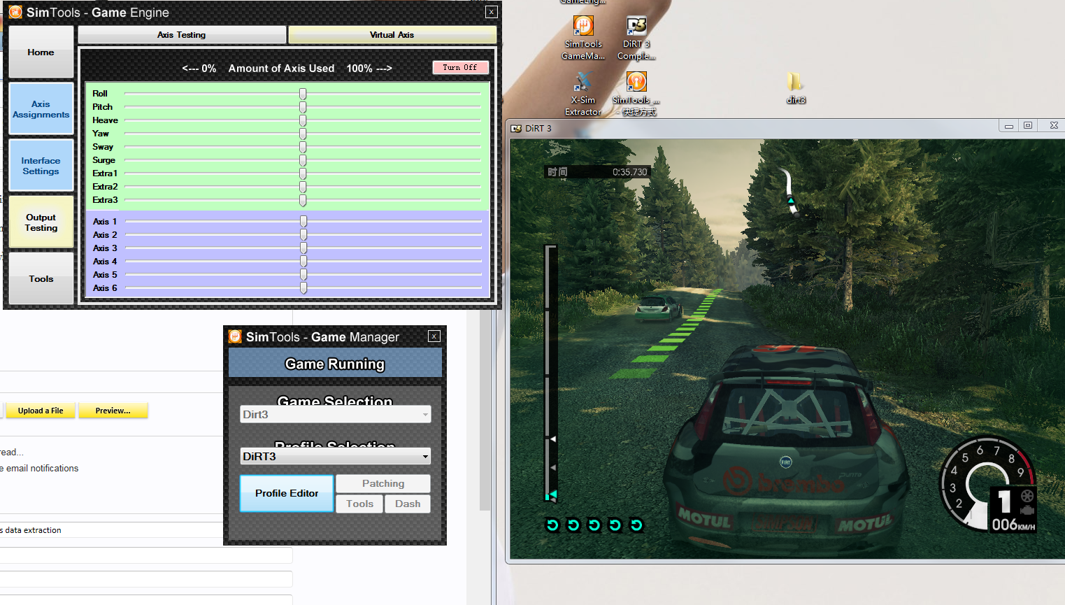

    This is my set.
    I feel this question is quite strange, may be I do not understand this force feedback racing car racing status data is sent out through what form. Are all of these games have a unified agreement, is through the DirectInput class?
    I think I should understand this kind of force feedback game first, we are how to get their data.

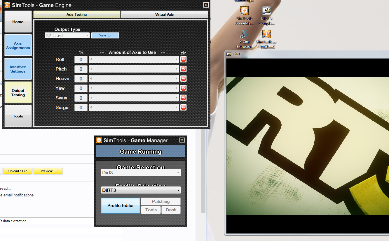

    1 .DPI set 100%,but show is not change.
    2.path is right.because GameManger show gamerunning when i was luanch game.
    3. Change Axis no effect.
    i need change 'hardware_settings.xml' for Dirt3?

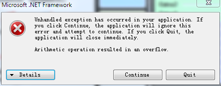

  15. leihonglun
    Dec 16, 2015
    13
    china
    262Coins
    Thanks for ever one Help me! I find problem. it's patch path..
    D:\DiRT.3.Complete.Edition.No.GFWL.Cracked ..:grin
    Now C:\Users\Your_User_Name\Documents\My Games\DiRT3
    @noorbeast @insanegr @value1 .
    And
    look this when i playing game.

  19. leihonglun
    Dec 16, 2015
    13
    china
    262Coins

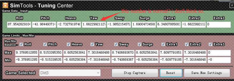

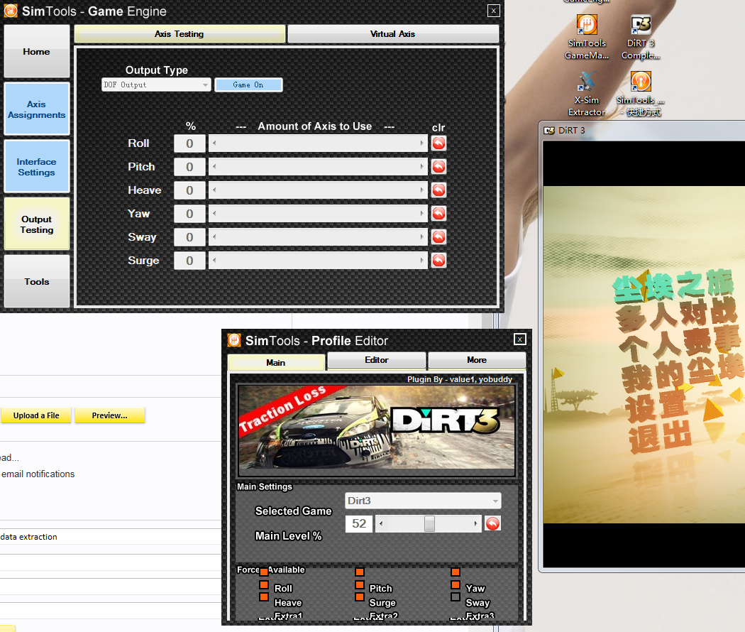

    hi @noorbeast look this .i think this data is abnormal..where is my set is error??
  20. noorbeast
    21,514
    150,704Coins
    +11,018 / 55 / -2
    The numbers in the green section are representative of extracted data and will vary depending on what is going on in the game, that is normal.
    What matters is tweaking the associated Min and Max values in the Tuning Center to tailor the desired movement, in conjunction with the % value allocated in the Axis Assignment tab of SimTools for that particular axis.
