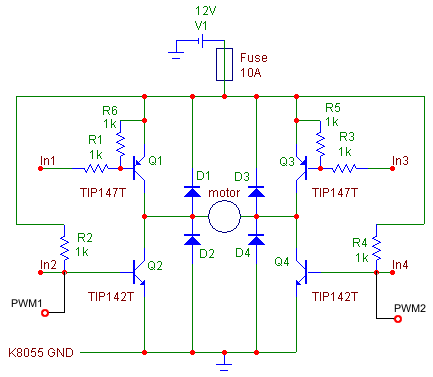

    I am in the prototyping stage (and yes, the electronics really do work) of driving 2 wiper motors with my K8055.
    The drawback (according to my understanding of other peoples experiences) is that there is bad lag on processing resistance from the feedback pots - this is probably due to the k8055 feeding back data to the processor and then having to receive its instructions back from the PC, rather than calculating positioning data onboard like Tronic's AMC does.
    (It may also be down to slow pcs - I don't have a problem there, but my gaming machine is very good and I use the function to isolate X-Sim onto only one CPU).
    They can also drop out on you as software crashes, which can have interesting results!! Breaker switches on extremes of position are a good idea!

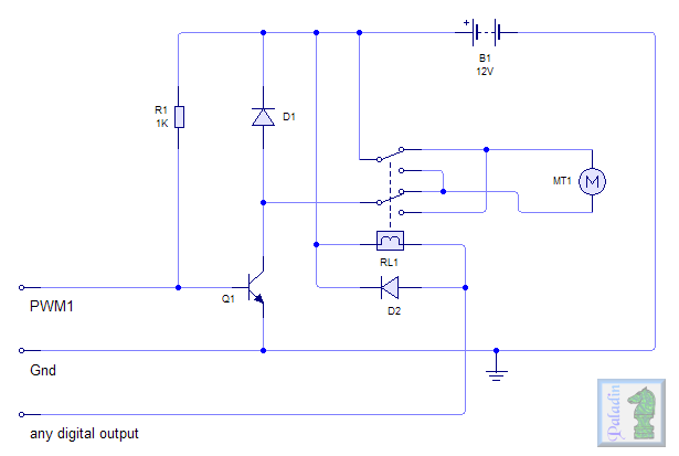

    The electronic setup I am using is based on a design I found on the Velleman forum for a relay solution using a double pole double throw relay, though I did also try mosfets which worked, but with bad power loss. Both circuits are below.
    These circuits are not complicated, and I can claim no originality whatsoever for the designs of the circuits (though I have designed my own PCBs, which I will share once my solution is complete).
    The source of the circuit designs is the Velleman forum. Pictures below should help you - I am using the relay circuit, and have simply doubled on one board to conveniently control 2 motors with one power supply.
    I have tried both of these circuits, and they DO work.

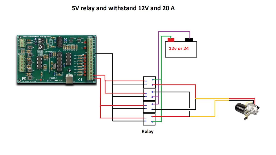

  4. Asus-G51JX-3D
    Asus-G51JX-3D Member
    Oct 25, 2010
    44
    - 69Coins
    2DOF, 4DOF

    Me too - I can claim no originality for the design, but it works very well and it is super cheap (less than £10 for one relay setup) - with K8055 PWM set to 100%, the motor stops, set to 0% the motor is at full speed. The output from the digital out will set the direction, so in the maths calculation in profiler, you need to set the digital chanel output to on or off as well as setting PWM to the calculated figure on the analogue output
    I have only one motor currently, so have had to test chanel one and two separately, but it seems to work fine

    Here's a video for you showing the Relay option I posted ealier in this thread - unlike the one you posted which had no speed control, this one uses PWM and produces very nice speed control.
    It also gives you all the power from the battery/power supply, as none is lost as heat - to me, relays seem the way to go ;)
    http://www.youtube.com/watch?v=m5wlM9Irxnk
    and heres the circuit again:
    enjoy :D
    Tim

    What you could improve:
    -Use Logic Level MOSFET's instead of BJT's. Much better efficiency, power handling and switching characteristics.
    -Use Solid State relays instead of mechanical ones. This will eliminate the mechanical wear on the contacts improving life, increase switching speed between directions and you won't hear it when it changes direction.
    :clap: :thbup:

    I have actually just finished etching a double relay pcb to control two wipers at the same time - I will post a video as soon as I get it wired up... the frame can wait ;)
    One other improvement I have just been playing with is the setting of the PWM threshold - in the video there appears quite a large dead spot... my motors have really benefitted from a 25% adjustment 8)

    What PWM frequency are you using?
    The BJT is probably too slow to turn on. You can try to lower the PWM frequency and see if it improves.
    MOSFET's are much faster, they will work fine without adjustments.
  11. bigtalltim
    bigtalltim New Member
    Sep 10, 2010
    189
    Belfast
    361Coins
    I believe the K8055 has a fixed frequency of 23kHz hard coded into the board
    Tim
