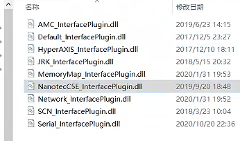

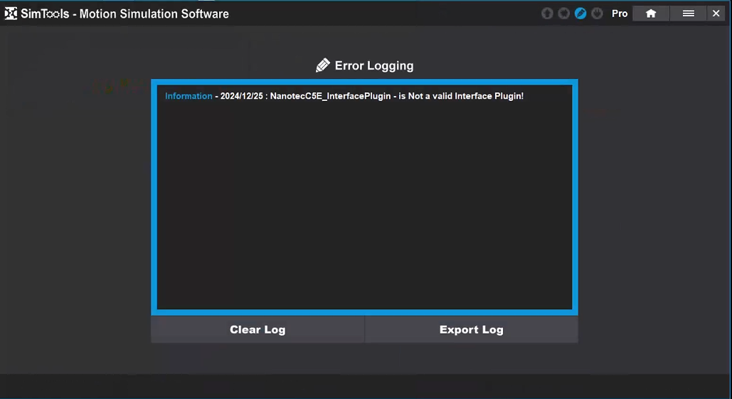

    I'm using SimTools V2 version now, and recently I wanted to play EA Sports WRC, but I found that there is no V2 version of the game plugin. I then studied how to upgrade SimTools to V3. After downloading the software, I was stumped when it came time to set up the interface. The plugin name I used in the V2 version is NanotecC5E, and the new version V3 does not have this plugin. I searched for many articles and did not find any mention of this plugin. I don't know where to start, so please help. I've also tried to take the V2 file and install it to the V3 version, but it prompts an invalid plugin.
    plugin has upload on this page

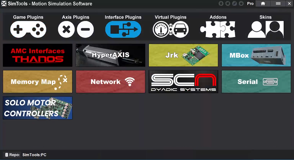

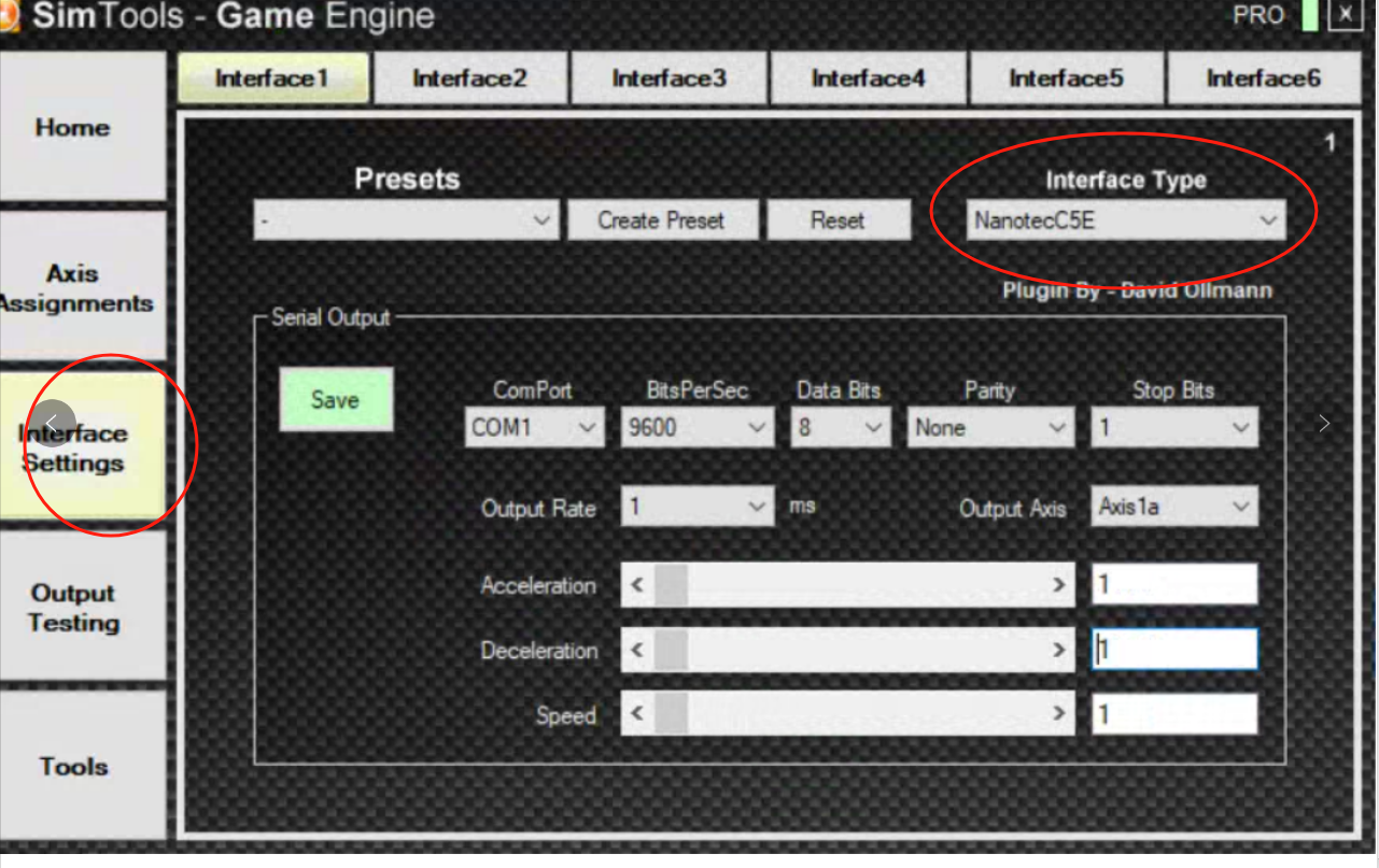

    Thank you for your reply. I understand what you mean. I also installed both V2 and V3 at the same time, but the problem now is that my V3 cannot be set in the interface, so my V3 version cannot be used. I need such a plugin or corresponding configuration method.

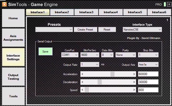

    I JUST WANT TO PLAY EA SPORT WRC ON MY COMPUTER WITH SIMTOOLS V2 AND I CAN'T FIND A PLUGIN THAT WORKS FOR WRC.
    The plugins I find now are all V3, my interface is not well configured, and I can't use V3's simtools

    I took a closer look at it again, my device should be SCN connected, in V3, I tried the scn setting, but it still doesn't work, is there any other way?

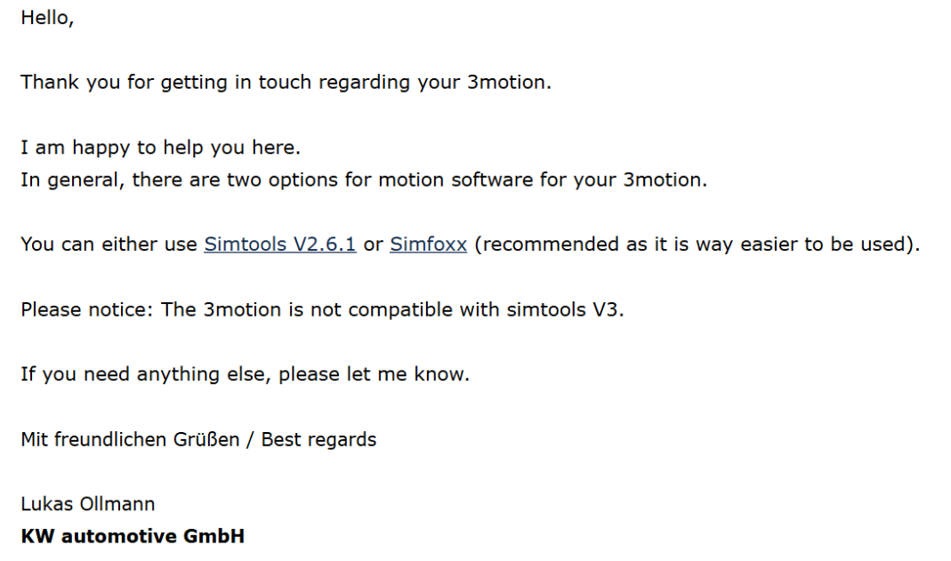

  14. long16652
    long16652 New Member
    Dec 25, 2024
    15
    55Coins

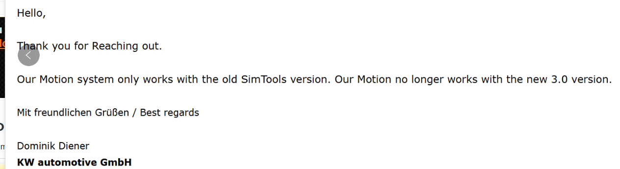

    I received two email replies at the beginning of January, they clearly stated that they did not support simtools V3, and also recommended me a different software... It's a really sad thing
