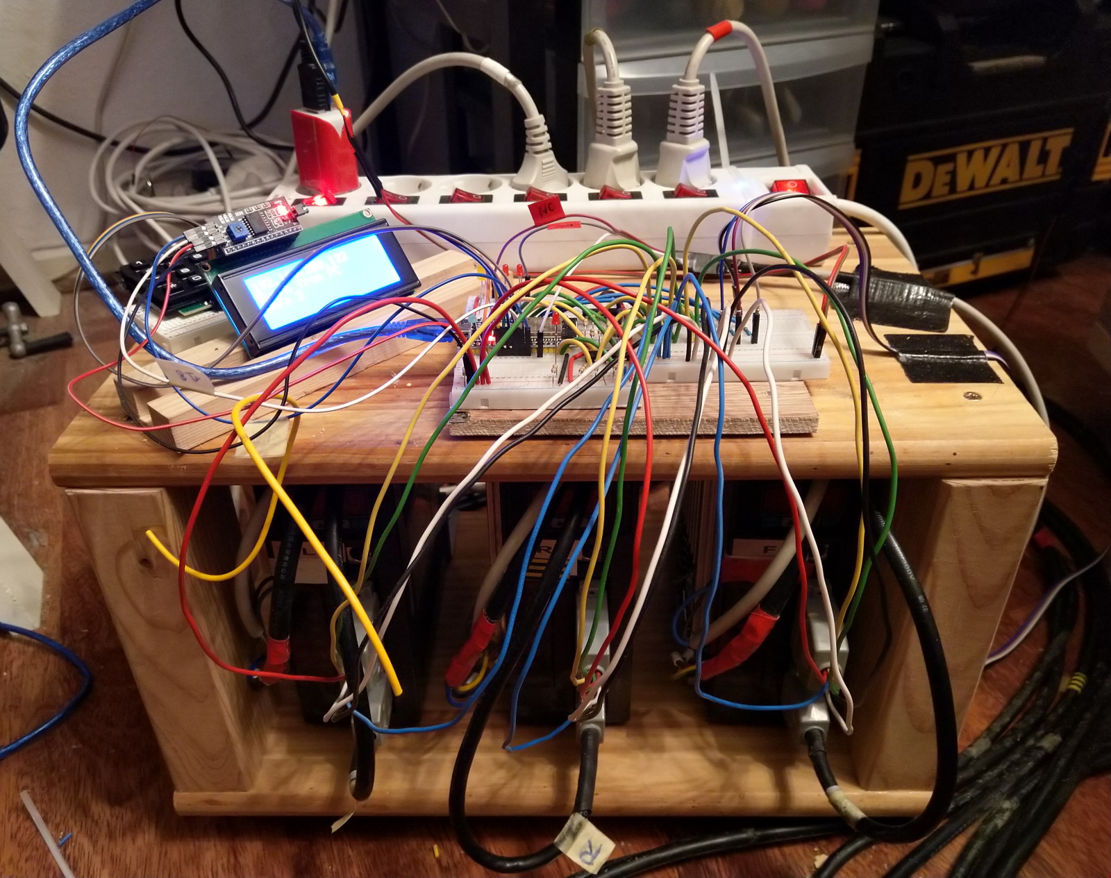

    The great thing about ESP32 is that it has wifi and decent performance. I use it to control my 3DOF racing simulator while playing Forza 7 on XBox or Project CARS on PC.
    The ESP32 board receives telemetry data from the racing game on a UDP port (pitch, yaw, roll, suspensions...) With these data I calculate the amount of pulses needed for the three AC servo motors which move the whole racing rig. I have done everything by myself (building the simulator, writing the firmware for ESP32, PC software...)
    Originally I used the STM32 board. For the communication between STM32 and PC use the COM port. A small program of mine runs on Windows, receives UDP data, calculates the amount of pulses and sends them to STM32. The STM32 in its turn sends the pulses to the motor drivers.
    I was very glad when I discovered the ESP32 since I could get rid of the long serial cable. Now I have just to turn on the XBox and power up the racing rig. No PC is needed. I use LEDs and a a LCD to get some feedback from ESP32, for example, IP address, reset state, online state etc... A keypad is used to send some test commands like homing, going to min, max positions.
    For the demo I attached some pictures. You can see the ESP32 and the wifi IP address on the LCD.
    If you want to use ESP32, go ahead. It works. Of course one has to do a lot of thing by oneself but isn't it fun :)

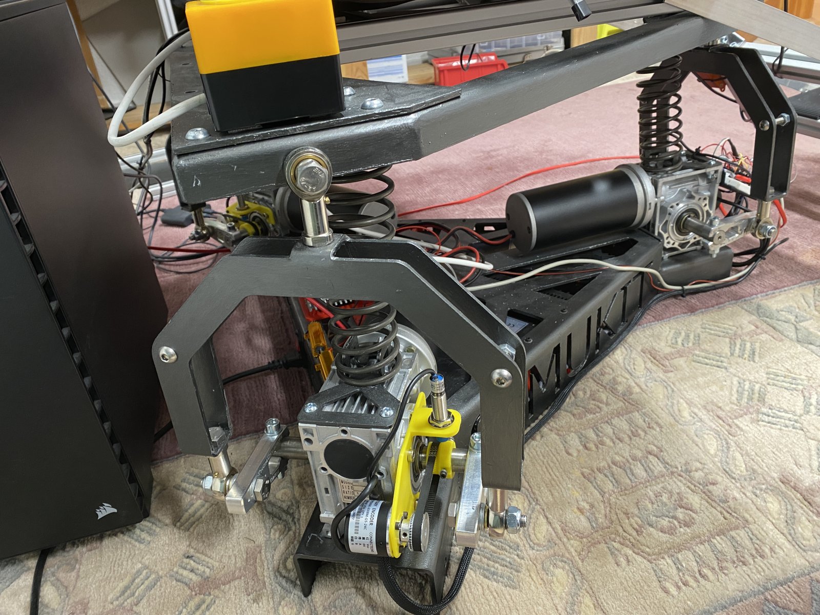

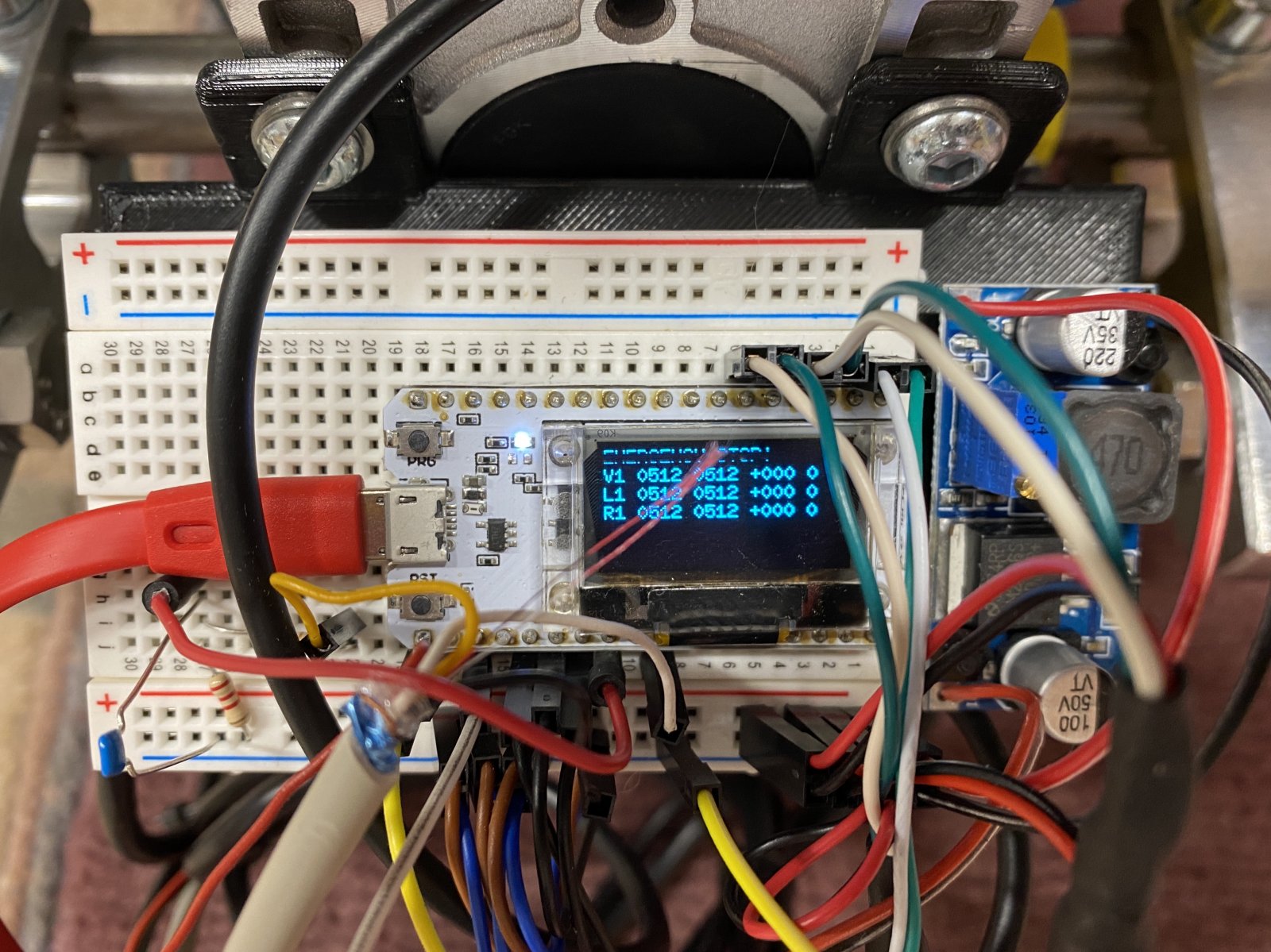

    Since some month I am using an Heltec Wifi Kit Esp32 Board (with a small on Board Oled display) to drive 3 24V 400W Motors with worm gears via Serially attached Sabertooth Motor drivers . For position feedback I replaced the original pots with interrupt driven 18$ Chinese 2400 PPR quadrature rotary encoders and capacitive proximity switches (for Homing) which gives a much better resolution and reliability. Communication with Simtools is via a short Text Telegramm via USB/Serial.
    After some tuning of the PID parameters i am now very happy with the performance of my Simukit3 rig when using Aerfly FS2 and a Vive.
    When i have more time I might give Wifi/UDP Communication a try again. I hope this will not introduce latency or small stuttering /roughness again. Your results show that this should be possible.

    Indeed, information exchange is useful.
    Encoders are definitely better than pots. With an encoder one is able to go to exactly the same position over and over again which is not the case with pots. I have this 2400 PPR encoder too. It is well built and the price is reasonable.
    Originally I used the NMRV worm gears. They worked ok, but due to the construction, worm gears always have backlash and that often create unplesant noises (cluck, cluck...) the motors change direction. Then I tried planetary gears (bought on eBay, PX110N0116S0) they worked fine and noiselessly. But after using these gears for a month I began again to search for another solution because these planetary gears don't have the double output shaft like the worm gears which make the platform more stable. Finally I found on Alibaba a gears manufature in China. I ordered three helical hypoid gears with double output shaft. It took two weeks for them to produce the gears. These things are great, they work very quietly.
    I don't experience any latency with my rig either. The UDP packages come approximately every 16 ms over wifi from the racing game. The ESP32 processes the data and give the timer interrupt routine the numbers of pulses it must generate for the three motor drivers. Everything happends in real time. Additionally to pitch, roll I also feed the rig with suspension data which make the racing experience more fun. One can feel a lot of bumping when driving.
    Thanks to the Chinese we can buy high quality motors for affordable price on Aliexpress now. That was not the case 10 years ago. The motors I use are 1,8 Kw AC servos which have 10000 PPR built-in encoders. They are so powerful so they can move the whole platform (me + 55 inch display + fanatec stuff + heavy wood plate) smoothly and pretty fast (appr. 370 mm/s). The funny thing is, after playing for hours, when I touch the motors, they are still cold as if they had never been turned on hahah...

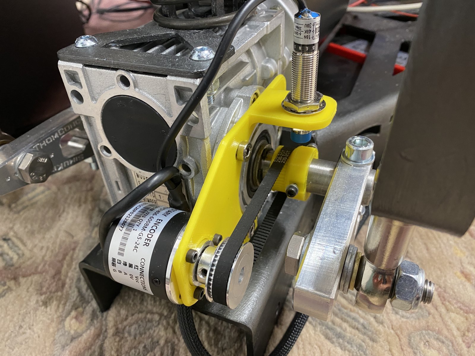

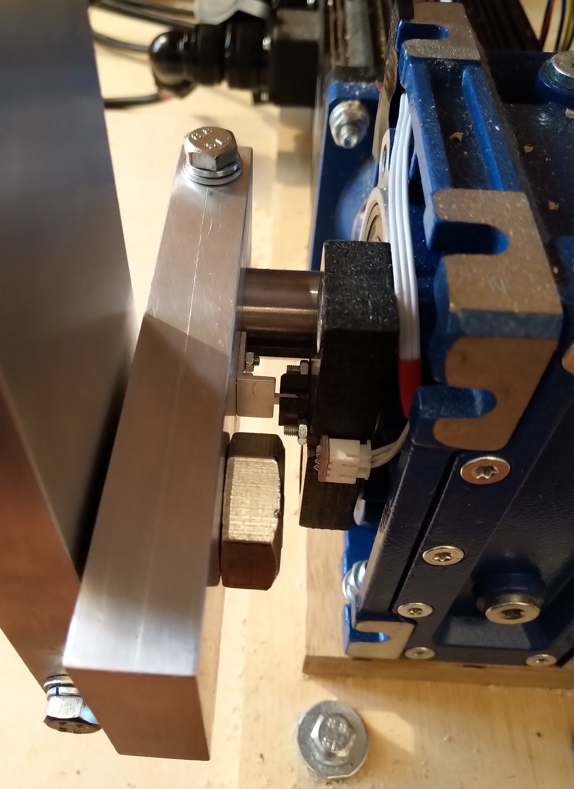

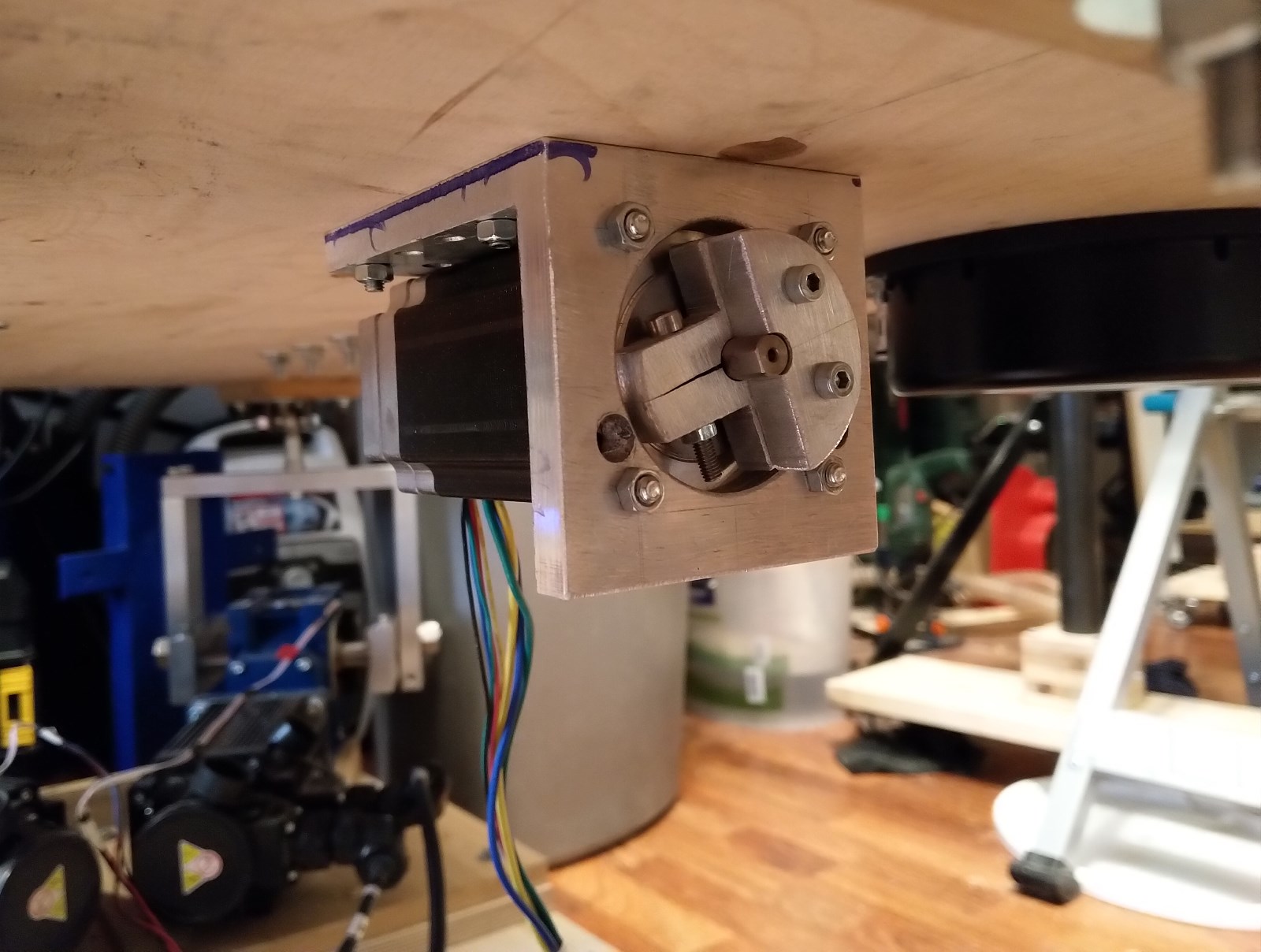

    I can see the sensor you use for homing on a picture, looks very solid. For that I use a dirt cheap optical endstop (costs about 1,3 EU on Aliexpress).

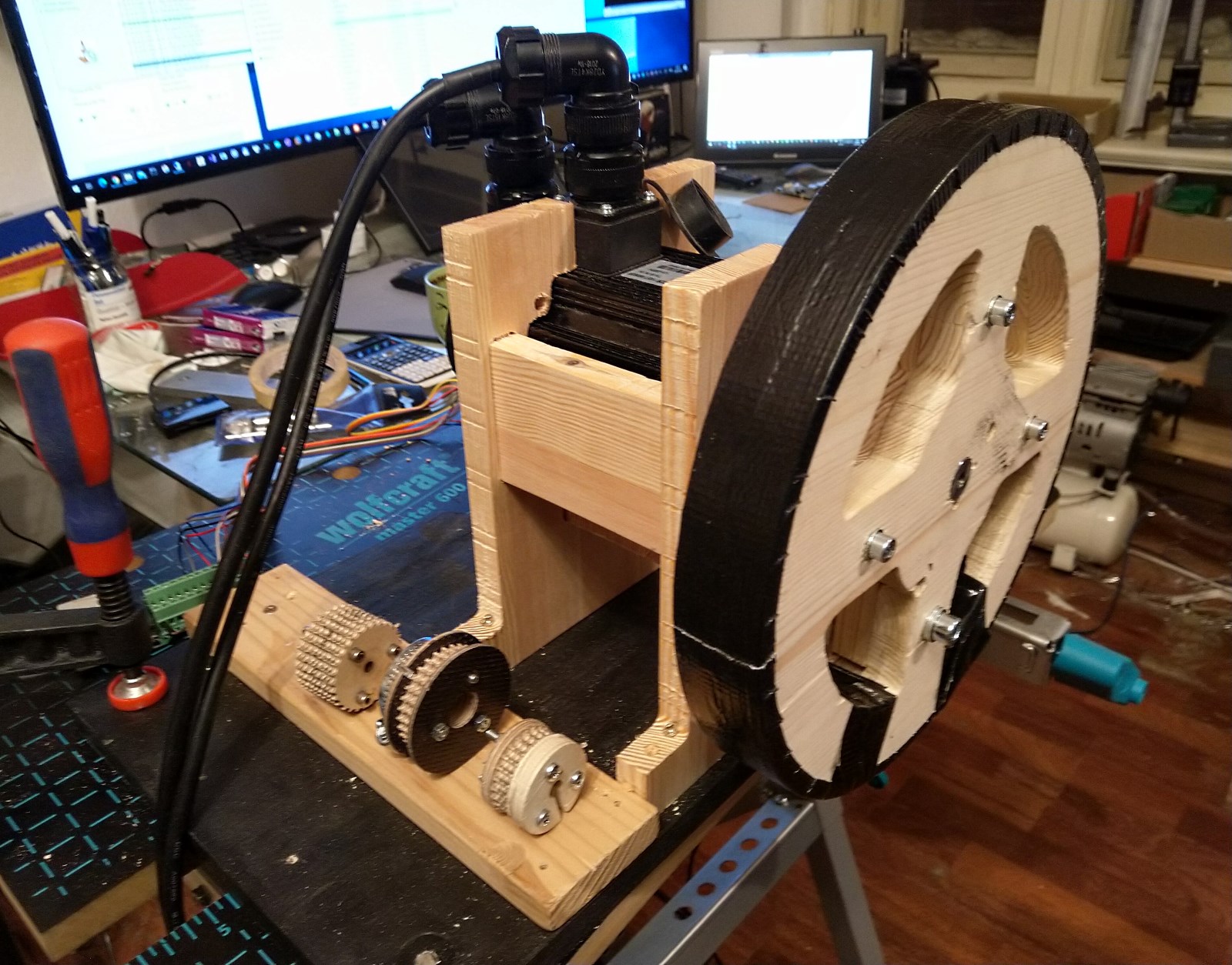

    To generate motor vibration I use a BLDC motor. The higher the RPM is the more it vibrates, and this thing can vibrate like crazy.

    I started using capacitive proximity sensors because first tests showed that they are able to detect 3D printed PLA. However Adjustment was very sensitive (and even dependent on room humidity) so I am using screws now to mark the lower and upper end position. Aside of this, capacitive and inductive Proximity sensors are very cheap (10$) and reliable nowadays, so I can recommend them. While a single Home position marker is theoretically sufficient, i use markers for the lower and upper limits, so I can “sanity check” if the platform leaves its allowed range.

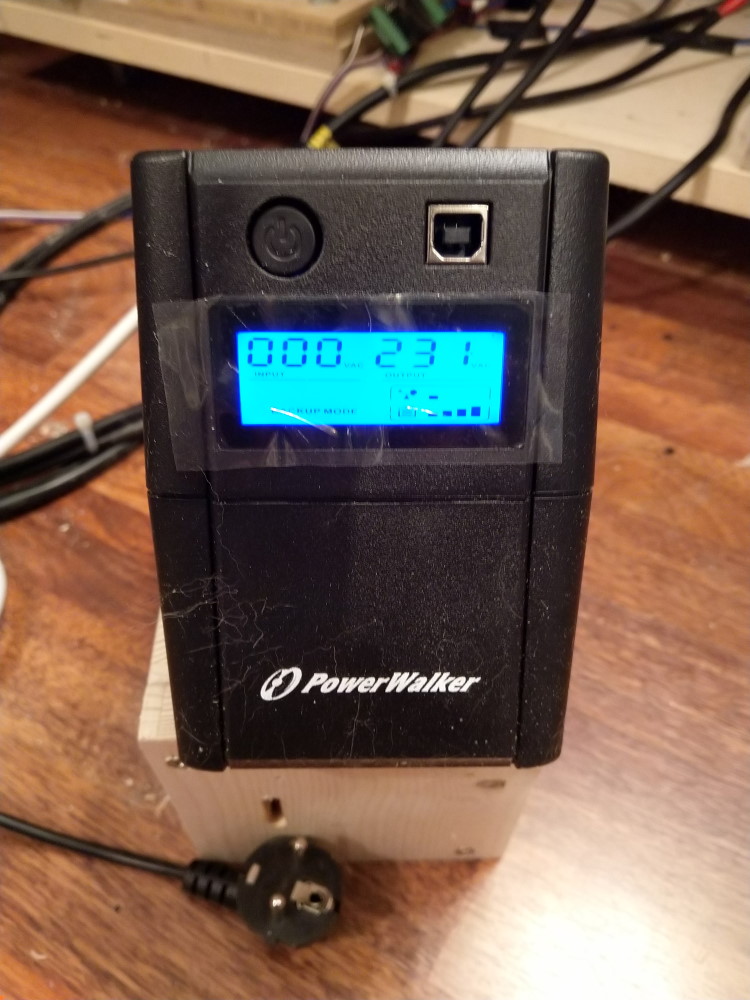

    It looks like there is a doable solution.
    I have just tested the racing rig with a 360W UPS. I plugged out the power but all three motors still run as if nothing had happened (switch time to battery mode = 4-10 ms). The motors are 1,8 Kw but they never operate at full power for a long duration of time so even a 360W UPS suffices to support the rig.
    I am gonna order a 1200W UPS on Amazon. At last the problem is solved.
