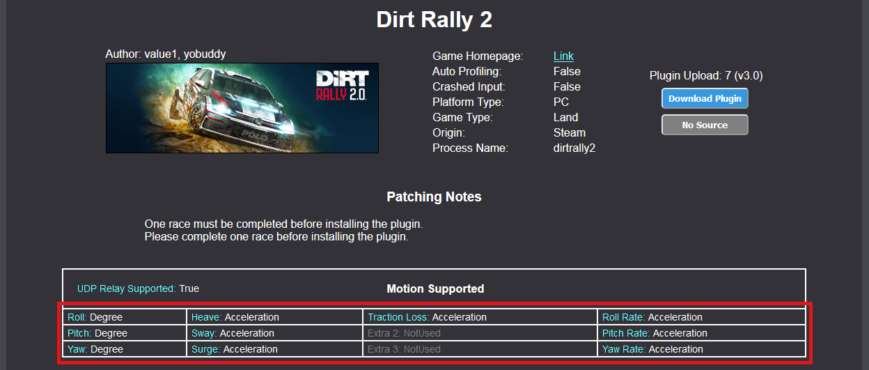

    Thanks for your response. Does it means that if I use UDP to output these datas, <Aixs1a> correspons to Roll angle of the vehicle, and <Axis2a> to Pitch angle and so on? Furthermore, I want to get acceleration along x,y,z axis of a vehilce in a game, and angular velocity around thses three axes. Can i achive this by using SimTools?
  17. yobuddy
    5,133
    47,907Coins
    +5,027 / 16 / -0
    The output you use is dependent on the interface plugin you use.
    If you use the network one, it will be UDP yes.
    You can click on a game plugin and see its data page, and whats available for any game plugin here:
    https://simtools.us/plugin_library/
    For example:
    Take care,
