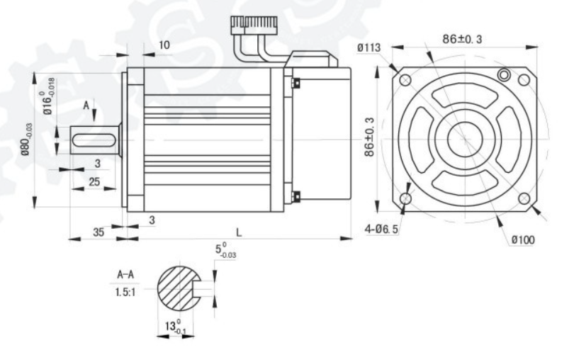

    I have an issue... I purchased (6x) 90ST-M04025 motors (with drivers) for a 6DOF project. These motors have 16mm output shafts. Unfortunately, I'm having no luck finding a 80:1 worm/gearbox with 16mm input shaft, but tones with 19mm.
