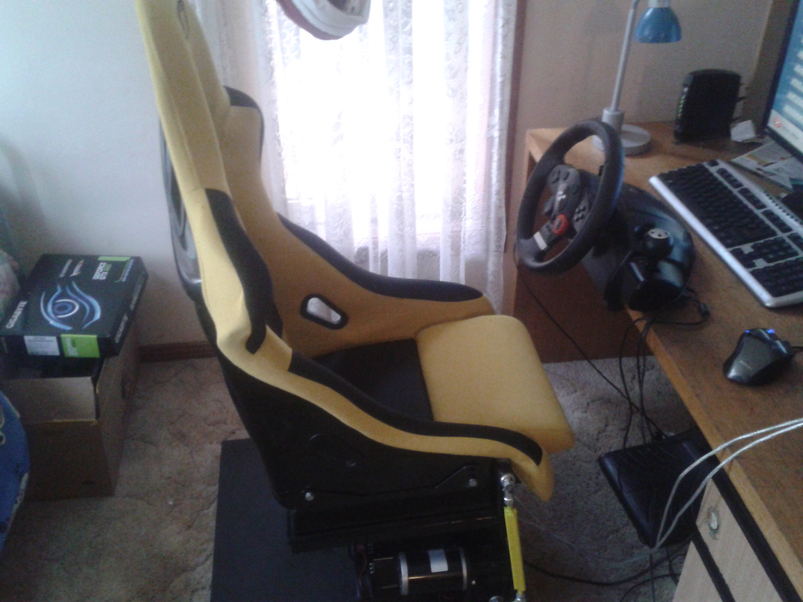

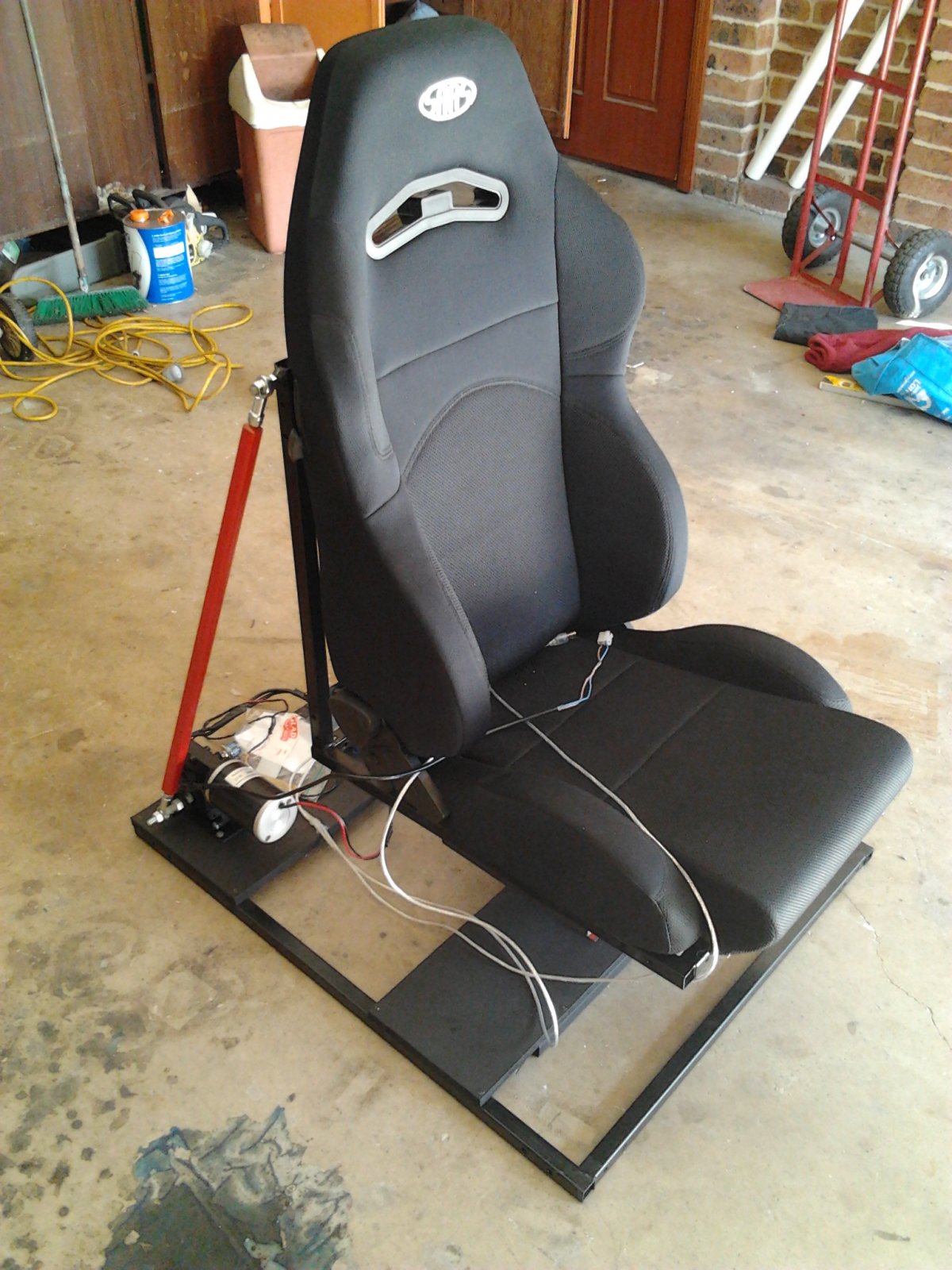

    The 25:1 gearbox motor will do fine for a shoulder mount seat mover like this
    or a desk racer mount like this

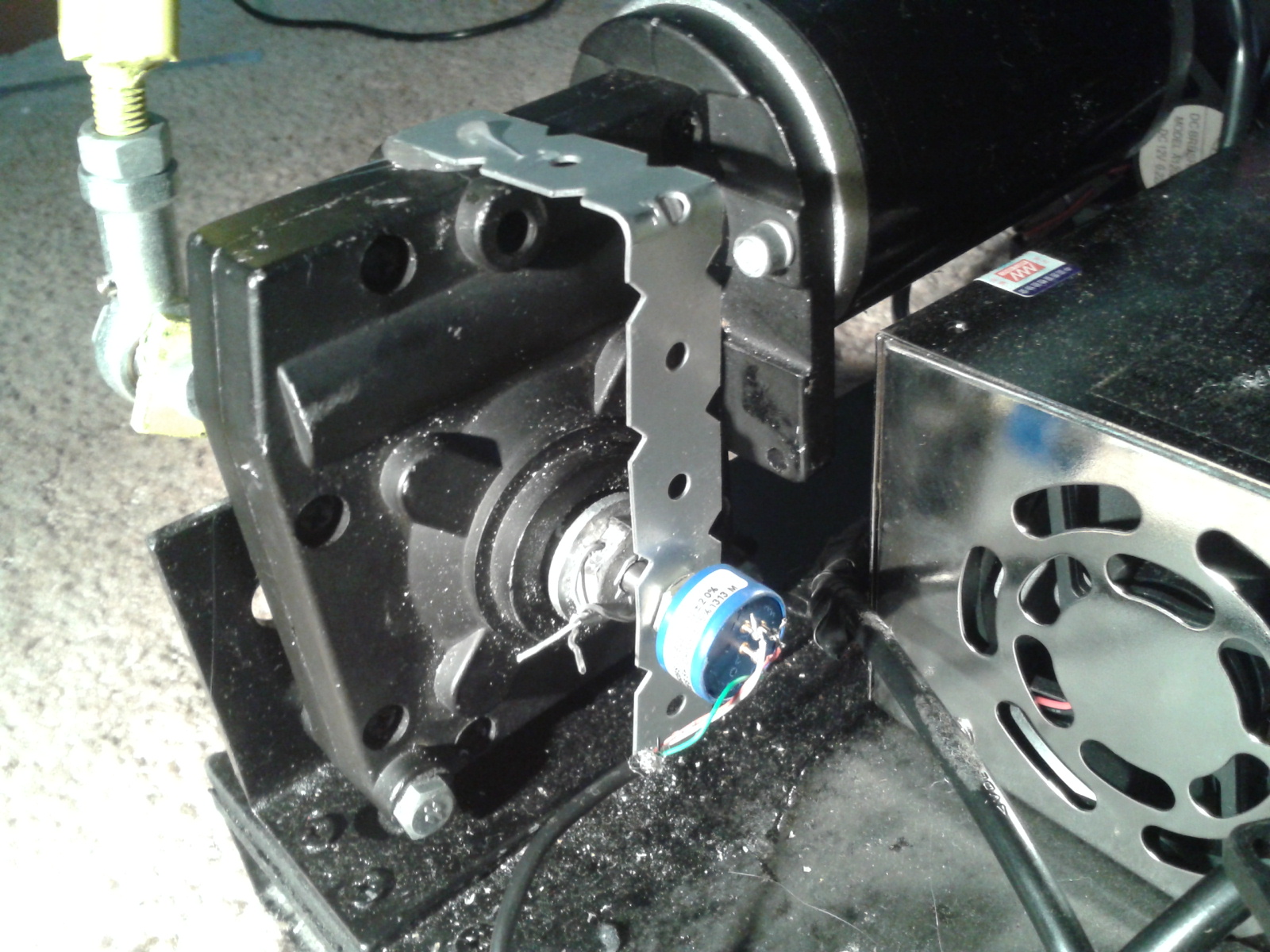

    Feedback is suggested a single turn 360 deg pot at 5k ohm and fitted to that back of the motor shaft http://au.rs-online.com/web/p/potentiometers/1642661/
    2014-03-28 10.35.20.jpg drill a hole in the centre of the bolt to suit the pot shaft size, line it up on a bracket and drill and tap a 3mm bolt hole into the shaft and put a small bolt into that to hold the pot shaft still, I know I drilled right through it all in the photo.
