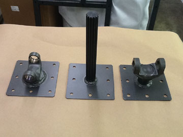

  3. cthiggin
    cthiggin Active Member
    Jul 1, 2012
    672
    Self-Employed
    Montgomery AL USA
    15,209Coins
    +435 / 0 / -0
    That's what I did. Found one (hundreds listed) here on eBay. Out of a Corvette. It was 30.00 US with shipping and had a brand new yoke and bearing installed.
    Cut it off at spline, welded it onto my steel plates, and it's going to be great. As Mike said, car scrap yards/parts yards to can get what you want. Here, in my local, I would of had to physically find one and
    take of off of the vehicle, THEN pay for it. For 30.00, I didn't have to go through that crap.

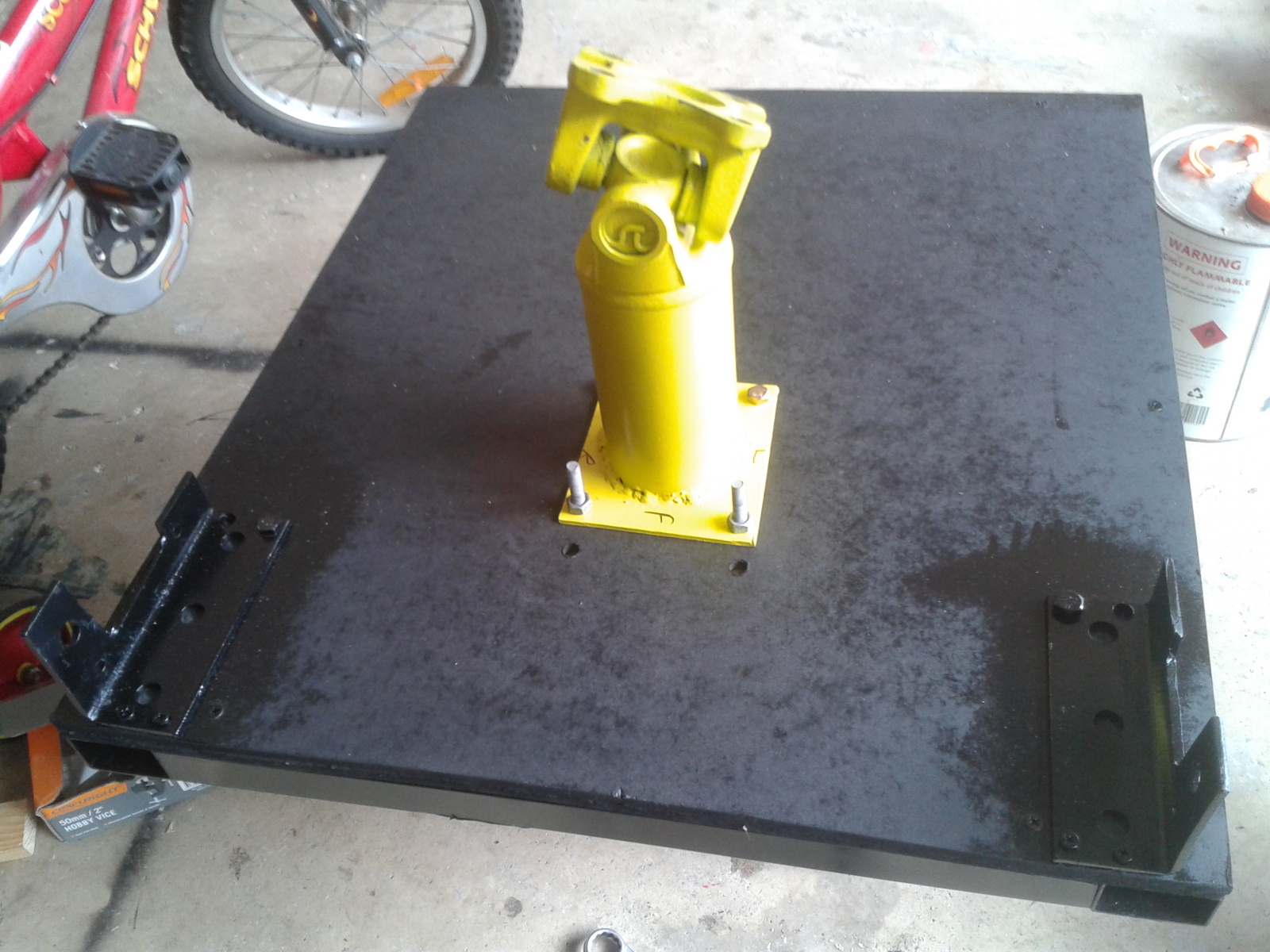

  4. bsft
    cut down driveshaft, not sure what car, but at $20, it was cheap enough to give me a pivot point, I welded a plate on one end.
  5. SeatTime
    2,573
    28,320Coins
    My local scrap yard has the stuff already off the cars on rows of shelving, as long as the bearings are in good condition and have no play which would allow the seat to twist then you will be OK.

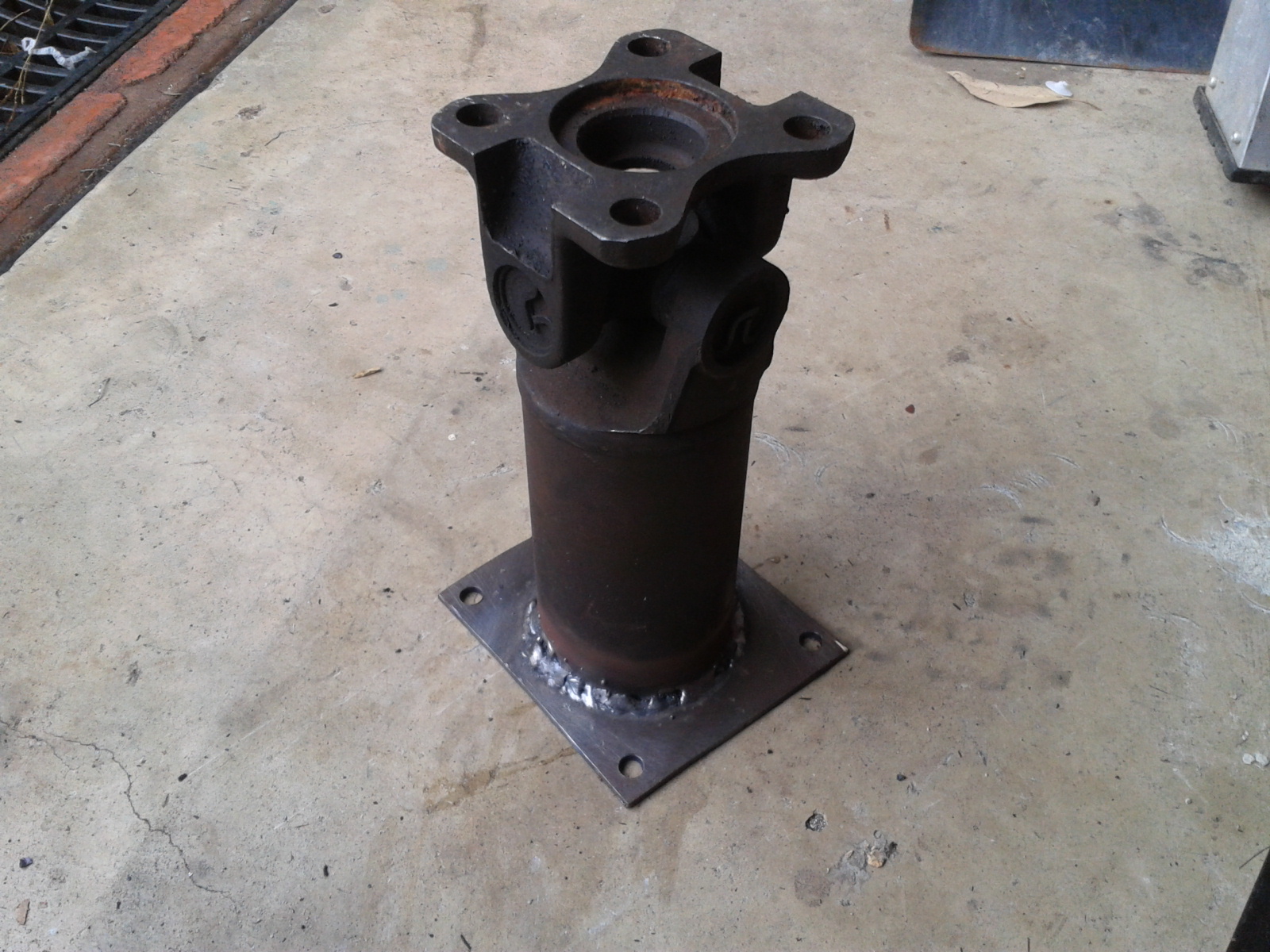

  6. cthiggin
    Jul 1, 2012
    672
    Self-Employed
    Montgomery AL USA
    15,209Coins
    +435 / 0 / -0
    Spline - U-Joint Painted - 022814.JPG SeatTime,
    @bsft and mine almost looked the same, BEFORE I cut my down and welded to plates and spline.
    Even if the bearings are rough, many times you can take the caps off, wash the bearing out, regrease and they're like new - did that many times many moons ago when I worked with cars.
  7. bsft
    @cthiggin , I got lazy and just gave the thing a quick clean and painted it. It didnt need a new uni joint as the old one was still good.
    Yours look real good though
