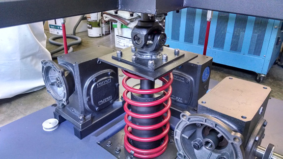

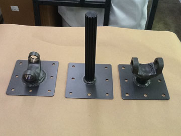

    Bought on eBay for 23.00 - cut them, welded to plates - 0 play in the journals.

    Hey cthiggin, if it's not a secret, what kind of spring and piston/shock setup do you have in that picture? I was thinking of having a setup like that under the seat for the heave axis.

    jimmcquade,
    After I finished with u-joint, plates, and my round tube with spline collar, I attached the assembly spline shaft/into/ spline collar, then measured the distance from base to the bottom plate holding u-joint.
    Took that base measurement - and added 8" - as my up/down movement is a total of +4" -4" for a total of 8" - then I could compute my spring length - CLOSED - add 8" + 2" more for load -
    In my case, I needed a 22" spring.............with the help of @speedy, here, and his use of a spring calculator, came up with the exact spring I needed. I only found 1 Spring Manufacturer here in US that would
    build me one. 325.00 US for one, 345.00 US for 2.... it was terrible expensive but it matches my platform, and top weight. This is an ASSIST spring and only helps relieve some load on the motor/gearheads.
    It is Matched to "my" platform.
    You cannot just go to a junkyard and pick up a used spring, as they will NOT match your heave movement in inches, nor will they match your top frame load.
    This was the most technical aspect of my build....but expensive - but I do know it matches my sim and works.
