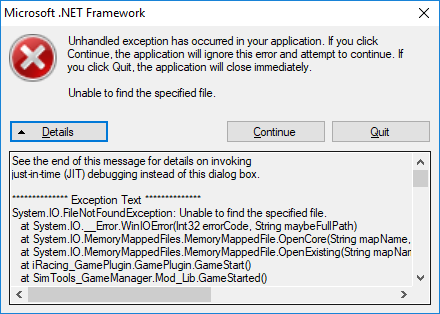

    This keeps happening. Any tips to solve it? It happens when I launch iracing.

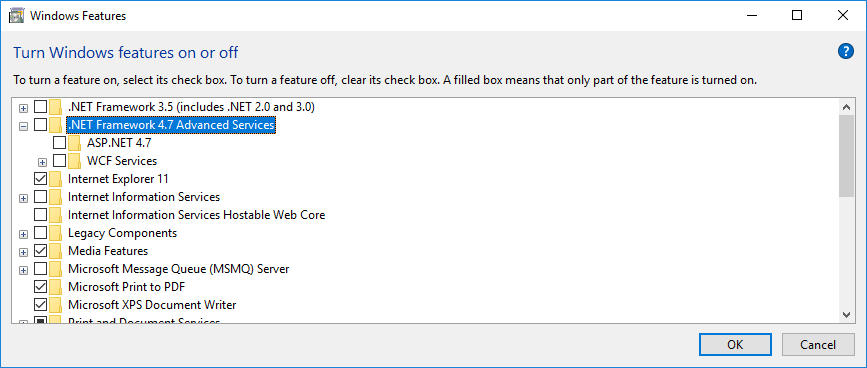

    Try this: https://www.xsimulator.net/communit...einstall-now-not-connected.10528/#post-136204
    • Close all running software applications.
    • Go to Windows Start Menu -> Control Panel -> Add or Remove Programs or Program and Features.
    • On the left column click turn windows feature on or off
    • Select Microsoft .NET Framework 4 Extended.
    • Click Change/Uninstall, Remove or Repair.
    • Select the Repair option, click Next.
    • The wizard will perform a repair on the .NET Framework installation.
    • It is suggested to restart the Computer.

    I don't see an option to uninstall repair ?

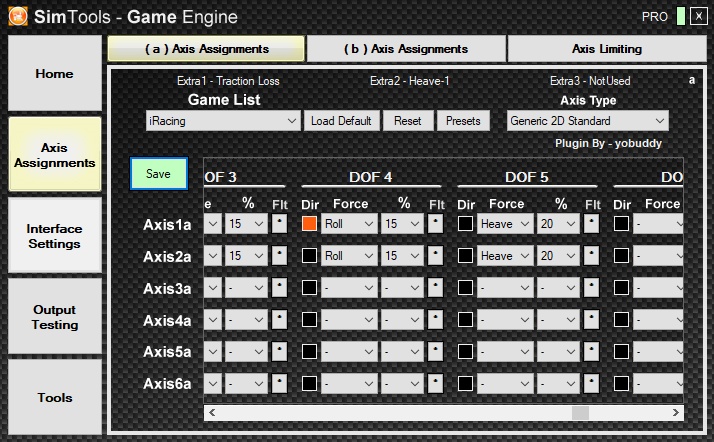

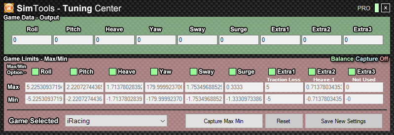

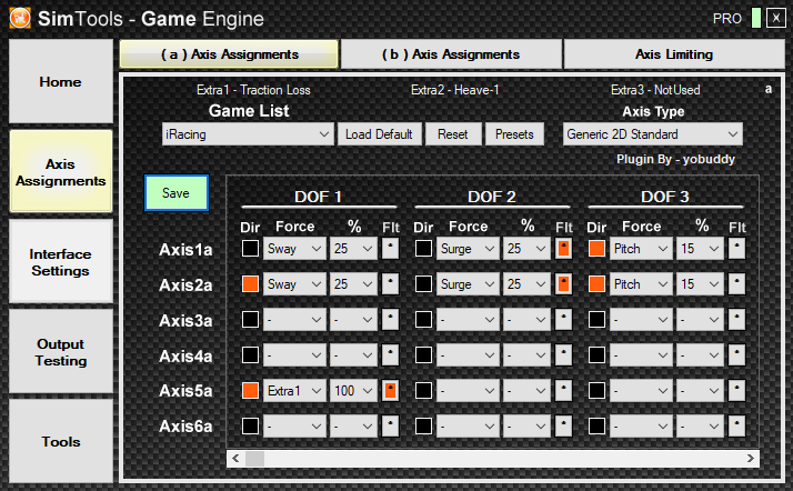

    That that ran and gave a message that there were changes to .net and rebooted. However, this hasn't solve a secondary problem, where the actuators start bucking like a wild bronco while driving. This start off smooth with the normal driving feedback, but a lap or two in, the simulator starts randomly bucking in an unnatural way. Thoughts?
    20,520
    144,950Coins
    +10,770 / 52 / -2
    That may be a setup issue: https://www.xsimulator.net/community/faq/steps-to-create-a-motion-profile.228/
    Or related to language settings: https://www.xsimulator.net/community/faq/simtools-language-setting-bug-change-to-english-local.233/
    Can you please post pictures of all your settings.

    English language setting is fine. I've been using the same setup basically for months since Patrick's associate helped me get setup. Like I said, it's hit or miss. If I reboot it usually solves the problem temporarily, but then it pops up again.
    20,520
    144,950Coins
    +10,770 / 52 / -2
    I don't use iRacing, but the settings seem to be fairly reasonable. So I would be investigating if there is perhaps a hardware issue. the game data or perhaps if something else on the computer is interfering.
    Does it happen with specific car or track, or with all cars and tracks?
    Does the rig experience that issue on any other game?
    Does it still happen if you disable peripherals, or perhaps firewall or anti-virus?

    Unfortunately, I'm not running any other games besides iracing. Car and track don't seem to make a difference. I don't have antivirus running on this computer. I'll check the firewall settings, but I think I have firewall turned off.
    Does .NET have to be a specific version?

    Thanks Buddy. Running your program above reset something and the actuator wonkiness stopped and things seem to be running normal again. Except for the exception still occurring occasionally, where I have to restart game engine and manager.
