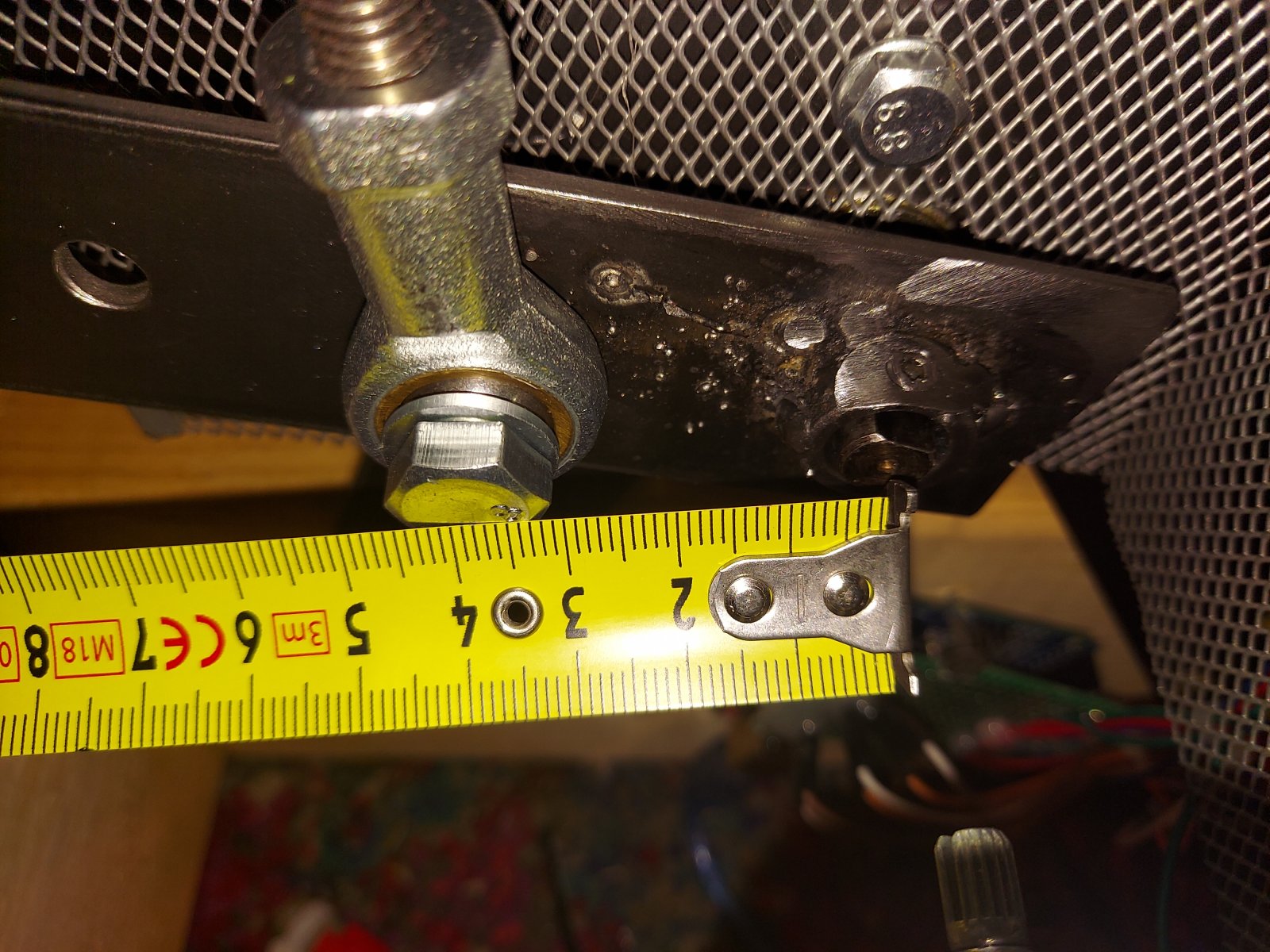

    The levers, as you have found, are way too long. With such limited inherent design leverage torque is really important, at a guess try about 40mm CTC on the levers.

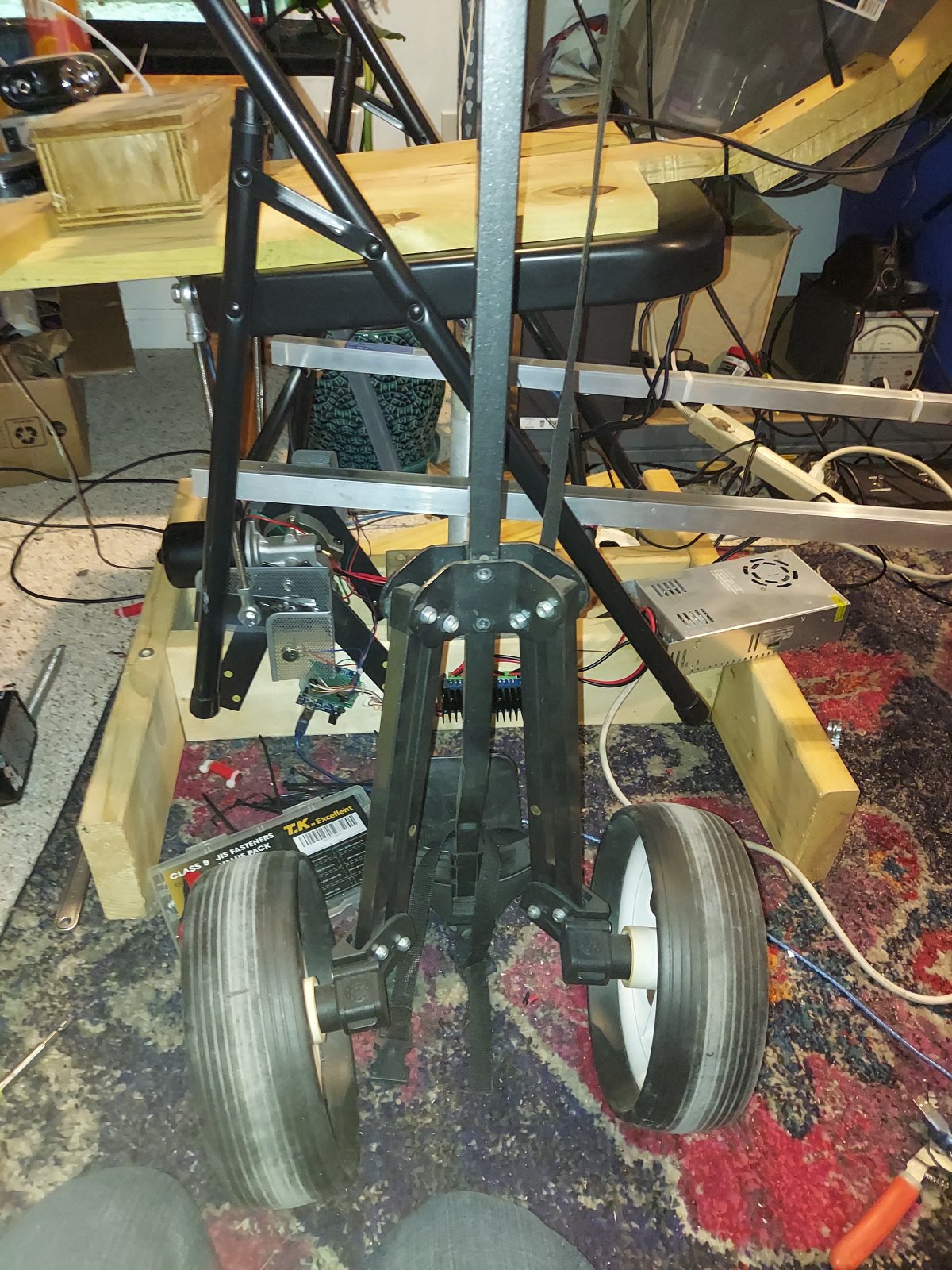

    The other issue is that the universal joint looks too flimsy and hence unwanted lateral twist is evident. You could use a bigger universal joint, say off an old car tailshaft, or consider panhard rods between the upper and lower frames.

    Thank you for the awesome tips. I didn't think about a panhard bar. That would be a quick and dirty way to stabilize it.

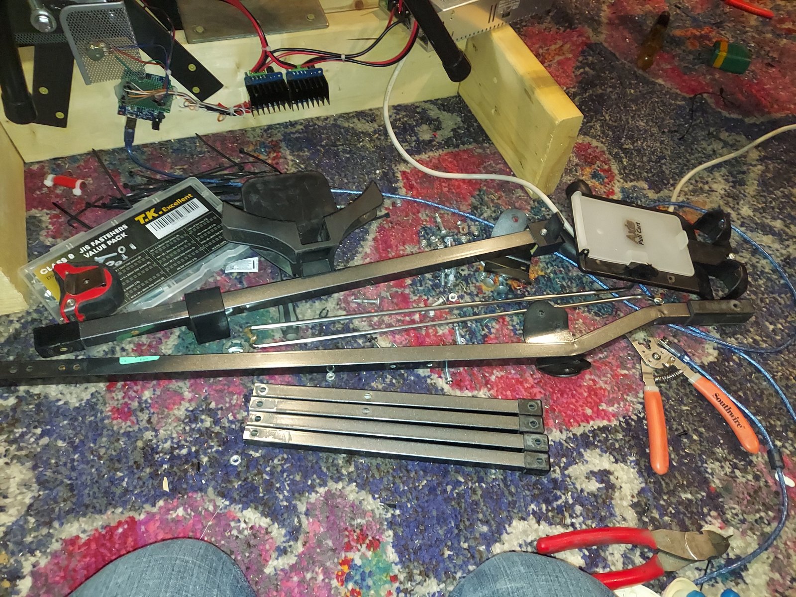

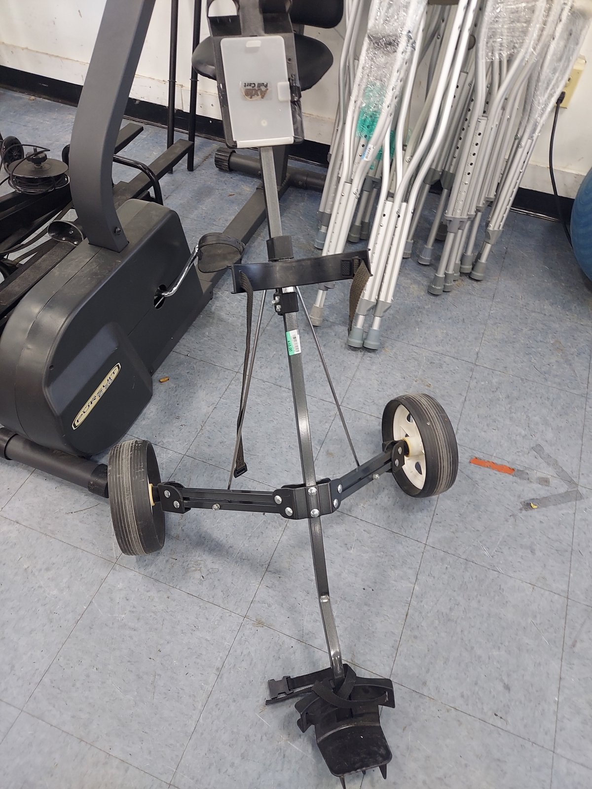

    I did some research on panhard bars and came across the Watt's Linkage. So I went to Goodwill and found a folding golf bag caddy for $10, took it home and disassembled it and now the sim rig has a Watt's Linkage. The yaw due to lost motion is SO much better. Thanks again for the great idea.
    I also took your advice and drilled the holes in the lever to 40mm CTC.
    I made a quick update video showing the Watt's Linkage.

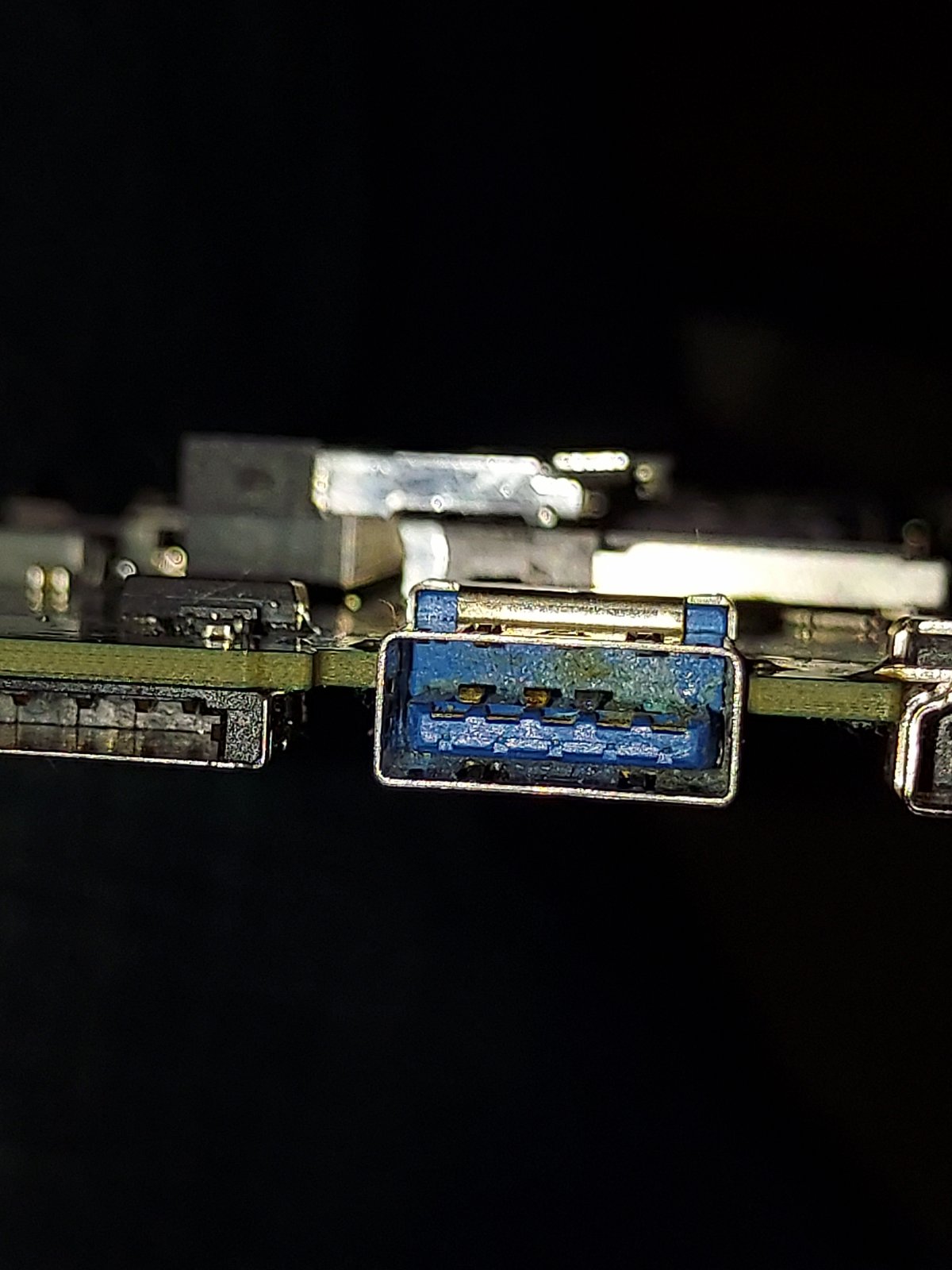

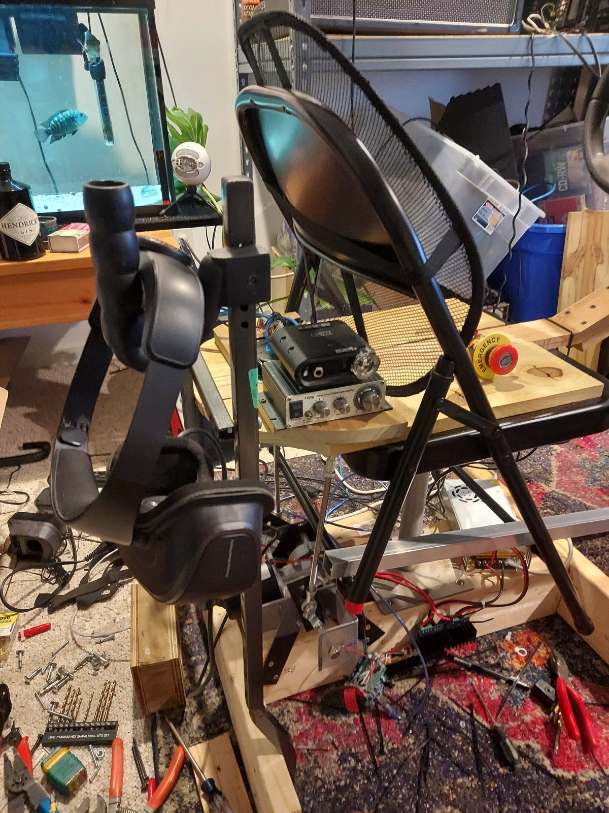

    It turns out the handle to the golf caddy also makes a good hangar for the VR headset. I sat on the chair and moved the seat around. It has much more power now and seems ready for its first real test with a game. Of course there has to be a hiccup right? I plugged my vr headset into my laptop and it wasn't turning on. I disassembled the laptop to figure out what was wrong with it. It had previous water damage that I repaired so I figured it was corrosion. It's an Acer Helios 300 with a 1060 gpu. Turns out there's a broken pin on the only Type A USB 3.0 port. I found the part on Mouser and will fix it when it arrives.
    There is a USB C port on the laptop but I don't have any peripherals for it. I did order a USB C hub which should provide the speed needed for the VR headset, I'm just not sure if it will provide the power.

    The down side of hanging a VR HMD like that is that it is tudned into a dust catcher, which is not good for the lens.
    You can make or buy a foam insert to protect the lens when not in use.

    I did a caveman fix on the laptop usb port. I just had to test this thing out. I finally got to sit in it and drive. I can't believe it!
