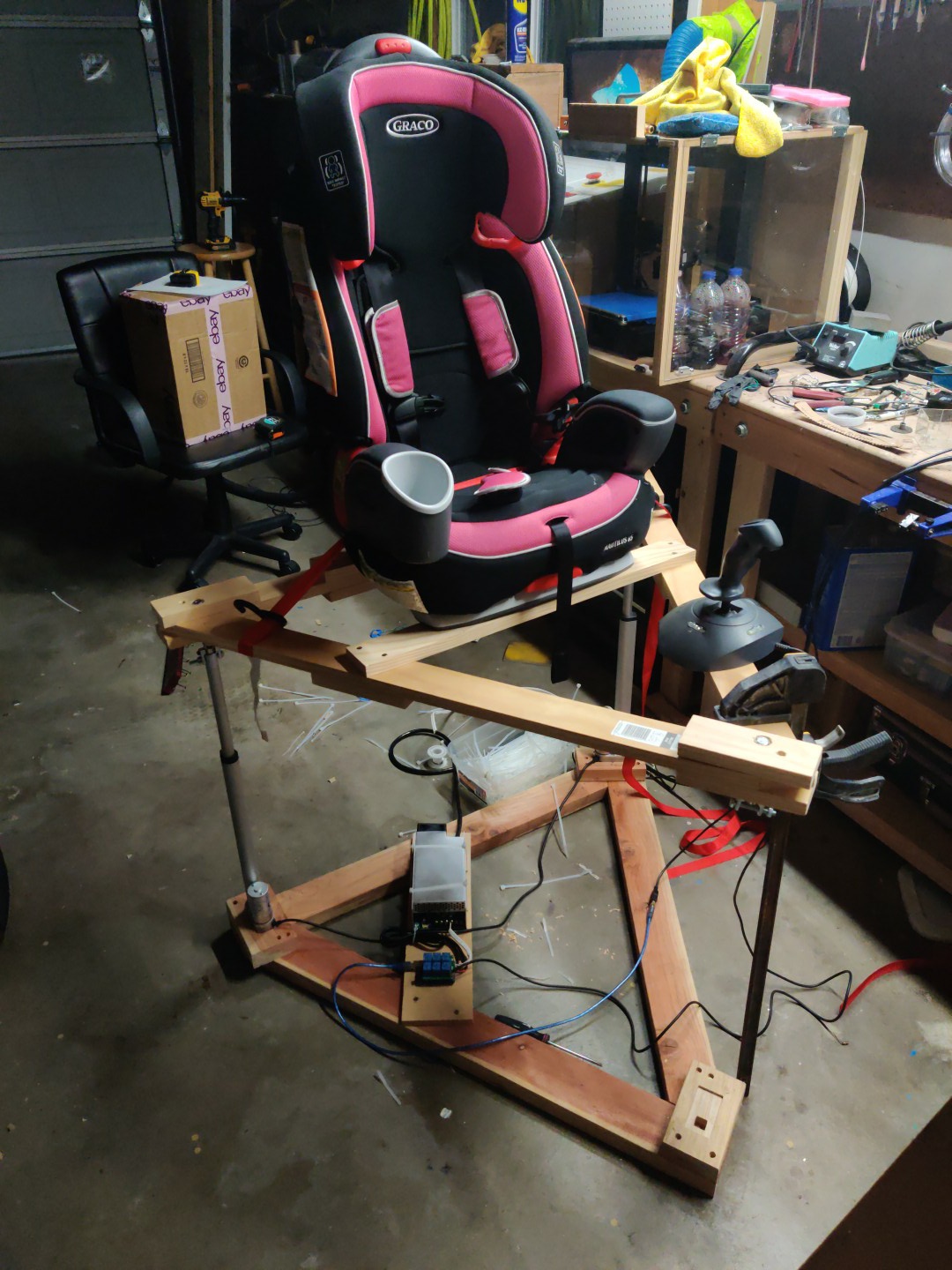

  9. vigilante397
    vigilante397 New Member
    Mar 12, 2020
    7
    87Coins
    +3 / 2 / -0
    Arduino, 6DOF
    Alright, been a little while since I've updated. I got the two other motors I had ordered, and they were significantly faster than the first despite being the same model from the same manufacturer, so I sent back the first one for a replacement, hoping to get all three the same speed. But before I sent the one back I went ahead and built my frame. The lower section is 2x4's, the upper section is just some pine I had lying around (ultra-cheap budget). I milled some brackets to hold the actuators to the frame and they fit great. It's not as sturdy as it would have been with a 6-motor stewart platform, but obviously it's half the cost, and pretty much all my cost right now is the motors, so if I bought 3 more motors and built a bigger frame I wouldn't be throwing away a bunch of money. Since the motors are really only rated for child-sized passengers my wife suggested strapping a car seat to the platform as a quick and easy way to get a good seat with a decent harness.
    I also got the PCBs I designed for the motor controller. I couldn't find anything ready to go that could drive a DC motor at 24V, so I made an Arduino shield using a bunch of relays I had around and that's the brain. It's ancient technology, but it's fast enough for my purposes, it's cheap, and I love the satisfying "click" when it switches on and off. I hacked apart an analog joystick and fed that into the Arduino for controls, and because of how simply I'm doing it the code only took about an hour to write. My power supply adjusts from about 19V - 40V, and with a 40 lb child sitting on the platform I'm getting 40mm/s out of the motors at 19V. I can get it up to 60mm/s or so, but it freaks out the kids, so I'm leaving it at 40.
    The new motor won't be here until Wednesday but it should be an easy drop-in and ready to go as soon as it arrives. For now I just have a clamp holding it so I can work on teh frame without the front falling down. So this is how it looks for now, and how it will look until Wednesday:

    Right, totally forgot to update everyone. So the good news is I got the replacement motor and everything worked great. For about an hour :roll These motors really don't like being on a flight simulator. I had them overheat to the point where they wouldn't work until they cooled down several times, but eventually one of them got to the point where it just wouldn't go period. Whoops. 10% duty cycle is 10% duty cycle. But the kids had fun with it while it lasted. I got a couple videos of some tests I was doing with the Arduino, but I only really got one video with the thing moving, and unfortunately I didn't have the seat strapped down tight enough in the video so my daughter had a bit of a scare :p Anyway, here's the first trial run with my brave test pilot:
    While I was waiting for the new motor to show up I was in the process of designing a fancy cockpit display for the kids to play with including a little OLED display that plays nicely with the Arduino. Here's a couple videos I shot of what I had it doing. And the clicking you hear in the background is the relays switching. Love that old-fashioned sound :p
    I learned a ton, and the kids really did have a good time. After the motor fried (fortunately I was still able to get a full refund from Amazon) I had a talk with the kids, and they agreed that swapping a motor once or twice a week wasn't worth it, so the project was dismantled, and the two remaining good motors will be put to use as automatic gate openers on the side of the house. We agreed that it was fun enough to do something like this again, but we're going to wait until we can afford a much bigger budget. I've been looking around getting quotes and the cheapest actuators I'm seeing that would actually do a good job are about $300 each, whereas this whole build was right around $200. Could happen in the future, but probably not super soon.
    What did I learn?
    - $60 motors won't cut it. They aren't fast enough, and they don't have feedback, meaning all positioning has to be time-based, making it inaccurate.
    - the Arduino Uno is looking like it won't cut it. Maybe it was the way I wrote the code, but when I was running the OLED screen giving position information and I changed directions too fast it would lock up and restart (as seen in the first video above)
    - Relays? Seriously? If I were doing it for real I would use solid-state motor controllers instead of relays. The only reason I used them was that they worked okay and I already had a box of 8 lying around from another project.
    - Maybe less DIY. Doing everything from scratch was fun, but I would love to have a rig that I could connect to a computer and run games and simulators like the serious builds I see on here. Doing that with a scratch hardware/firmware build isn't impossible, but with all the stuff already available out there it would make sense to look at commercially available controllers to take advantage of what's already been done.
    Anyway, I had fun, hopefully you had fun watching and reading this. I don't regret building it the way I did this time as a first "hello world" into motion simulators, but I treated this more like a toy from the get-go, the next time around will be a bit more intense ;)
