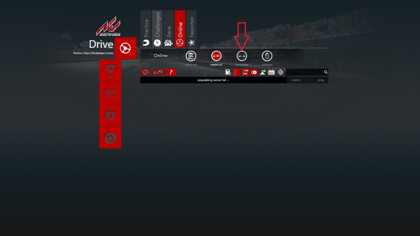

    I'm digging out this old post. Although I have a T1000 3DOF, I have little knowledge in the rig command and it was a pain in the neck having my rig working properly. I know almost nothing in computer science and the various needed software. My project is to add another T1000 3DOF in the room, and to make it simple, buy another computer for this second rig. I understand that the two rigs could compete through an internet connection. Unfortunately, the internet connection in the room has a very low rate and even disconnects sometimes. Thus I have to find another way of having the two rigs talking to each other if this possible. Any idea how I could achieve that? With limited technical language please!
    Thank you for your help, and sorry for my low level technical background.
    Regards
  19. noorbeast
    20,520
    144,950Coins
    +10,770 / 52 / -2
    I think what you want to do is called LAN enabled racing, where you race against a competitor using your own network. I suspect that you may already have a LAN setup, or could easily set it up, depending on your network hardware. but worst case you can have a simple LAN between 2 computers: https://blog-archive.josephcs.com/setting-up-a-simple-lan-connection-between-2-pcs/#main_content
    Games that support LAN will implement the interface in different ways, here is Assetto Corsa as an example:
