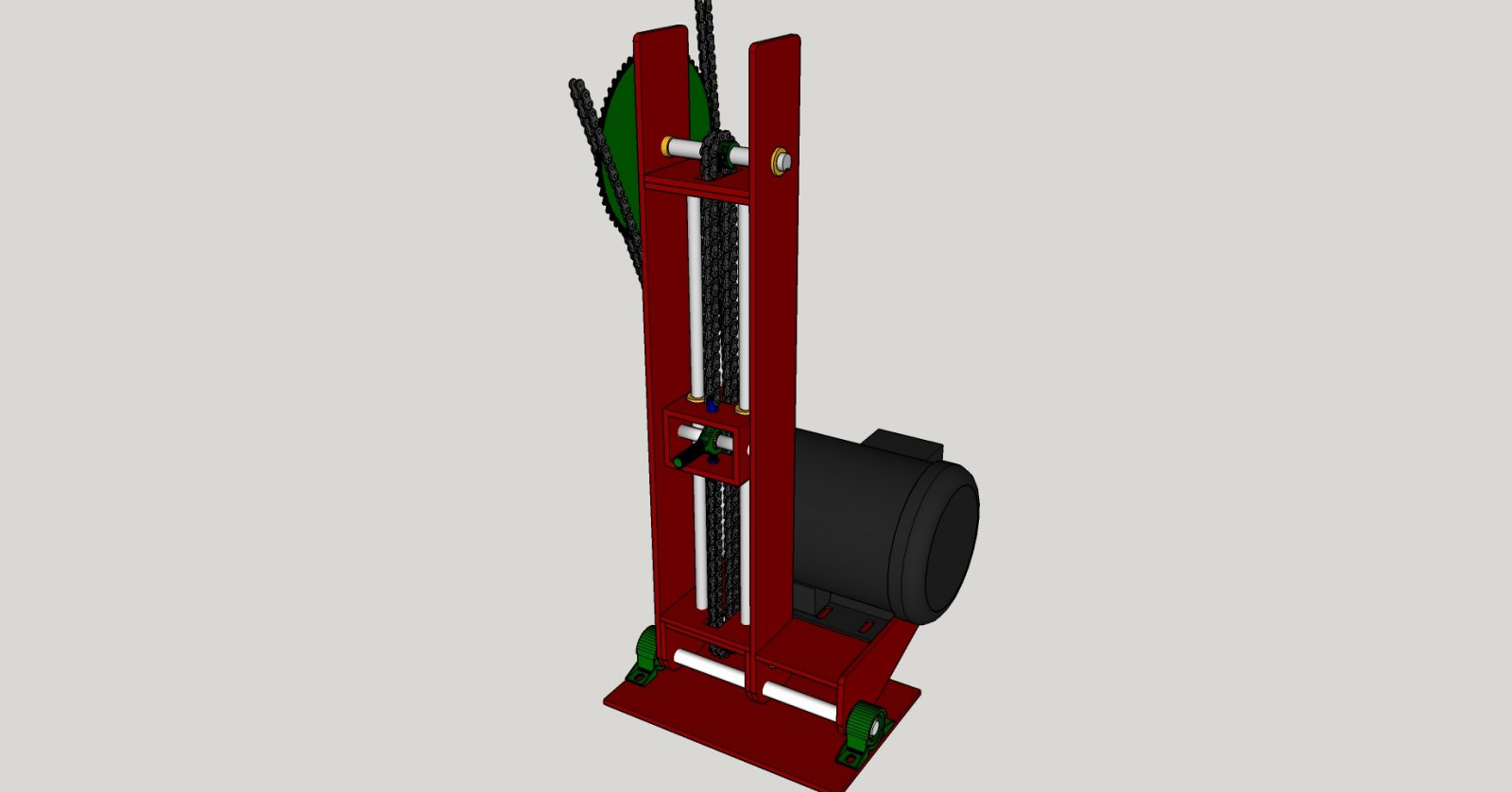

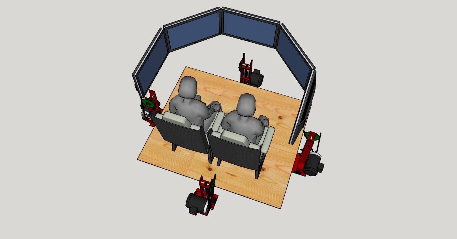

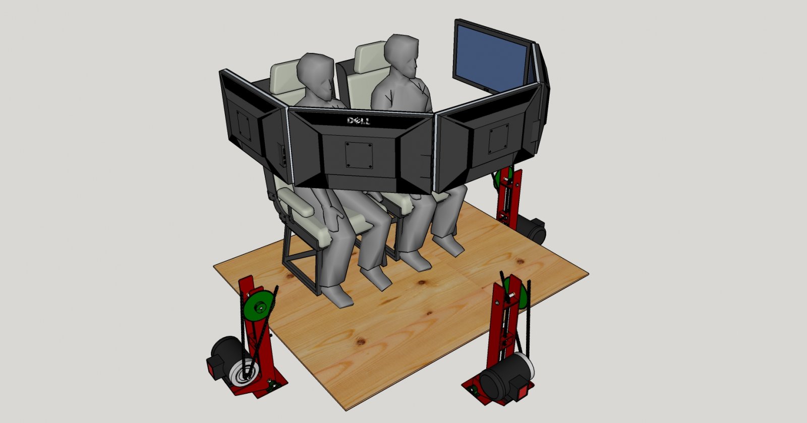

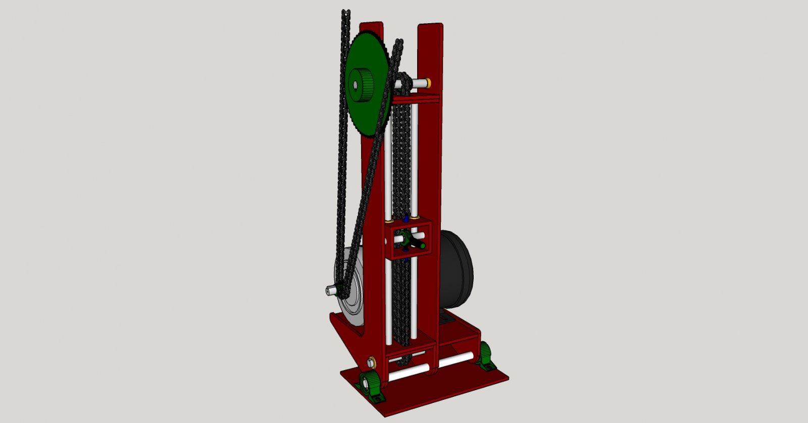

    Hello All,
    I opening this thread to record my build progress.
    I'm a former embedded software developer, recently turned into a R&D supervisor that been dreaming of building a two seater so that my dad and myself could keep flying together once he loses in pilot license.
    Watching Roland Schieller's 2 DOF platform made me realized it was possible with reasonable parts.
    Like Roland van Roy I have a limited ceiling height constrain so I had a pretty good idea on how to attack the problem after looking at his DIY Motion PlatformIII http://www.simprojects.nl/diy_motion_platform_iii.htm
    I still had one major problem. Maybe it's was in my mind but , I leave in Quebec/Canada I found it hard to find mechanical parts and precision metal working suppliers.
    That all changed with my new job. I finally got the chance to meet very nice mechanical people that are building machines for a leaving and now I know about suppliers like:
    I also managed to find an US company http://www.automationdirect.com that sell AC/DC motors, VFD drives and gear boxes at a very reasonable price.
    My platform's characteristic would ideally look like this:
    • 1.8m width x 1.5m length
    • 2.13 m : Max Height including motion & heave
    • 180 View : With 5 27" LED monitors
    • 275 Kg : Max Platform Weight
    • 20 deg : Max pitch and roll angular movement
    • 35 deg/s : Max angular speed
    • 0.080 : Max heave movement
    • 1G : Max heave acceleration
    • 4 actuators
    • Actuator driven by 1-2 hp, 220 v, 3 phases, AC motor with VFD drive
    • 24A @ 220V : Max source power
    I'm at the design stage and I working at obtaining the drive motor characteristics from the platform parameters instead of designing the platform from the motor specifications.
    I have been working for the past months on a set of spreadsheets that allowed me to reproduce a CKAS like platform that could not fit into my basement.
    My newest version aims at designing a DIY Motion Platform III like platform that is not making use of cables and without a central pin for preventing swinging motion.
    My ultimate goal, other than having my own platform, is to provide all spreadsheets, plans, technical knowledge I gained while building it to the community.
    I'll surely have questions has I have not been doing maths and classic physics for the last 25 years but I'm sure it will be a fun ride building it.
    I'll leave you with some images of what is to come and will be posting progress as I make them.
    Platform MK-1.1
    Actuator MK-2.1

    Those are early conceptual sketches done with Sketchup.
    I'll be finalizing them once my calculations are completed.
    I'm trying to design them so I won't require soldering to assemble them.
    I'll then have to learn Autodesk Inventor and redraw then to have a metal shop lazer cut the parts.

    I think they'll be made of 6 mm steel and about a 1 m height by 20 cm wide.
