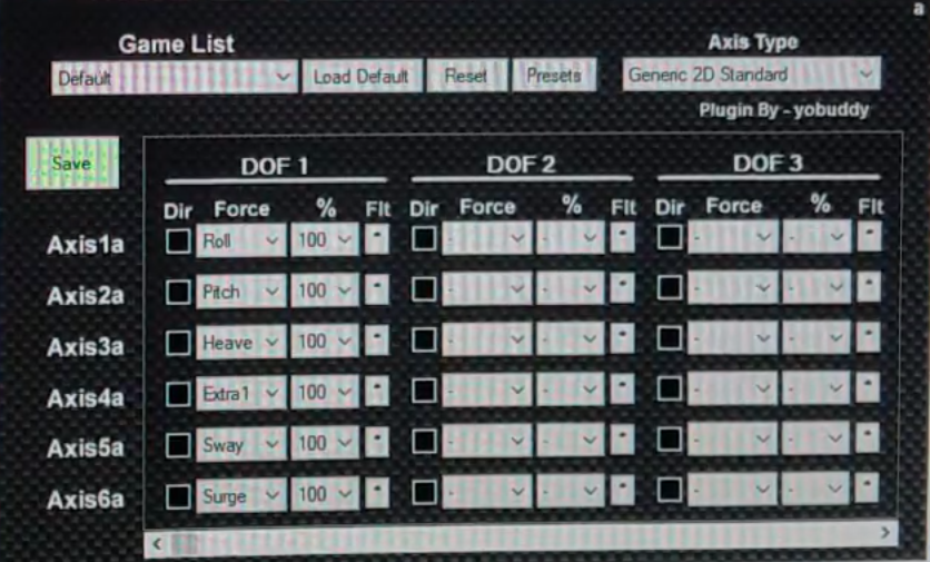

    We have built a motion platform based on SimTools and HeXpod.
    We have some issues with that acceleration is not simulated. (By pitching backwards)
    How could we fix that?
    See picture of our settings.
    Victor

  6. hexpod
    hexpod http://heXpod.xyz
    Apr 18, 2016
    1,218
    berlin
    7,838Coins
    +376 / 5 / -0
    DC motor, 6DOF
    In the column “DOF2”
    - next to roll, you choose sway
    - next to pitch you choose surge
    Apply strong smoothing
    Do not use washout
    Simple.
