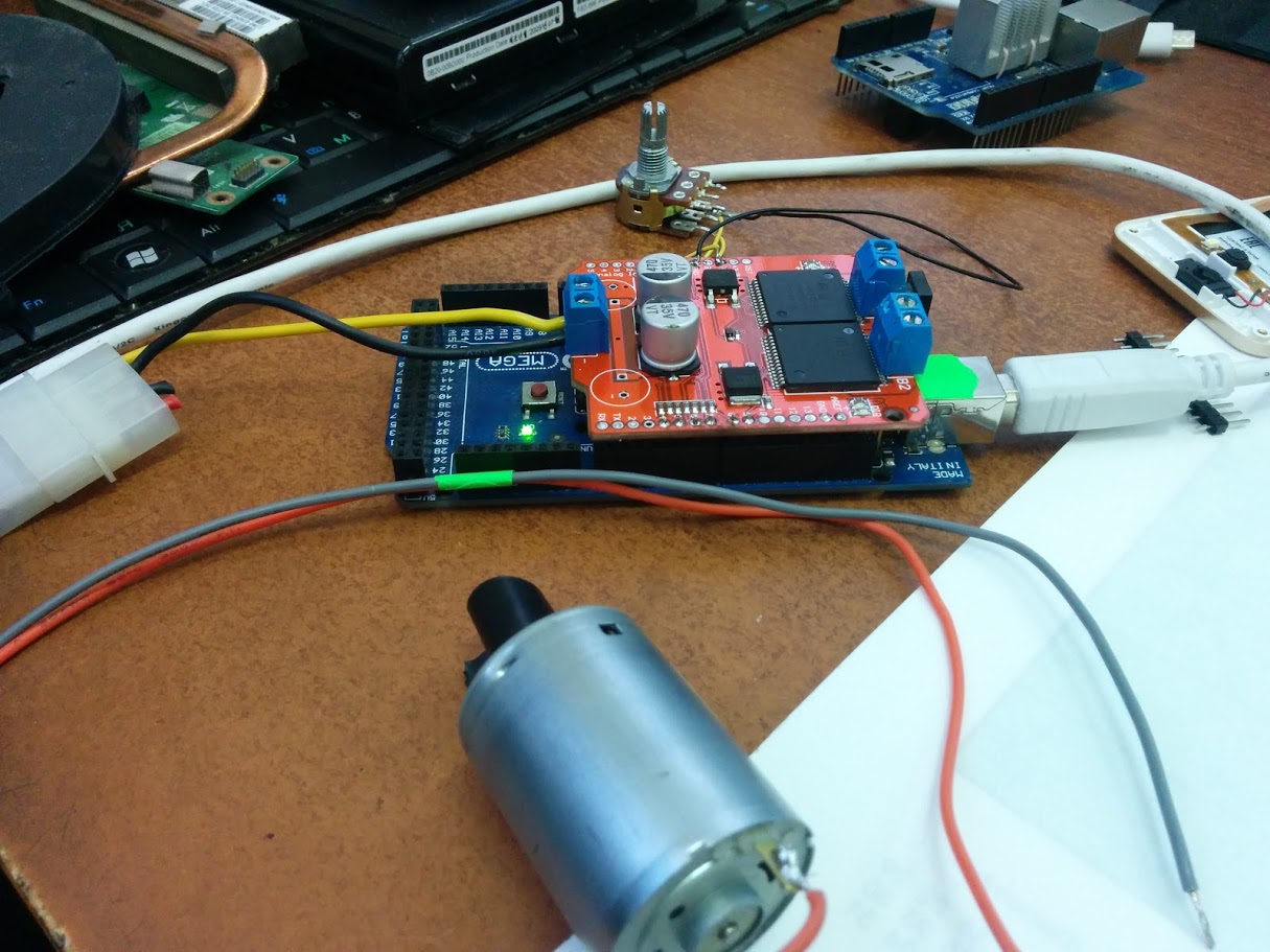

    Trying your hand at building a simulator in the Arduino.
    Please do not blame) As far as I correctly translated the rules. I need to collect 250 coins that would test the program simulation.
    At the moment, I bought fee monster motor driver. I beg your Arduino now have a response from the variable resistor.

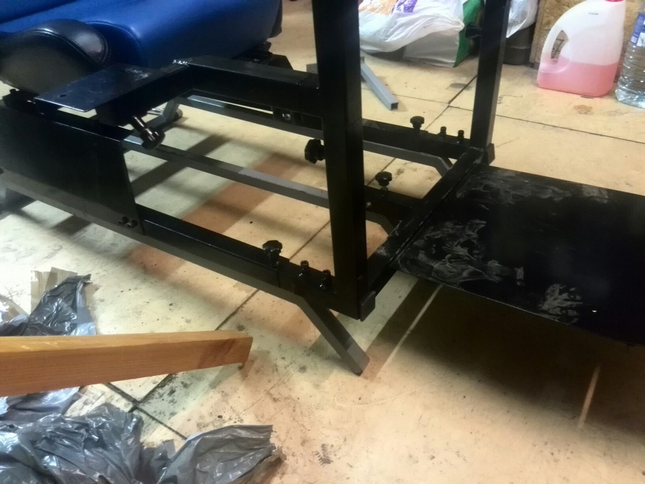

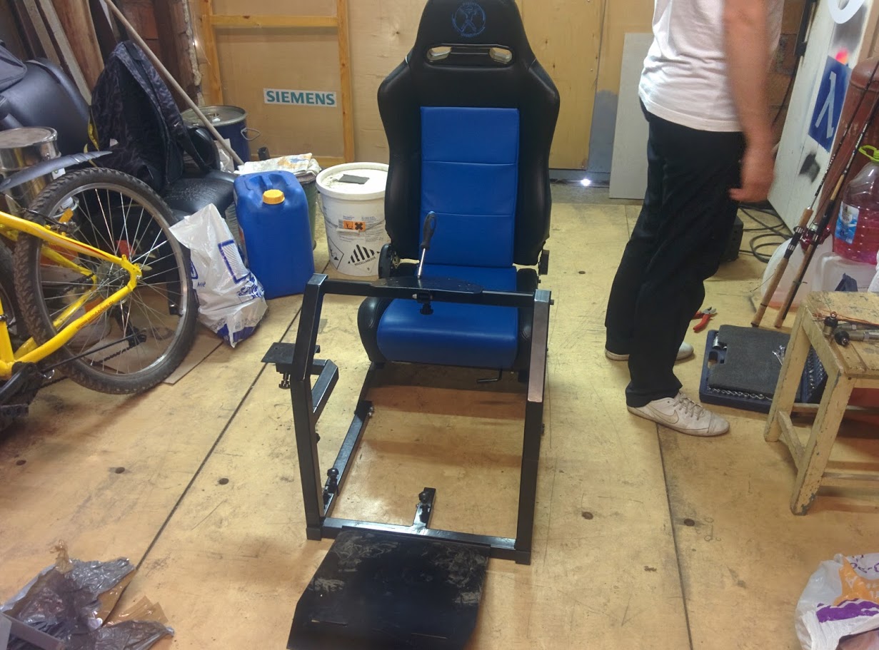

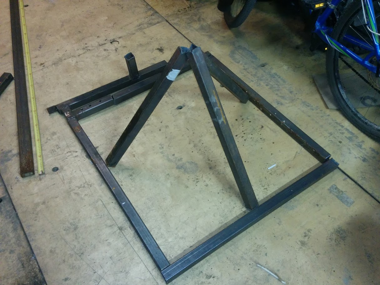

    wiper motors were purchased from Russian truck KAMAZ engine number 16.3730. 24 volts.
    Already it has igorovogo frame of the chair.
    Now we cook the bottom part of the frame where it will be attached to the chair hinge.

    Привет, как ты планируешь использовать движки от камаза (24В) с МонстрЩитами, если он расчитаны до 16В?
    How do you plan to connect the gear motor (24V) to the Monster Moto Shield, because it is rated to 16V?
  9. testlab
    testlab New Member
    Jun 2, 2016
    8
    33Coins
    Привет) Я подключал вроде работают шустро (уже почти собрал стенд сниму видео как работает)! Если будет не хватать то поставлю Motor Driver BTS7960 43A .
    Просто сначала купили Monster Moto Shield а потом подвернулись моторы почти даром)
    Hello) I connected like working smartly (almost assembled stand shooting video how it works)! If you will miss then put Motor Driver BTS7960 43A.
    Just bought the first Monster Moto Shield and then turned up the engines for next to nothing)
