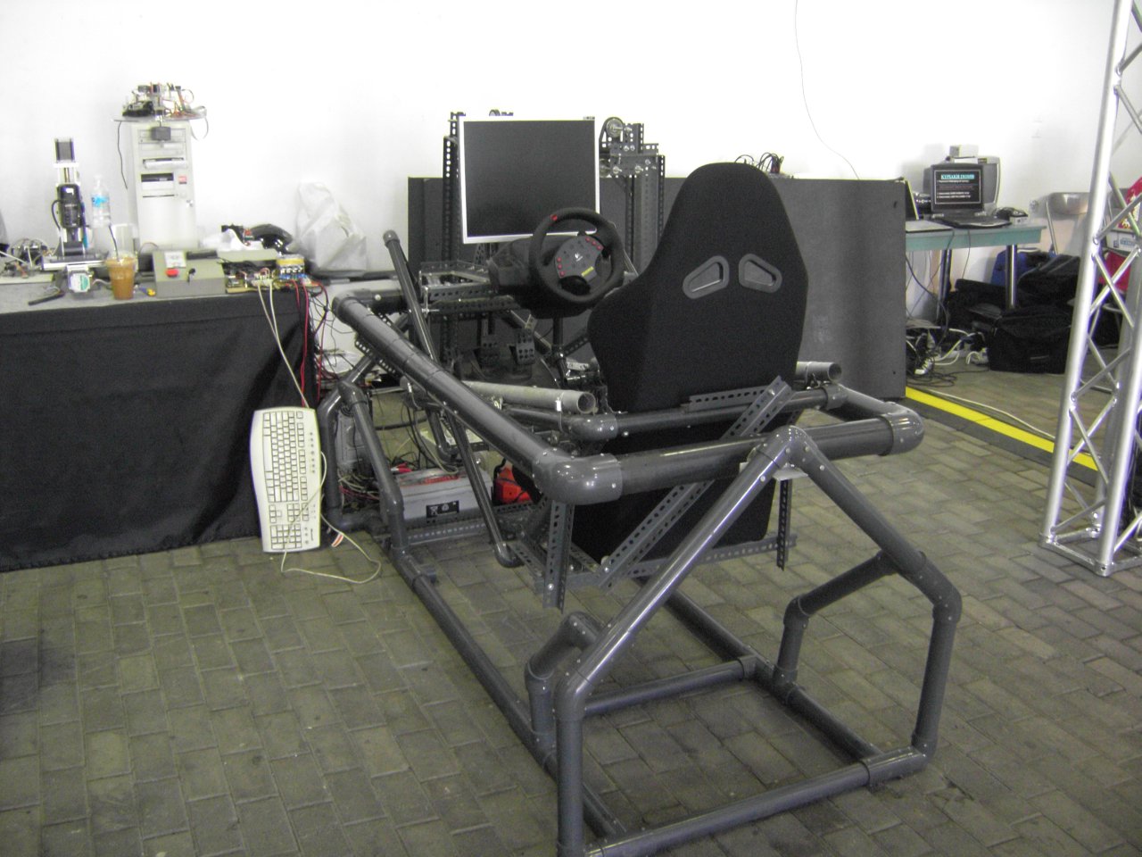

    This is my full motion simulator that I recently converted it to car racing simulator with the use of x-sim software.

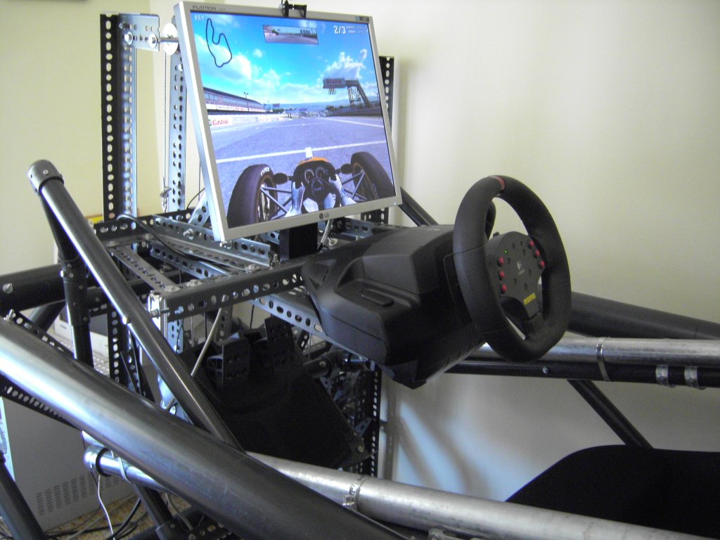

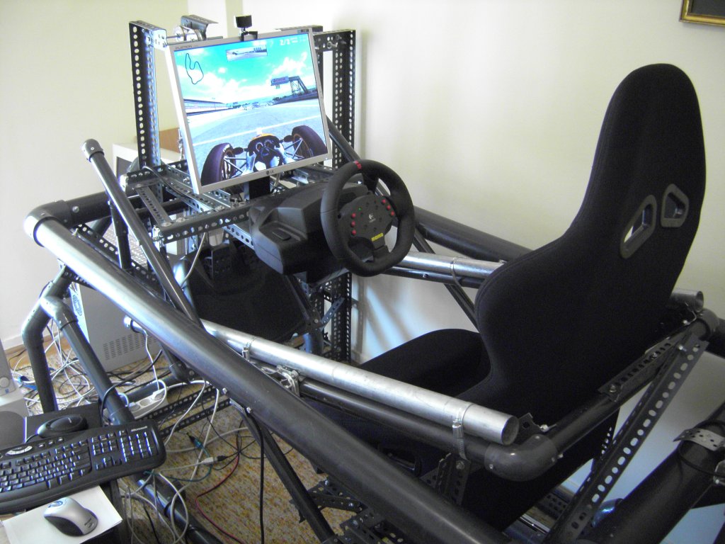

    Its based on the old joyrider design but I motorized it with the use of car windshield wiper motors.
    On earlier videos I used a Basic Stamp2 microcontroler to read the data from the USO interface of the x-sim. And the motors were driven with the use of Parallax's HB-25 motor controllers that converts the wiper motors to big servos! But now I moved on to the advanced motion control methods with DIY motion controller interface AMC1.5 and my own DIY h-bridge motior controller DSMhb1.2b. See more info about it here:

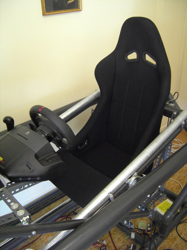

    Hey Thanos
    Congrats! The movements seem quite perfect!
    It should be noticed, that the entire construction is made without soldering. All parts could be purchased via the local DIY store. And the racing seat is a really great inmprovement!

    Yes the gear effect isn't notisable in video but its there. You can feel the small vibration during the shift changes. It is more notiseable on slower cars that take more time to shift...!
    Another thing is that I filtered the sudden moves to the half (using the smooth sliders) to avoid braking apart the motors! It needs more tweaking in both x-sim software and inside the microcontroller code to find the best conbination of safety and speed. After all the motors behave as really big servos they just follow the position point that x-sim instructs. No washout is implemented at all!!!

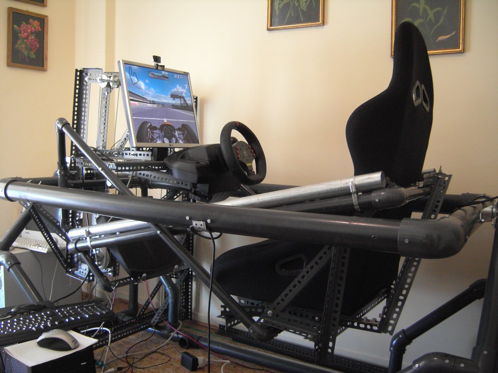

    Thats really great. The movement looks very acurat and precisly...and fast!!!
    As longer as i a watch your movie, i like the construction of your frame more and more, although it does not fit in every livingroom due to the size of it.
    your interface works very well...nice work!!!
