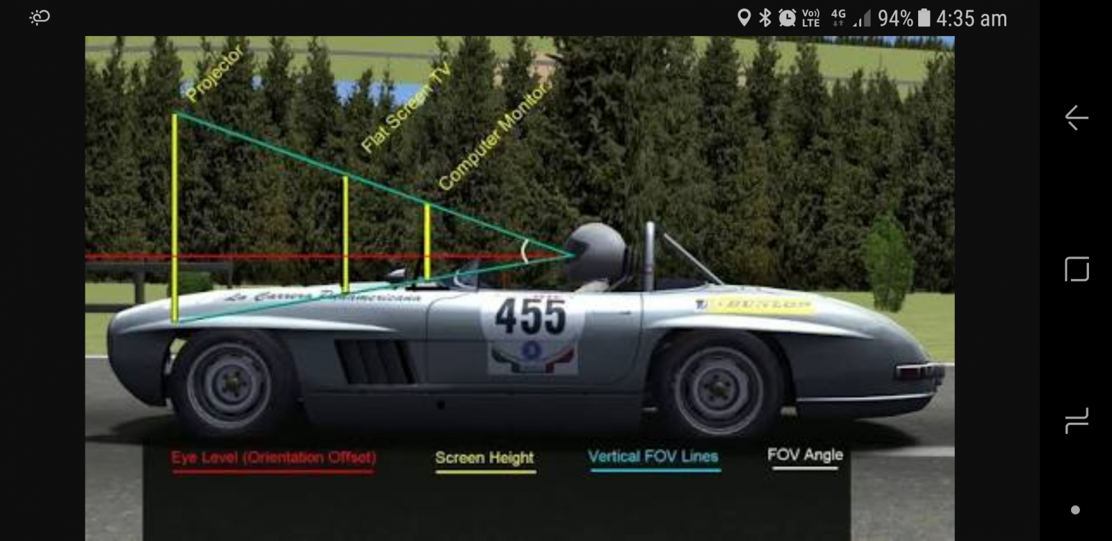

    Gday Nick. You must have a head Luke a shark. Lol . Check out field of view vids on YouTube bud .
    To get proper immesion(180degre veiw)you must set up your monitors corretly. I have mine set like this.
    Center is 550mm from my eyes and the sides are set up at 45degres from that. No the outer edges of the outside monitors are at the end of my perifial vision. Witch gives you 180degre veiw. If you set your field of view correctly it dose not matter the size of monitors you have you move them closer or further away to get the same immesion.
    Yes my hands are close to my monitors but they are set correctly . I can't post vids yet but when I can I will show the importance of correct fov for full immesion.
    It was a $ thing for me $150 per 1080p 1ms 24 inch monitor @75htz or 4 to 500 for 32 inch tv' of around the same stats.
    Hmmmm 3 monitors for the price of 1 and they weigh 3 times as much as well.
    Imo bigger would probably be better but if its a $ thing like me do some research and you will find the same thing I did you don' have to have the bigget to be the best
    Cheers scotty

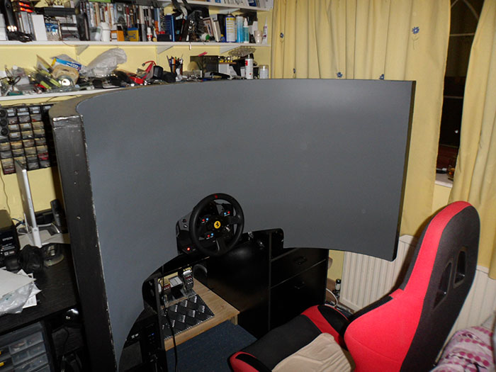

    Projector wins!
    Linky : http://www.projectimmersion.com/rig.php
    We can all go home now.
    Seriously though, buy the biggest triple screens that you can afford with a resolution that your computer can handle.
    No point going 4k or 120Hz if you have a potato graphics card. 60Hz is perfectly fine as higher refresh rates are mostly advantageous for FPS games as opposed to sim racing/ flight sims.
    Response times below 10ms will be completely fine again. With TV's you have to be careful about input lag though as some cheaper TV's can have input lag of around 200ms!!! The better TV's can offer what is called "gaming mode" which reduces input lag considerably but slightly increases response time.
    Isn't technology just fun!
    Either that or buy occulus/vive :D.

  13. Nick Moxley
    17,054Coins
    +2,504 / 30 / -2
    Sweet setup Alexey, Seeing my hands on the projection would drive me Banannas. lol But ya that looks Bad A** i must say. Any way to prevent that issue ? like an Icarus setup or how is that drastically different to yours ? Single projection VS double i guess right ?
  14. Alexey
    Alexey Well-Known Member
    Sep 23, 2014
    452
    Electronics Technician
    Adelaide, Australia
    8,060Coins
    +620 / 2 / -0
    If you were really tricky you could have a cutout placed in front of the projector to block that part out.
    This isn't my setup if that what you were thinking.... But I can dream :D.
    2 or 3 projectors would be awesome though, as It would enable you to encompass your entire view to give a really great immersive experience.
