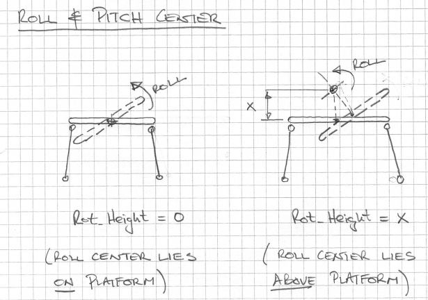

    Also a quick question: I'm told that SimTools/XSimulator does not offer adjustable roll center (or COG), has this been added or can it please be added? This is to have the center of rotational movements be around the center mass of the pilot/driver instead of the center of the platform.
    Credit for this image- Ian's BFF
  3. SeatTime
    2,573
    28,321Coins
    There is a separate 6DOF module coming out with Simtools V2, but I don't know if it will support variable Roll Center? Although I do own a copy of BFFs software, built my sim so that the roll center is close to were it should be without using any special math modules. Don't forget - simtools was not designed for 6DOFs with the majority of users having 2/3 DOFs sims.

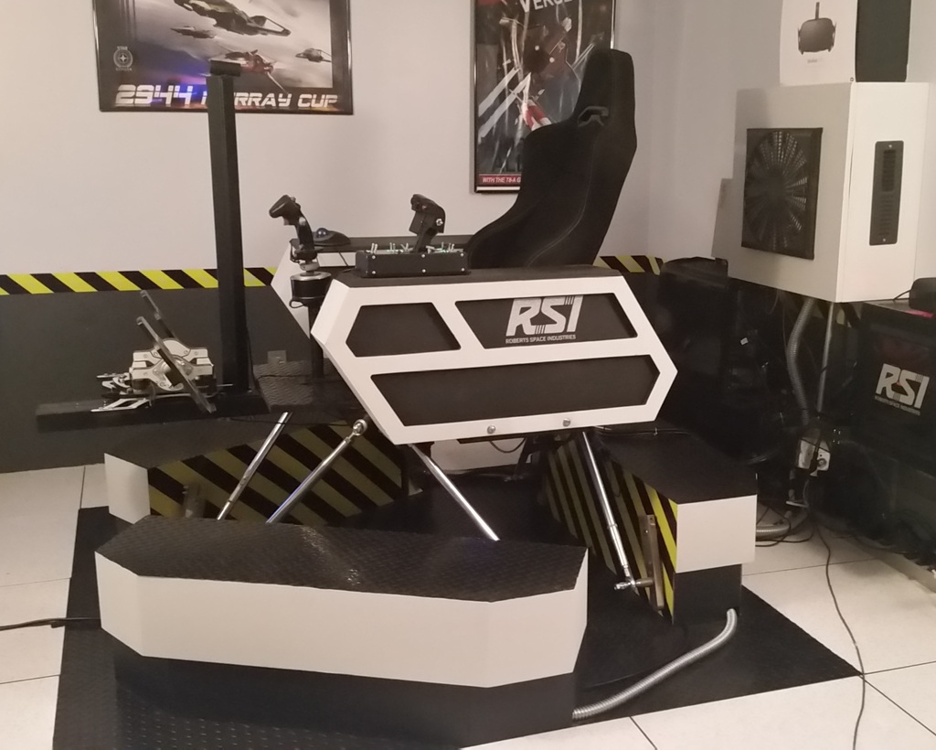

    Hey guys, I haven't forgotten this thread! Updates coming soon, been working on the final polish on my Rig and will be showing it off plenty once it's properly done.
    Since my last post here I eliminated the once pieced hex shaped bottom bracing structure in favor of three separate enclosures (one for each actuator pair) which are still under construction. I also fabricated my steel top hex platform and got that installed, I couldn't believe how much a couple hours of testing and tuning wallowed out the holes in my temporary wood top platform!
    I've also spent several hours tuning for P3D and took my first test run in Dirt Rally which needs a LOT of tuning work! Next up for setup and tuning is going to be DCS world and then hopefully Elite Dangerous. Where's mah SimTools 2.0 @eaorobbie ? <3
    As far as the physical build here's the to-d0 list:
    *Finalize actuator covers design, build them, paint them.
    *Build final interchangeable mounts for Joysticks, throttle, trackball, pedals, Rift camera, steering wheel, H shifter, racing pedals.
    *Brace forward platform area from underneath for rigidity, possibly by welding a brace to the top hex (which will require disassembly of upper platform)
    *install rubber diamond plate flooring covering to upper platform

    Here's a photo for you obobo! Basically finished as of yesterday =)

  12. noorbeast
    21,556
    150,956Coins
    +11,025 / 56 / -2
    Your craftsmanship is superb, a true work of art :thumbs
