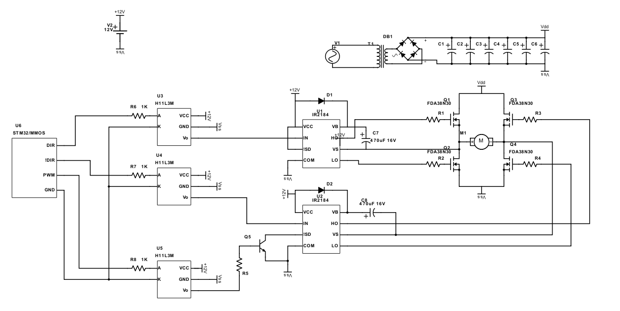

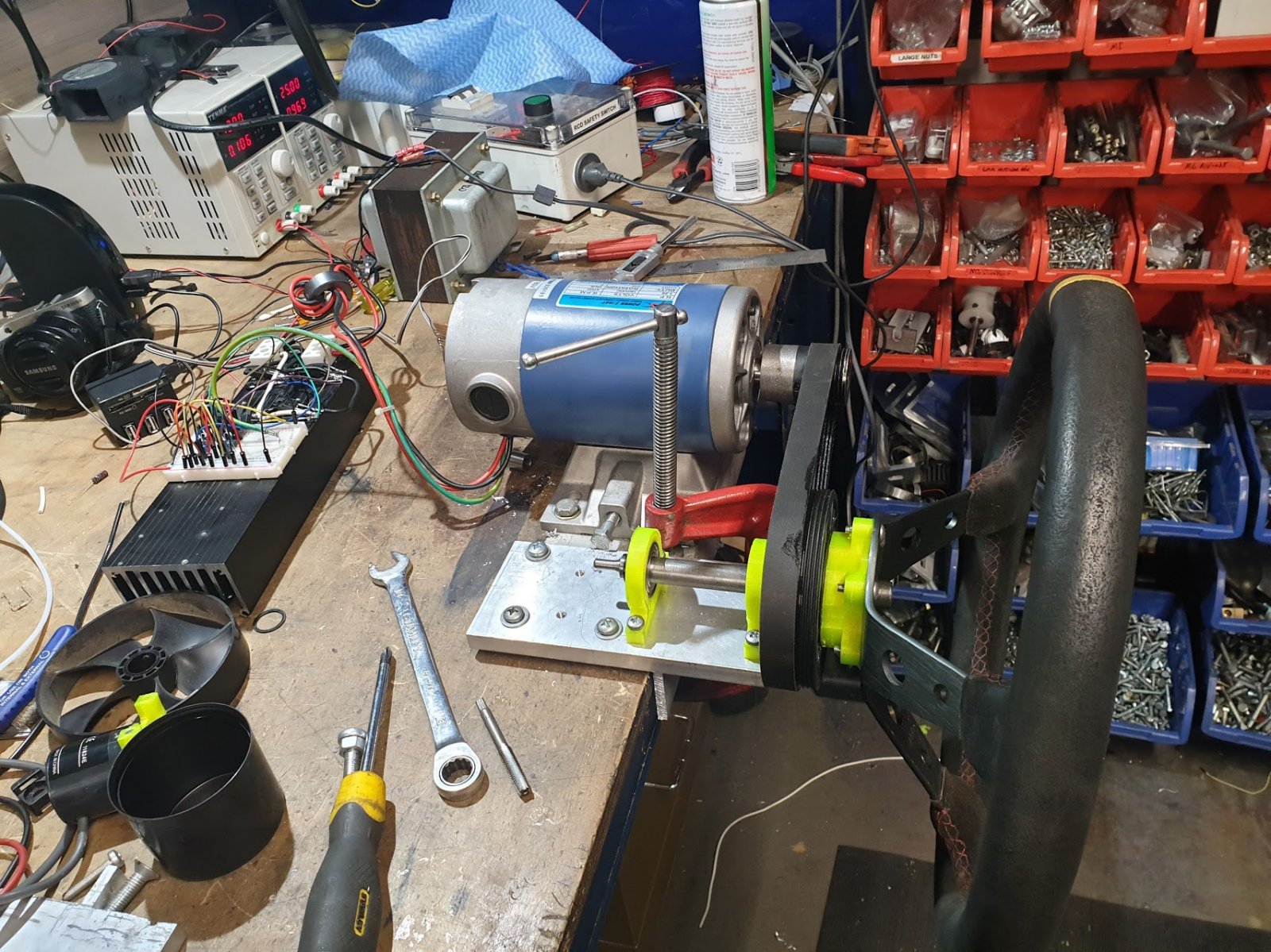

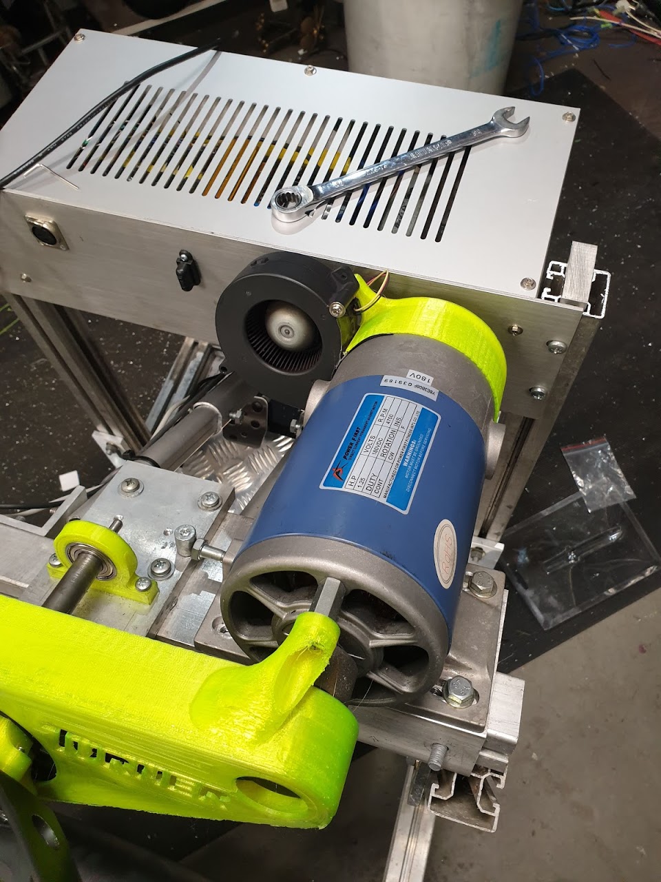

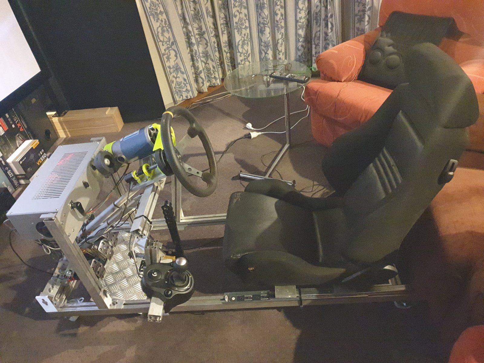

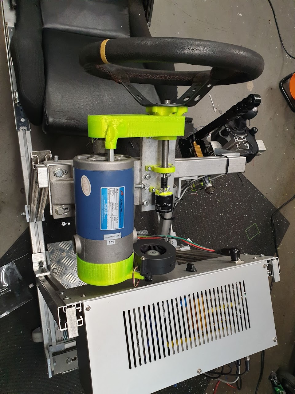

    Hi! I'm Matt.
    From the information I have found on this and other forums, I have cobbled together a quite functional belt drive DC OSW with a home made H-Bridge, a salvaged treadmill motor, and an AC stepdown transformer from an arcade game.
    I have made a video about the build, but left out a lot of the technical information. I want this thread to be a stub for that information if it is requested.
    For now, here is the the video, hopefully I can edit this stub and add some pics once I've had time to figure out posting here.
    20190823_212127.jpg 20190812_214212.jpg 20190821_225351.jpg 20190821_225628.jpg
    Components used:
    Motor and pulley set - Salvaged from freebie york 104 treadmill
    Stepdown transfomer - Salvaged from broken arcade cabinet (240VAC in, 120VAC out)
    Controller - MMOS flashed to STM32 Disc1 board, PWM + Dir mode
    Encoder - 2000 P/R chinese omron clone, 8000 PPR, requires pullup resistors to operate as source code for MMOS is secret :(
    Optocoupler - H11L3M logic output, suitable up to 1MHZ. Note : inverts logic and requires pullup resistor not shown in currecnt schematic.
    Bridge driver - IR2184PBF. Allows balanced all N channel bridge and equalizes dead times. Produces high side drive voltage internally with help of capacitor and diode
    Mosfet - FDA38N30. Extreme overkill for this applications, but very cheap as clearance item and can drive large inductance without freewheeling diodes.
    Transistor - BC546, its just flipping the logic back again from the optocoupler. IR2184 has handy intenal pullup on this pin, could be ommited if MMOS code was not secret.
    Gate drive resistors - 2k 1/2w
    Other components such as the diode bridge and power caps were salvaged from my junk box. 150VAC metal oxide varistor was installed on transformer secondary (not shown) and a 200V TVSS diode is installed across the motor winding.
    All other controls were connected using the diagrams provided for MMOS. Brake seems to interract with accelerator by a couple of percent, but fixed by setting dead zone.

    Belt-drive-DC-OSW.png Here is a basic schematic. It's not 100% like this at the moment and I've left some values out, but this is best functional representaion.

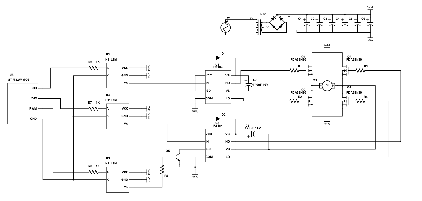

    I missed the 12V plug pack than runs the drivers. Apologies, here is the updated schematic. Belt-drive-DC-OSW (1).png
  11. Sieben
    Sieben Active Member
    Nov 6, 2018
    395
    2,241Coins
    +115 / 2 / -0
    Cool!
    Actually haven't seen such topology with h-bridge before. Very interesting with pwm+dir mode connections. I mean left side is for dir, and other with pwm. As simply put, generally top are for dir and bottom for pwm are used. That's genius designed you applied here. Nice!
    It's good that mmos allow two dirs also. With arduino, and emc 09, that i use, only one dir pin is there. So an inverter is required. If use that mode.
    Thanks Matthew for the info. You driver looks very cool!

  12. Matthew turner
    Matthew turner New Member
    Aug 27, 2019
    18
    211Coins
    +11 / 0 / -0
    I cheated a lot to keep mine as simple as possible, don't think I could achieve a design like yours :). I initally had bot shut down pins connectod to mmos, but i ended up needing more min force than mmos allowed and it was glitchy. When I went to only one side pwm, it worked perfectly. I was dubious about ilusing the shut down pin for pwm initially, but the shudown delay is very very low so it actually works.

  14. Matthew turner
    Aug 27, 2019
    18
    211Coins
    +11 / 0 / -0
    Yeah, I had to get very good optocouplers to work at 16khz. I tried lower frequencies, which worked well and allowed far less minimum force, but I could not stand the high pitched whine. Most of the parts I used were fairly expensive, so I don't blame you wanting to use discrete components. For me creating a high side driver that worked at 150V was not an option, so that is why I went with the IR2184. The IR2184 also implements matching dead time when switching either direction which is very handy.
    I could not use IBT-2 as it cannot handle high voltages - this is the biggest disadvantage of the treadmill motor.
