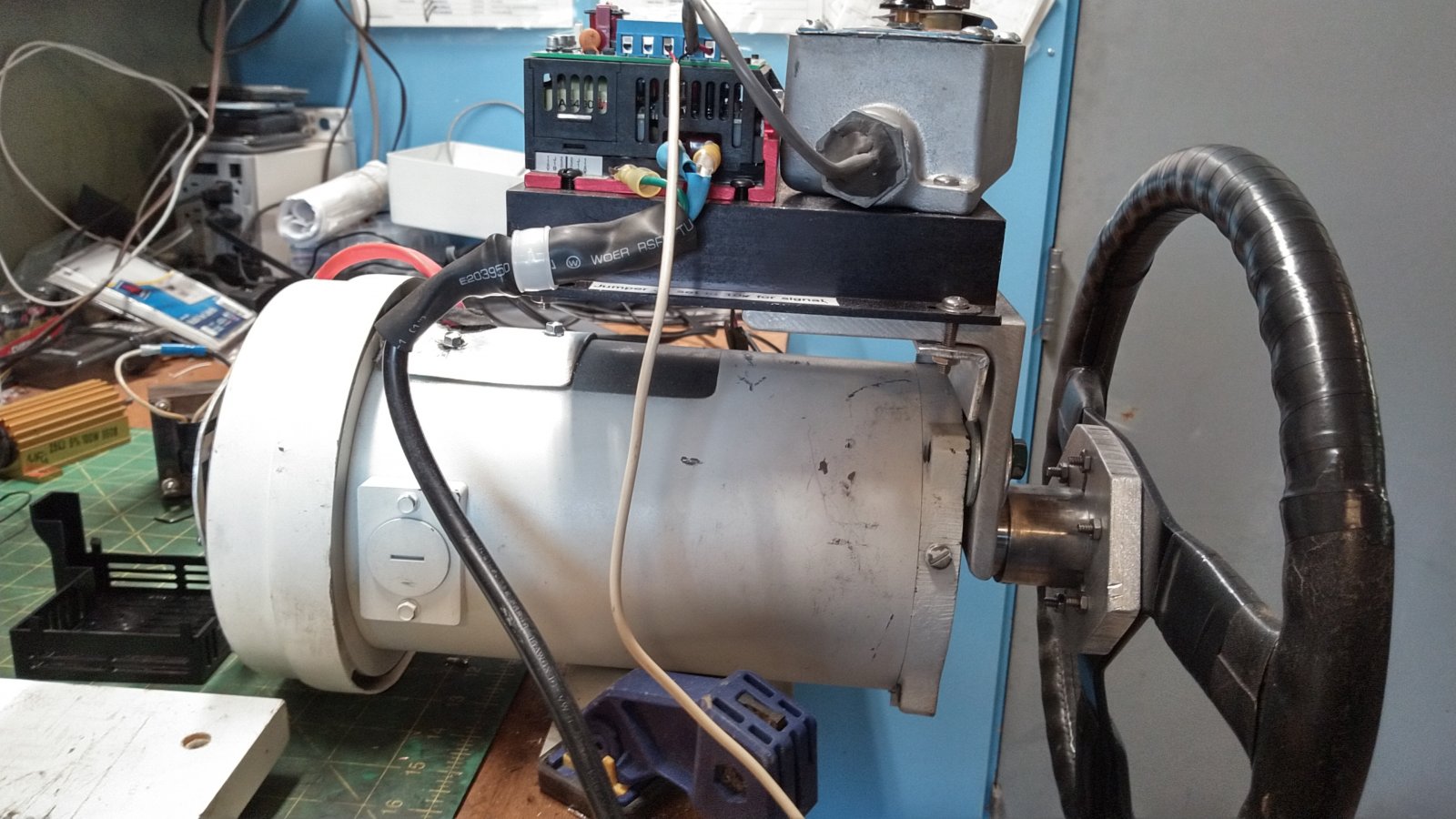

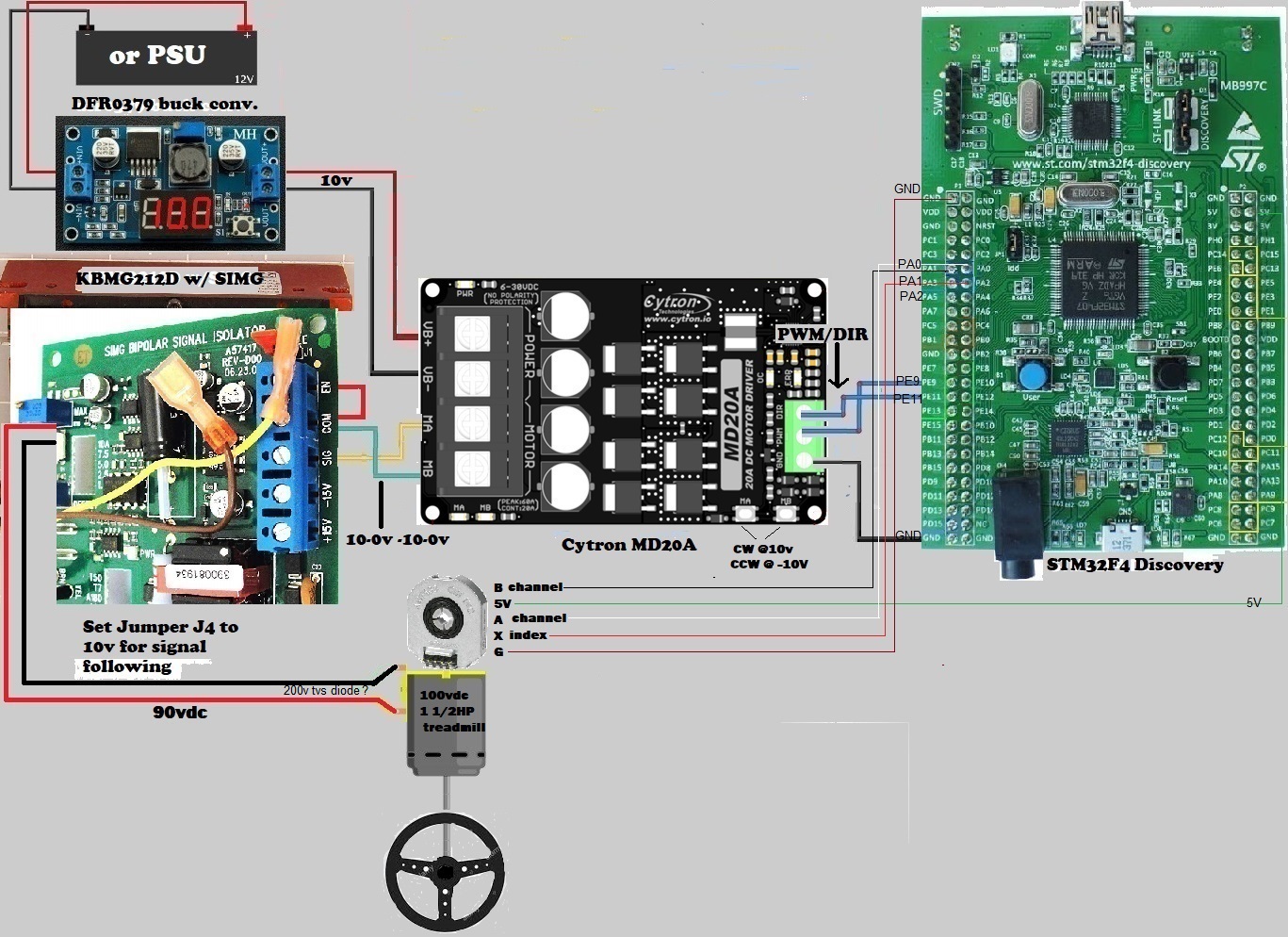

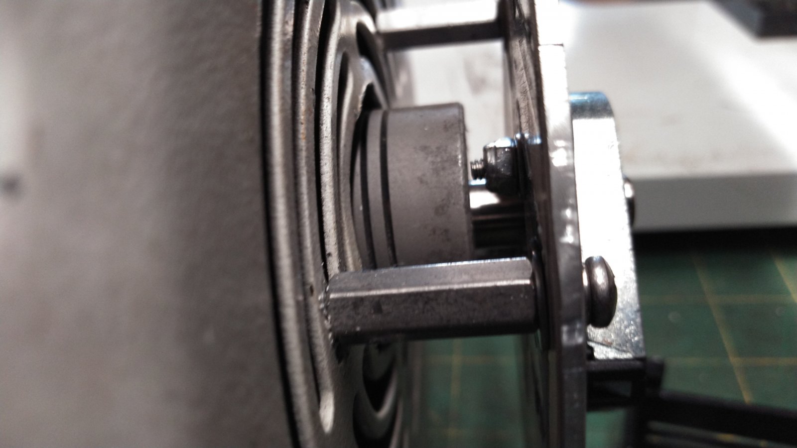

    I started this experiment with a 90vdc , 1 1/2 HP treadmill motor paired with KB electronics KBMG 212D and the SIMG signal isolator. The PWM from the MMOS through the STM32F4 seems to convert reasonably well through the Cytron H-bridge as -10 - 0 and 0-10 (buck conversion 12v in/10vdc out to the cytron) which maintains the same frequency from MMOS. Using the CUI AMT102V encoder directly mounted on the back of the motor, shaft through encoder on the treadmill motor. cytron4.jpg

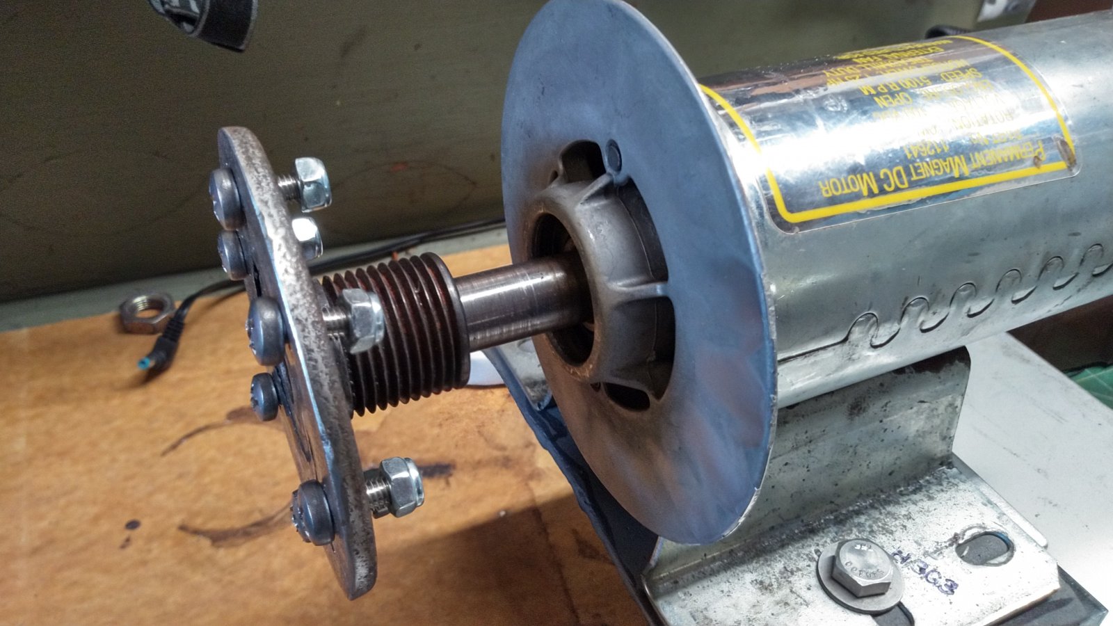

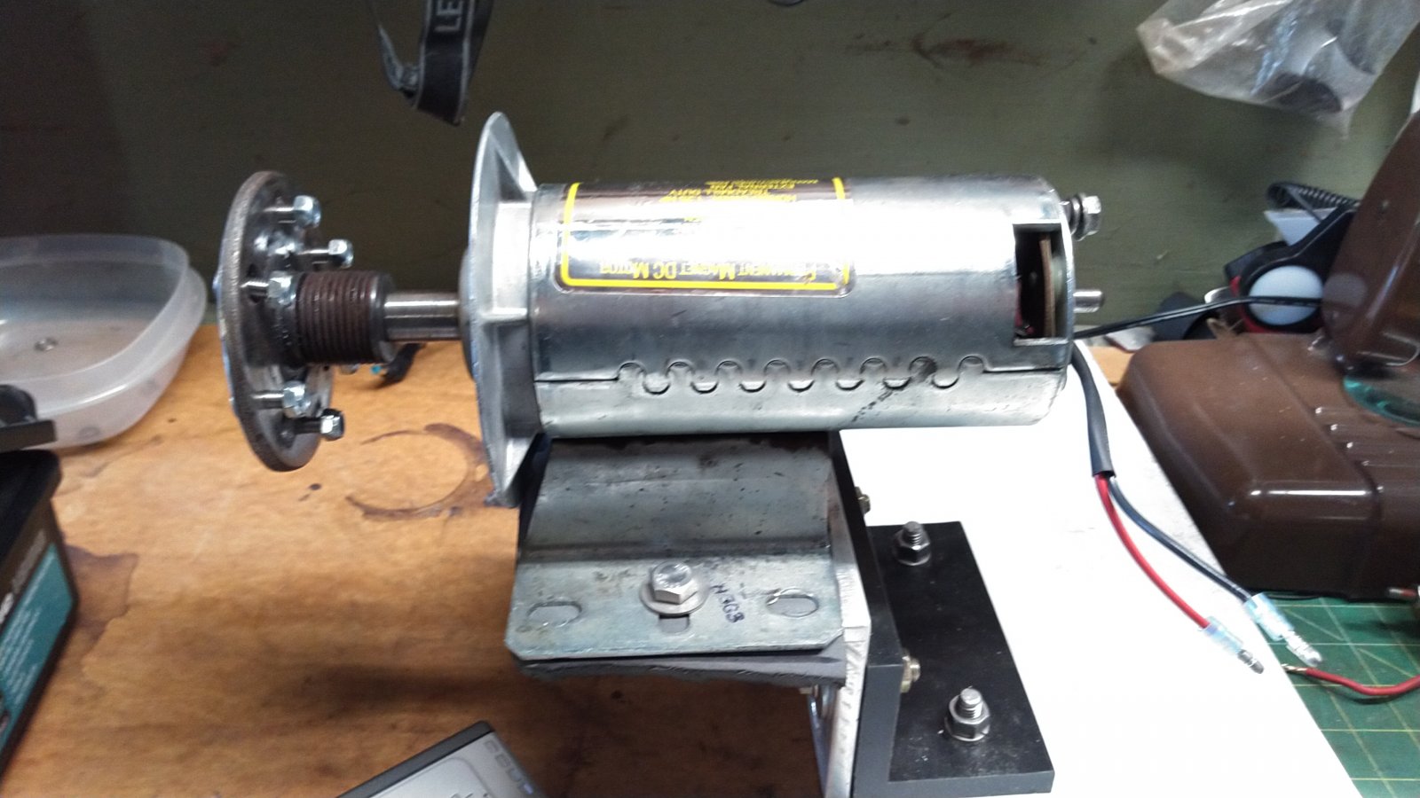

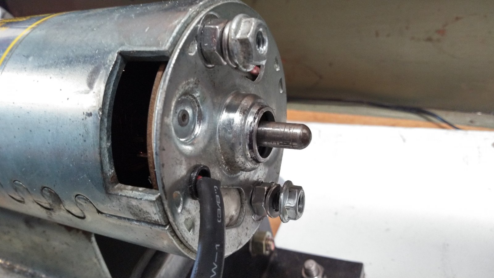

    KIMG0008.JPG Encoder conveniently mounted here.
    KIMG0005.JPG Plumbing flange welded to flipped bored pulley for the belt.
    KIMG0004.JPG Treadmill Motor mounted with isolation.
    Unfortunately I found myself dissatisfied with the noise of this motor/SCR drive combination.
    Certainly the brushes, smell, arcing would not have been tolerable for long.

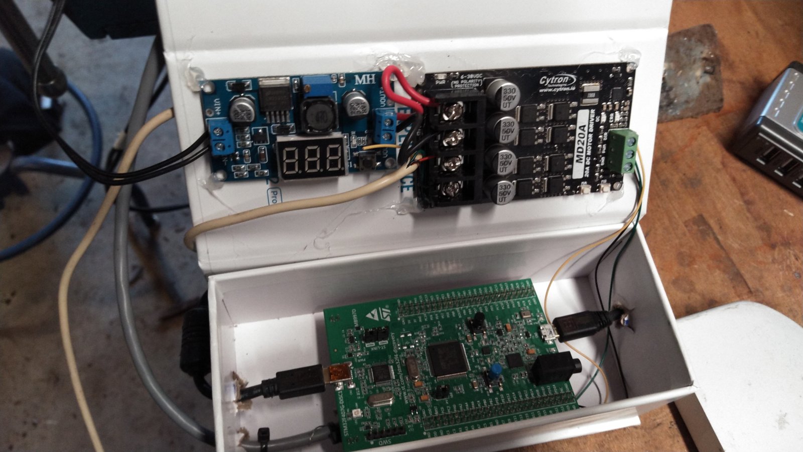

    nice experiment! I wish you success :)
    beware that hot glue may loosen when temperature will rise in the box... and cards may fall and short-circuit

    I want to try this as I have a 180 volt DC treadmill motor sitting in my cupboard.
    As the KBMG is capable of 200 volts I want to use that, but the H-Bridge is only supplying 10 volts?
    Any info will be greatly appreciated!

    Yeah I saw that but I don't want to mess around making my own PCBs and stuff, just thought that I could use off the shelf PCBs.

    The 10v is voltage following ie. max speed CW to the KBMG and so -10v would be full CCW ( 0v at rest, no command to run from the cytron H-bridge). It's function is conversion of PWM to analog dc voltage. The KBMG: 120v AC input produces 90VDC and input 220v AC reliably produces 180VDC. It may function on the first input and the last output at reduced speed. The KBMG would work well on a lathe with potentiometer my backup plan for the drive......I need to update having toyed with the various dip switches, pots and gimx adapter.
