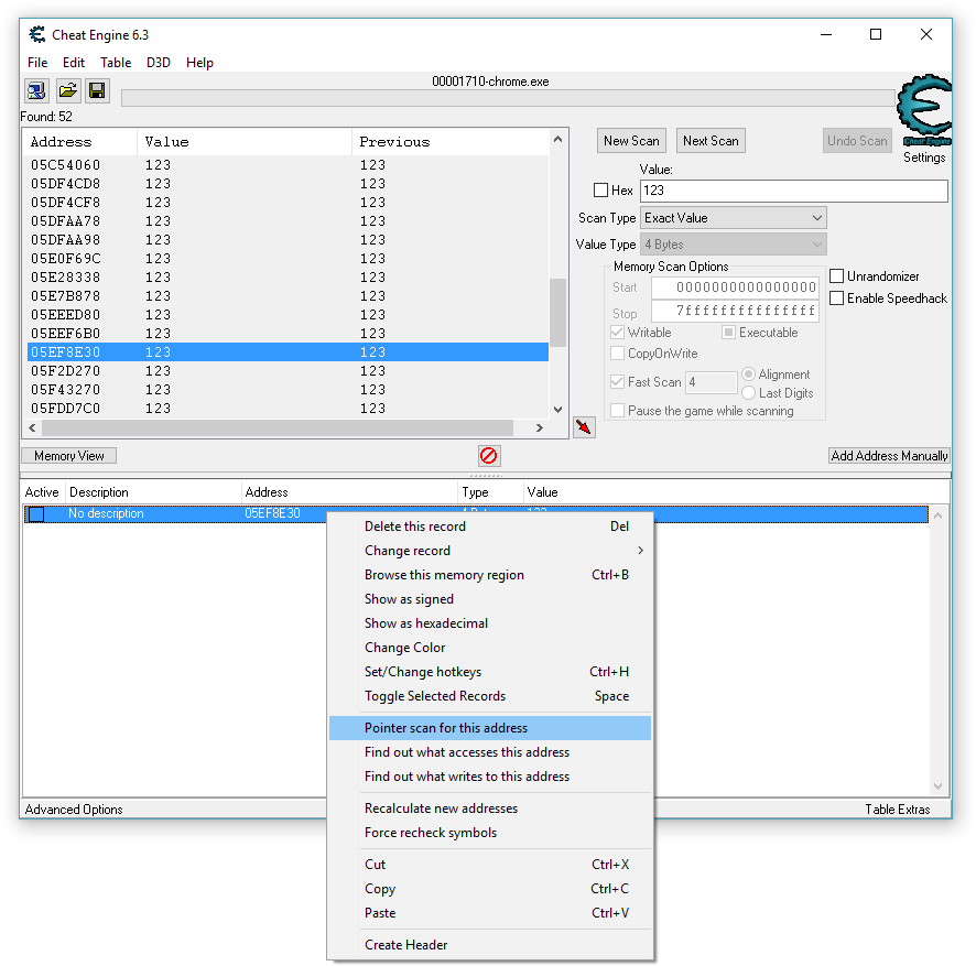

  6. value1
    Jan 9, 2011
    2,184
    Zug, Switzerland
    14,936Coins
    +3,328 / 11 / -1
    You will have to find the pointers to the values with a Pointer scan
  7. RaguTom
    RaguTom Cool Guy, Chronic Long-Winded Poster Gold Contributor
    Jul 15, 2016
    53
    Electronics Engineering/Technician
    Harrisburg, PA, USA
    331Coins
    +99 / 1 / -0
    Thanks!!! You even took the time to make a screen shot. I'll give that a shot!
  8. RaguTom
    Jul 15, 2016
    53
    Harrisburg, PA, USA
    331Coins
    +99 / 1 / -0
    Would this be a correct method:
    1. Search for value
    2. search for pointer based on found address
    3. close game, open game
    4. re-find value
    5. search for pointer based on new found address
    6. remaining pointer should be base source of data
    I saw something similar to this in one of the write ups floating around and that's the process I gleaned from it.
