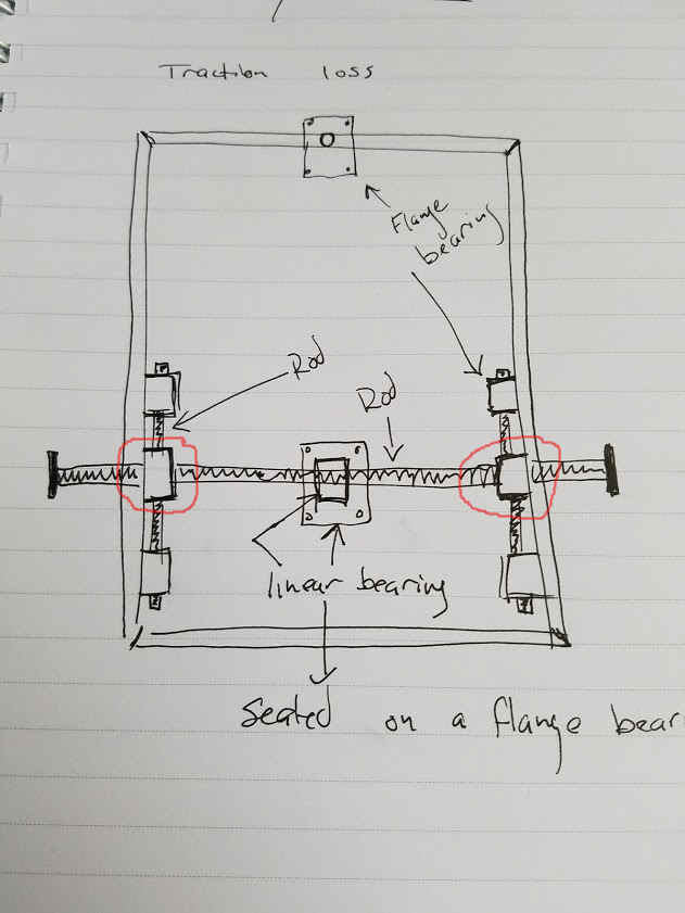

    Most people I have seen use wheels for traction loss. I have this idea in my head to use linear bearings instead and would use rods to slide on instead of a plate. The rods on the side would need to move and the centering would need a bearing to center on and that would set on a flange bearing. Ideally I think i'm looking for about 3" of travel in each direction so I would need the horizontal bar to extend 3 inches out each side, the linear bars running forward would need to extend the same I THINK?,.,Next step will probably be to use sketchup and then print some parts for a test.
    Shoot holes in my idea?

    3DOF, DC motor
    With the front bearing you have circular motion.
    The traction loss ballscrew is linear.

    which is why i have linear bearings running in both x and y directions.....traction loss to the left.....slides left on the rod rod going across goes foward on the left, back on the right. Pivoting linear bearings on the sides.

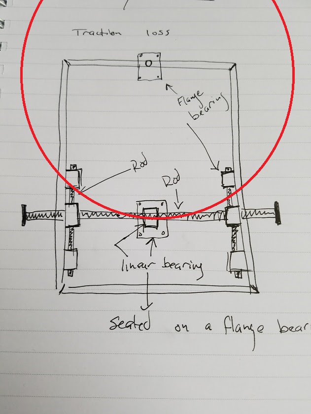

    if I can place my front center pivot and then measure backwards to where I want my bar that will run horizontally where my linear bearing will sit I believe i can calculate the curvature of the circle so i can order a track for the space tht I need. I then can place bearing rollers on each edge of my rig to allow further stabilization for a much simpler solution. I want to avoid slop in the motion.

    Okay I get that but how do you plan to connect a motor to it?

    stationary plate that is on the base that the rig sits on. a secondary bar connected solid to each side

    reduce noise, slop and save on space as well as work for my current configuration

    It should move smoothly I would think. Have you allowed for the joints in the red circles to move off of 90 degree angles though?

    correct, these would need to pivot

    Okay I think it should work fine then although it may be more complicated and costly then some other methods.

    I think it might be overlky complex as well but I really want it to be smooth

    I used bearings running directly on an L shape steel path for the 3dof motors ... and used a ball screw wit asteel cage fist for driving the center flange bearing .

    when I was planning my rear traction loss I though about a lot of ideas like yours at the end I ended up using roll bearing sliding on flat peace of steel . I use a 4x4 inch lady suzan in front.
    thwo peace of plywood where those ball bearing are screwed in two the plywood . 3 rows of bearing (mix of metals and plastic ones). Metalic to help the slide and resilience. Plastic for the grab on to the sheets of metal.
    I used 3 sheet of steel lubed with thick grease (bicycle grease).
    If I had some cash I d remove the top plywood and use all the way 8020 . If more cash I d use only 8020 alu. that is for another project maybe

    All i did was to get the curvature, although i had wheels was to put the pivot point in and put some string from that with a pen at the distance to where the wheels are and draw a line. i then welded the wheel brackets 90° from that line. you could just measure that arc line accurately instead of calculating, although if you have cad software it is easy with a known measurement.
    I would happily draw the track section for you if your stuck
