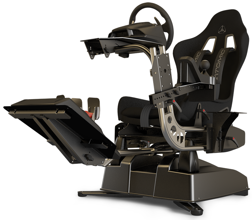

    If your intention is to demo the unit at public events then you will also need to build-in some adjustability to accommodate for various sizes.
    First thing to note when doing this it that although it would be easy to buy a seat with runners, this also throws off the center of gravity and so it is preferable to adjust the wheel and peddle position instead.
    Whilst searching for ideas, my favourite compact DIY solution is noorbeast's and my favourite commercial sim is the Atomic Motion System... http://www.atomicmotionsystems.com/?page_id=10244
    I have no affiliation with this company and only came across their design whilst searching for ideas. I like how compact it is and the adjustability of the peddles and wheel. I have a young son who is always keen to 'help' me with my games and so this would be useful to have.
    It also folds away very nicely (not that I'd ever put it away but for you requirement to transport!)...
    Finally, it would be remiss not to mention that if you intend to allow the public to ride on your Sim then you will need to take out some form of public liability insurance just incase the worst happens.
