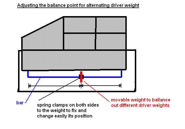

    Hello!
    Some pictures of my project, currently I am not planning to use x-sim software, I already made software for LFS and rFactor for my sim.
    Motor control-software is now under work.
    Feel free to comment!!

    Hey tppohja nice work. Look like the poffessional wok of an expert.
    The following criticism is not against you. Do not misunderstood. I would be happy with a simulator like yours.
    I think the major problems of design like yours are the wrong rotationaxes. To create feelings as realistic as possible the axes do not have to intersect the center of mass. They need to intersect the head or better the ears, because there is our equilibrium organ. This organ is resposible to detect rotational accelerations.
    And we dont want to detect the rotational asseleration because they are not realistic. I dont understand this in the designs like yours.

    Thanks, that is just hardware work of software guy :)
    Still long way to go.
    I have been thinking also that rotationaxes thing. It is very hard to build, and I'm not sure is it so much more realistic than this. I just don't know, I have never even been in moving simulator before... :D

    Jeehehee, very nice !
    Do not forget to put a moveable weight under a rig :), to balance the weightpoint.
