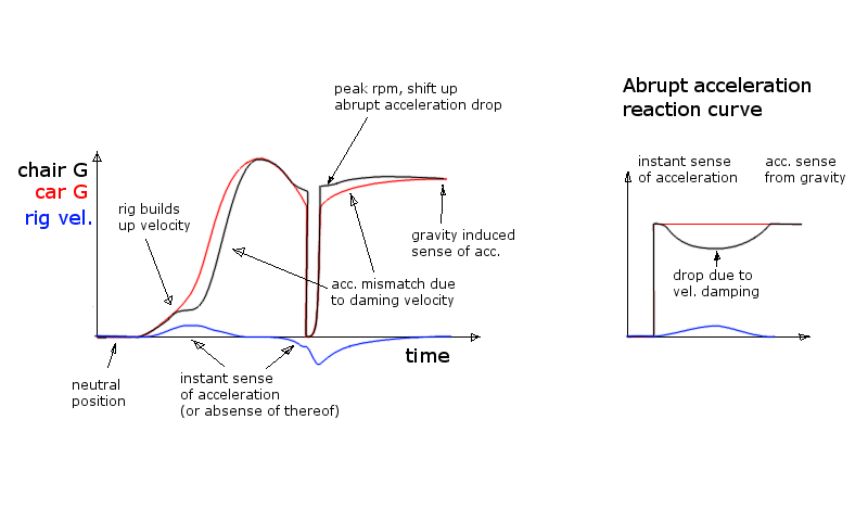

    It is notorious that actually simulating G-forces with motion sim is challenging and besides small handful of very specific cases, simulation could never be fully accurate. But to some extent it's possible to do it and it doesn't takes 6DOF super-expensive huge rigs.

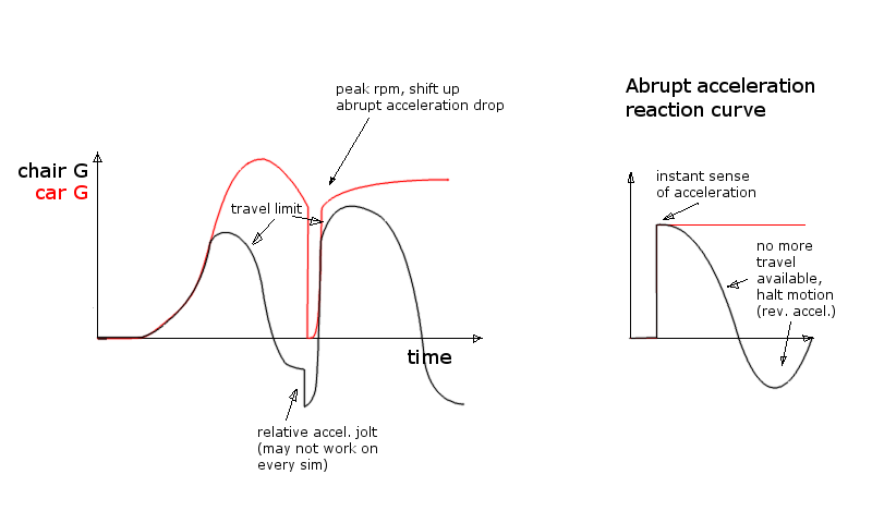

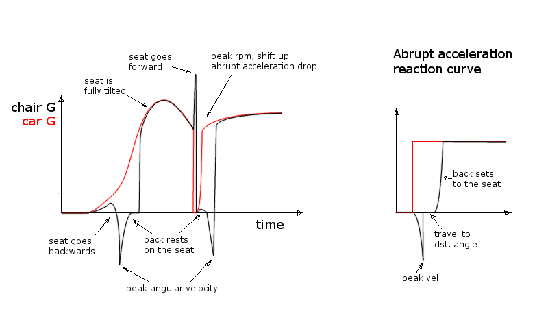

    There are few types of common inexpensive builds. Swivel-chair-like are typically having pivot point way below the chair and are typically used to only simulate tilt. They can additionally simulate small horizontal accelerations by tilting. We shall call this "acceleration via earth gravity" type of G-force simulation. As long as angular speeds are small it actually works well. But suppose you want to simulate surge of accelerating car, including abrupt acceleration drops upon gear change. In this case, the chair would have to rapidly tilt. But since pivot point is below centre of the mass, this tilting creates a force in an opposite direction. This would be especially striking discrepancy between expected feedback and resulting feedback when you shift up - you would expect the chair to take off your back, but instead it pushes you into it even harder. It makes up for intense experience and is cheap, too, but it's very inaccurate in terms of representing forces. Perceived acceleration cuvre looks like this:

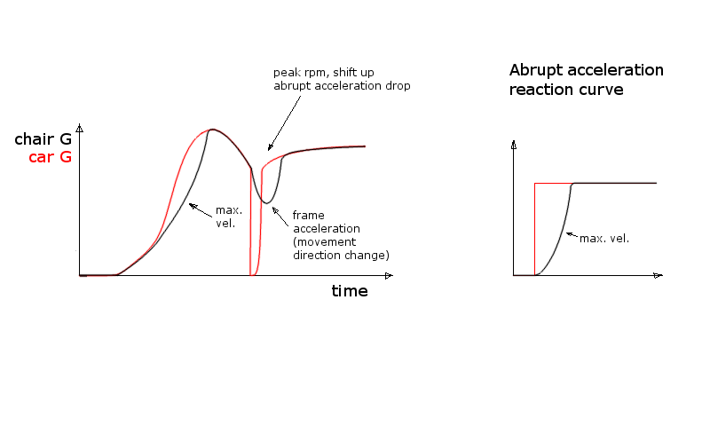

    Another common type of inexpensive sim is gymbal-like system, called "joyrider", usually 2DOF. Major difference forces-wise is that centre of mass lies close to pivot point. This doesn't creates counter-acceleration (at the centre point) during rotation, so the response curve is a lot smoother. You can also get away with a lot weaker motors if you manage to get centre of the mass really close to the pivot point. Note that perveived acceleration line is slightly curved towards greater acceleration (angle) during rotation at the same angular velocity, this is because tilt-induced sense of acceleration is a sine function of the tilt angle:
    Some sims use traction loss simulation, which is by nature the same thing as with 6DOF motion simulators that actually use linear acceleration, only made in cheaper fashion, and it includes yawwing but from standpoint of acceleration it doesn't pays any role. This paragraph discusses both. Physically accelerating the seat linearry is of course the best way to simulate linear forces. But travel magnitude is very limited. So it can nicely simulate short bursts of forces but when it comes to continious force it has to wash it out and stop the rig, which causes a bit of reverse acceleration, usually also returning then to the central position. Its acceleration curve looks like this:
    And then there's combination of gravity-induced sense of acceleration and actual linear acceleration. This is usually only found in expensive 4-6DOF motion sims, but it's also acheivable in pendulum-type "joyrider" which is a lot favorable option to an enthusiast next to $50k equipment. The only difference between pendulum-like and gymbal-like joyriders is that former deploys centre of mass heavily set off the pivot point, so that the frame acts as pendulum. And by contrast with regular joyrider, that build requires powerful motors, by formula of:
    torque required * gear ratio = full mass with driver (kg) * arm length (m) * desired acceleration (m/s²)
    where gear ratio must be low enough to allow for high accelerations at high rpm so that there isn't acceleration drops due to velocity limit. With gear ratio 1:20, mass of 100 kg, arm length of 0.5 meters, and desired acceleration of slightly above Earth's gravity, you would want at least 2000 rpm motor with 25 Nm of torque. A 4.5 horsepower winch motor would suffice, but then 0.5 meter arm length is probably too short, and that's a matter of consideraiton: short arm significantly reduces arm length to the head and accordingly reduces vestibulatory perceived acceleration, and pendulum swings faster, but considerably less torque is required and there's less centrifugal parasitic force (since centripetal acceleration is ω²*r so obviously having smaller radius helps). Combining linear acceleration with tilt in order to acheive continious sense of acceleration imposes additional variable: velocity. And it's by nature a parasitic variable because due to travel limitations, this velocity has to be dampened - by creating counter-acceleration. So there's a challenge of damping this parasytic velocity without damaging overall experience. You can come up with multitude of damping functions, simpliest of which is reducing acceleration rate proportionally to current velocity, so that as the rig builds up the speed, small degree of counter-acceleration is automatically aplied. Acceleration graph for combination of the two approaches looks as following (with pendulum specifically but 6DOF is no much different since it has to perform all the same things):
    That approach of course has drawbacks as well, as you can see the force has significant drop in the middle of rig travel because since the rig has to apply linear acceleration, the seat builds up the speed, and then the rig has to damp it, which creates some counter-acceleraiton, i.e. perceived acceleration drop. But as it was mentioned, for a motion simulator rig it's practically impossible to simulate all the forces perfectly correctly, you'd have to settle for "better than nothing", or in this case "better than other options".
    So that's regarding how can (or can not) simulate G-force with motion simulator rigs. Note that for all of above figures, the chair G-force is not actually directly equals to car G-force, but it represents it in the most accurate way it's acheivable. It is implied that forces are way under 1G, because simulating force of over 1G requires using centrifuge, but even then it also imposes great deal of other challenges without resoving which it's simply doesn't improves anything, cranking up the rig price by order of magnitude.
    Hope that helps. Sorry if I'm inventing the wheels here.
