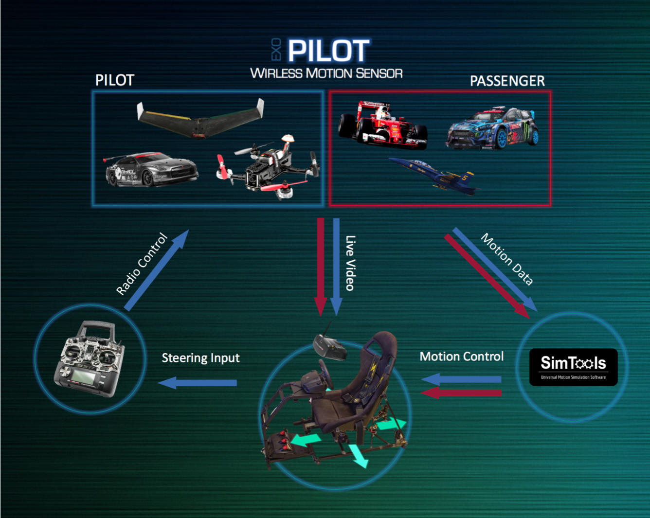

    Idea Breakdown:
    (RC Model side of things)
    (Arduino + 9dof pcb + wireless transmitter + power) = Small device to attach to any RC model.
    (Simulator side of things)
    (Wireless Receiver + Custom app to receive data and send to SimTools) = Telemetry data received from RC Model

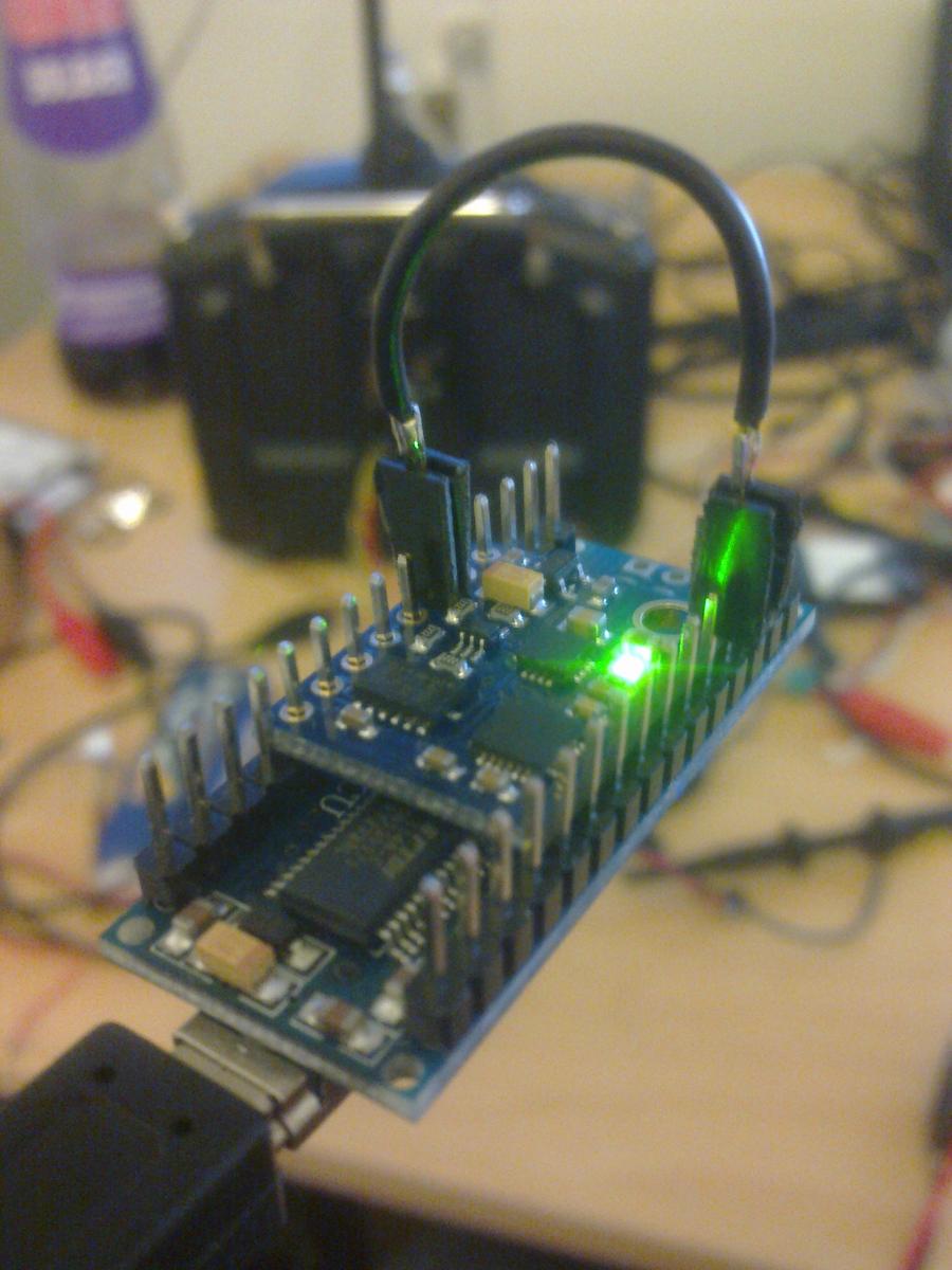

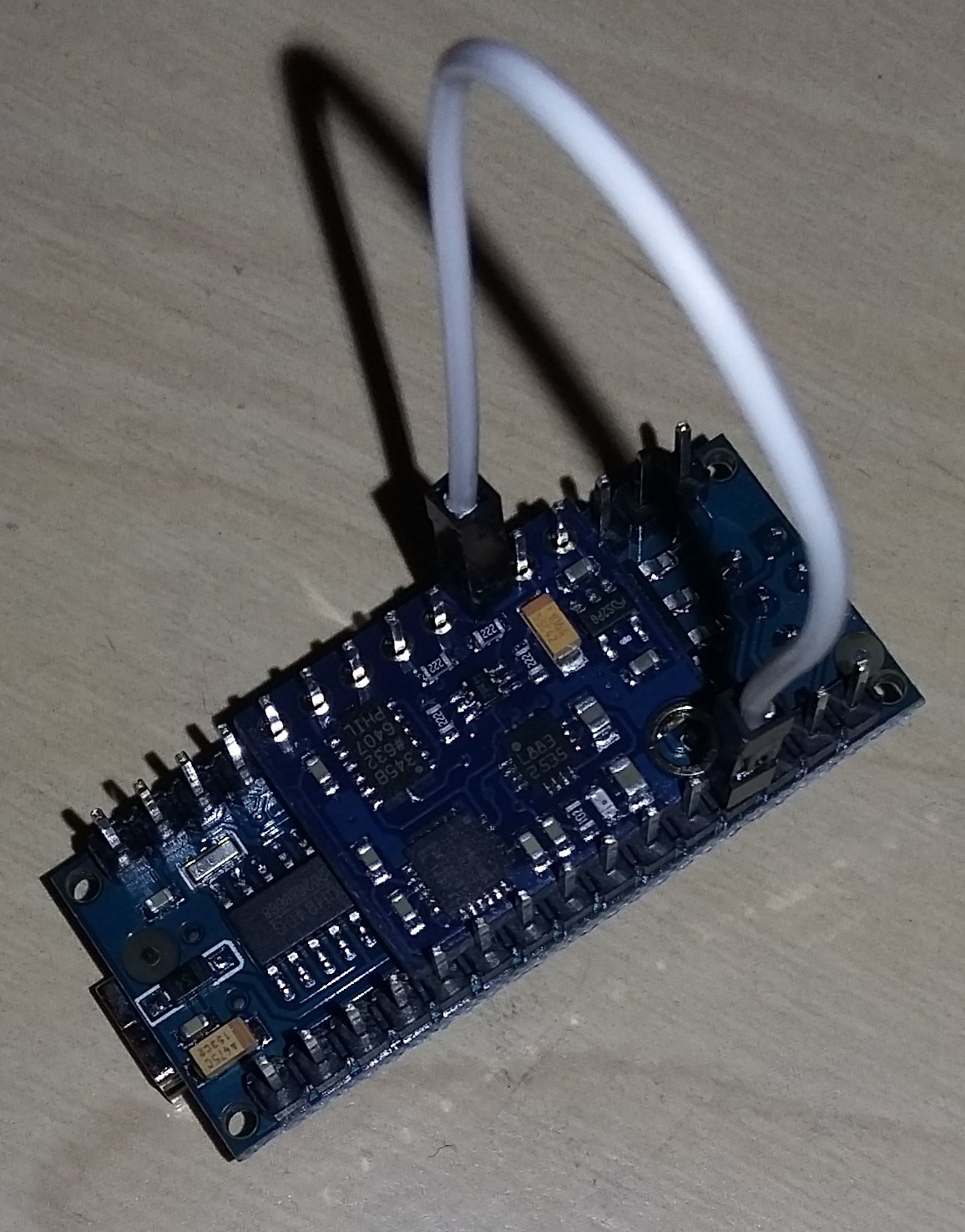

    How to put together the Small device to the RC model
    Attach the GY-85 9DOF IMU to the Nano like shown.
    Only one wire jumper is needed for the whole build!
    (Mine worked fine even without solder for testing.)
    IMU board -> Arduino
    Vcc_in -> 5 volt
    GND -> Ground/GND
    SCL -> A5
    SDA -> A4
    (pic's is so much easier)

    I have been working with @yobuddy on this for a little while and wanted to show you guys what we've been able to get working so far, as well as what's left.
    Some background:
    For me this project actually started with an innovation competition at Brigham Young University where I just finished my bachelors in mechanical engineering. Initial Funding was offered for students to try out innovative ideas; to prototype them and to explore their market potential in 2 rounds of competition in which the final winners would be given additional funding to work on the idea. I had recently started two new hobbies(I'm sure many of you have this problem...) of Sim racing and FPV quadcopters, and the concept of merging the two was an irresistible project for an engineer. I was able to convince them to give me the initial funding which helped me to finish building my sim, and to begin researching telemetry systems for the data transmission. During the first round of the competition all I had was a chair that sort of wiggled around, and the promise of "dont worry, I promise this is going to work!" The judges were amused at best. After researching different options and borrowing from various different projects I pieced together the setup that yobuddy described above (arduino + 9 DOF IMU + telemetry radio) and got some rudimentary code to send the data back wirelessly, (to your question @Gadget999 , yes the telemetry module essentially establishes a wireless serial port and more or less works as though the arduino was plugged in via USB), but as far as writing a plugin to allow it to talk with simtools, I tried and quickly realized that my programming skills were hopelessly inadequate. With the final round of the competition rapidly approaching, I knew I would need help so I messaged yobuddy in desperation hoping he could help me with the plugin only to find out... he had been wanting to do the same thing but was looking for the wireless telemetry solution!!!(what are the odds?)

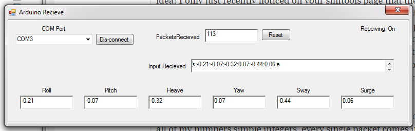

    Anyways, to make a long story short, we refined the arduino code above to send the data in a usable format, and he put together an awesome plugin and receiving program that totally saved my bacon and allowed me to get the whole thing working the night before the competition (of course). Luckily, it ended up going extremely well with people lining up to try it and having a blast weaving back and forth between pedestrians and laughing hysterically. I was luckily able to win 4th place out of 70 initial contestants and the idea was overall received extremely well. Here is a video of somebody trying it out at the competition, complete with a headtracker/FPV headset linked to a 2 axis camera gimbal on the car for full immersion. Keep in mind that this is the day after we got this thing working so there is PLENTY of fine tuning to do, but the main point is that IT WORKS!!! also, keep in mind that my motors are fairly weak, so the response time has more to do with that than it does with signal lag
    and a demo of the FPV headtracking
    Here were my concept posters
    Screen Shot 2017-03-10 at 6.56.04 PM.png Screen Shot 2017-03-10 at 6.56.25 PM.png
    So in summary, it works, and it's awesome, but we've got some kinks to work out before it works flawlessly. You'll notice that while the ultimate goal is to put this on a quad/plane, the initial demo was on an RC car. This is for several reasons

    As long as the telemetry gets to the PC before the video arrives to the screen/googles, a telemetry output delay should be possible.
    As to sync the video with telemetry for different depending on different gear.
