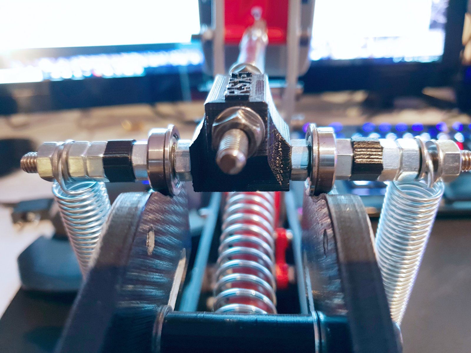

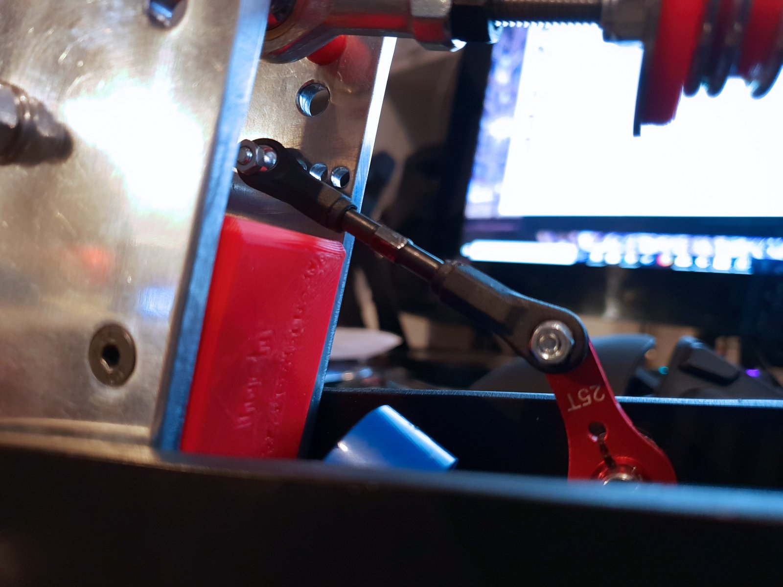

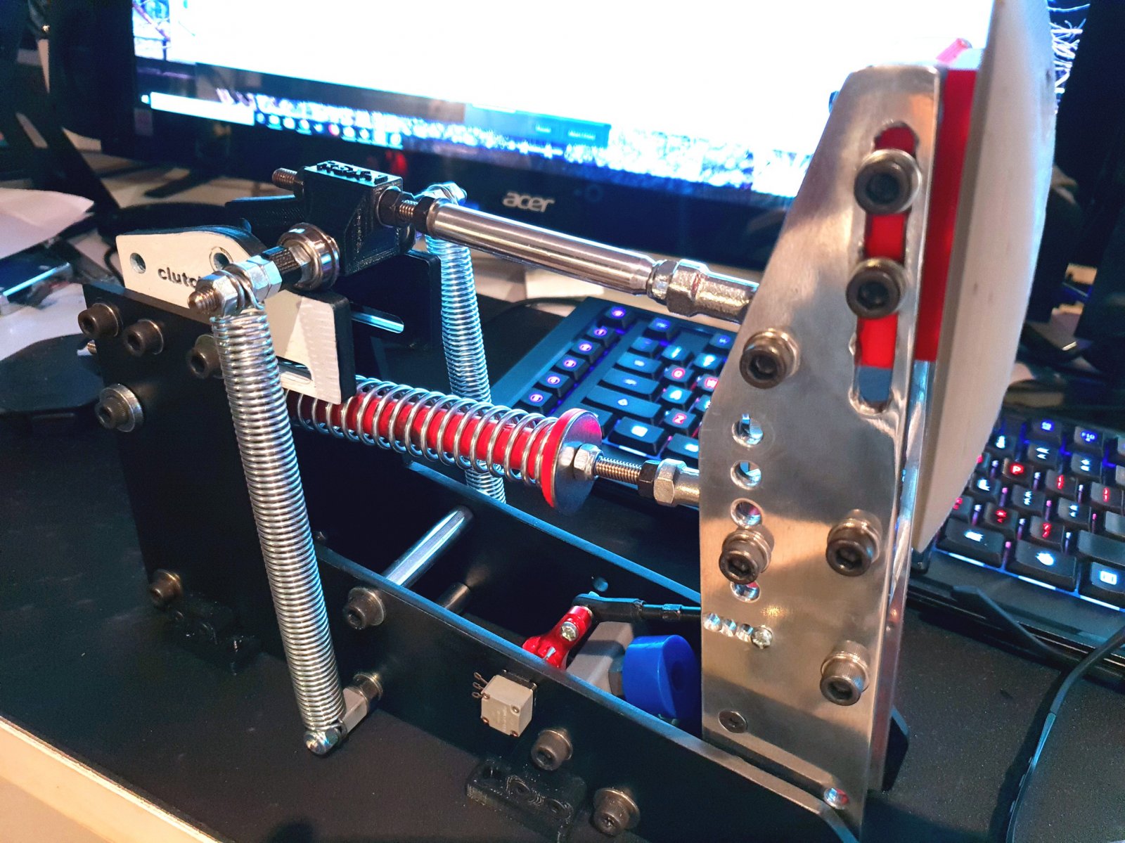

    playing with the pedals last night whilst designing the heel plate I decided that the spring mechanism in the clutch was a little too aggressive for my liking. Mind you, not that I don't like it, just that it was a little snappy and no adjustable free play or dead zone at the beginning of the pedal press. So I decided to build the newer design shown on the Protos and yes indeed, I think this is that 'goldilocks, 'just right' type of result!
    And I completed the potentiometer for the throttle and clutch with its linkage....
    The roller system with flanged bearings. No run out, no drop offs and solid as a rock!
    A couple of pics of the second clutch mech completed...

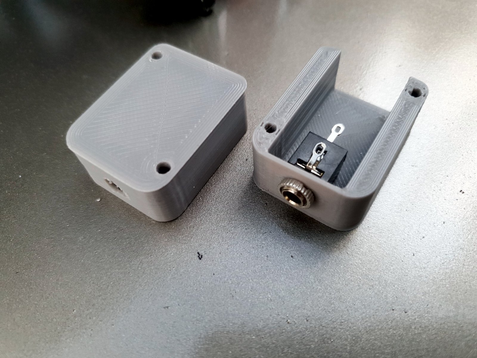

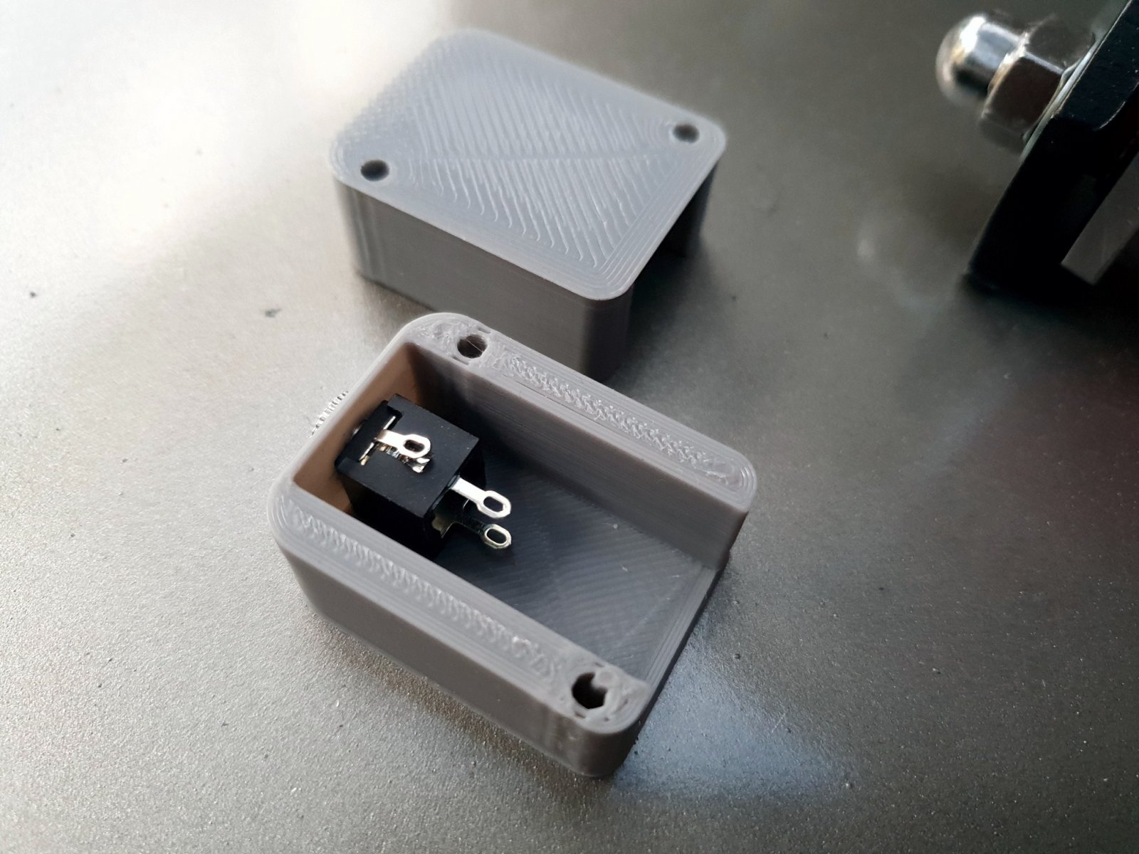

    I am now taking care of the minute details. I decided on a 3.5mm stereo jack and socket to make the connection so I designed and sliced up a case to hold the socket for the pedal housings and also a cover for the potentiometer so that it isn't exposed and vulnerable to prying / curious / accident inducing / clumsy / derpy hands! :D
    This will enable me to just unplug and unbolt each of the pedals individually should they need repair or maintenance or knowing me, upgrades (as I cannot sit still)
