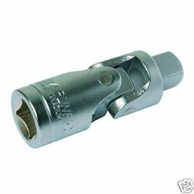

    Dear sirs,
    Pivots are probably required for Motion simulators, sitting under the seat allowing seat to be moved about by a motion unit.
    I have attached a picture.
    The pivot I have seen allow movement left to right and back and forth.
    This concerned me as when the seat is twisted by actuators that there should be atleast 2-3 degrees circular movement so there is no added stress on the motion unit (Actuators).
    Should a pivot be sat on a spindle....
    Kind Regards.

  4. Fahim
    Fahim Member
    Dec 11, 2008
    424
    245Coins
    Dear sir,
    Please see photo. Are these okay to you use as a pivot.
    You can get these from ebay cheap.

  6. Fahim
    Fahim Member
    Dec 11, 2008
    424
    245Coins
    Dear sir,
    I have been to the hardware shop where they sell this:
    There are different sizes: range from small to large:
    I held them in my hand and found out the play is only 1mm approx. Not much.
    Is this dangerous to the simulator if there is no play?
  7. egoexpress
    egoexpress Active Member
    Dec 13, 2006
    3,839
    Germany - Frankfurt/M
    421Coins
    +7 / 1 / -0
    You need a cross joint with zero play.
  8. Fahim
    Fahim Member
    Dec 11, 2008
    424
    245Coins
    Dear sir,
    There were heavy duty big size at the shop and they had no play. They were for industrial purpose. Very strong. But a little expensive.
    What happens if thier is play.
  9. adgun

  10. tronicgr
    tronicgr
    The play is increased as you get far from the crosjoint to bigger radius. In a distance of 1 meter you may measure 5mm play!!! Not good! You will actually feel the rotation effect!
    Thanos

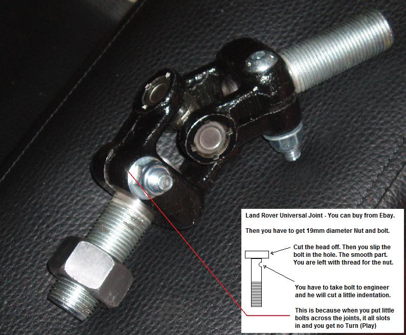

  15. Fahim
    Fahim Member
    Dec 11, 2008
    424
    245Coins
    Dear sirs,
    Land rover universal joint for loweer column. You can buy these from Ebay :)
    Any good?

  17. Fahim
    Fahim Member
    Dec 11, 2008
    424
    245Coins
    I have bought the above land rover joint which are sold alot on ebay. They cost around 11-15 english pounds. And they have 0 play.
