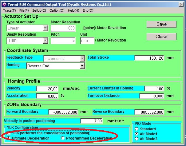

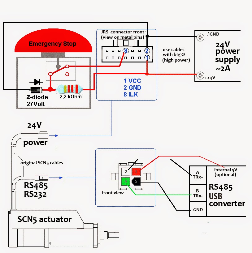

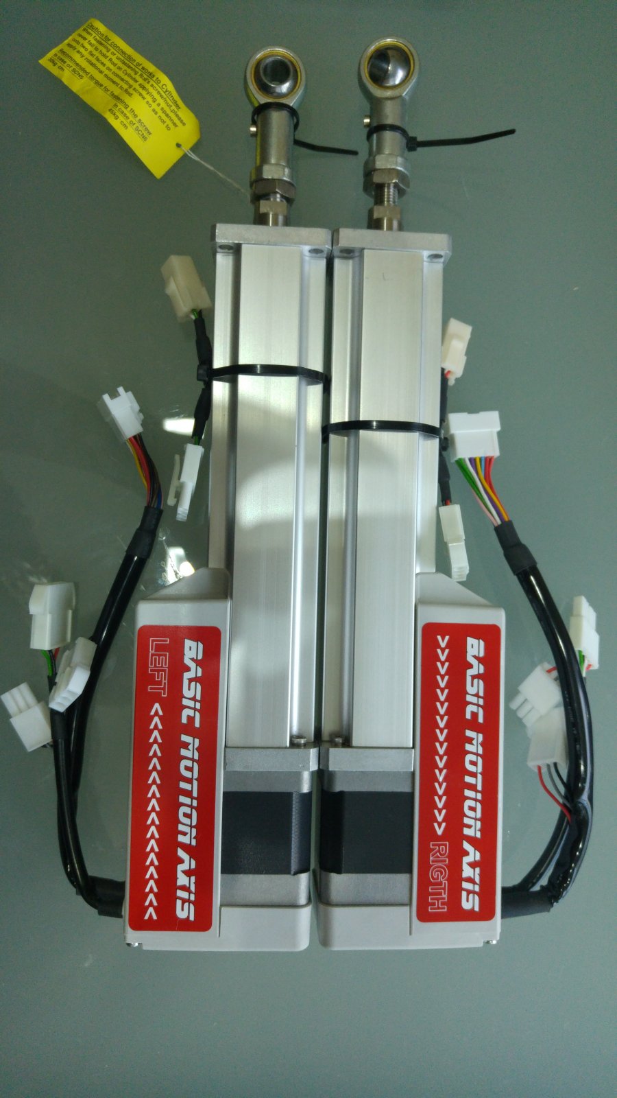

    Hi. After following the installation tutorial for two SCN5 actuators (https://www.xsimulator.net/community/threads/scn5-wiring-tutorial.5566), and after making them work I realize that the ILK does not work. I have reviewed the electrical installation and everything is well connected but the actuators always work, whether the circuit is open or closed. I have to say that these actuators are bought second hand and I understand that they came in a movement platform kit, so I do not know if the ILK will be disabled by default. I enter using the Dyadic software and configure the ILK but it does not do anything at all. Any suggestions? Attached photos:

    The ILK is still not working, for now if I do not find a solution what I will do is put the switch that disconnects directly the 24v power that goes to the motors in case of system failure, it is not the best option but unless you find a solution it will be what I will do. A greeting.
