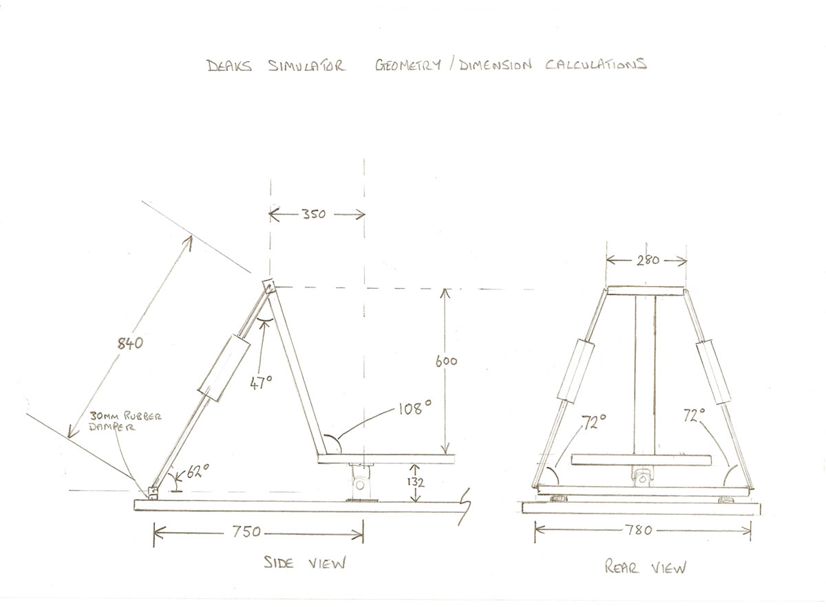

    After reading almost every post on this site (honestly) I am just about ready to undertake my first motion sim project :D
    My welder friend is coming round to my place tomorrow so we can discuss fabrication methods and what aluminium to use.
    I have done a drawing to calculate the correct angles and dimension based on the very helpful information found on this site, but I would really appriciate some feedback on whether my calculations are on the right path.......

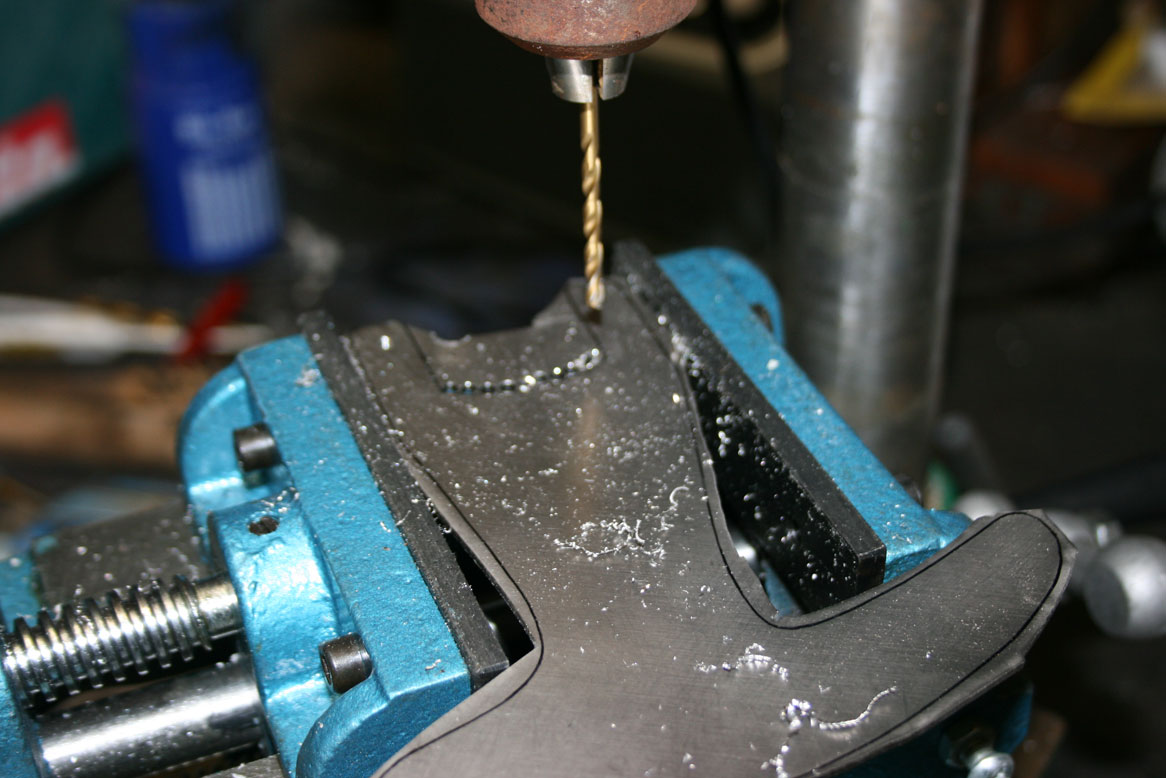

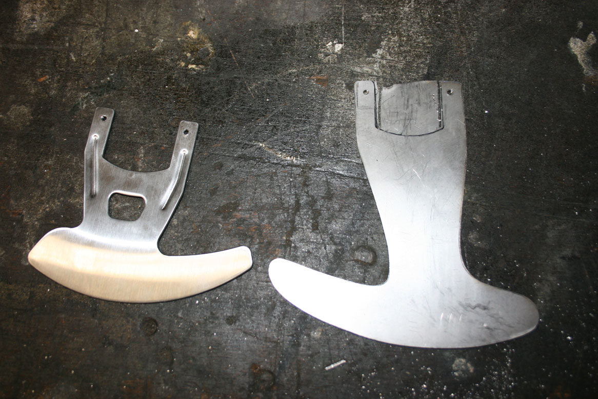

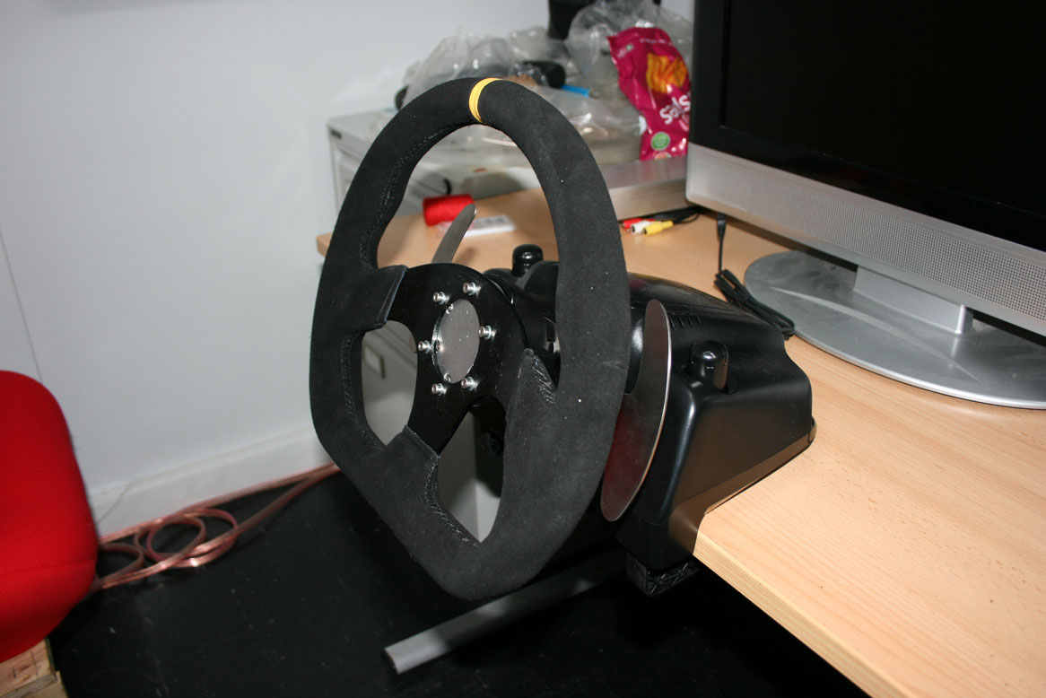

    Last week my G27 finally arrived, and I have now finished my wheel adapter for my OMP (copy) 320mm D shape wheel and a pair of titanium shifter paddles.
    The paddles took ages as I do not have access to fancy plasma cutters, just a jigsaw, pillar drill, angle grinder and hand files, I am very pleased with the end result, next job is to make a button mount for the wheel and wire into the now missing G27 button circuit.
    When I find my card reader for the camera I will post some pics
    I have my universal joint from a mitsubishi shogun 4x4 so it should be strong enough for my 100kg body!!!
    So guys, please feel free to comment on my dimension /angle calculations, I want to start fabricating as soon as possible, hopefully I will have the funds to buy the SimXperience starter kit and damper kit + 3rd Actuator before Christmas :D
    I calculate that the damper arms will be around 840mm, I am pretty sure there is enough adjustment in length to accomodate this dimension, if not can someone let me know otherwise.
    Finally, I just want to make sure that a 2DOF with an (inspired by SimXperience) rear traction loss 3rd actuator is going to be the best way to go for realistic as possible race 'feel' within a resonable buget and engineering skill level???
    Thanks in advance
    Deaks

    I think your geometry will be a good starting point. You could make the frame easily customizable by adding extra length to the base, and extra width to the dampening bar. The actuator rod can also be extended/retracted easily if needed. Modifying these 3 parameters you can find out what works better.
    The rear traction loss is definitely a great way of adding realism to the motion given a limited budget and engineering level. An other one would be vertical movement, but that is a lot harder to do effectively.
  3. bvillersjr
    bvillersjr Active Member
    Oct 11, 2008
    1,174
    Ohio, USA
    437Coins
    +22 / 1 / -0
    I didn't spend the time to convert all of the measurements for comparison, but it looks close.
    I wouldn't suggest aluminum for this though. It's too light and causes the simulator to jump around, even with good dampening mechanisms. It basically presents a compromise because you will have to over-dampen, or suffer motion quality consequences of a sim that jumping around.
    If you use steel, you'll save some money and gain some motion quality.
    With regard to the third actuator, I, of course think it adds alot, but I'm not sure that my opinion counts much since its my design :)

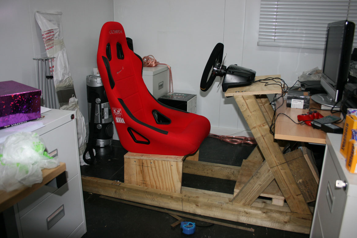

    This weekend I mocked up the cockpit to make sure my estimated dimensions were OK.
    I made it from some 4x2 timber and plywood that was lying around the yard so cost was almost nothing :D
    I know it looks like it was constructed by a farmer but it done the trick and allowed me to get detailed dimensions for the aluminium version.

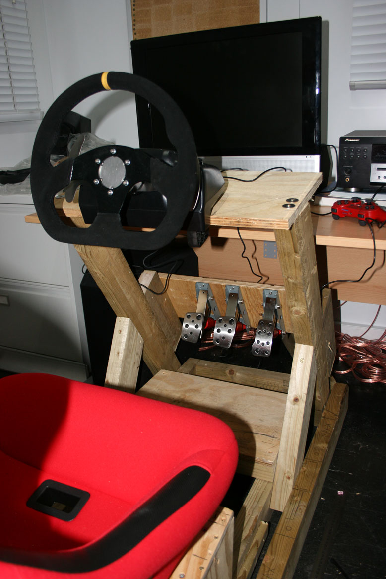

    Here are some pics of the modded G27 wheel and titanium paddle shifters
    I have now prepared most of the drawings that enabled me to produce a fairly accurate materials list and cutting list. Tomorrow, I will order the aluminium 8)

    I like your suede wheel very much.

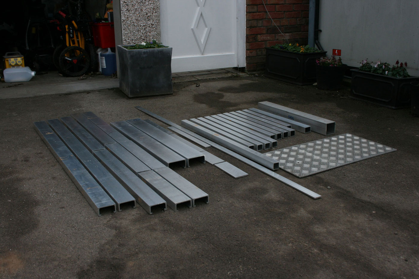

    Bvillersjr :- I understand your concerns about the light weight of aluminium construction but I do plan on sitting this bad boy sub woofer behind the seat:-
    Another reason was that luckily I can get lots of aluminium very cheap ( a round of golf in the summer) My mate Chris runs an aluminium stockholders :D
    Another mate Tim is a welder and has an AC TIG welding set up .... He like beer in return for welding :D
    The raw materials arrived last week and I have spent 4 days in a freezing workshop cutting and preparing all the oparts ready for welding, it should be ready for me to collect tomorrow.

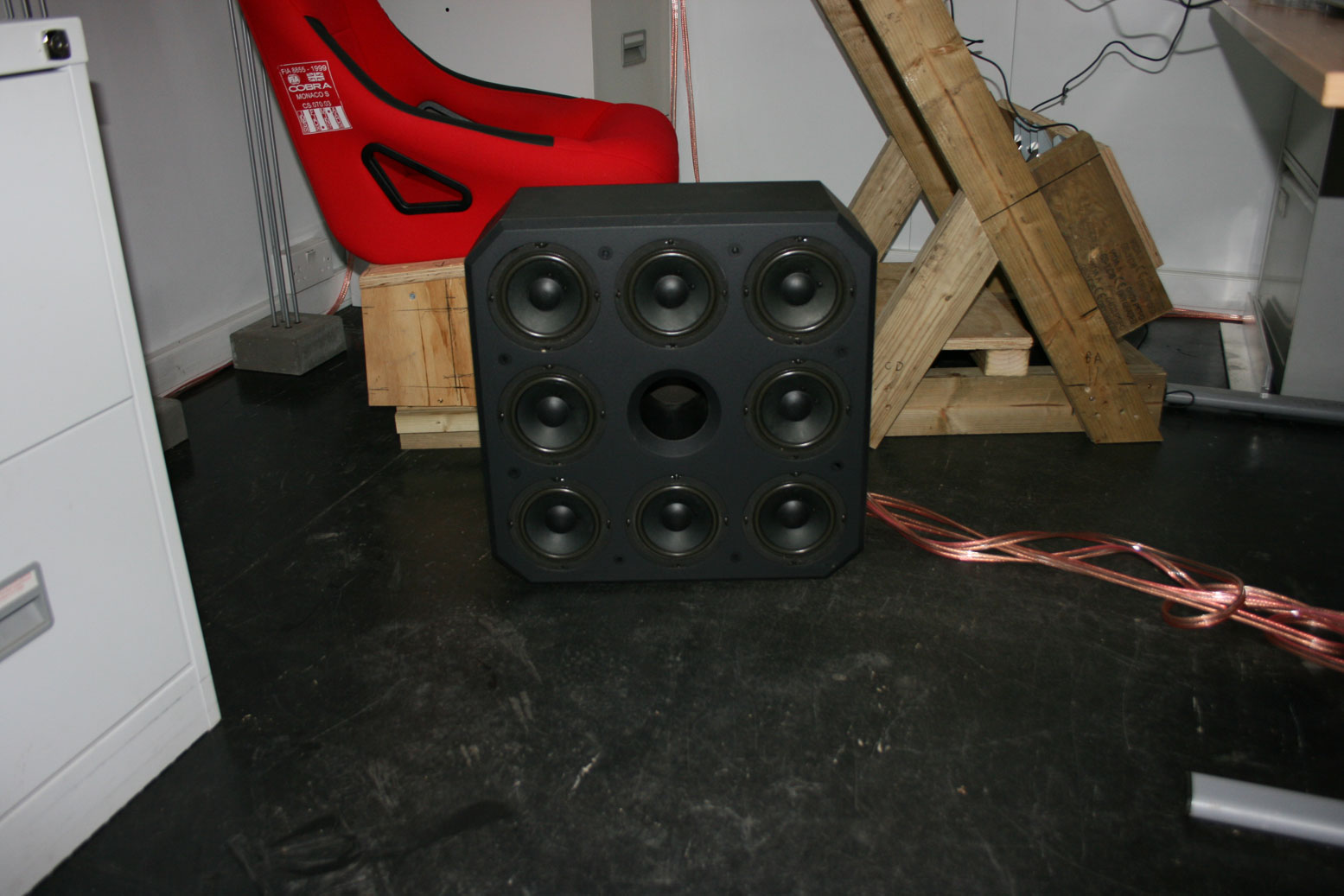

    Silly(c)One :- Hmm maybe six bass shakers is rather excessive, the trouble is that I have never seen or felt any in action, so I guess I was trying to avoid being dissapointed. Another reason is that here in the UK the bass Shakers are very expensive almost $170 a pair !!! If I get 6 from parts express they work out reasonable cost even with the shipping. I suppose I could always sell what I don't use.
    I plan on driving them with a couple of spare power amps I have kicking around the place with some low pass cross overs from the pre outs on my Pioneer surround amp LFE/SUB outputs.

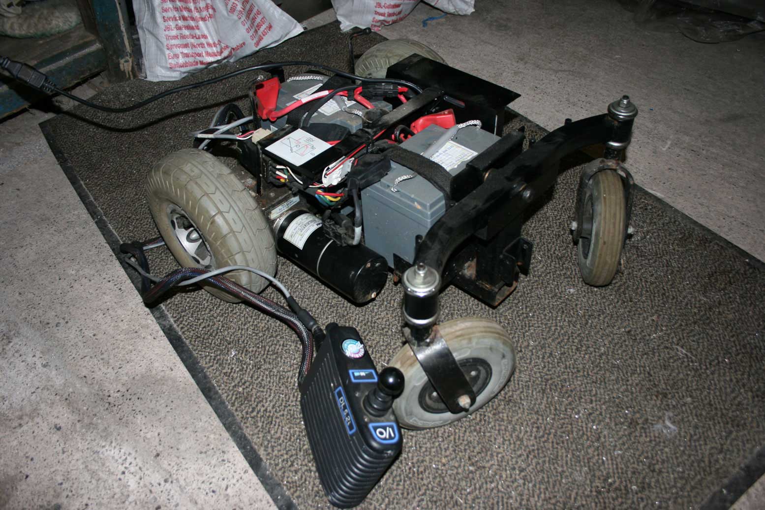

    But today I was given this :-
    I am currently charging the batteries overnight to see if it works.
    The spec on the motors is:-
    Dynamic Controls Ltd WMT90110
    DC24V
    8 AMP continuous
    120 rpm =/- 10 rpm ( I suspect that this maybe too slow??)
    Stated Torque 50Nm (pretty pokey)
    Can anyone suggest some options on how to control these motors, I know the Pololu controllers are only 12V.

    A quick answer about the bass shakers : I bought a pair of 100W bass shakers on ebay (from Germany or Austria) for 55€ including shipping (2*19€ + 17€) and they shake the whole floor of the apartment.
    Moreover, 2 bass shakers on the seat would be too much I heard (and tbh I don't feel much difference with one or two on the seat, so one is enough), so I intend to keep one bolted below the seat and bolt the other one on my base board next to the pedals. I'll keep my thread up to date with the results...
    BTW, I'm not sure a power amp with sub woofer filters is the same as a Buttkicker amp/filter... I had initially hacked my 5.1 Logitech system to use the bass shaker instead of the subwoofer speaker, and there was far too many high pitched sounds coming out of my seat. I will use an Aura Interactor amp just as a filter, it has quite a few settings that I believe change a lot the experience of the bass shakers (normal/A/B ?, Game/Music, a power pot and a filter pot). Else you have to use the Bass Shaker plugin for X-Sim and I am personally not convinced at all by that solution for the following reasons :

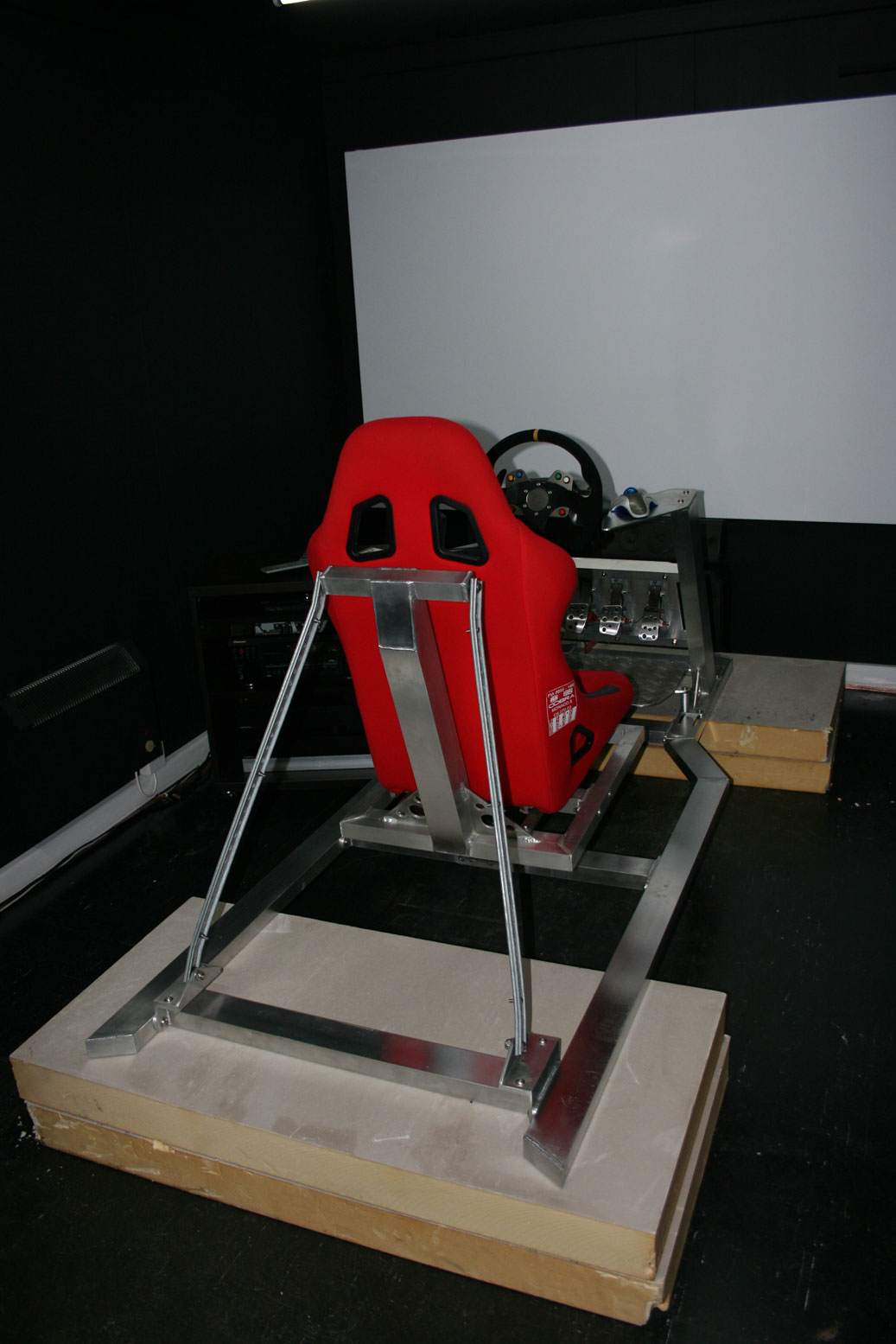

    The main title should now say :-
    The Deaks simulator (phase 1) is now complete :clap:

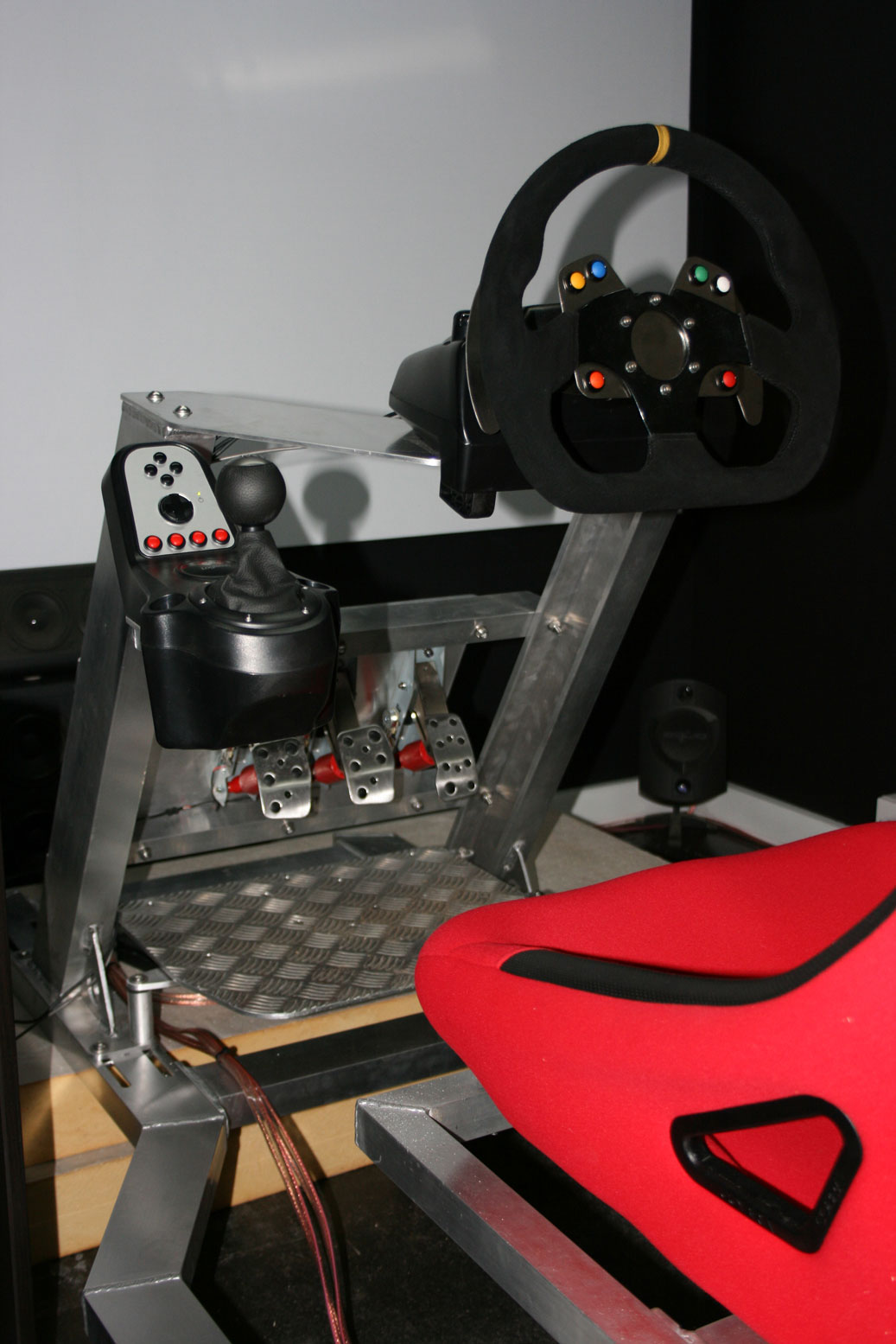

    Its been a while, but since Christmas I have now a working rig (no motion) instead of a pile of different aluminium sections.
    The next stage will be to add motion, I would still really prefer to use Simxperience starter kit, but simply dont have the required funds yet.
    Here are some pics of the progress:-

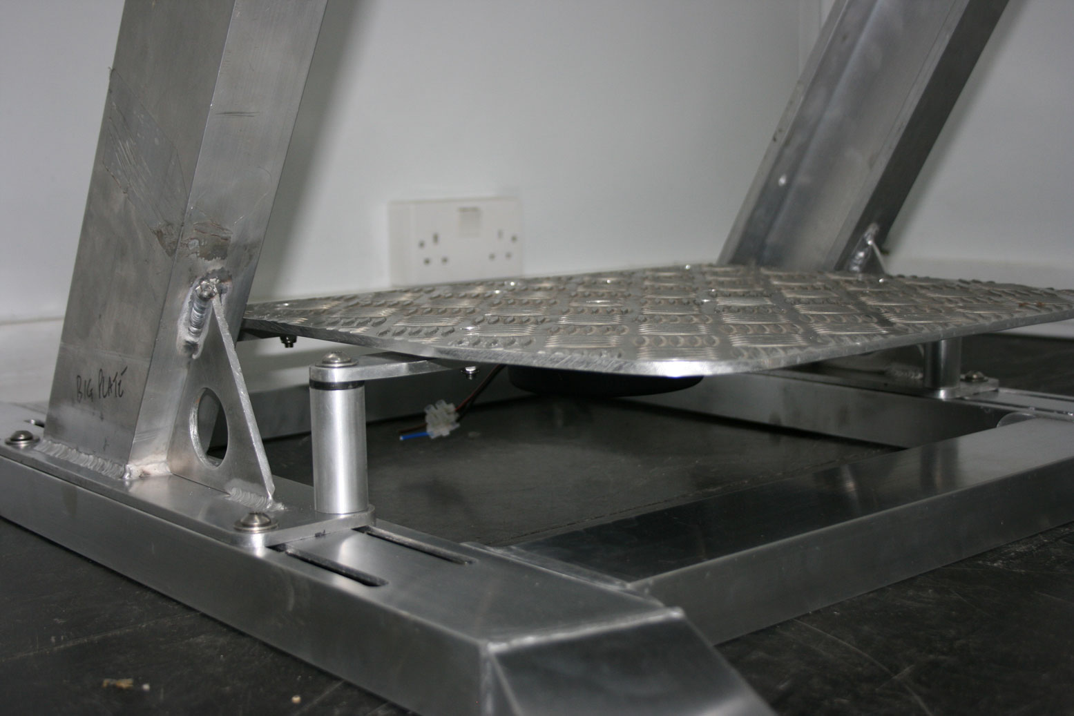

    My method of making sure that people of different heights could use the rig has worked out quite well. It only takes a couple of minutes to slide the whole pedal and wheel assembly forwards or backwards up to 5 inches either way.
    You can see how I did this in the pic below:-

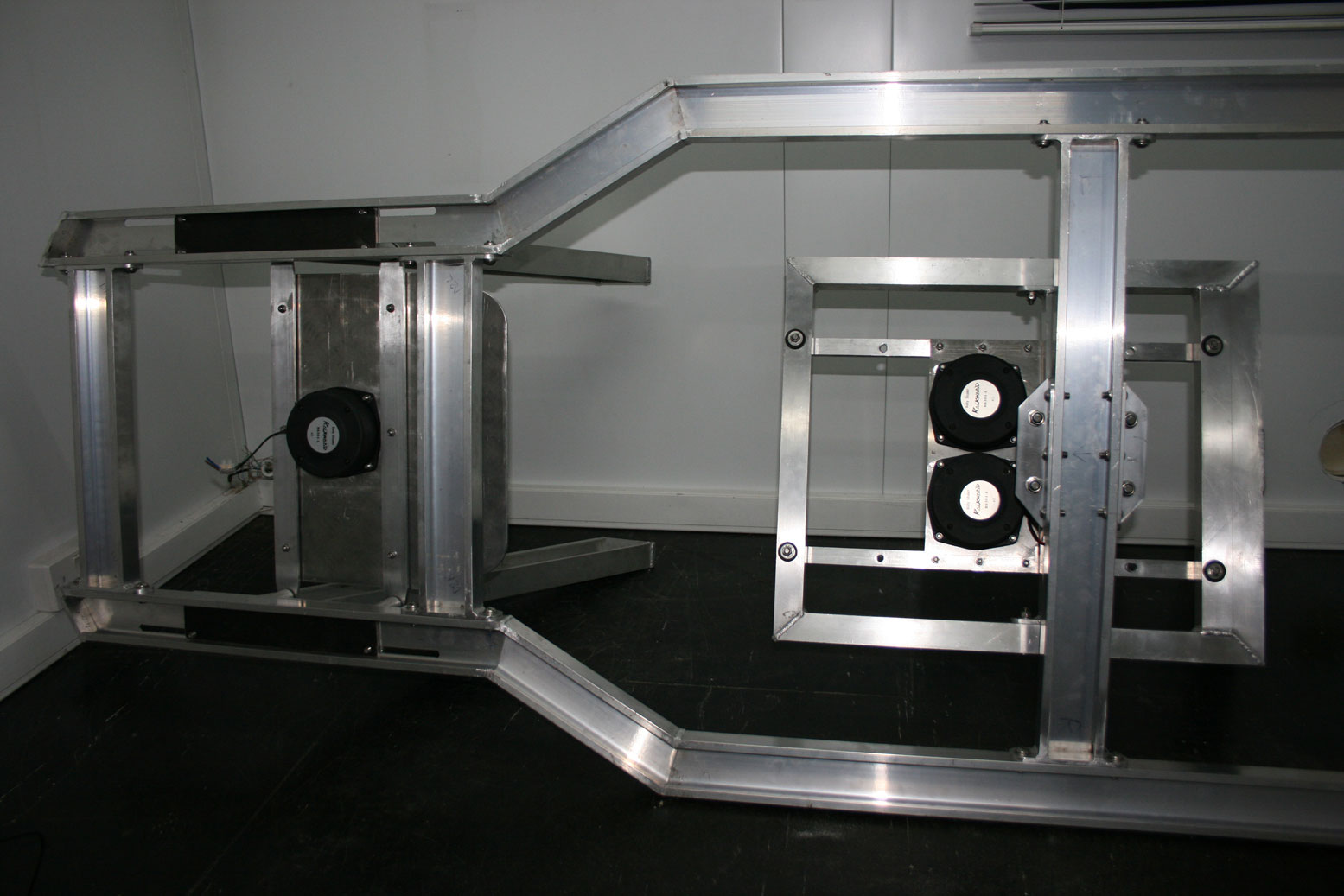

    Here is a pic of the rig from underneath during assembly:-
    I have fitted two bass shakers under the seat and one under the foot plate assembly. The seat shakers work really well, but I'm a bit disapointed with the one under my feet. I might mount it behind the pedal mount instead, as I tried this with my wooden prototype and it worked well.

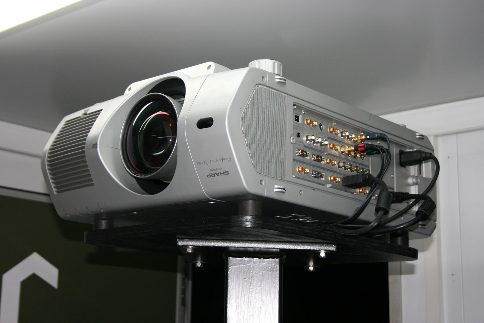

    Thanks to ebay, I was lucky to pick up a high lumens projector (720p not 1080p) for just over a hundred pounds from a company close to where i live.
    It's a monster and the picture quality is good enough for now. The bulbs have a couple of hundred hours left, but when they go I will just throw it in the bin as the bulbs are almost £300 each :thbd:

    To be honest it cost me a round of golf in the summer for Chris who supplied the aluminium (approx cost to me £25)
    The welding by another mate Tim did cost me £100 as it took him 3 days to jig it all up and weld it together. He used a really good AC TIG welder, and his welding is excellent.
    I dread to think how much the aluminium would have really cost if I had to pay 'normal' prices, a good few hundred pounds I suspect :uups:
    It does flex a bit, which is no problem in its current form, but when I add the rear traction loss (whenever that may be) I will add some steel L section inside the main chassis rails from underneath.
    I am really pleased with it so far and love the way it looks. I cant wait to get the motion working. please come back to me ASAP about the AMC stuff ;D
