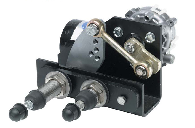

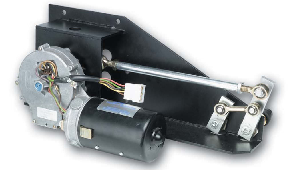

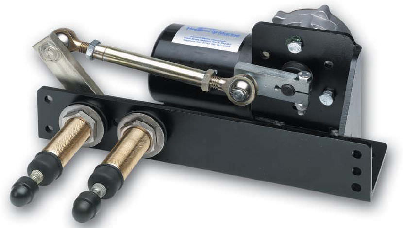

    First, as I see most of the used wipers here are commonly any car wiper motor ... And I think the better wiper motor is related to it's availability around you and how you're going to actually get it ? How much for ?
    Second, I guess wiper motors power and torque is related to the wind shield blade size of the vehicle itself and How many blades are there ? ... So Buses, Trucks, Ships and Trains are the biggest ... descending to all smaller sizes of each one like Minibus, Van, Boats, ... atc .
    boat-windscreen-wiper-motors-37750-451789.jpg ship-windscreen-wiper-motors-37750-451909.jpg ship-windscreen-wiper-motors-37750-452015.jpg
    So for using it in simulator for pull/push motion the decision is back to its final angular speed ... as you can maximize the torque and the working range as you like mechanically ... but not the speed .
    So, the faster -> powerful is better than powerful -> faster .
    Regards
