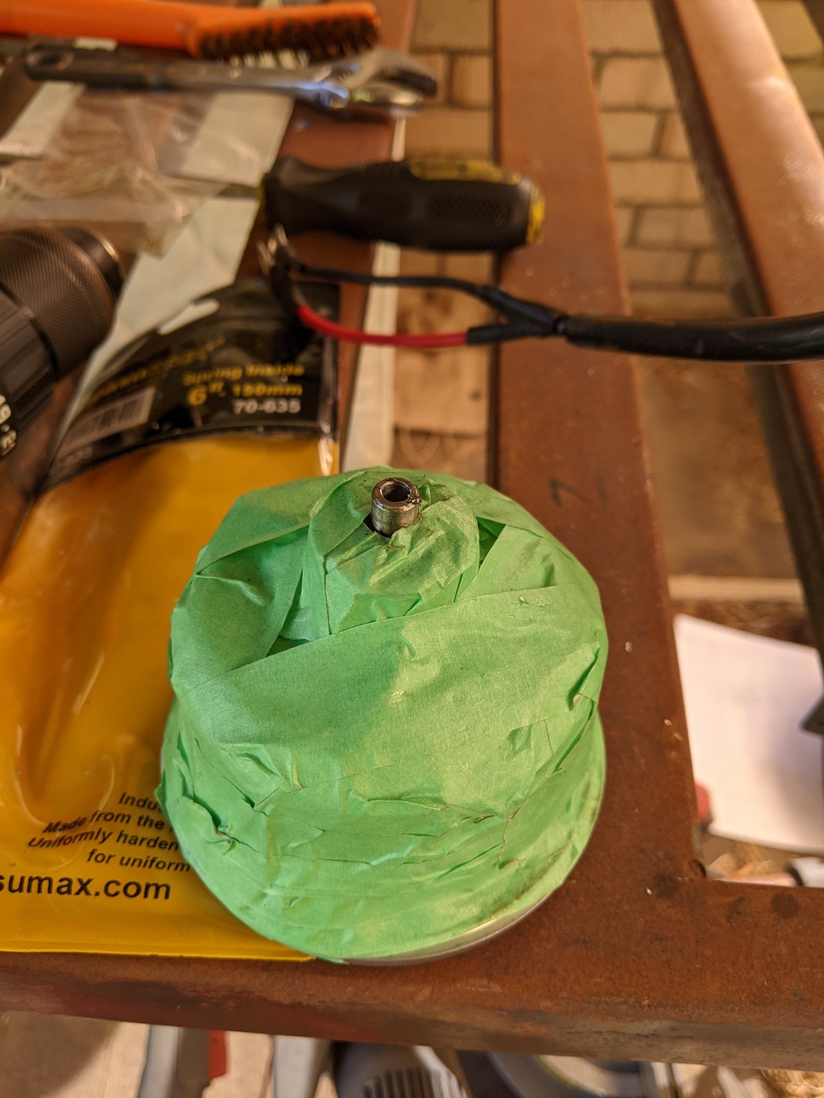

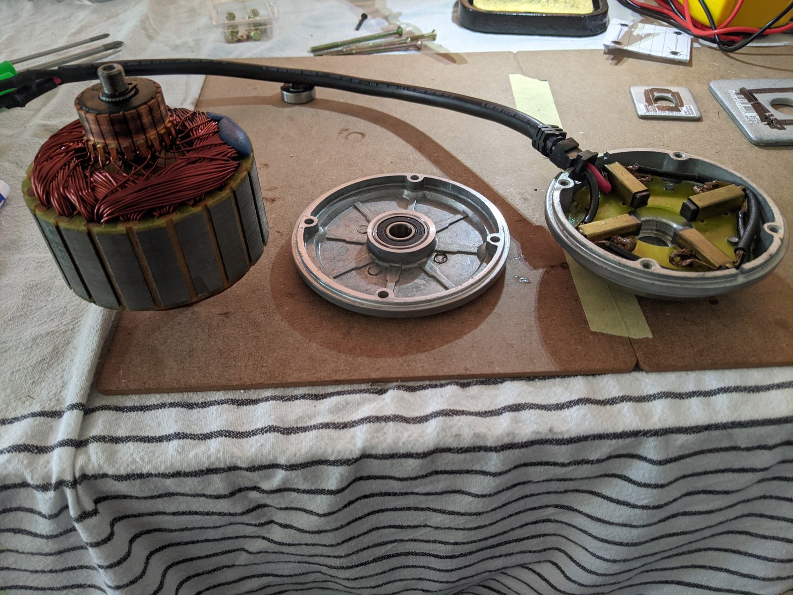

    I finally got the motor pulled apart, tapped a thread into the back of the shaft. Turns out the drill press table had an angle so there goes the M4. Thankfully I has able to drill it out and rethread to an M5 (After resetting the table).

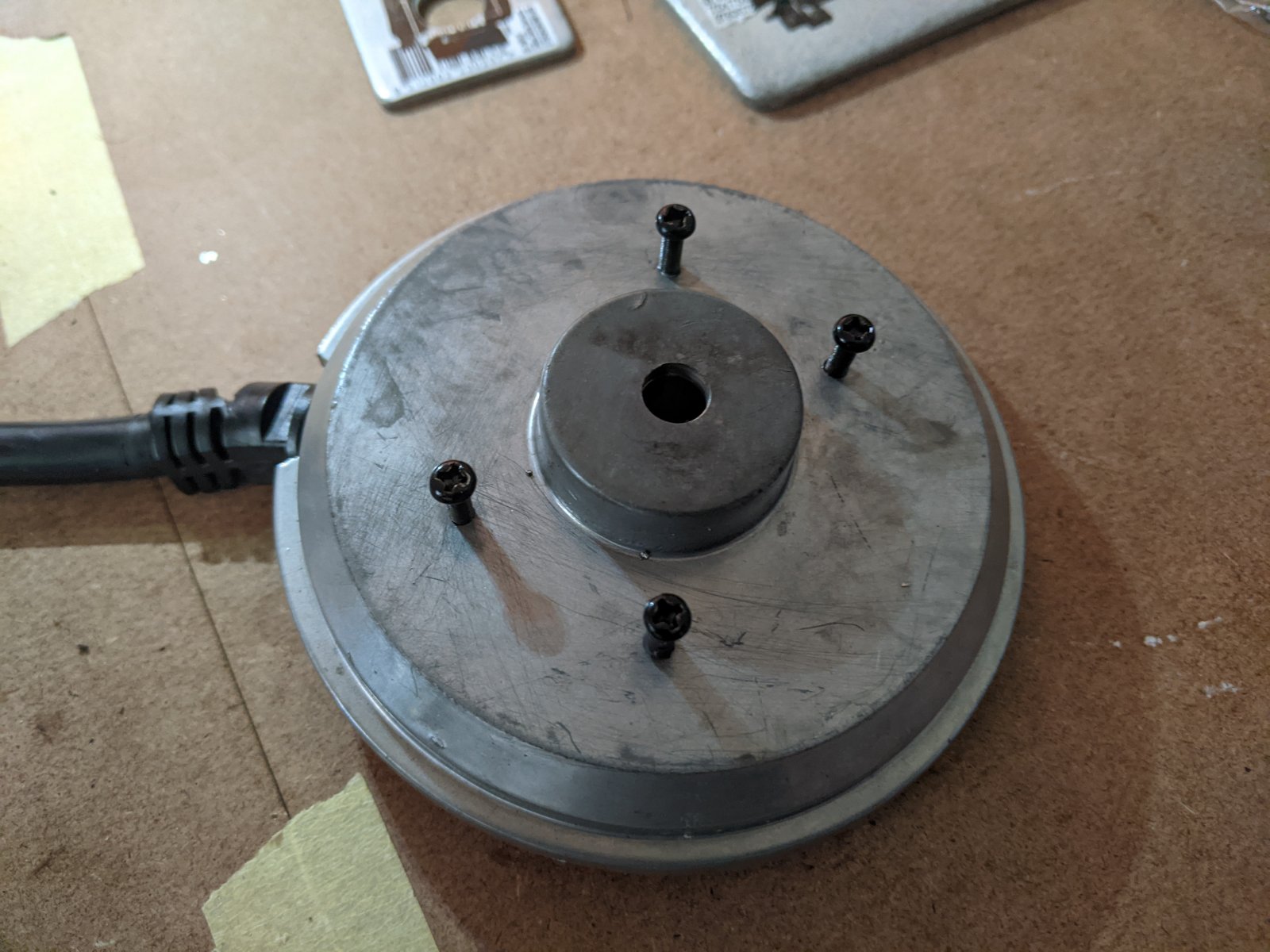

    Also made up a wheel adapter - 10mm ID for the shaft with a 3mm securing hole. This is brazed to an adapter with 60mm PCD to suit the G27 during testing. Somewhere along the line it went slightly out of square and true. Revision 2 should fix this all going well.

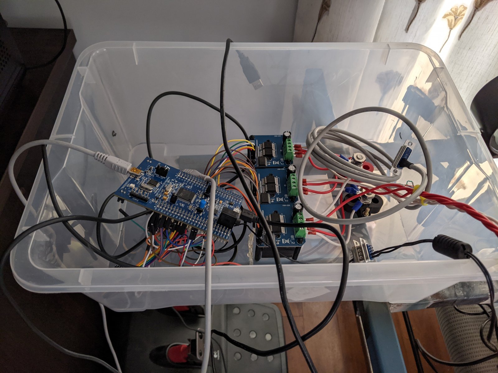

    Tedious process of connecting all the pins - they have to come off again soon to be able to feed them on the correct side of the interface box but tonight was just for testing.

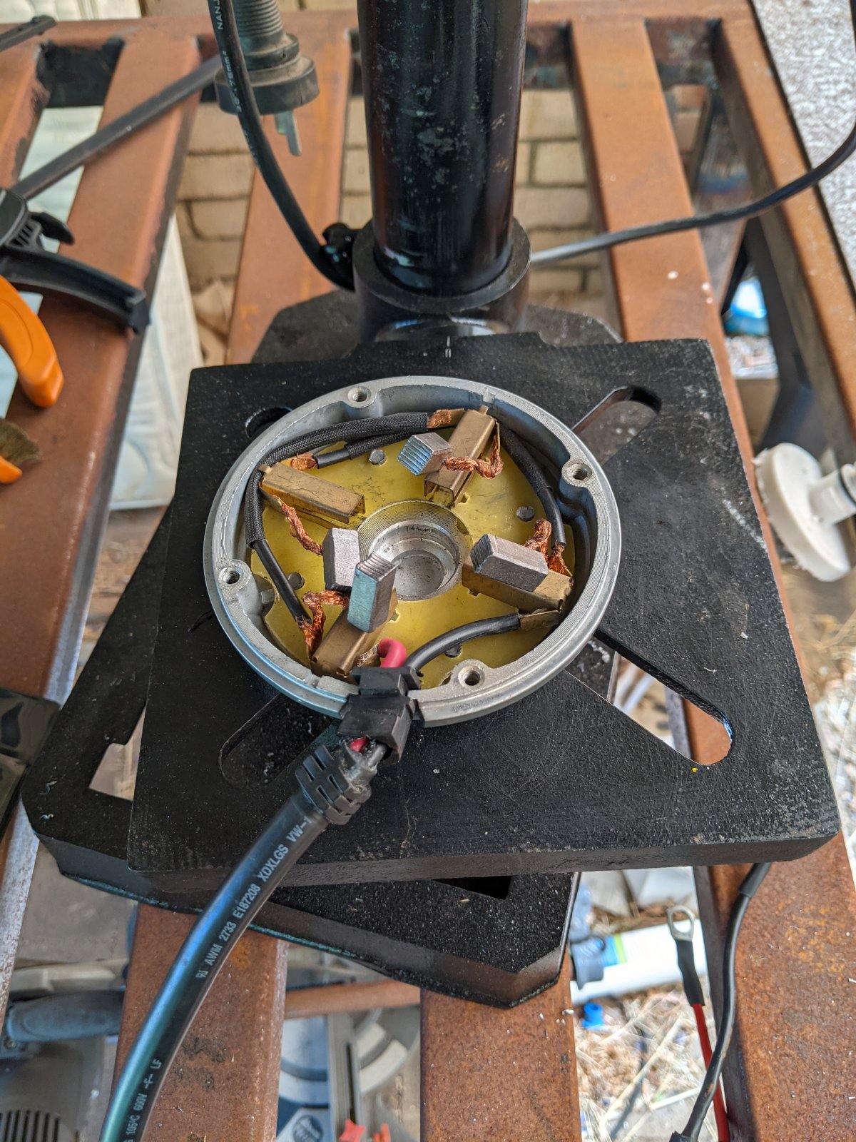

    Further updates, opened the motor up and religned everything. Didn't seem out of sorts.
    Now when I power it all up, motor only spins in the one direction. Swapping between PE9 and PE11 will change the direction. Speed changes every 10 seconds. Motor runs as expected when hooked up directly to the PSU.
    Perhaps I have burnt out more than just the IBT.
    In other news, sprang for EMC Pro. Runnings just the two IBTs now, however the perform much better with active cooling. Those little chips certainly get hot quickly otherwise. From MMoS to EMC leads to some different pins, coincidentally this fixed the movement issue entirely. Possibly messed up the PWM pins (PE9 - PE11?)

    3/ Secure everything down, make the component box overall neater and mount the connector pins for neatness.

    Finally got some photos.
    PXL_20230105_042643588.jpg PXL_20230106_000714035.jpg PXL_20230104_064303237.jpg PXL_20230104_081618202.jpg PXL_20230105_042636208.jpg

    Wheel adapter was redone. It is definitely closer to centre and true (always room for improvement). The hole in the motor shaft seems to be a little bigger than an M3. Callipers show 3.1mm. I think I'll leave the M3 in there and file a flat into the shaft and then secure with a set screw. This will also, hopefully, have the added effect of removing any play.

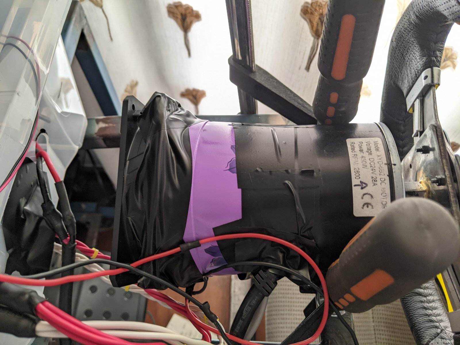

    Overall the wheel feels great - probably a little stronger than needed at 100% but it is just too fun! Come up with another temporary solution to the cooling as seen below.
    Yes, that is a plastic flower pot that has been sliced and diced. I thought I had sheet metal but it was more like thin plate which would have taken more effort to come up with a mock design than I was willing to spend.
    Took the motor apart again to drill / file some more holes. The back has 12 x 7.5mm (Groups of three linked together) and the front 6 x 10mm. I may still need more but the back is definitely running out of room around the brushes to keep some integrity. RC motors have big holes and small supports though so this may be an option.
    A Corsair Sickleflow 120mm doesn't have enough pressure. It moves air but there is a lot of turbulent flow. Motor lasts a little longer before getting hot and cools back down within 5 minutes or so. I have ordered a Noctua NF-F12. I have tried both push and pull. Push ends up heating the steering wheel, that wasn't the best idea...

    New fan is helping a lot but it still felt like a $59 AUD bandaid.
    Did some more reading into EMC and the 'Constant' Tweak had been bumped up to 120%. I don't know when I did that. Changed it back to 100% and the wheel gets warm but far from hot. I'm more than happy with that temperature and the FFB is still nice. Not as strong as before but if I'm being honest, it was probably more than necessary :p
    This fan is loud though. I'll try some resistors to help lower the voltage of it which should quieten it down. I can see it will be a game of fan sound vs vent holes vs FFB. I'll find the balance sooner or later.
