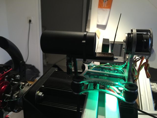

    As you may know I have my Oculus tracking camera attached to my rig and have noticed since runtime 1.3 that after a while (especially noticeable in a F1 car where you sit so low) that I slowly sink in my seat to a point where I have to reset my center (I have it mapped to my Steering wheel). It seems to get worse the more roll that my rig has. I have built a rig to test this out and it seems that the new runtime for the CV1 is very susceptible to any camera/headset movements outside the norm which is a real shame for people with large movement sims like myself. Has anyone else notice this?

    Fixed! - fitted the tracking camera to a 2 axis servo controlled camera gimbal (designed for a GoPro Camera) - disconnected the Pitch motor as it seems to not be the problem DOF, drove around in a formula car for over 30 minutes - no more sinking :).

    It's a two axis gimbal off Ebay - delivered from Melbourne Australia around $50 - designed for a quad copter/GOPRO. Came ready to go. Mounted it to a bracket fixed to my rig where my camera normally goes. Connected 12vdc to power it and pulled the pitch motor plug off the control board as you don't want, or need it - then have to fix the pitch axis so that it stays level. Mount/balance the tracking camera, turn on the power, it self calibrates and then is ready to go. As the rig rolls it will keep only that camera axis level.

    I tried to set the camera in the center of the rig, but still have the same sinking issue.. I can confirm that if I disable the roll movement the camera stays in the correct position.. So I have ordered me a 2 axis gimble and will set this up and retest it.. I hope I have it here at Wednesday!!. Will write up as soon as I've tested it!

    I can confirm that it works.. I still have a minimal sink, but way less then before .. but that is a matter of further tuning.. perhaps I have a bit to much vibration on the rig..
    and perhaps I should remove the antivibration balls in the gimbal frame..
