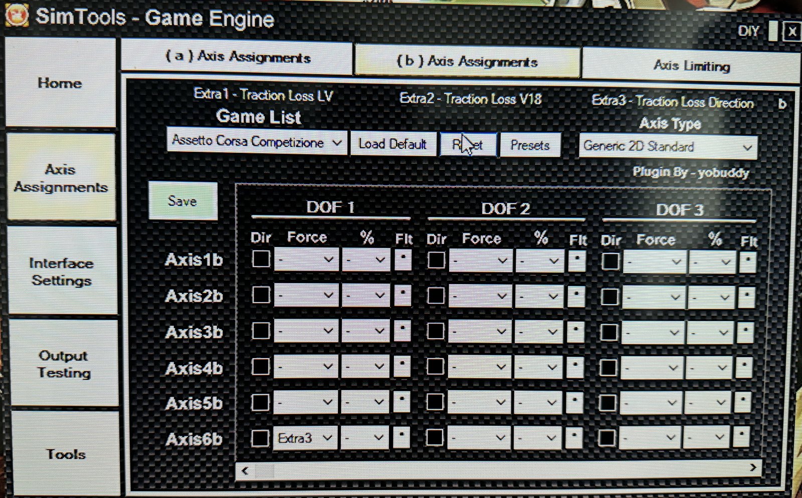

    Hi everyone. I apologize if I'm in the wrong section, but I tried searching and couldn't find anything.
    I recently mounted my station (6DOF), and tried the configuration on simtools (7 AMC AASD15A with @Thanos.) The problem is that when I run the test output it doesn't detect the Surge. Is there a guide for my 7 servos? Thanks.

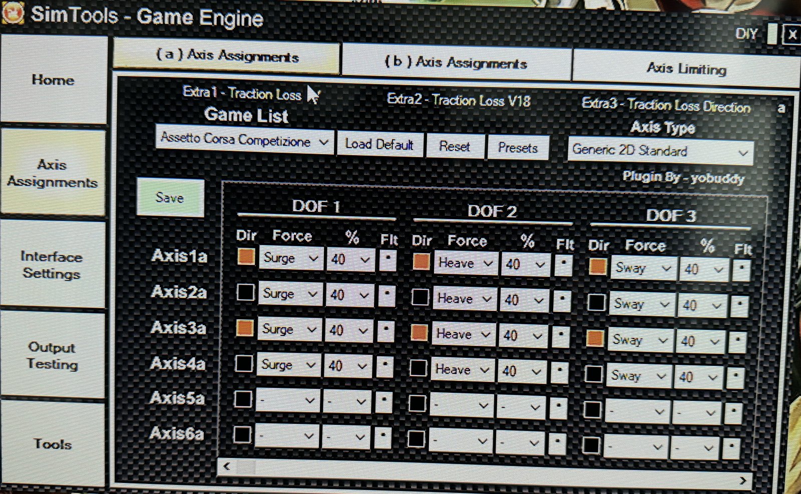

    Output Testing uses the Default profile in Axis Assignments, so can you please post a picture of that.

    It’s the same like the others pictures

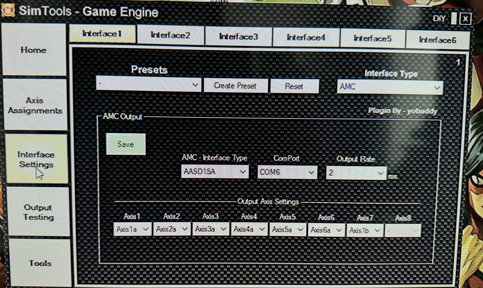

    Another things. I wiring the actuators like this:
    RL port1, FL port2, FR port3, RR port4, TL rear port5, Surge port6, TL front port7
  11. simone maggioli
    simone maggioli New Member Gold Contributor
    Nov 26, 2023
    16
    56Coins
    4DOF
    I configured the 6 axis, where i can find the 7th? Because miss.

    I think in simtools is the axis1b (since first 6 actuators are on slot a)
