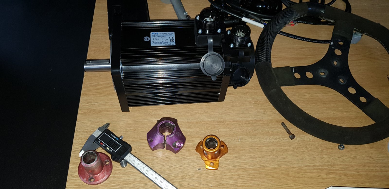

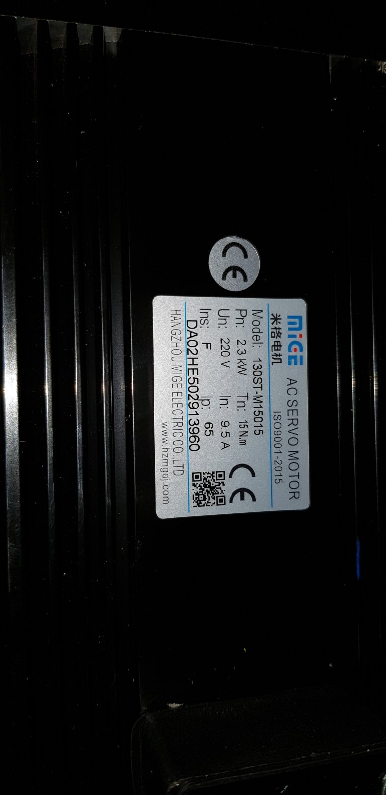

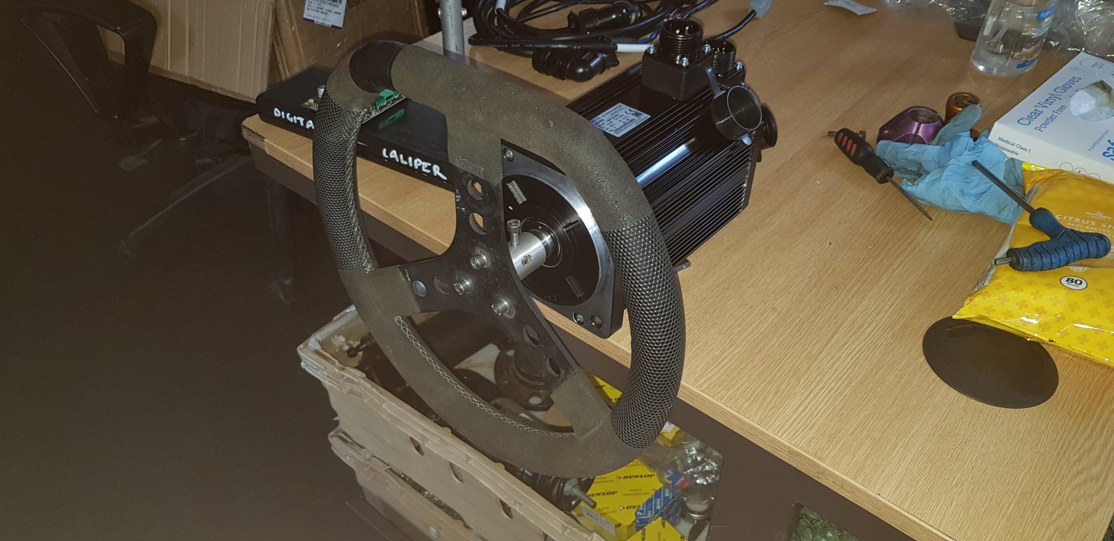

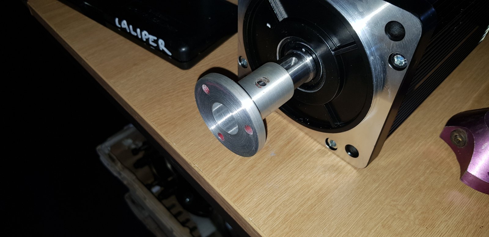

    Today the mige servo motor arrived
    The drive appears different to the one Thanos uses, i think it operates the same.
    Unfortunately the TDD board is held up in Los Angeles and itnhas been delayed
    I have fitted an old kart wheel for now

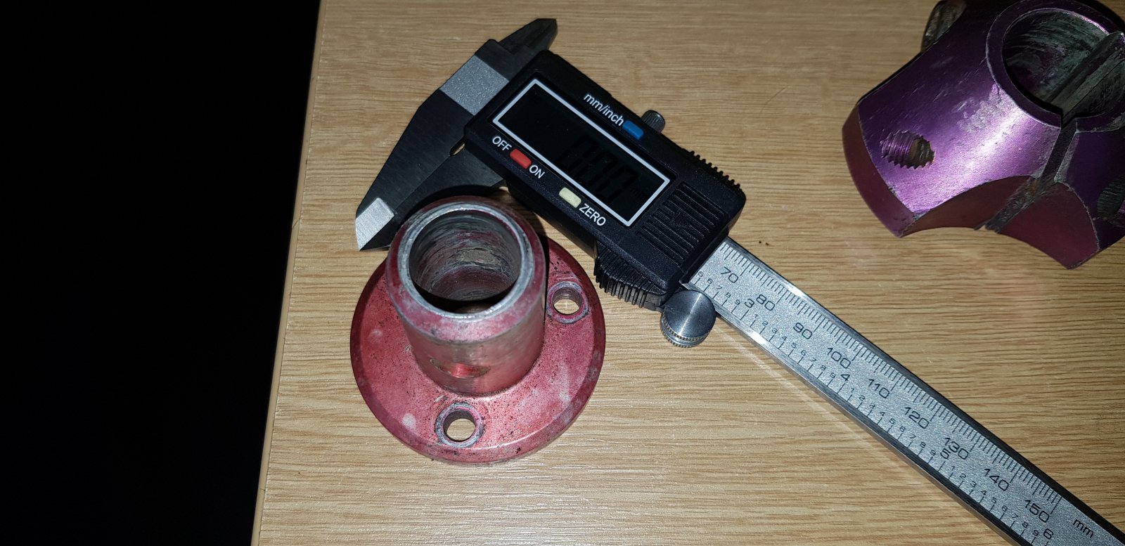

    I took a 19mm dia wheel hub and bored it out to 22mm.
    A quick polish up on the lathe and the hub adaptor looks good.
    I hope the TDD turns up soon so i can get testing

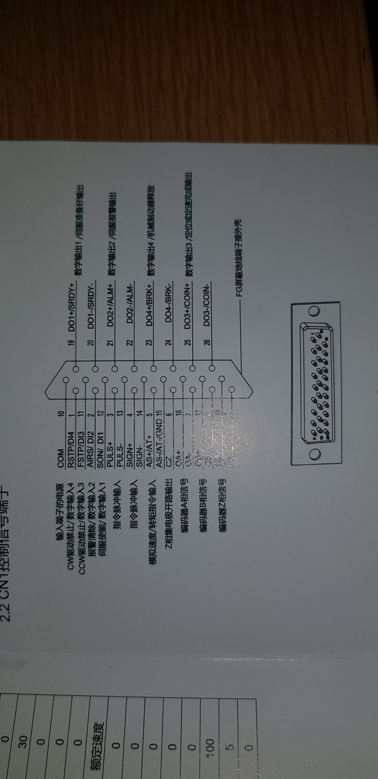

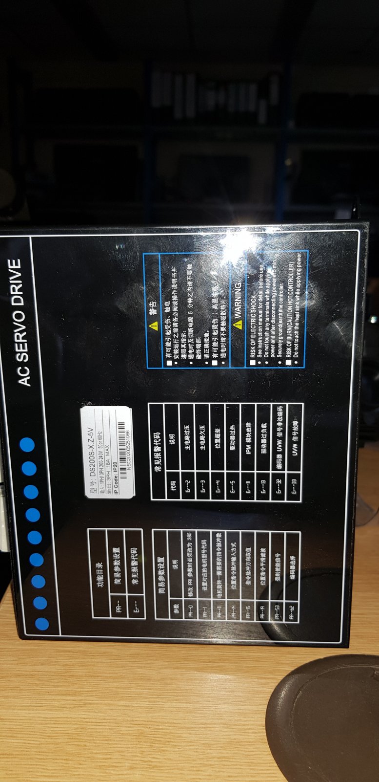

    I asked for the exact AASD-30A - this is what they sent
    do Mige not make the AASD-30A ??
    I have a copy of the manual - will scan it
  7. Gadget999
    1,988
    12,132Coins
    +492 / 11 / -0
    Attached is the pin comnections
    Are they the same as the AASD ?

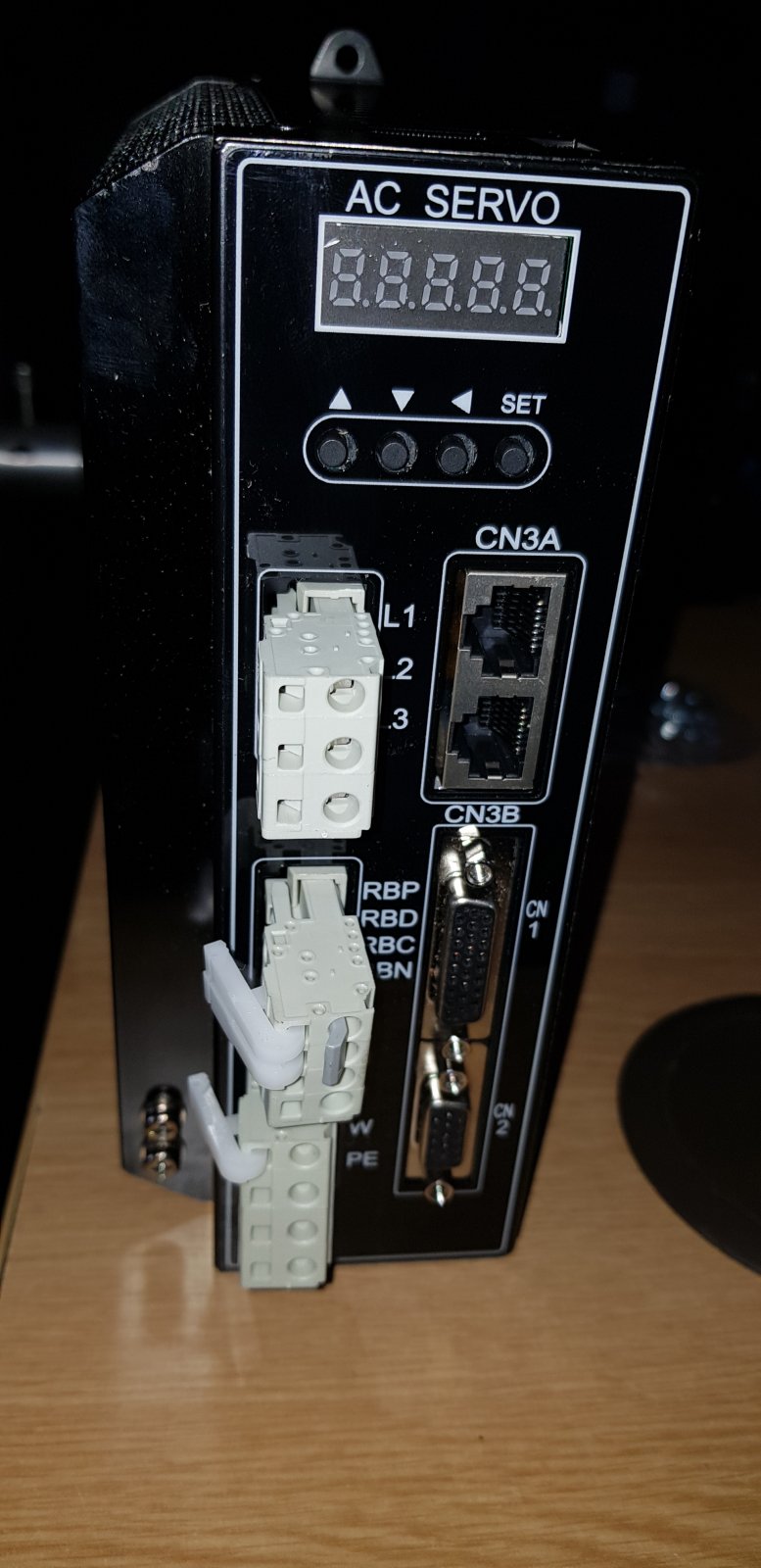

  10. Gadget999
    1,988
    12,132Coins
    +492 / 11 / -0
    does your driver look the same as mine ?
    do you use it for a DD wheel ?
    it seems likely i can use this with the TDD board if the wiring is the same, or i can wire the connector to suit

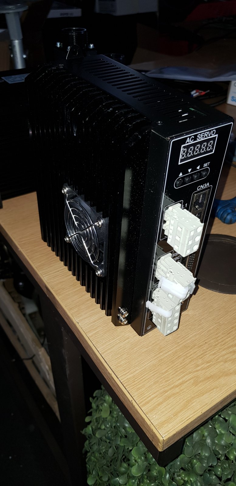

  11. Gadget999
    1,988
    12,132Coins
    +492 / 11 / -0
    it looks like i have the DS200
    seems like a nicely built unit
    manual uploaded :)

  13. Thanos
    Jul 6, 2017
    1,379
    Electronics Engineer
    United States
    2,907Coins
    +1,078 / 10 / -0
    Yes, the custom wiring is one problem solved, but what about the torque parameters? I'm not sure if they are the same or if similar ones exist in the Mige servo drive and with what values...
  14. Thanos
    Jul 6, 2017
    1,379
    United States
    2,907Coins
    +1,078 / 10 / -0
    It shows a 26pin connector... not the same as the DB25 of the AASD servos
  15. Thanos
    Jul 6, 2017
    1,379
    United States
    2,907Coins
    +1,078 / 10 / -0
    Oh, and the Torque signal is two pins Positive and Negative. It doesn't seem to use a single analog Torque signal input with digital direction pin like the AASD...
  16. Gadget999
    1,988
    12,132Coins
    +492 / 11 / -0
    reminds me of the different control strategies used for DC motor controllers - some use 2 pwm pins for cw and ccw - some have a pwm pin and a direction pin
    so I need to understand what the TDD board exactly does and how the code works
  17. Gadget999
    1,988
    12,132Coins
    +492 / 11 / -0
    option 14 allows you edit the type of control :)
