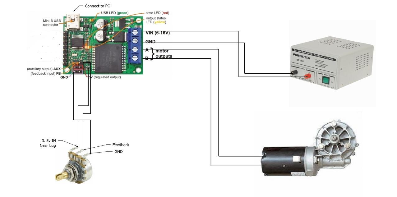

  13. bsft
    agreed, what ever @eaorobbie is smoking, I want some. I just wired up according to this and never had a problem
  14. eaorobbie
    20,465Coins
    +1,686 / 23 / -2
    Thanks he doesn't read the documents provided by pololu , the Aux pin can be used instead of the 5v pin so that you can set the feedback disconnect error that can be set in the Jrk. Sorry if I confused you @CoachKalk was not my intensions. Thanks @bsft for suppling my wiring pic too.
