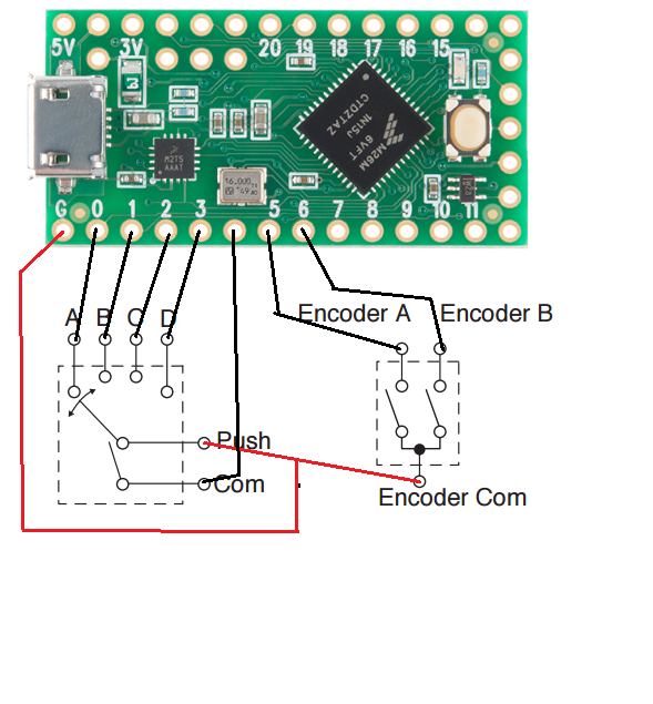

    679Coins
    +95 / 1 / -0
    Amm on the forum you said you have connected the COM to ground.. So COM is ground and other terminals are wired to the inputs ( Push, A,B,C,D)??
    If that is correct then you wired it wrong. From the datasheet you have provided (Page 2 - Circuit diagram) I can see that PUSH should be ground (don't know why it is like that but it is written in the schematic diagram) and COM should be connected to the input where the pushbutton is connected.
    Thy swapping COM and PUSH wires.
    PUSH and Encoder COM should both be grounded
  19. tadythefish
    tadythefish Active Member
    Jul 8, 2009
    148
    Process automation engineer
    Slovenia
    679Coins
    +95 / 1 / -0
    This is how it should be done (if you look at the shematic)

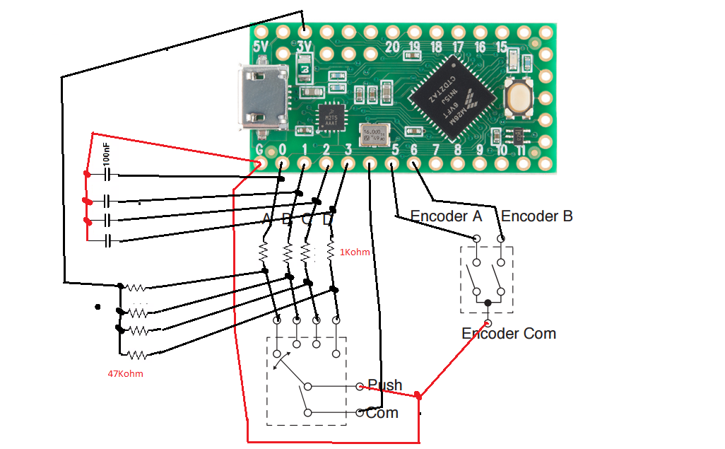

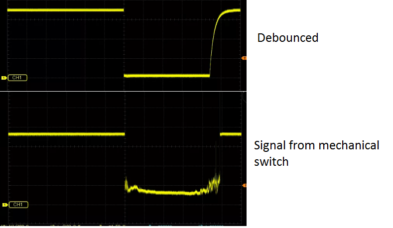

    And this is how I would do it ( hardware debounce). If the libraries are fighting with each other I would do it like this. It does add quite a few components but this is good hardware debounce.
    The capacitor (100nF) and resistor (47Kohm) have an effect of slowly raising the voltage on the input. This adds some time delay but if you use simple push buttons this is not noticable. The 47k and 100nF combination gives you 12ms of delay before the voltage on the input is at 3V. I woul have to look at the teensy datasheet to see at what voltage on the input is considered logic HIGH ( this is less than 2.5V).
    But it is easier to try it out. If you still have bouncing issues then you have to raise the resistor value OR the capacitor value.
    I made the drawing as a quick quide line... The encoder shoul also be connected like the buttons (should be debounced). These encoders are mechanical and the bounce. You clould get false values!

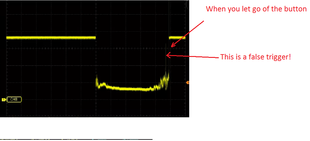

    In your code you use interrupts on all inputs so any noise on the pins is going to trigger the code!
    The 1K resistor is there optionally BUT it helps protect the switch from current spikes. When you push the button the capacitor is discharged via 1K. If there was no resistor there would be (in theory) an infinent current spike at time zero. In practice there is alot of resistance in the wires, capacitor it self and switch contacts but never the less it could get to an ampere or so. In time this would destroy the contact plating so it is best to include it.
    Even if you don't make hardware debounce please at least add 1k resistors as external pull-ups ( from input to 3.3V) it will save you alot of headaches ;)
    Sorry for my english :)
    And the scope traces....
    False triggering....
