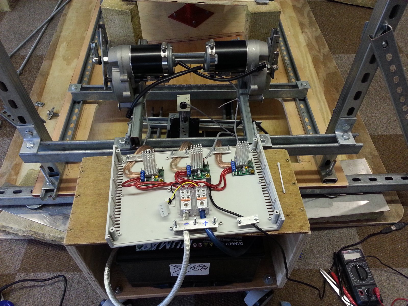

    Progress so far:

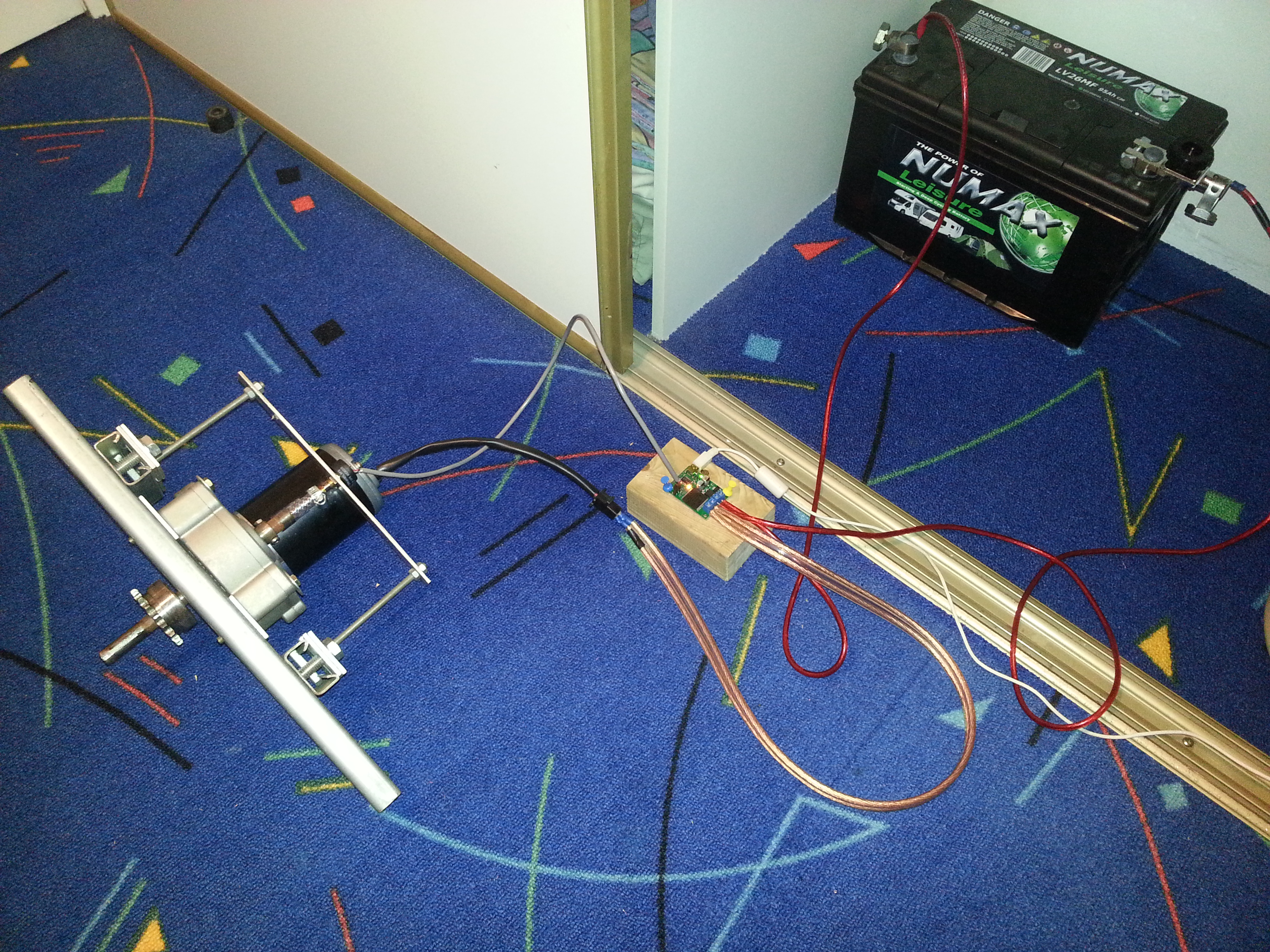

    I've connected up 1 of the JRK's to a motor and had a play with the config utility. For feedback I'm using 180degree hall sensor pots. These seem to work great and are perfectly paired with the JRK as they have a 12bit output. Also are non contact so should last a lot longer than a conventional pot.
    I'll try and keep this thread updated as things progress!

    A question for all you JRK experts...
    How do I get the current plot to show more than +/-5000mA? My motor current spikes way more than this so shoots of the scale. The box won't let me type in anything higher!
    Also what do people use for heatsinks? I've found some small ones that will fit but they are only 18mm tall. I know some people cut up CPU heatsinks. Can anyone link me to one that is suitable?
  8. eaorobbie
    20,398Coins
    +1,683 / 23 / -2
    Yea its a bummer on the graph bit, doesnt go any higher than 5amp (5000mA) the Jrk was never intended to drive the size of the motors we use, originally designed for the BattleBot market(Nerds that love Destruction). Hence a lot of the information is about weaker motors and not the big worm gear units we use.
    The driver is capable of 30amp peaks, yes way of the chart, and some of us push it way past that, 40-45amps.
    With the graph , I normally only select the Input and Scaled Feedback and error for PID tuning.
    And if I need to see how it is actually driving the motor, I include Duty Cycle and the Target Duty Cycle to see if the driver actually needs more power(Amps).
    For heatsinks I have been using these small animals for a while now, but with a 120mm fan(12v) on top of each Jrk and mount my Jrks off the surface as the air gap underneath them helps them disipate heat quicker. Never had one shutdown yet because of heat and please dont touch them after a long run on the sim, they can get that hot it will burn your skin on touching, Done that it hurts. They are quite strong.

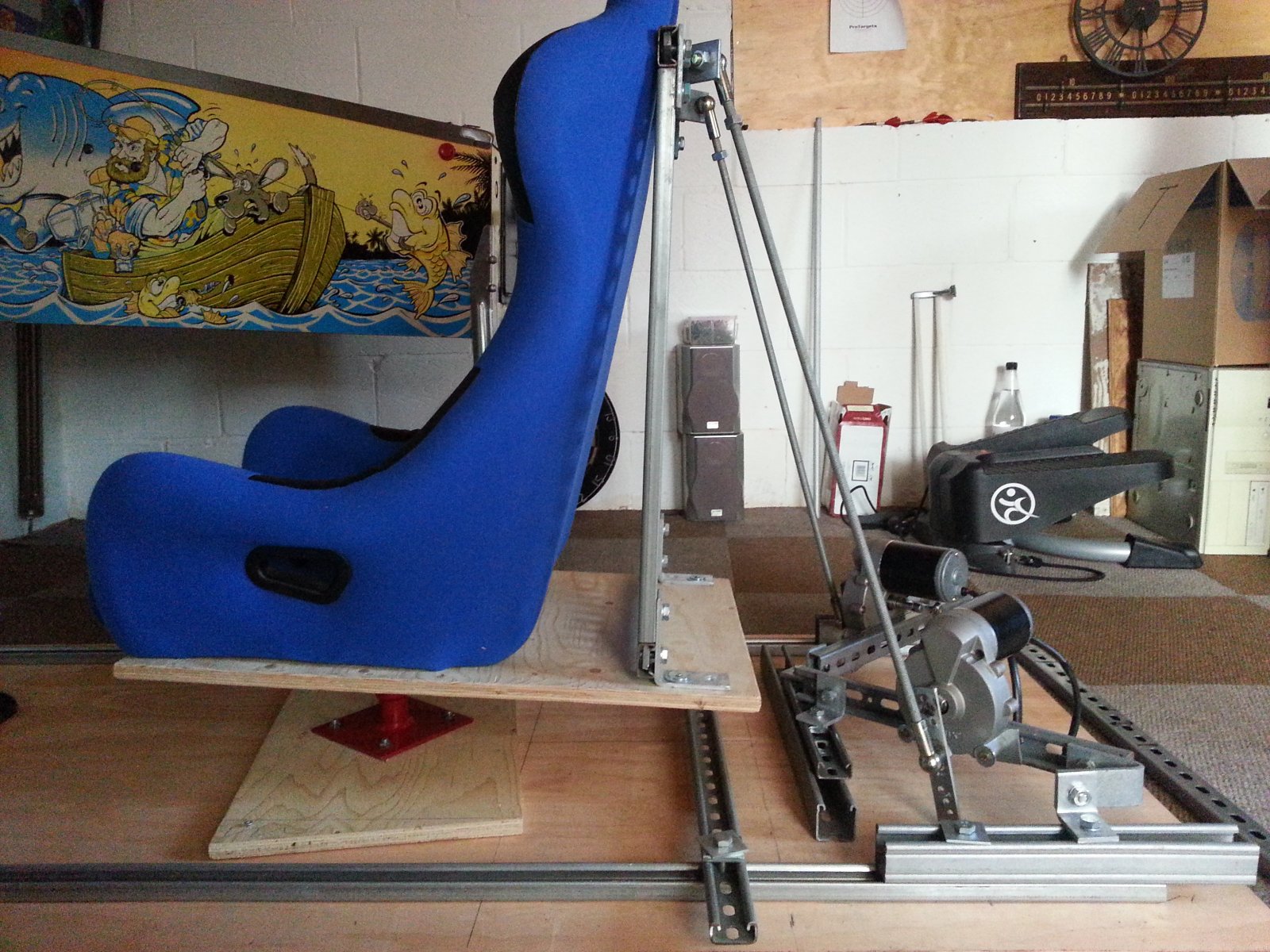

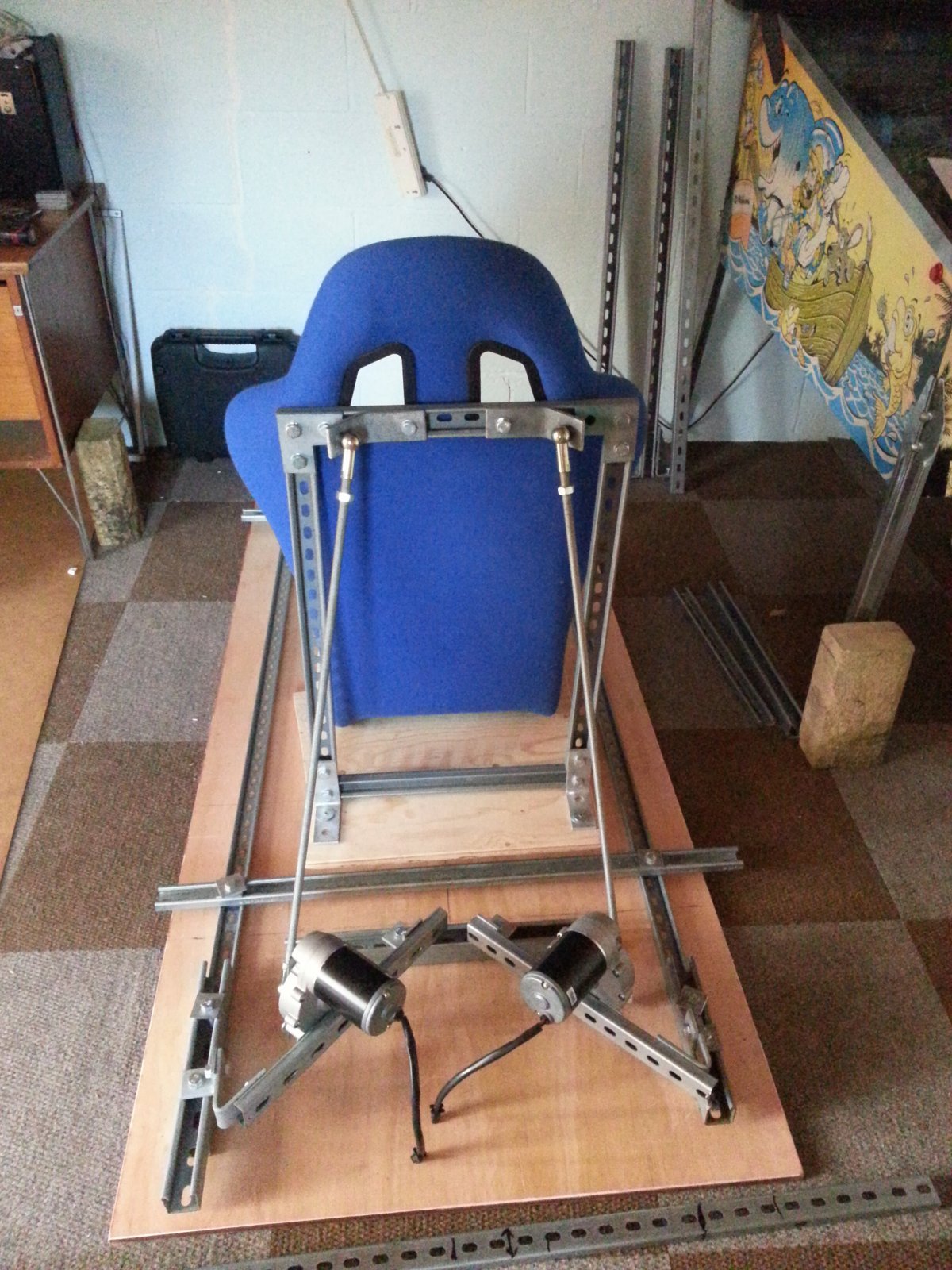

    Time for an update!

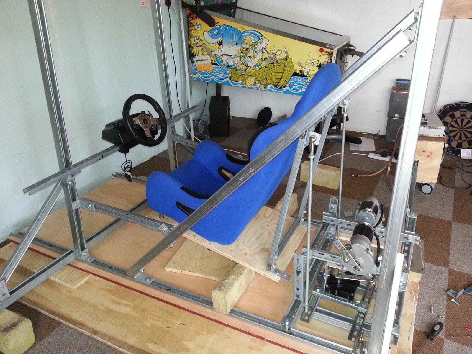

    Seat has been attached to the universal joint. I've also mounted the motors. What do people thing of the motor positions? I've used a 50mm motor arm length.
    Next step is to finish of the electronics box and start thinking about the drift axis!

    A bit unusual motor position/rotation, haven't saw that kind of setup yet, but if it works fine, why not :)
  13. bsft
    angle looks good, a little narrow into the seat so you should get BIG sway, but nothing a profile fix will not sort. Motors in position like that should be fine, a different idea.
  14. SimonUK
    SimonUK Member
    Jun 1, 2009
    43
    Electronic Engineer
    England
    705Coins
    +25 / 0 / -0
    What do you mean by big sway? Should the motors be further apart from each other?
    They are completely adjustable in all directions so I can quite easily change positions if required.
  15. bsft
    Let me explain
    Example, my foot motor mount sim had motors 700mm from pivot and used about 70mm throw. Which gave me a surge angle of about 7 deg total, but because the motors were only spaced at 450mm, so its actually 225mm from pivot point of centre, the sway was 17 deg total. So with your sim, and I am usually wrong, because they connect a bit narrow at the shoulders, you may have more sway angle. But this doesnt matter, with my foot motor, I just turned down the sway force and number to make it better.
    As said, I am probably wrong by only seeing a photo.
    Dont worry, its a good job you are doing there.
  16. kurgine
    kurgine Member
    Feb 24, 2014
    45
    510Coins
    +22 / 0 / -0
    2DOF, 3DOF, DC motor, JRK, 4DOF
    It looks like it is, so just finish it, start to move and look if you like it. Then when youll have felt how it works you can try different placement of the motors. From pic it looks like youll have shorter movement of surge then sway, ofcourse as @bsft said you can sort it in profile. But you can make less movement in profiller, if it is too short then not much you can do there, motor position could help. Just finish it and try it :)
    I have motors much closer and have to lower movement in profile as it is too much already for my likings, so in your situation no sense to make it closer right now if later you have to lower movement in profile, specially in your situation it is easily changeable later.
    Btw can you tell more about motors you use, i see you got them long time ago, but maybe you still remember specs of them?

    Thanks for the feedback. I'll hopefully get it all powered up this weekend and then can see if anything needs tweaking. Having everything adjustable is a big advantage in my opinion.
    The motors are from electric golf trollys. I got them from ebay but can't find they for sale anymore. They are 180W. Not quite the same as the ones bsft linked too. They worked very well for my last sim, so hopefully they will work well for this!

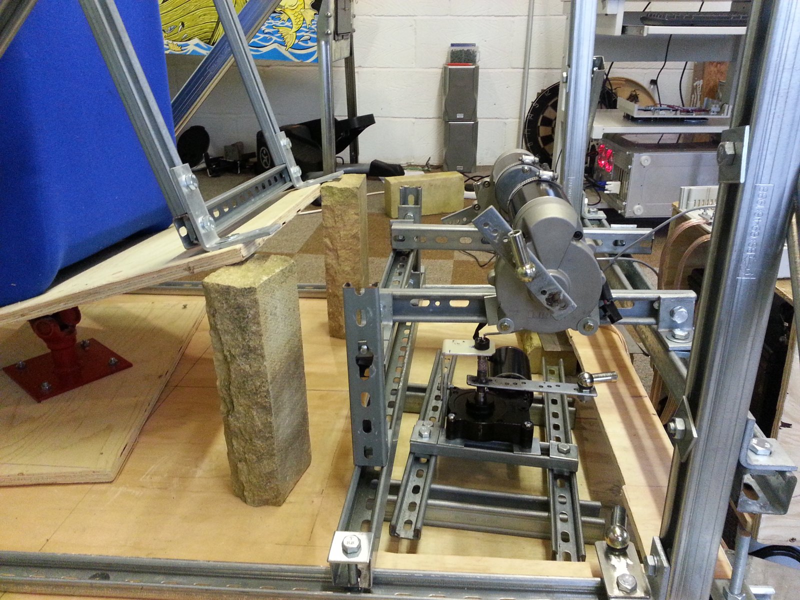

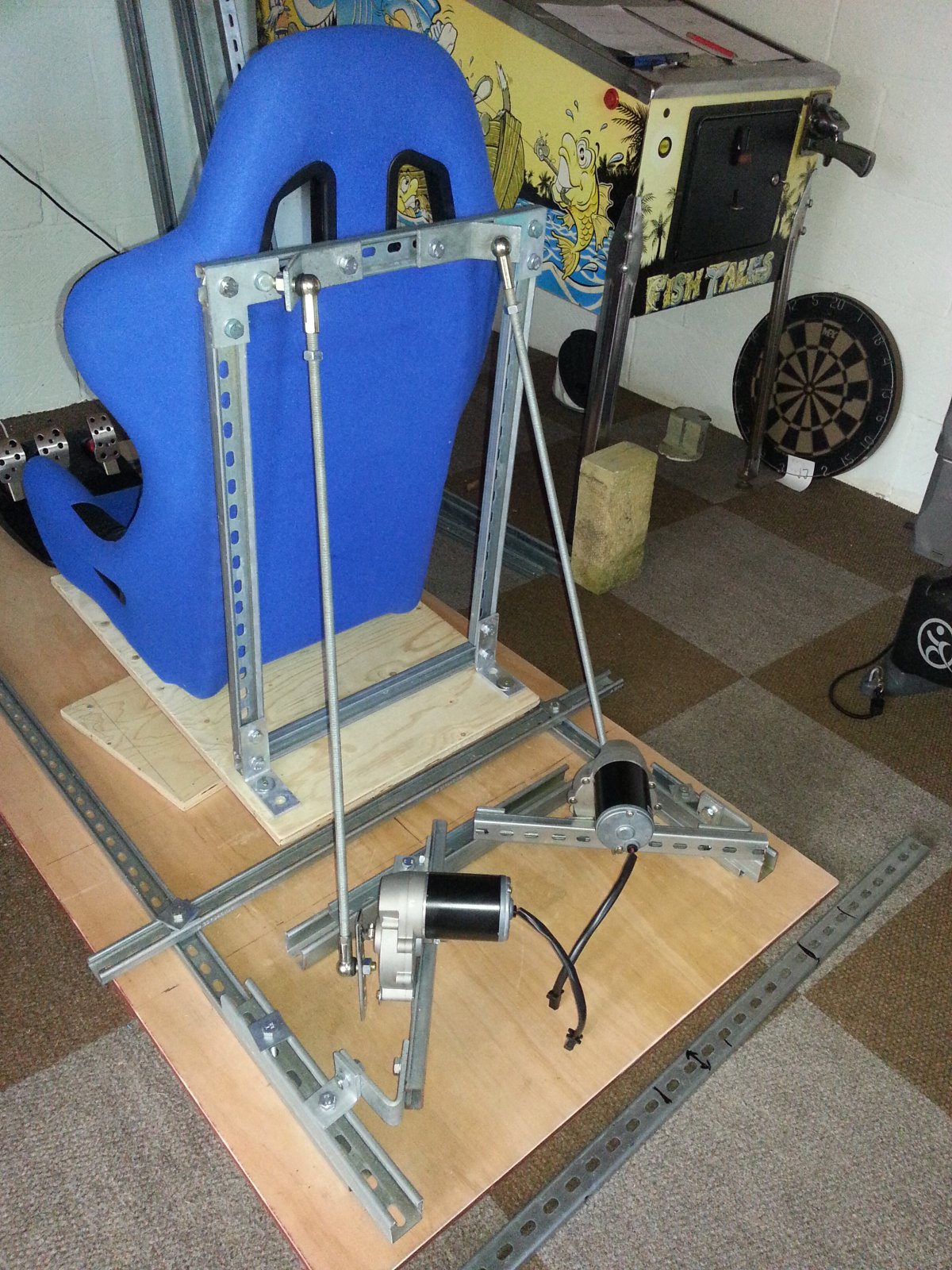

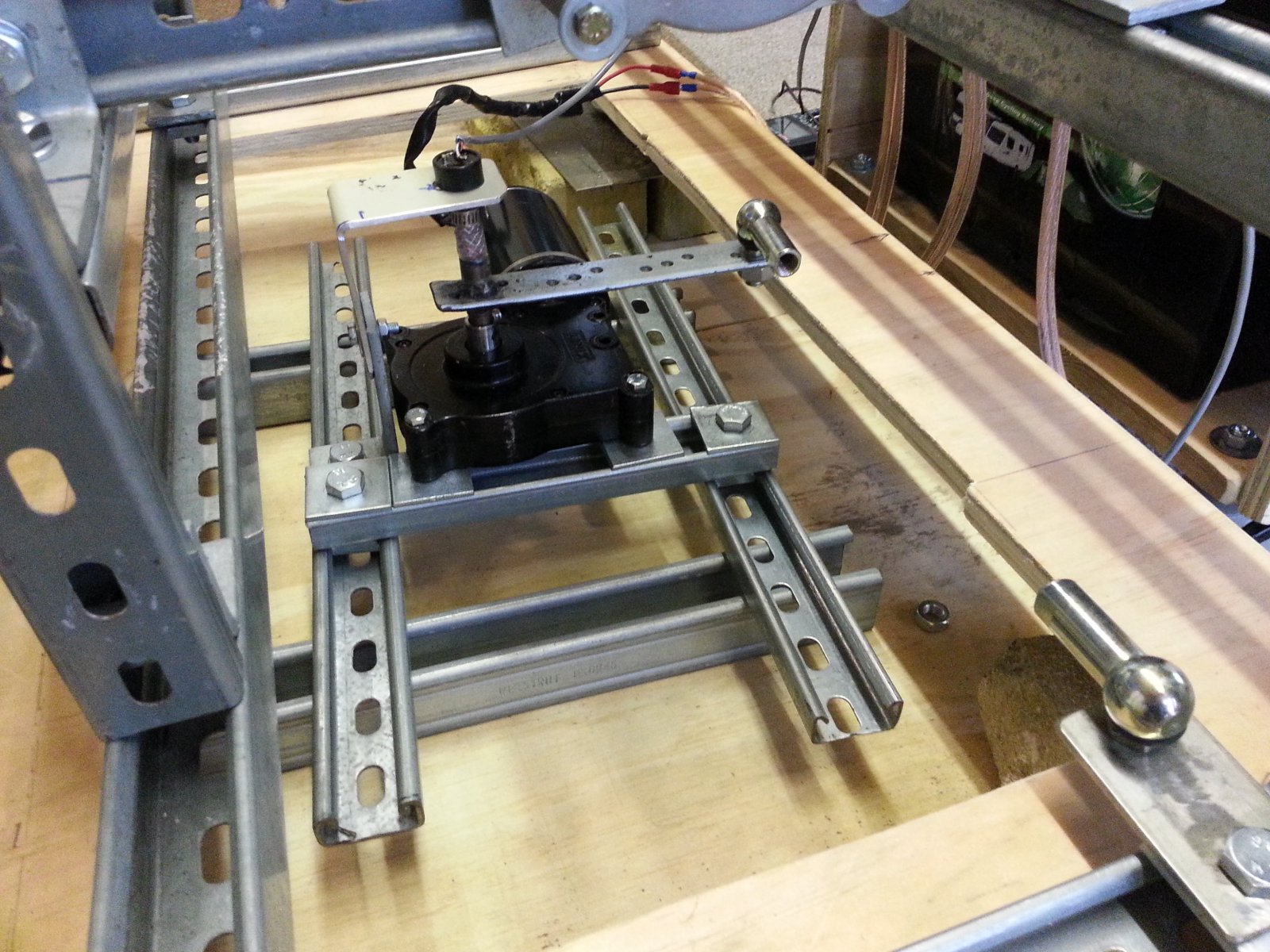

    Time for another update!
    I've re-positioned the seat mover motors to be more inline with the seat. The previous 45 degree angle ended up with a lot of sway and not much surge! What do people think of the new position? Does it matter that they are mounted slightly higher up? They are currently slightly higher than the bottom of the seat. I couldn't decide if this will make the motors work harder or not!
    Also the drift motor is mounted! Again what do you guys think of the position of that?
    Today I have been playing around with a new toy. A Benq W1080ST projector :D 1080p and a very short throw lense. Am going to try and recreate a SuperFOV effect!
