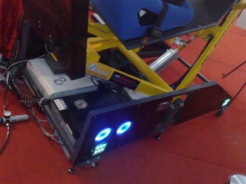

    Hey all, this simulator is built by my team of 3 mechanical engineering students in the over a span of 14 weeks as part of our final year project and public exhibition showcase.
    The simulator is actuated using electro-pneumatics computed by a dual networked PC setup and running on proprietary software as well as X-Sim software. So you can very much qualify it as an X-sim simulator! Here are the videos of it in action.

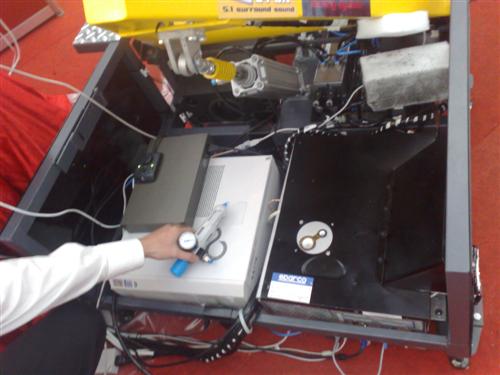

    The simulator runs on electro pneumatics. It motion is computed on 2 independent networked PCs and linked to the Velleman USB 2.0 card. Will post more pictures of the build process of the SIM in due time.
  4. shaunzer
    shaunzer New Member
    Sep 20, 2007
    10
    0Coins
    Re: Motion Simulator

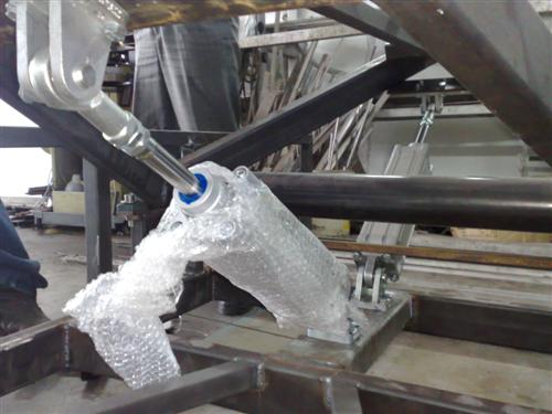

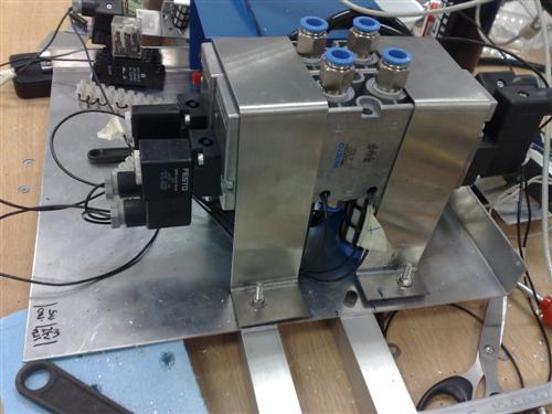

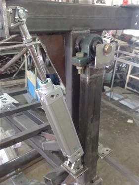

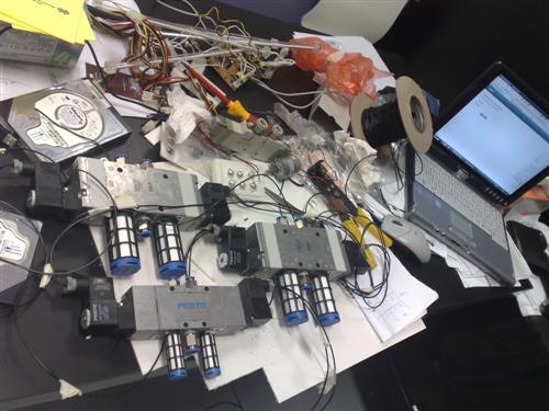

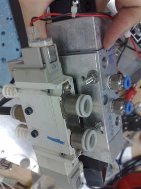

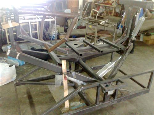

    Here is the build process of the simulator I will be sharing with you all.
    The system uses 2 festo 5/3 middle closed valves for movement of the simulator and two 5/2 valves (mixture of festo and SMC valves) which are used for moving miscellaneous components such as the simulator locking/latching system as well as the controller forward/backward adjust.
    2x 63mm cylinders are used for the pitch motion with the air inlet and outlet variable so that the speed of the air entering and exiting the cylinder can be controlled so as to control the speed of the simulator given only a single 5/3 valve used for pitch (the other 5/3 valve together with 2 more 40mm cylidners are used for the roll motion).

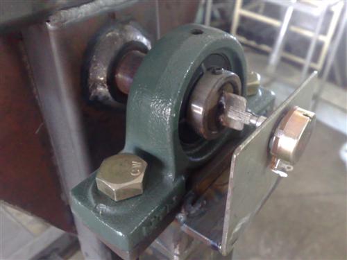

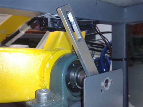

    Initially, custom POT mounts were created for and mounted onto bearings, at Rotational POTS are used.

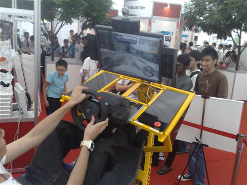

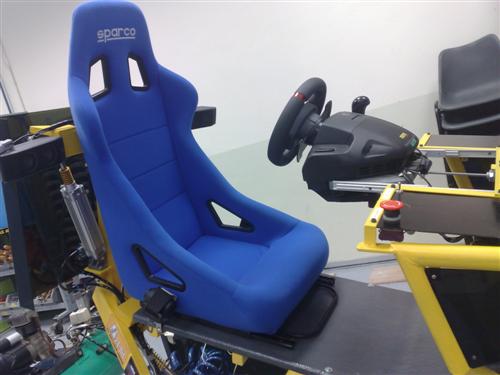

    Here you can see the sim in operation (you can see the videos shown earlier in the post in action) what it does is the valves are made to switch as fast as it can so that air flow can be regulated into the cylinders (you can hear fast clicking sounds in the video). Since 2 cylinders are mounted per axis, they can serve to counter's forces so that the speed and smoothness of the sim can be varied as well.
    The sim had few other additional eye candies like status lights and cool LED fans.
    Other standard features include the logitech momo racing wheel and surround speakers on top of the webcam for multiplayer.
  6. shaunzer
    shaunzer New Member
    Sep 20, 2007
    10
    0Coins
    As mentioned, rotary POTs were used, but was set back due to lack of resolution. In the end linear pots were used, we are looking into expanding the sensitivity with rotary encoders and/or light gate rotary sensors.
