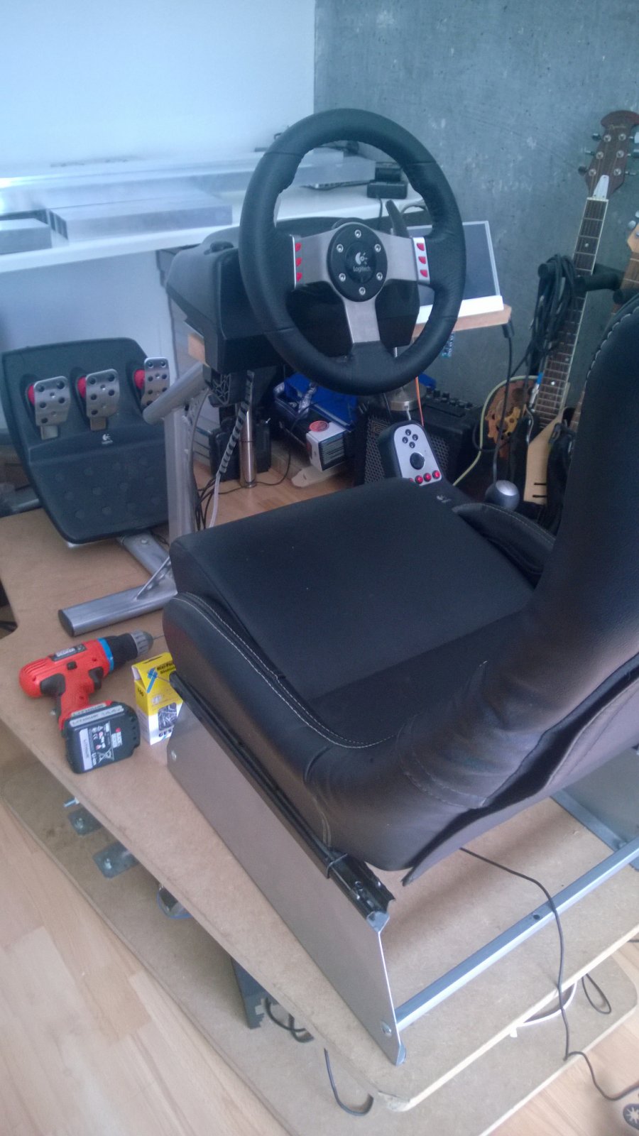

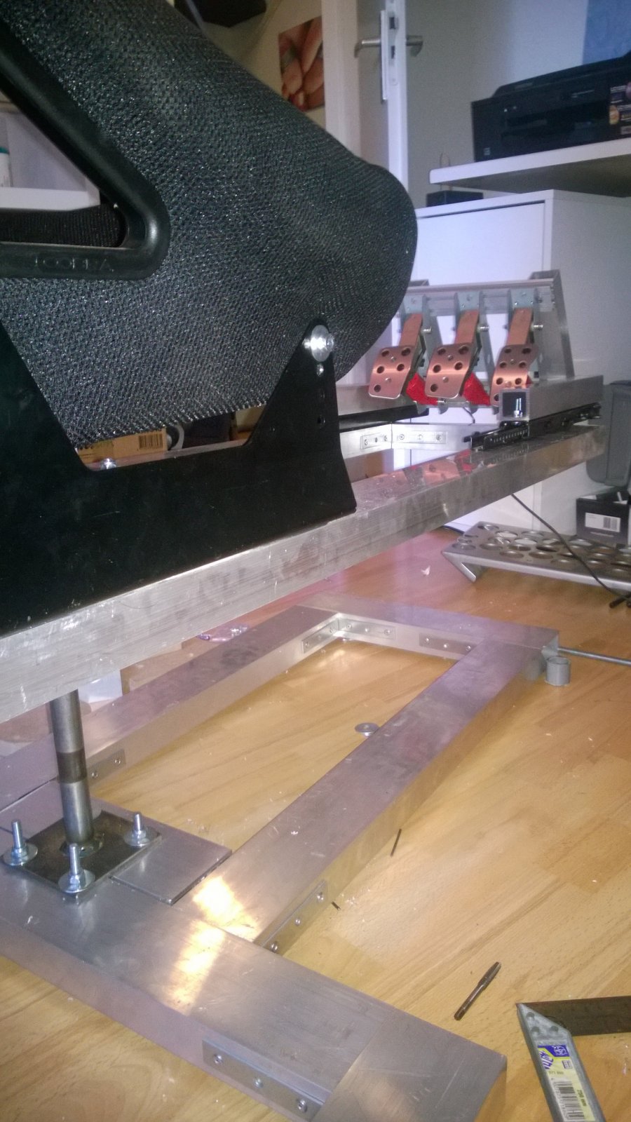

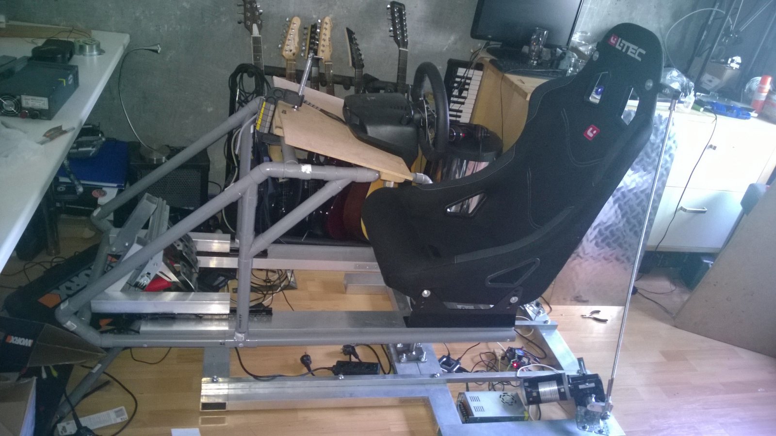

    After having build my first platform, converted a playseat to a 2dof rig, I started a new build.
    I felt I could do better then 2 boards with a playseat on it :)
    So this is or rather was the first version:

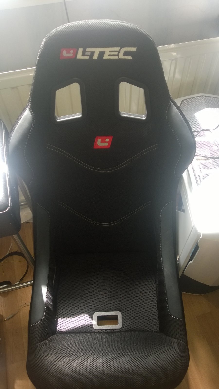

    But the playseat squeaks and the back is flexing so I bought:
    Such a nice seat and fit I needed a new platform :)

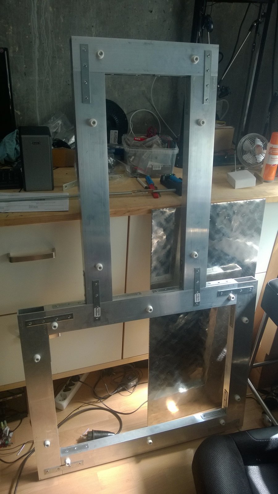

    So now I will have the the motors connecting to the back of the seat at sholder height.

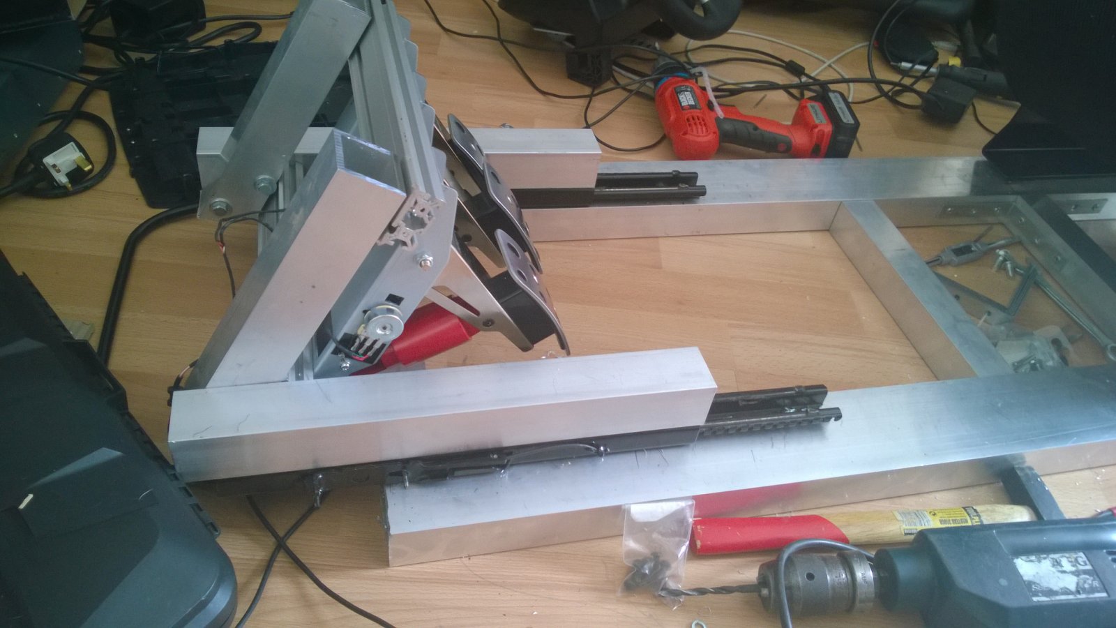

    So I bought a load of aluminum bars and started drilling and popping nails in it to get to this bottom platform
    Looks good and feels sturdy.
    So next up the upper deck :)

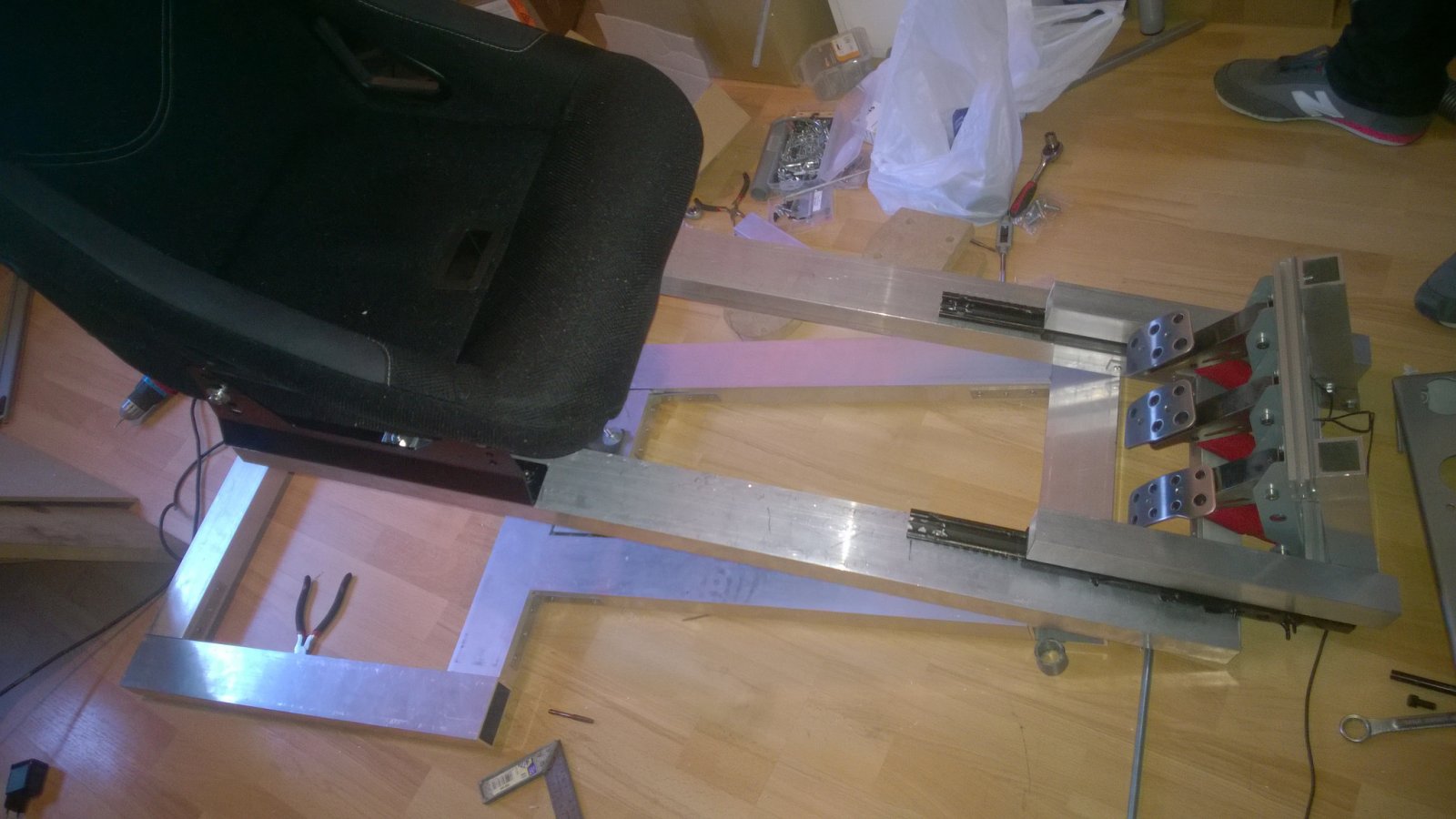

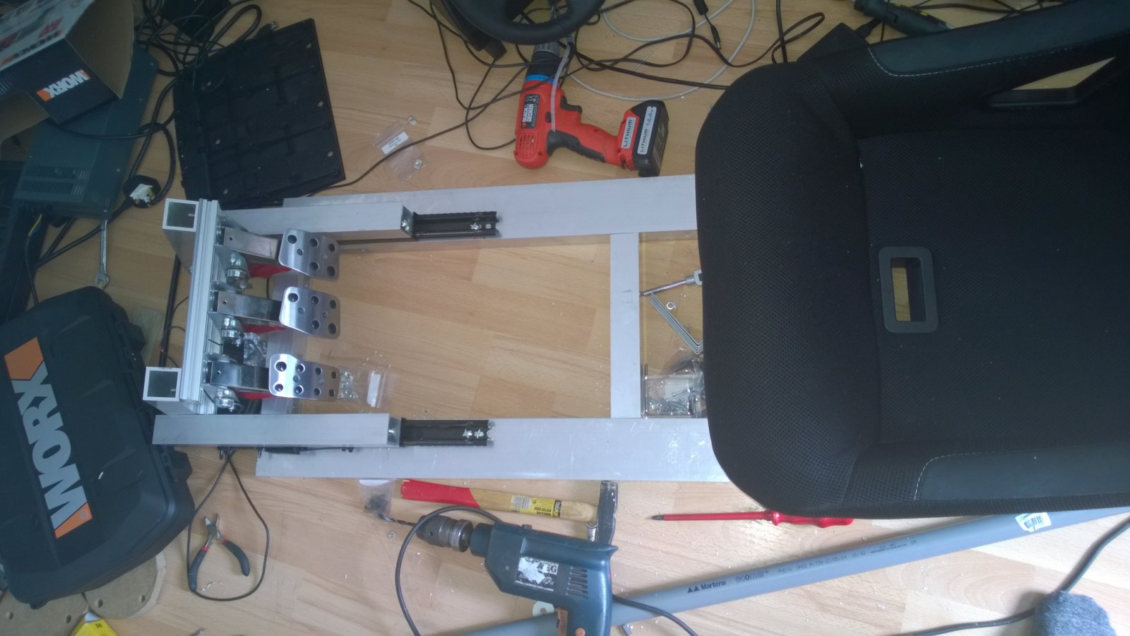

    Having the seat at a fixed position so that the center of gravity will change less when others want to use it. I decided to have the pedals sliding instead of the chair and inverted the pedals (g27). (got the pedals covers on wrong, I know! :). Like this:

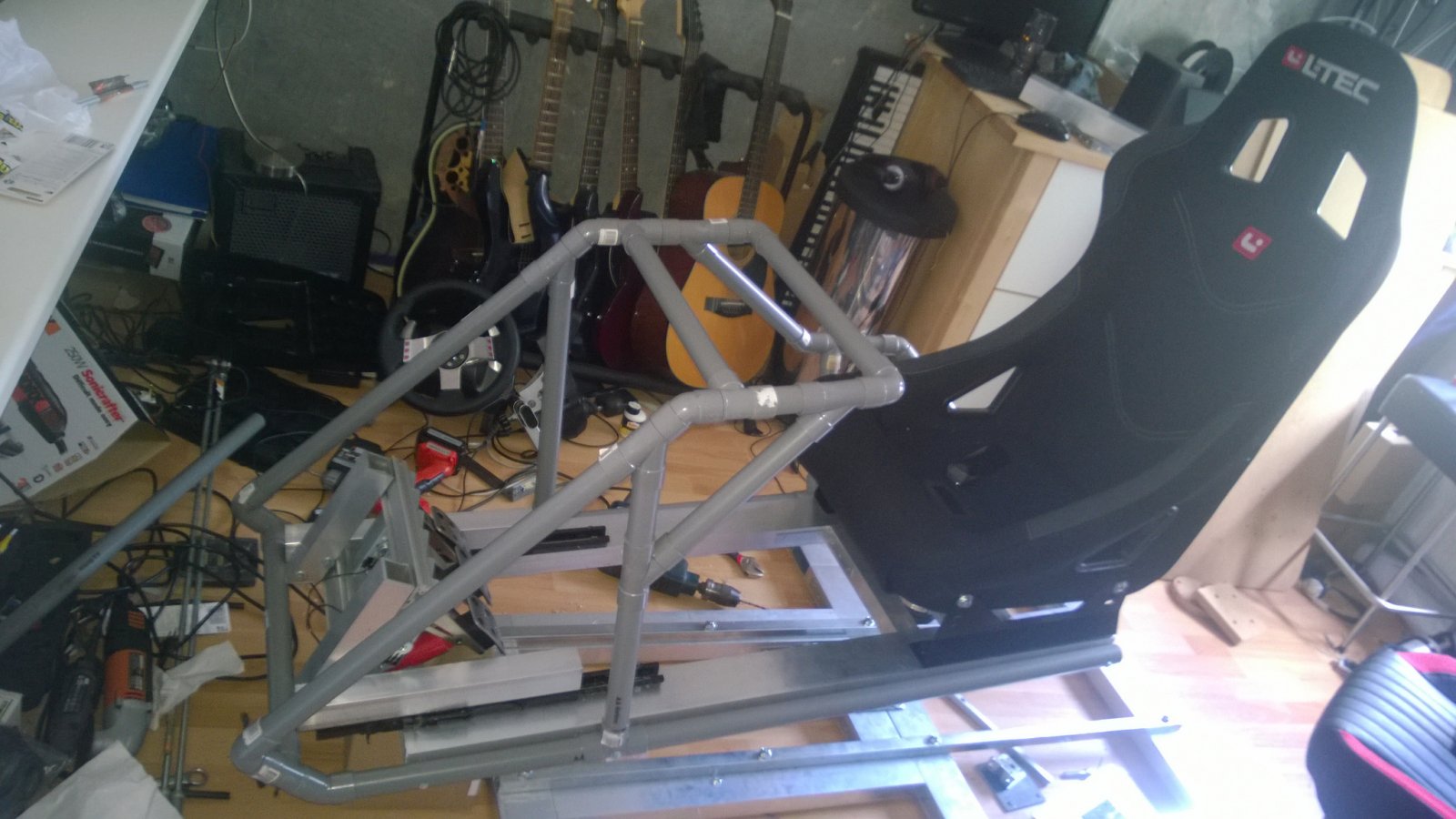

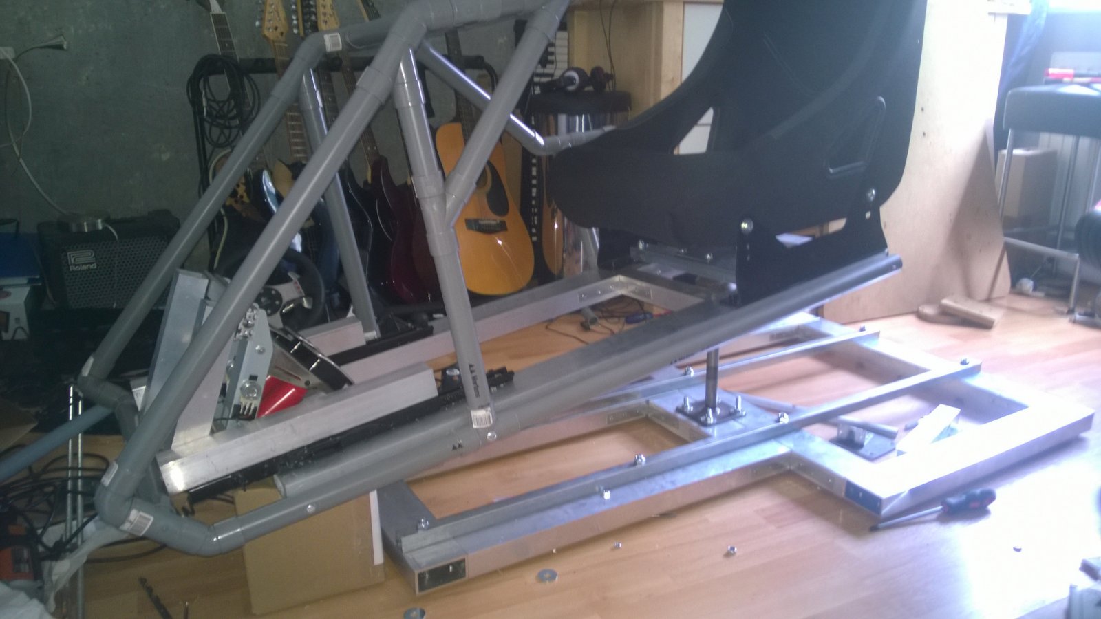

    For the upper frame of the deck I will use PVC pipes to keep things light. So that will be the next step before I can find the balance point and join the 2 bases.. I will connect a bar to the seat to connect to the motors instead of having a T-Bar construction standing up from the upper deck..
    I will cover the upper deck with a tear plate from the top and half way I will let it go underneath the board so I create more space for the heels at the pedals. I got the plate but I need to slice it so I can bend it twice to get a nice fold, creating a pedal bucket.

    Traction loss is not on the agenda yet.. But you'll never now. But for now I continue as I intended.. The 3th axis is not hard to setup in the construction I have now..

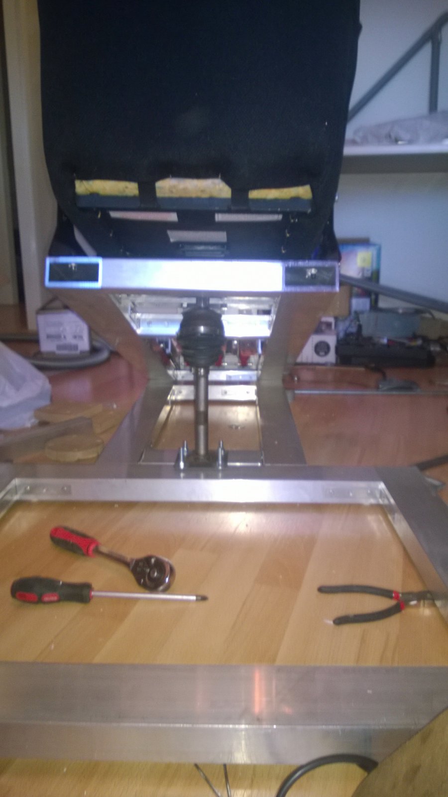

    Today I managed to marry the upper and lower deck :)
    And it feels so much better!!! Had my son on the seat and felt how heavy it would be to move if in the correct position.. That will rock !! as it is quick light to move!!!!
    Tomorrow I will mount the motors and glue up all the piping :)
    I hope It will get sturdy as soon the PVC is glued but I think it will work. Spray paining it black as soon as the glued dried.. I hope I won't get to high of the glue :)

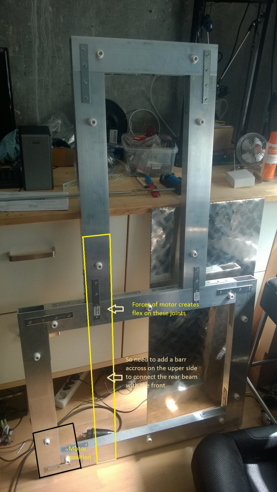

    I only made one mistake, I had forgotten about the force of the motor, I forgot the pull force of the motor, so now the rear part of the lower deck will flex. So I need to add a bar across the back to connect the rear cross bar with the front beam..
    That way the forces will be transferred across the whole deck, instead of just the rear section. So that is on the list for today/tomorrow and then hopefully I can connect the motors and have the PVC rigging set up and bolted to the upper deck.

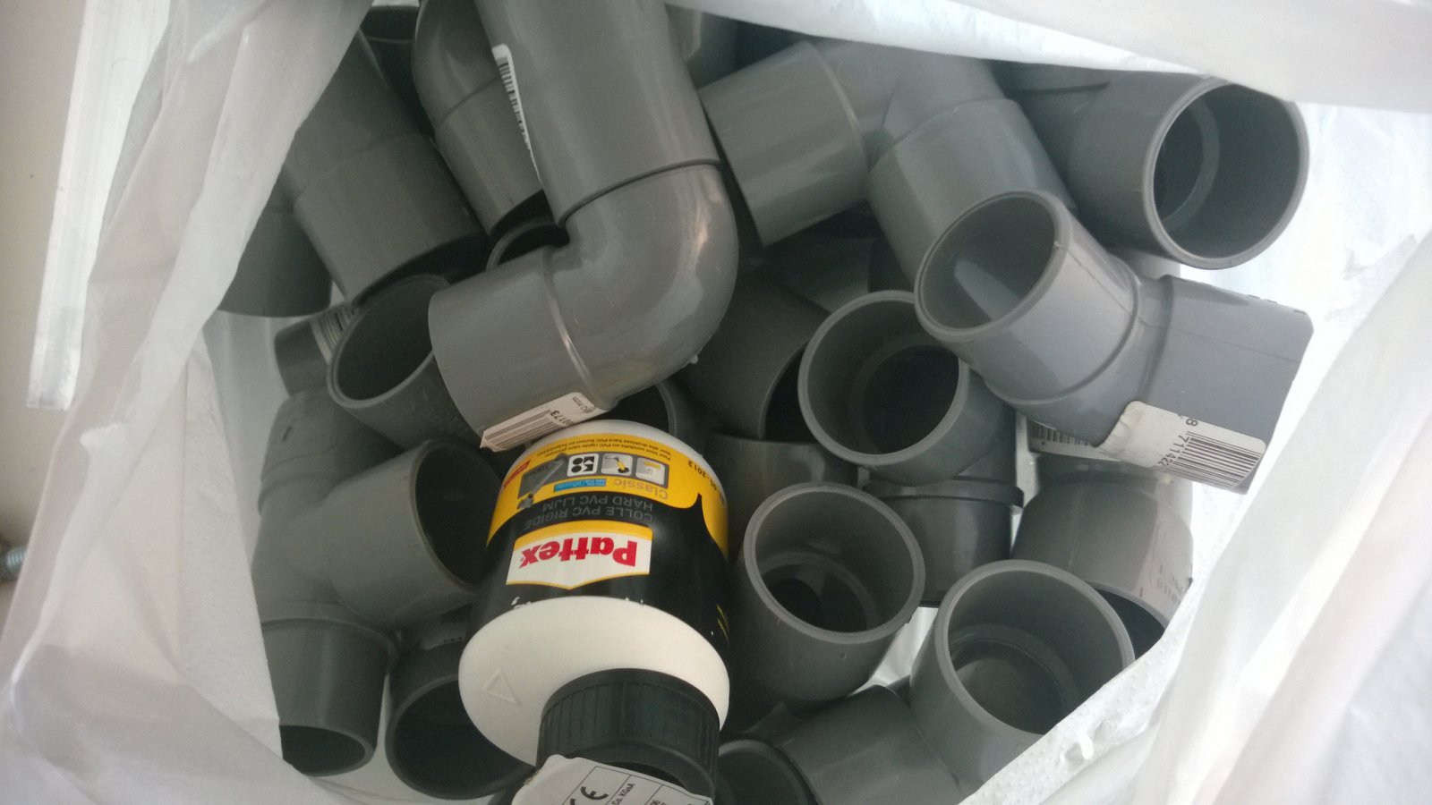

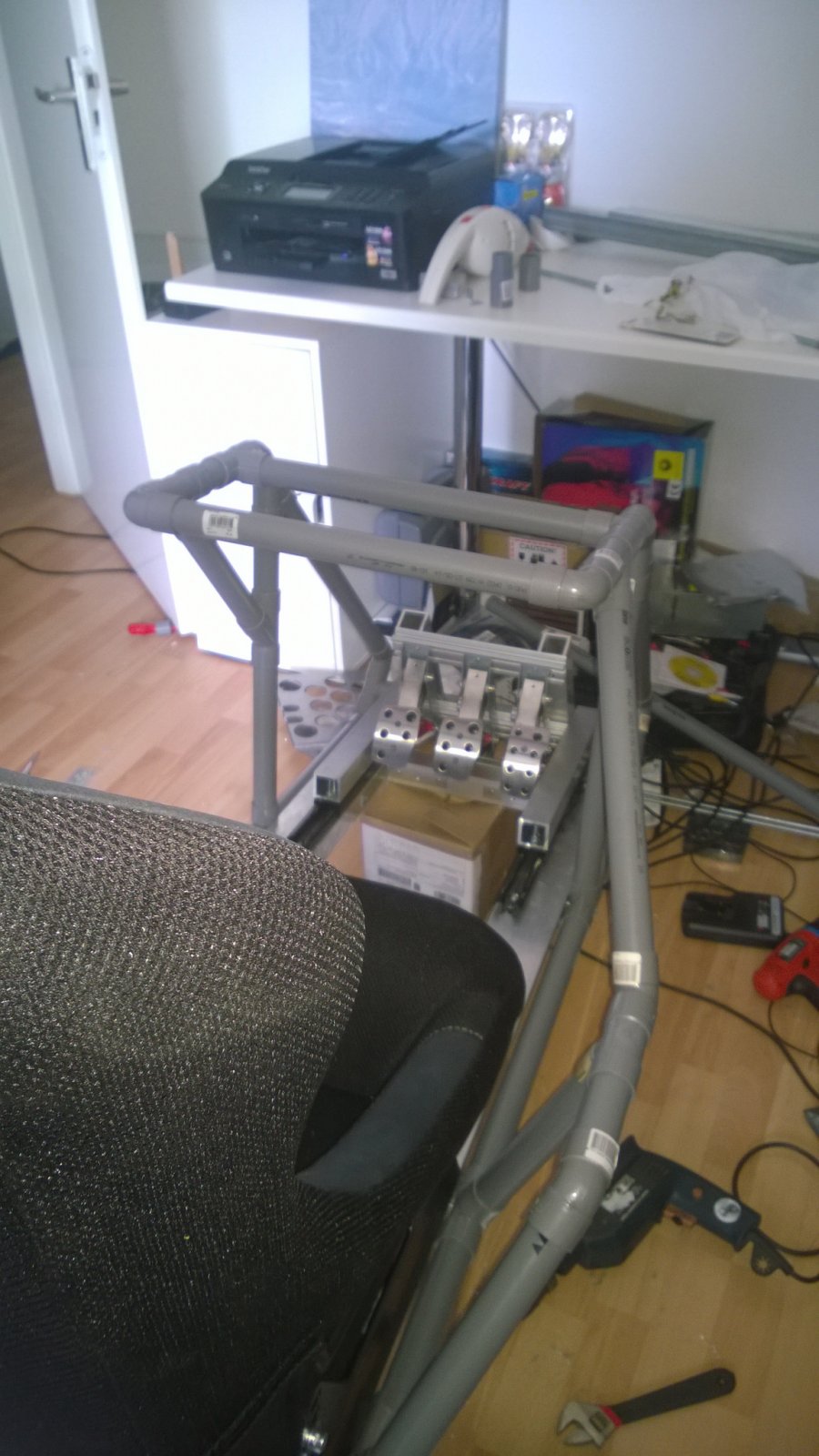

    As it is boring at work, no calls, I managed to continue and fixed the minor issue on the frame. now it solid :)
    And managed to get high.. Ehm glued the PVC..
    So again boring you with some useless pictures :)
    While glueing (and some occasional sniffing) I drilled the holes and tapped threads so I can bolt it on to the frame. So now I let it dry and wait for the right time (dry period of 2 days) to spray paint the PVC black.. ( and remove all the stickers first :-( )

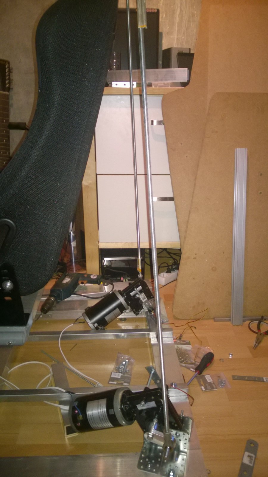

    Hmmm .. not sure but I hope this ain't too straight up..
    I did align the motors in the direction of the rod.. Not sure if that would matter in any way.. But nevertheless it's done..
    So tomorrow I'll connect the rods to the seat , drilling holes in a brand new seat.. :-( will be carefull :)
    Then reconnect every thing and hope for the best, that I didn't kill anything in the process

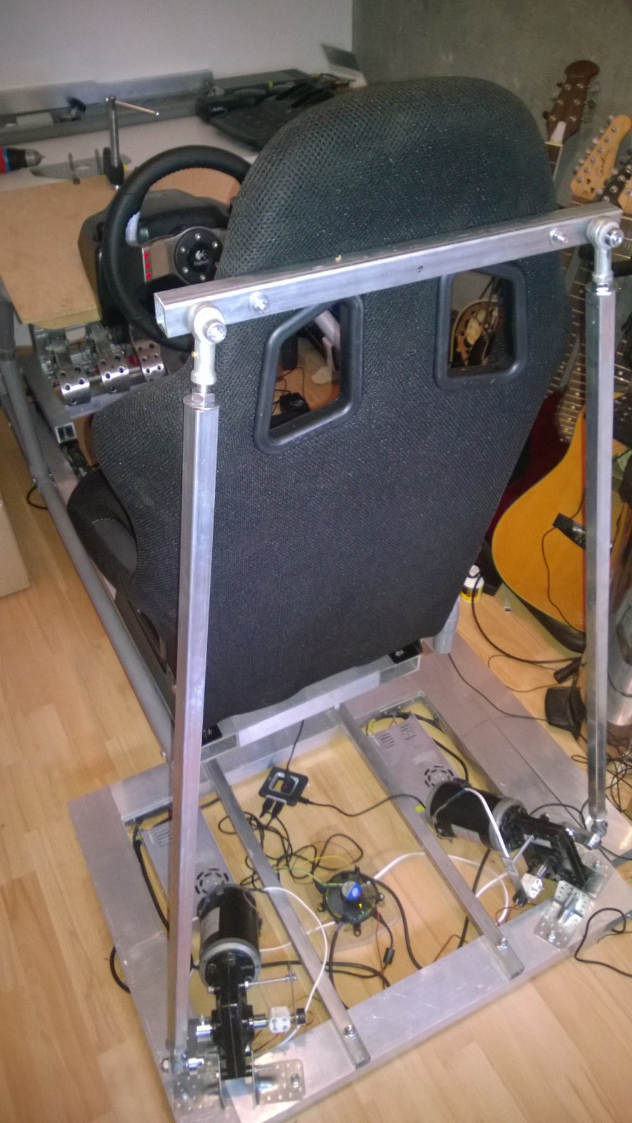

    I couldn't resist. Although not finished. Missing the steeringwheel deck, shifter fixation, tearplate for the floor and wood plate for the back to mount all the parts. I had to do a test run.. Oh man. what have I been missing out. so much difference, more feel.
    But need to do more tuning as I am not been thrown back enough when hitting the gas. But shifting kicks hard!! So I did a good shakedown, not 100% satisfied but I will get there!!!
    Also ran Grid motorsport, without motion, a damn that looks nice!! Will run it tomorrow with motion..
    I guess the finishing will take longer then the initial build :) but that's ok as long as I can race!! My evers are now 45mm so I thing I will extend my current ones with an plate and have them at 65mm length.. that way I get more room to play with settings.. :) but all in all, this is a might fine rig, glad I did the conversion from the previous one..Already much better looks and a whole load better feel. So now I got a rig that I can use for my upcoming Oculus, just some tweaks..
    BTW never though that inverting the pedals the way I have them now is also so much different, way more feel and you really have to get accustomed! And thanks for the nice comments and 'tags' :)

    Hi Michael,
    NICE work my friend...been watching your thread since beginning.
    Question: On the last picture, it "appears" that your rod from motor to back of seat have some flex/bend in it, like it's not strong or thick enough for length/load.....is this just an optical in the pic?

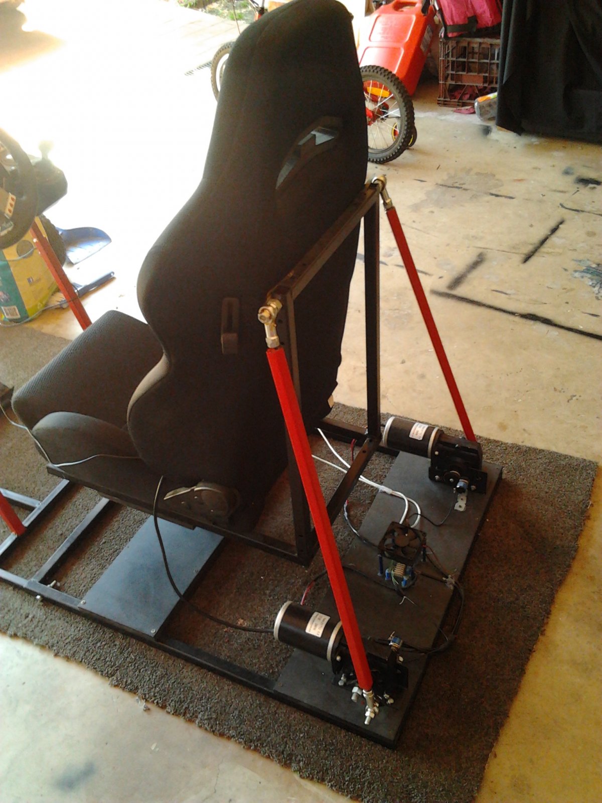

  15. bsft
    @Michael Hensen , I think @cthiggin has a point, it looks like the threaded rod is flexing.
    I suggest a length of 20mm box steel with bits of threaded rod on the ends . This will be a lot sturdier and will make the motion more solid.
    Like this

    Yep, I found this too!! they are bended.. will have to box it. :-(
    For now it will hold another day .. but it is something I 've put on the list

    Ok, thanks guys. I have got the rods boxed in 20x20 steel bar, and pretensioned the rod inside.. Much better indeed and no need to look back if the rods are still ok..
